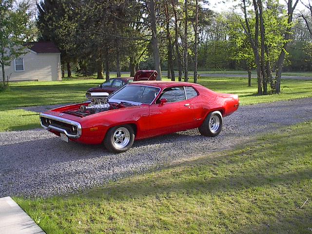

Post by ffej » Wed Feb 08, 2012 5:28 pm
i havent had any problems i put super stock springs on it at the same time.as far as hooking up the car has a blower on it . i think the only thing that would help my traction is slicks and then id probably find a weak spot in the motor :D besides the leaf spring relocation i also got wheels with a shallower offset, it really looks good with that big of tires that sit all the way up in the wheelwell,jeff

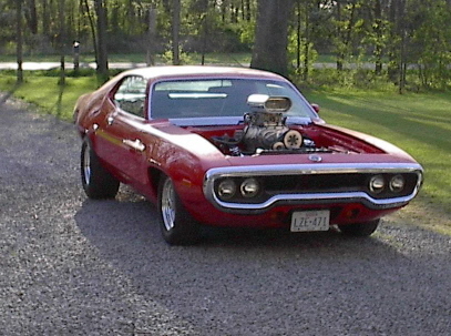

heres a couple of shots that show tires at better angle sorry about pic quality old camera

Post by NOrrTH » Wed Feb 08, 2012 11:07 pm
Awesome! nice ride. Man I'd love to go for a burn in that. Do you have a hood with a cut out for it?
I can't think of a body style, well maybe an E body, that screams for meaty tires these these do

NOrrTH thanks! yea its a blast to drive as soon as you step on it all the power it has is there. i have a rr hood for it but i think im going to find a satellite hood before i get the cutting tools out,jeff
