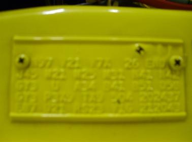

Restoration may be too strong a word for what I plan to do with to one of the Satellite Sebrings I bought several years ago as a donor for the RR/GTX restoration. It won't come close to the level of restoration the RR/GTX went through. It's currently mounted up the rotisserie, outdoors undercover, with work having to be postponed awaiting warmer/drier weather to complete some paint and body work. In the meantime managed to finish up the motor and transmission recondition/mild build up. Block appears to have low miles on relatively recent commercial rebuild, .040 over flat top pistons, .010 down, should be 8:1 CR with the 452 head castings that were on it. Along with new rings and bearings, installed a new Comp Cams 268/276 cam/lifters/timing set/spring kit and some left over HP parts. Same thing for the trans, rebuild with a few somewhat inexpensive internal HP upgrades. Should be a pretty decent daily driver with some performance while burning regular fuel.

What's that Holley you're running? I've never seen that type with an electric choke that's a Mopar application, just the Rochester replacement.
Re: Finally some progress on project #2
Post by 72RoadRunnerGTX » Sat Jan 29, 2011 1:52 pm
List #80555-1, 650CFM 4175 series universal spread-bore. When I picked this motor up several years back, in donor car #2, it had a leaking miss-matched Thermoquad on it I couldn't for the life of me find parts for. Bought a couple other used TQs hoping find something to get this motor running well enough to move this car around when needed prior to disassembly, they were just as ratty as the first one. Out of frustration I ordered the Holley, it will fit well for my current plans for this car as a driver, when tuned/jetted correctly for the 400, and the full electric choke will contribute to good all-around street manners.
