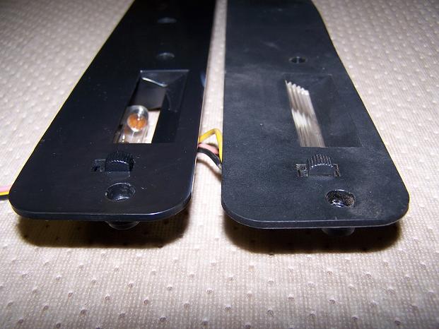

Got the first couple of base protos this week (a blank and a lighted base w/ fader hole). Next step is texture matching and moving on to the lens. The detail is matching GREAT. Only difference is the bulb mount. The switch assy is dead on. Dimensionally excellent. Slightly stiffer than an original piece to boot, so it should hold up better on the sagging problem.

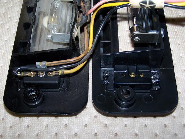

Backside of switch compared to original...

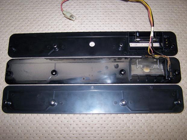

New blank, original assy, and new base for fader/lighted version.
Re: Map light lenses and assemblies
Post by Eric » Thu Sep 02, 2010 12:05 pm
Very cool Jeff. I remember spending a LONG time finding one that wasn't warped and didn't have a cracked/faced lense. Even then, the switch isn't all that good.

Question for folks on the switch. The proto doesn't have the wiring terminals installed in the switch, so perhaps that's the reason for this, but it acts like a two position switch. I would always mess with these to get the switch to stop in the middle so the light didn't ever come on. Was the switch intended to be a 3 position switch or is that how a fatigued assembly acts? I'm confirming with the manufacturer too to find out if they think this is an artifact of the terminals not being in place yet.
Thanks!
Jeff
Post by bruce » Thu Sep 02, 2010 1:27 pm
Can't answer your question Jeff, but that sure is a nice looking piece!

Post by 72RoadRunnerGTX » Fri Sep 03, 2010 12:34 am
I've had a couple of those original switches apart, electrically speaking pretty poor design. Internally, pretty clear it was intended to be a two position switch only. A real center "off" position for map/dome lamp switches is very common for many other make vehicles over the years but don't believe it was intentional for this particular application. It's the heat and current draw of the incandescent bulb that causes the most issues with this map light assembly.

Thanks folks! Sounds like we'll pursue the 2 position setup. I really appreciate the feedback on this!
