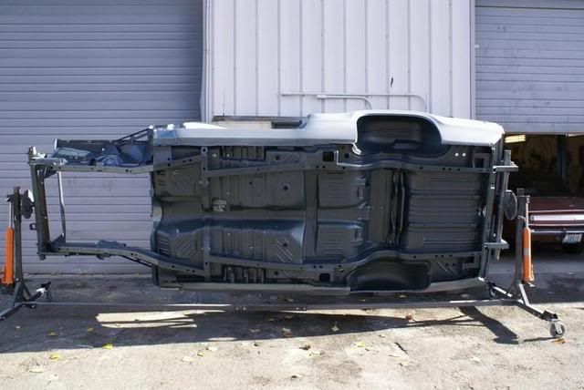

Take a look at the USCartool rotisserie kit, comes with detailed instructions and everything less the square tubing. I have about 8'2" under my door drive housing and had a good 6-8"s clearance when my car was up on the rotisserie.
