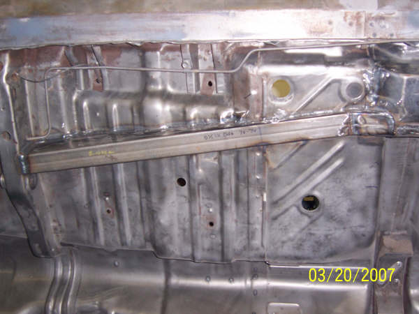

Post by ffej » Thu Dec 31, 2009 12:55 pm
i used the ones from ce and they went right in. bought the bolt in style them welded them in.,jeff

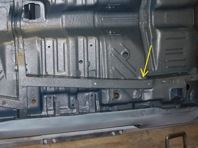

heres mine if helpful
