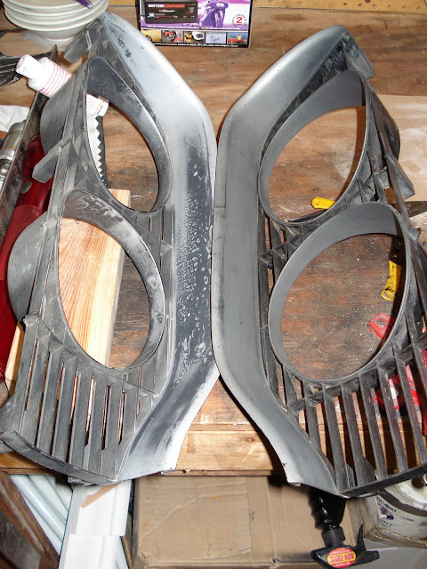

Post by steved » Sun Sep 20, 2009 2:23 pm
I took a better look at what I had, and the left grille had been repainted, but the middle and right grille sections were the darker silver.
I'm going to check out the SEM stuff from the '72 grille thread...
update with a picture:

Re: silver and black grille...'71 GTX
Post by Eric » Sun Sep 20, 2009 8:02 pm
The grille silver did darken a bit with age. I'm not aware of anyone making the correct color in a can. Here's an NOS Satellite grille, the base color should be the same for your GTX.
The grille on the B7 blue car in my sig. is unrestored/survivor....FWIW
(18.29 KiB) Downloaded 1795 times

Post by steved » Sun Sep 20, 2009 8:54 pm
Thanks Eric,
That's clearly not the rallye wheel silver.

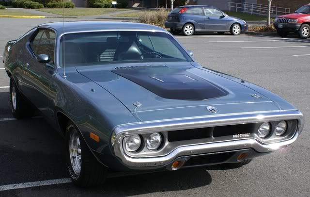

Post by Eric » Sun Sep 20, 2009 9:07 pm
Interesting too, I believe the Satellite grille was actually two different silvers, one on the grill fins and the other on the base and headlight surrounds.
I used a grille silver paint from Totally Auto on my butterscotch car, but it is a little lighter than my B7. Interestingly though, I have a NOS GTX/runner grille center and the Totally Auto stuff matches it pretty good. I suppose Chrysler used different vendors at different times and the paint formula was no consistent.
Here's a closer pic of the B7 car.
(168.66 KiB) Downloaded 1776 times
