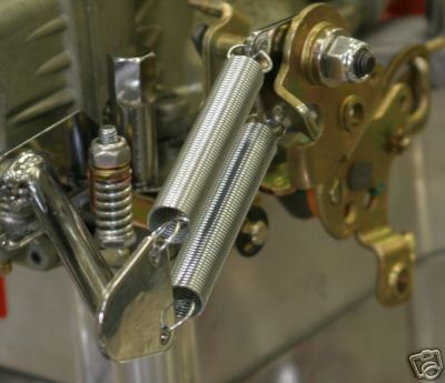

i need to do th ereturn spring bracket...eventually - this is how it's been set-up since i got the car 5 years ago...not pretty at all, i know...probably get it replaced when i do the intake
Post by landon1 » Sun Jul 20, 2008 1:47 pm
here's the bracket i've been looking at...lookin for coil relocation bracket as well if anyone has suggestions

landon1 wrote:i need to do th ereturn spring bracket...eventually - this is how it's been set-up since i got the car 5 years ago...not pretty at all, i know...probably get it replaced when i do the intake
Not trying to contradict or be rude, but I would consider the throttle-return spring a priority. $20 spent now for a spring/bracket assembly is cheaper than a smashed up Mopar or even the people/things you will hit as a result of the ensuing accident (or even your own injury). At least get that spring replaced, wow... A good generic source is Spectre Performance at Kragen. And I agree about the two-spring thing, either one inside the other or adjacent. I've heard too many stories in my lifetime of these springs either flying off, breaking, or just giving out.

Post by landon1 » Sun Jul 20, 2008 5:29 pm
i'd never seen double springs til i got my 78 dodge pickup that had them stock - never had a problem with that single spring...
anyway, i got the one pictured above - it's on the way, as i may be picking up my torker intake in the next week or so... i really wasn't planning on getting a new air cleaner and all that other stuff too, so after i knew what i needed i was just going to order it all at once, but luckily oreillys and arnold's had everything i needed except for the springs - they could order them at 30 bucks, but i got this set on the way for 15 total including shipping.

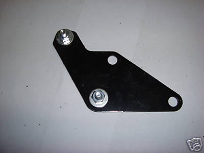

I bought one off ebay and in the past made one from some 1/8" aluminum. It relocates the coil in front of the caburetor and mounts the coil horizontally.
Ron

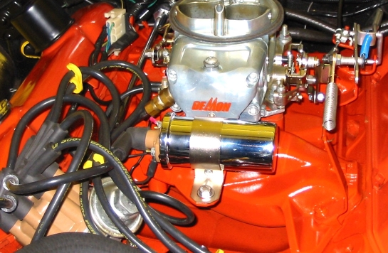

Here is the coil mounted in my old Challenger with the home made braket.
Ron

Post by mopar71 » Mon Jul 21, 2008 4:52 pm
Its hard to see your fuel line in that pic,I think landon wants to put it vertical.On the 440 sixpaks I see that they have a bracket to place it on the left side of the carb.
