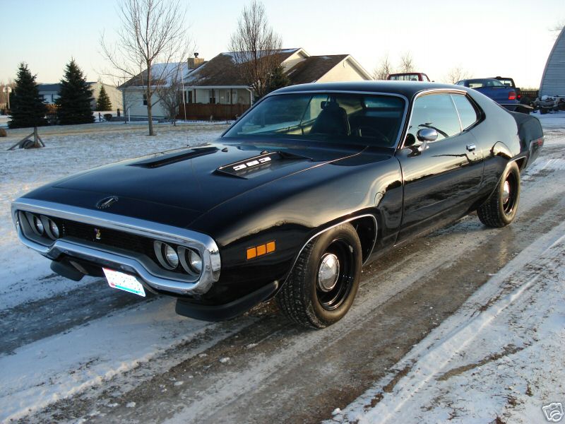

Hey guys -
Long-time lurker here, thanks for all of the informative posts and info. About 4 months ago, I purchased my all-time favorite car - a Black/Black 1971 Plymouth Road Runner. Car was bought without my actually going to see it because of my work schedule. It's an interesting bird, a REAL Black/Black Road Runner with no vinyl top - it has a '71 block but not numbers matching. 383 automatic. Car had a rotisserie restoration and it has a ton of new parts on it - even new fasteners. New floors welded in and new fenders. She's a real beaut. But it still doesn't run right and now we're thinking that it has the wrong heads.
So here's my question: I'm considering dropping in a new Hemi crate motor. I've seen them online as low as $12,100 plus I figure another $800 to ship it and $1000 to install it. WILL THE CAR BE WORTH $15,000 MORE BECAUSE IT HAS A NEW HEMI? Again, the car is definitely a Barrett-Jackson worthy car in-terms of it's restoration, although I intend to drive it. But I paid $23k for the car plus another $4500 finishing the restoration to get to where I am now. Only remaining issue is the driveability (it stumbles heavily under acceleration and barely gets out of it's own way).
Is the car an easier sell at $30k assuming I can get it to run right, or $45k with the Hemi?
I have no 'short-term' plans to sell it. But I have to be honest with the fact that I've never kept a vehicle more than 4 years and if I have to or choose to sell it in a year or two, which is the easier sell?

I personally think a matching numbers engine(or just an engine like it had originally)would be better than the Hemi.Everyone always goes for the biggest and the so called best,thats why all the major big blocks are of course hard to come by,just like the 73-74 b bodys ,people are starting to want the engines they had in their cars before they decided to join the power trend.I think since you plan on selling it,it would be smart to check out whats selling and whats not on ebay or something,find out if people would prefer and Hemi or not.Your right your car is beautiful,i buy either way,Hemi or not.
You beat me to the punch on that car. I remember it coming up on Ebay, but I couldn't pick up the phone quick enough. I've still got picture of it on my hard drive.
Short answer to your question. No. Not in the current market. Work with what you've got. Any modifications should be done for your own enjoyment.
You've likely just got an ignition or fuel problem. A new distributor and/or carb is a whole lot cheaper solution than a Hemi.

She is a beauty! I agree with the rest of the guys in saying that you wont get your money back with the hemi. Have a good mechanic check whats happening with the current engine. Its a tough market right now with the gas and all. Either way good luck with it

what kind of hemi you talkin about? an original style or a 5.7? the original RB wouldn't be bad to install, but unless they've done some improvements to it (i'm sure they have) i heard they're pretty tempermental and if you don't know how to tune em right, they'll run like crap - and 15K for a motor isn't what i would call a bargain - then you still have to buy all the accessories, i believe.
imo, keep the 383...what makes you think the heads are wrong?
here's what i would do....
1. distributor - go electronic it's an amazing difference - since your car is a resto-type, get the pertronix that'll fit under the cap and nobody will know. PS check vacuum advance on it...mine was runnin bad that's pry the cause (i was going to change it all anyway, though)
2. carburetor - what is on it? factory or afermarket? maybe your carb isn't set-up correctly, but my bet would be on the ignition. now i've heard from several (i need to save-up for this...) putting on a thermo-quad or edelbrock carb will give you excellent performance plus get you the mileage we all need now.
once you get that bird runnin from coyote, you won't ever want to sell it imo, but maybe by that time i'd have enough to buy it off ya JK

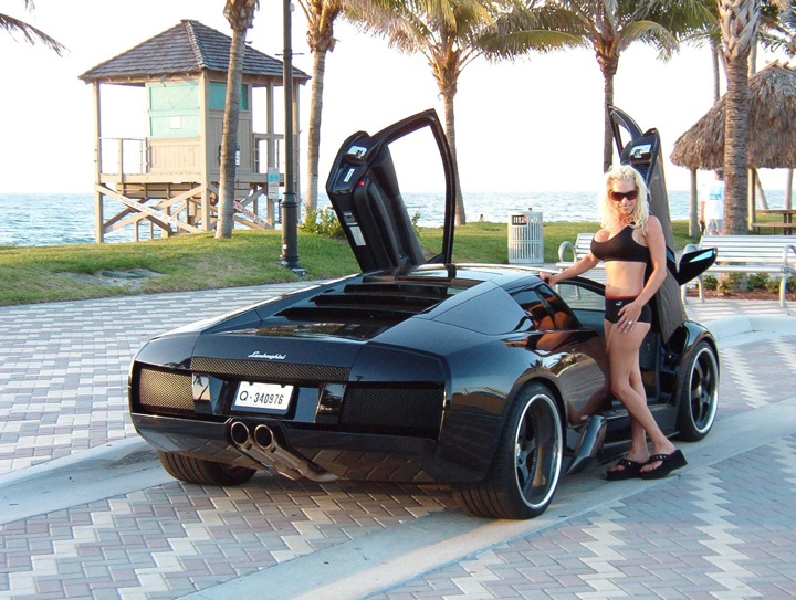

You probably wouldn't wish you had one, after actually getting it. Like a boat (can be), the 2 best days are the day you buy it and the day you sell it. Now THAT car - I researched and looked for - hard. Over 4 months and 3 PPI's (Pre-purchase inspection - you have to pay pro between $400 and $1100). The car I bought was known and documented. And the year of ownership cost me more in-terms of depreciation and - ahem - 'maintenance' than the entire purchase price of this car.
It's a scream, no doubt. But drink 3 beers and play one of today's high-tech video games and it's about the same thing.
Although your couch is way more comfortable.
Pic of the 'ex' attached.
