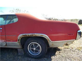

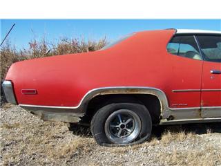

Ok I might be considering buying this Roadrunner and it seems to have some good options. It's factory sunroof with white vylon canopy top. Has side body trim with door guards. It's an orginal 340 matching and lots of body rust and I wanna know it it worth getting for around 5,000.

Looks like it is a Satellite, not a Road Runner. Road Runners didn't have the two tone body color with the body chrome molding.
If it was a real sunroof road runner I'd say it might be worth it, but for a rusty Satellite, probably not....just my 0.02
BTW, a road runner VIN would start with RM23 while a satellite would be either RL21, RH23, or RP23

i really think you should check the vin num. i dont beleive the side trim was an option on a 72 rr. as for the dash it would be the same in a sebring plus, which a lot of them had the two tone paint like the one in your pic.jeff

Not to discourage you, but make sure the tag matches the car. The side chrome body trim is code M33 and would show on the fender tag. Also the body side molding (bump strip) is code V5_ and would also be indicated on the tag. Unless someone took a road runner and cloned it to a satellite, that two tone/trim combo was not available on a 72 runner. Do you have a photo of the hood on the car?

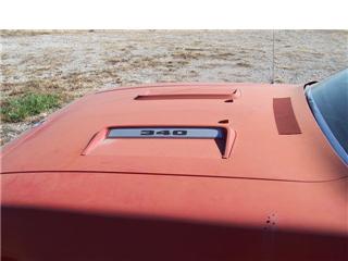

Alright he gave me a bunch of pics of the car so hopefully you guys can tell that this a rr not a sebring. And I know sebrings came with different hoods and this one looks original for the car.
Heres the hood

Post by landon1 » Thu Nov 15, 2007 12:59 pm
maybe you could scratch a lil bit of paint off the lower part of the body to see if there was red under there at one time and someone painted over it for some kind of body damage...idk...and maybe someone really liked the look of chrome trim (eck for me on these cars) if it is indeed a rr...also is it possible the car had 2 tags and one is missing?

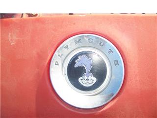

Personally I think the guy is BSing you. It sure looks like a sebring plus to me. And that is a really fresh looking rr sticker in the basil.
I think $4,000 would be fair from what I can see from the pictures

Have him send you (or better yet go look at it in person) legible photos of the dash VIN, fender tag, radiator support VIN, and cowl VIN stamping (located on the drivers side). If the last six numbers match on all these, and the dash and fender tag read RM23 (and they're not repops) then it's a runner that someone decided to fix up with SSP trim. Also get an interior photo of the passenger side dash....FWIW, the woodgrain bezel should have a roadrunner emblem. Many times when a car is cloned these do not get changed over...
