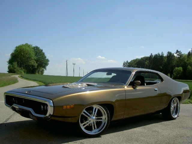

Dammit Gionni- I LUV THAT STANCE!!!!!!
Now- what the hell are you doing putting lower blocks on mopar- SHAME ON YOU GUYS.
You should just reverse the front spring mount/hanger on the rear springs and that will drop the rear of the car 2" (50.8mm) you'll need a jack/stands, round file and about 2 hours start to finish.
The hanger is offset 1" ( 25.4mm) toward the bottom of the car- from the factory. The bolt pattern is asymetric so the workers could only install it one way- slot those 4 holes so the hanger will install "upsidedown" and bolt it back together. one note- make SURE the slots ar no wider than you need and that you keep them square to the mount.
Cheaper ( no blocks or U-bolts to buy) and better than lowering blocks because it doesn't change the leverage the axle applies to spring.
