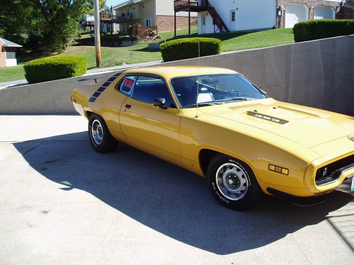

Thanks for all the help guys! I really appreciate it. After talking to the owner a little more I believe this car was originally a satellite. It is nicely done and definitely looks like a RR from what I can tell. It does not have round guages in the dash. Is this a dead giveaway from a satellite to a RR? I am posting a pic of the car too. Any thoughts or opinions? What would a car like this be worth if it's in decent shape and a clone?

WOW! I don't care whether that thing is a Road Runner OR a gussied up Satellite, it's BEAUTIFUL! What's the asking price? From the way it looks, it shouldn't be cheap. Oh yeah, the sweep dash rather than the ralley guages is a dead give away that it's likely a Satty. What's the VIN?

I haven't gotten the VIN number yet. The asking price is $11,000. It is a good looking car isn't it!?
Post by bruce » Tue Oct 17, 2006 11:54 am
$11k actually doesn't sound outrageous for a car that looks that good. As long as the body is solid, it runs well, no major issues. You'd certainly spend way more than that building one like it!

Hows the engine? It looks good,the dash is definetly a dead givaway,most roadrunners had a rally. 8)

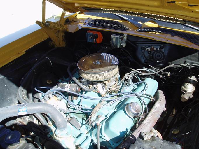

The engine is a crate 383. Supposed to run good. I'm going to look at this car this coming Thursday so we'll see. I've attached an engine pic.

Only two things I can see, you need to get rid of all the black "trim" on the outside of the car (particularly the marker light bezels) and you need to get rid of all that black in the engine compartment. Post the VIN when you get it!

OK...I'm going to ask a dumb question. What's the deal with the black. Is it just not "correct"? Is engine bay and trim supposed to be the car color?

Post by bruce » Tue Oct 17, 2006 2:50 pm
No need to apologize, EVERYONE has to learn sometime! Yeah the marker light bezels should be body color. So should the engine compartment. It's a typical shortcut to just paint the engine compartment black. Often seems easier than painting it properly.
Also, since GM and Ford products usually have black engine compartments, you'll often see folks who like THOSE cars doing Mopar engine compartments in a similar fashion. Can't say that's their FAULT, they just don't KNOW any better! :lol:

Thanks for the wealth of information! You're absolutely right too. I have always been a GM guy and black in the engine compartment didn't look wrong to me at all. Now I know.
