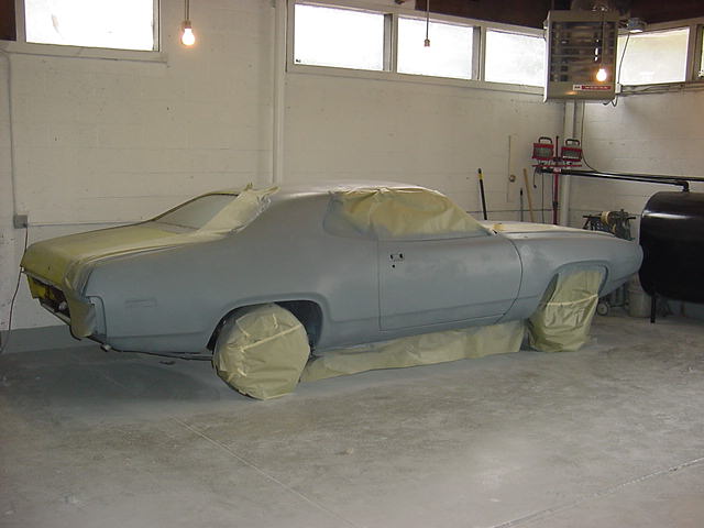

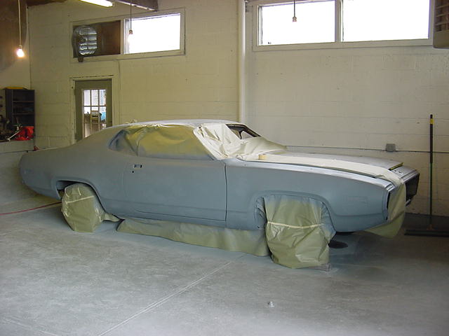

Hi All,
Thanks for your interest. Things are moving quite well on the resto. Body was in great shape with the exception of some small 4x4 areas that were patched in the rear quarters. Rear window turned out to be fine but when we pulled the windshield and trim off..OUCH! The lower windshield track is rotted about 12 inches across in the middle as well as the lower corners. Surprisingly the upper areas about 3 inches in from each corner are bad for about 6 inches on each side. Quite a bit of work. Any suggestions out there besides fabricating windshield track from scratch> Here are a couple of photos.
Scott
New Curious Yellow Project Photo
Curious Yellow
- MVC-004S.JPG (36.56 KiB) Viewed 5028 times
- Right side welded up, skimmed and in scratch primer
- MVC-002S.JPG (36.05 KiB) Viewed 5028 times
