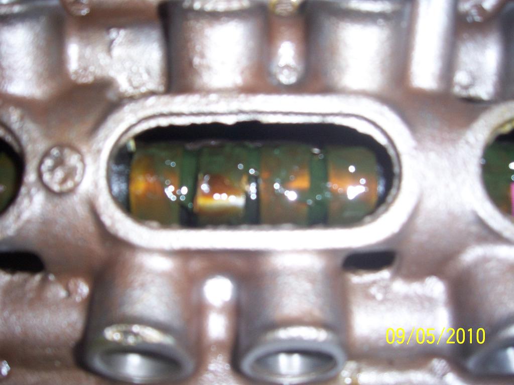

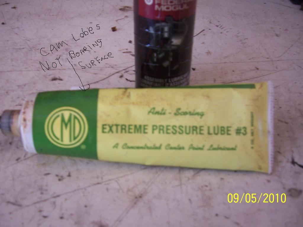

Hey there looks like you are doing a good job but one thing i see in your last pic is that you have no cam break in lube on that cam.Not telling you what to do but with all that hard work the last thing you want to do is wipe a lobe off that cam on break in.Also make sure you use a zink additive to the oil also helps the cam live.here is a pic of a cam in a motor i doing for a friend of mine.Also here is some of the assembley lubes i use.

I did put lube on it.the lube lunati gave me with the cam,may not look like it but its on there.may have just more on one side then the other.
