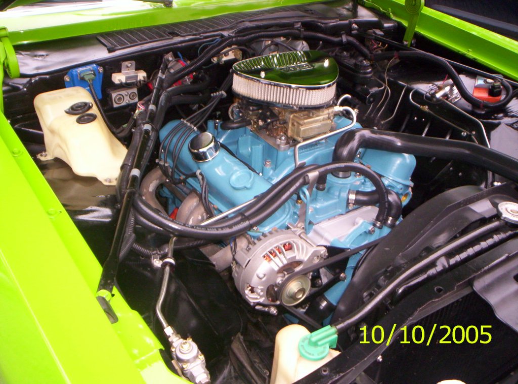

Post by 71Beeper » Sat Aug 21, 2021 8:50 pm
Lovin the blue paint Scott. :beer:
Years ago when I had a 318 in my F-body Road runner I painted it corporate blue.
All the camera pictures 150.jpg (157.24 KiB) Viewed 298878 times
I'm glad that you decided to go with the AVS2 carb....you won't be disappointed.

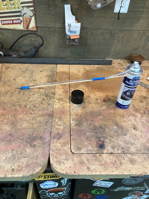

I assume you put some sort of protection on the inside of the rockers?
Re: Daddy's Stinky Car progress page - updated for 2021.
Post by sdweatherman » Tue Jan 04, 2022 2:24 pm
71Beeper wrote: ↑
Sat Jan 01, 2022 9:07 pm
Excellent work Scott!
Yes, Eastwood makes a rust encapsulator spray can that comes with an 18" flexible spray hose. You run the hose into your frame rails or rockers or wherever, and slowly remove the hose as you spray. Pretty slick!
Post by 71Beeper » Tue Jan 04, 2022 8:50 pm
That does sound pretty slick - I'll have to look into that product.
ct71rr
Posts: 344
Location: Massachusetts
Post by ct71rr » Wed Jan 05, 2022 2:27 pm
Yup. The Eastwood spray works pretty good. I’ve been using it in my rockers, windshield frames and in the bracing that attached to the rear wheelwells. I attached a thin wood dowel to the hose to make it more rigid. After spraying some, I remove the cap with the hose on it and attach it to a can of metal prep spray to clean the hose and nozzle out. Works great.
