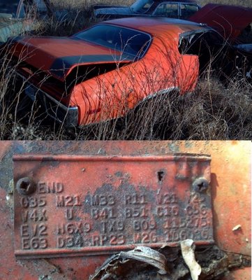

There are a few old threads here on this forum addressing the ’72 v21 & v25 issue, do a search. Appears the v25 code was not included in the fender tag on RMs with N96. Satellites showed both codes.
Re: Inherited 1972 Roadrunner/GTX 440
In my experience the V21/V25 coding wasn't dependent on N96 but instead varied by build plant. A Windsor car (R is the 7th digit in the VIN) typically has different coding "quirks" than other plants and this is no different. All V21/V25 Windsor built cars I've come across were only coded V21 on the tag.
