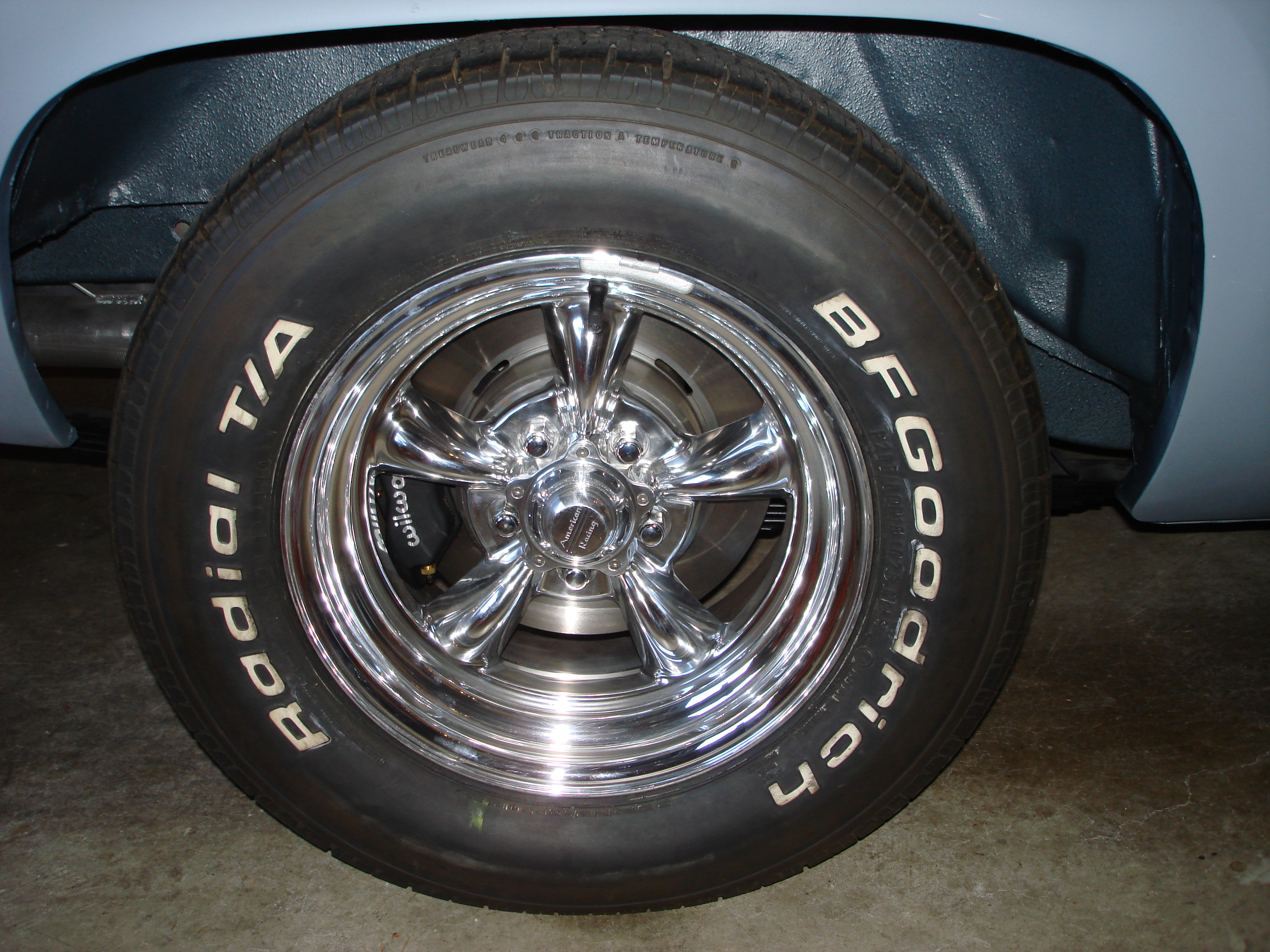

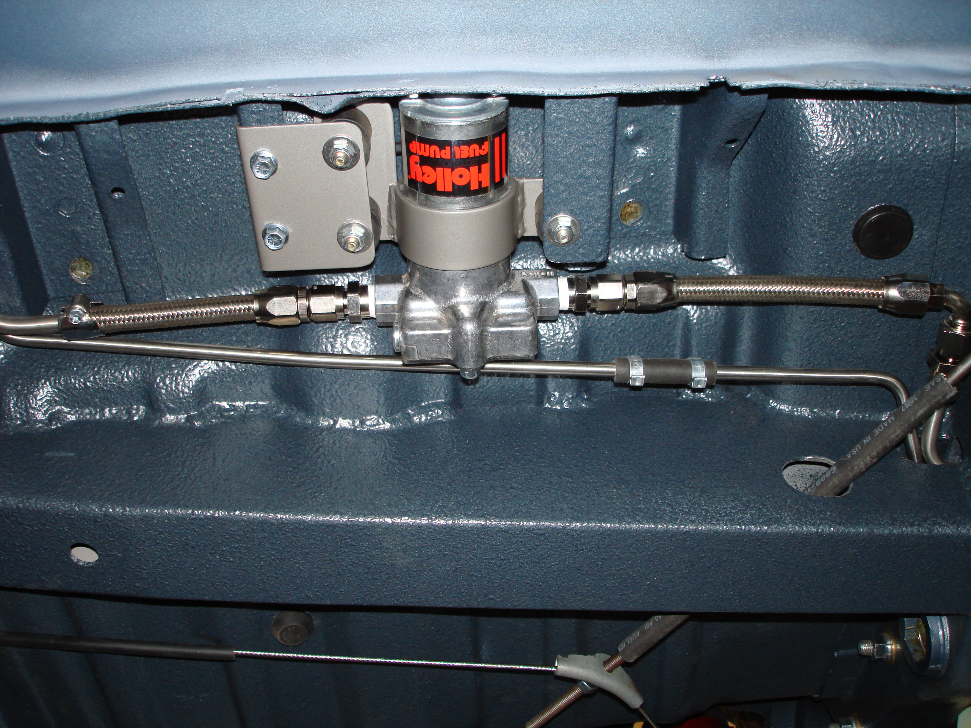

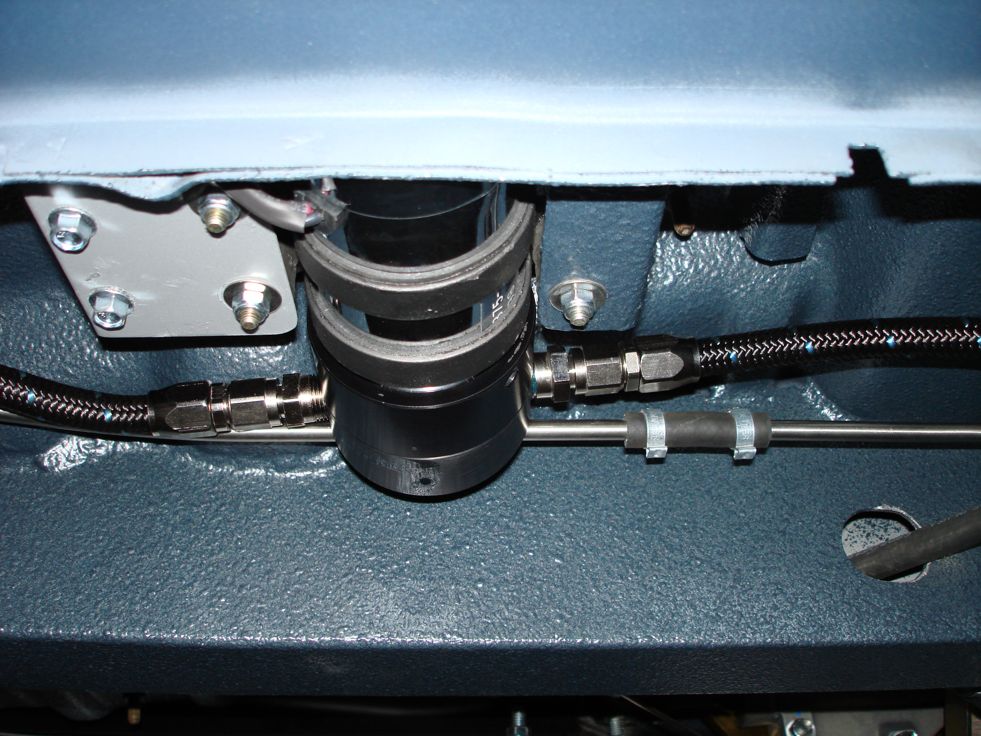

I gave up on my attempts to quiet down the Holley "Blue" vane and rotor electrical fuel pump. I had an idea from the start that it may be noisy and had fabricated isolation mounts for it and the regulator. However between the outright vibration of the pump and the corresponding pressure pulses in the line between the pump and regulator, I just couldn't handle the noise resonating throughout the entire body of the car. Took a chance on the Holley "gerotor" 125gph pump, physically larger I was concerned it may not fit, it did after mods to my mounting hardware. Guess what, NO! noise at all. Ok, a little hum maybe can be heard with the engine off but what a difference. This pump is internally regulated at 7lbs. psi vs. the "blue" pumps 15lbs psi, all but eliminating the line pulses to the regulator.
Also had to give up on my plans to run 15" rallye wheels on my car. Both the 7 and 8" wides wouldn't clear the rear Wilwood disc brakes. The only off the shelf 15x8" wheel with the 4 ½" offset I was looking for was the AR torque thrust II. I had already committed to 15" tires some time ago, and at this point don't really want to go bigger.

Post by landon1 » Sun Jul 27, 2008 5:55 pm
what size tires are you running? i think i'm going to have to go with 27 or 28" diameter rears, as the 60 series bfgoodrich tires on it now look too small.
Post by 72RoadRunnerGTX » Sun Jul 27, 2008 7:47 pm
That’s a 255/60 15, on the rear, 27” diameter. Plan to run 235/60 15 up front, about 26” in diameter.

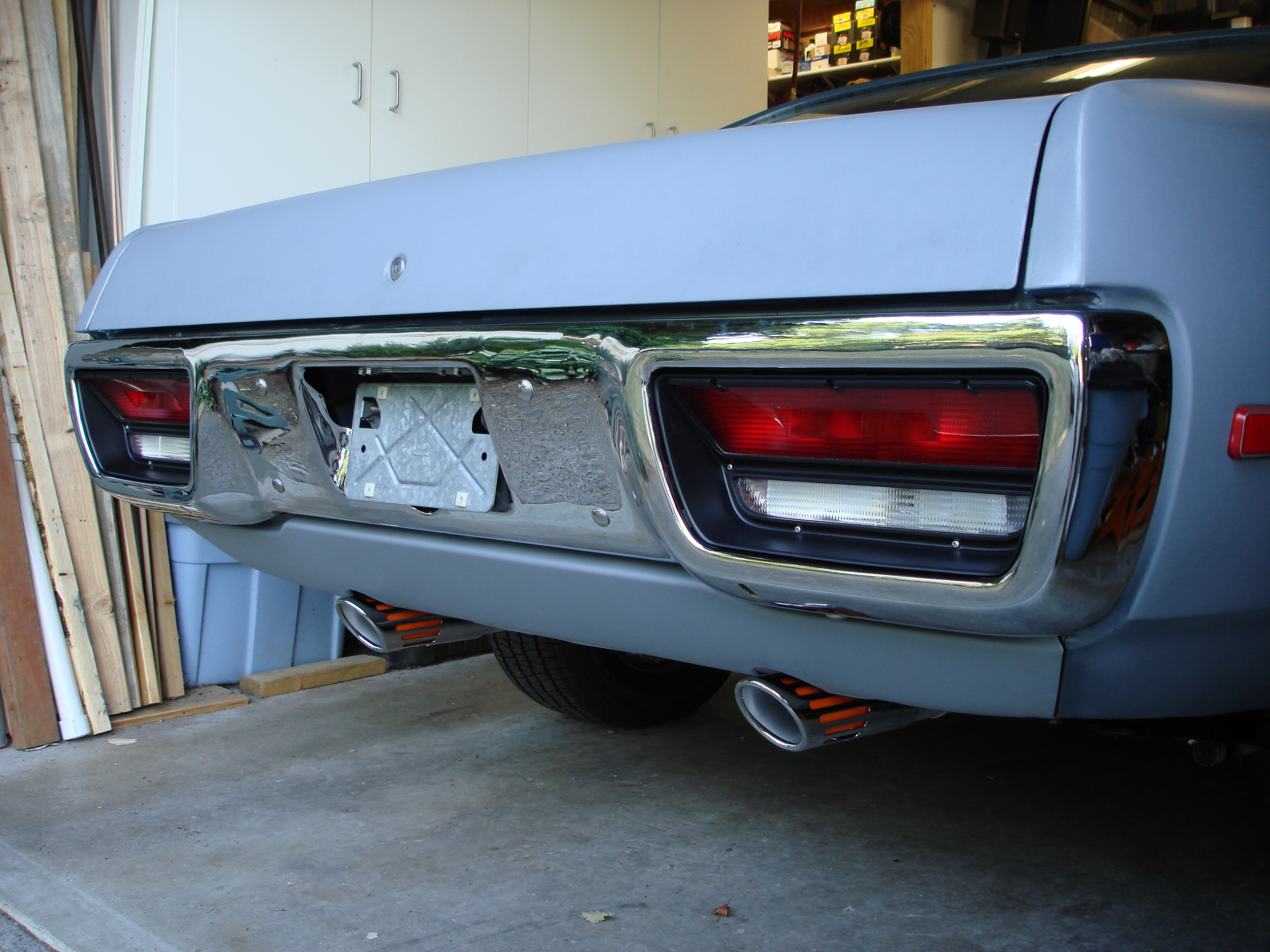

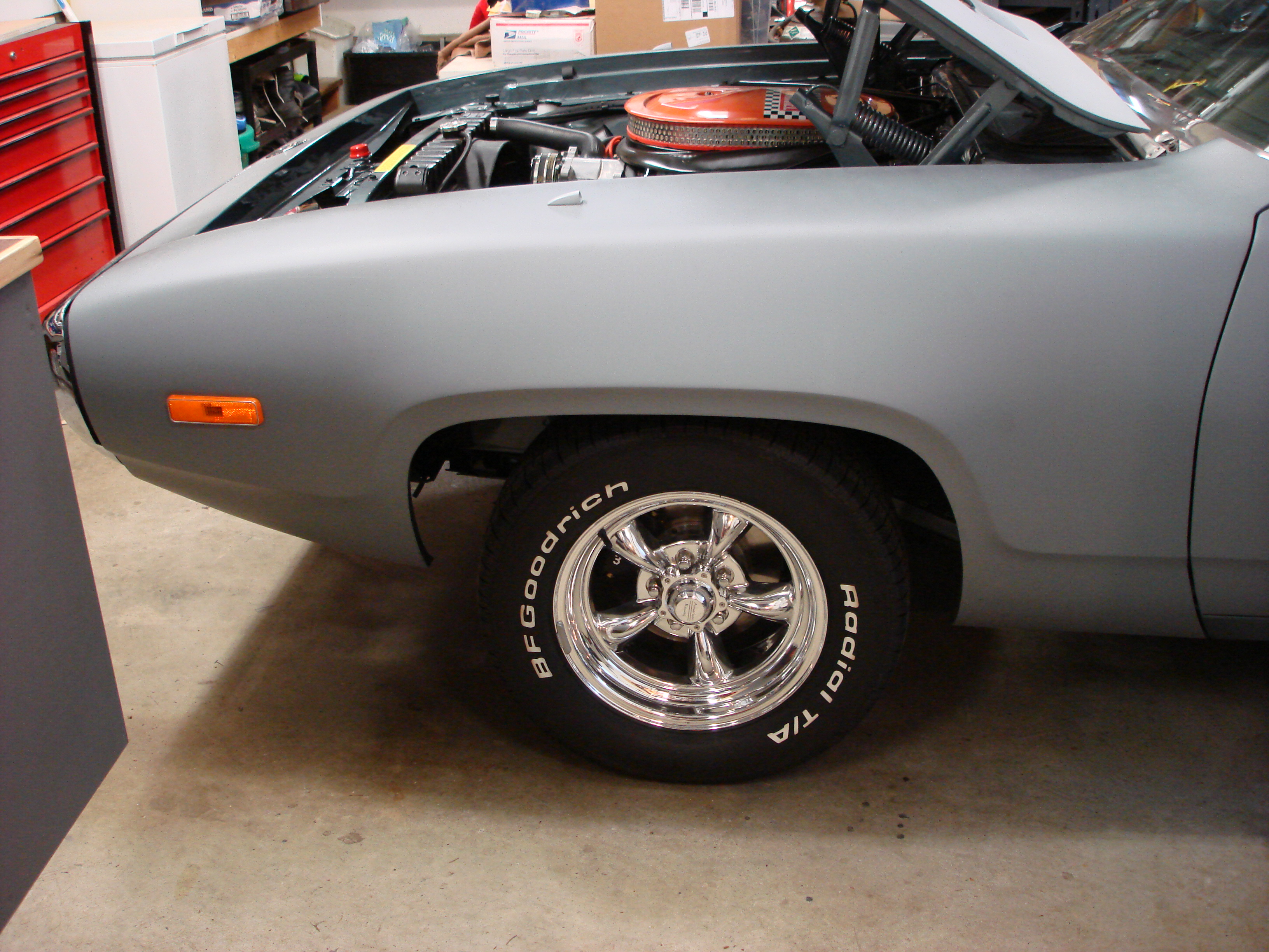

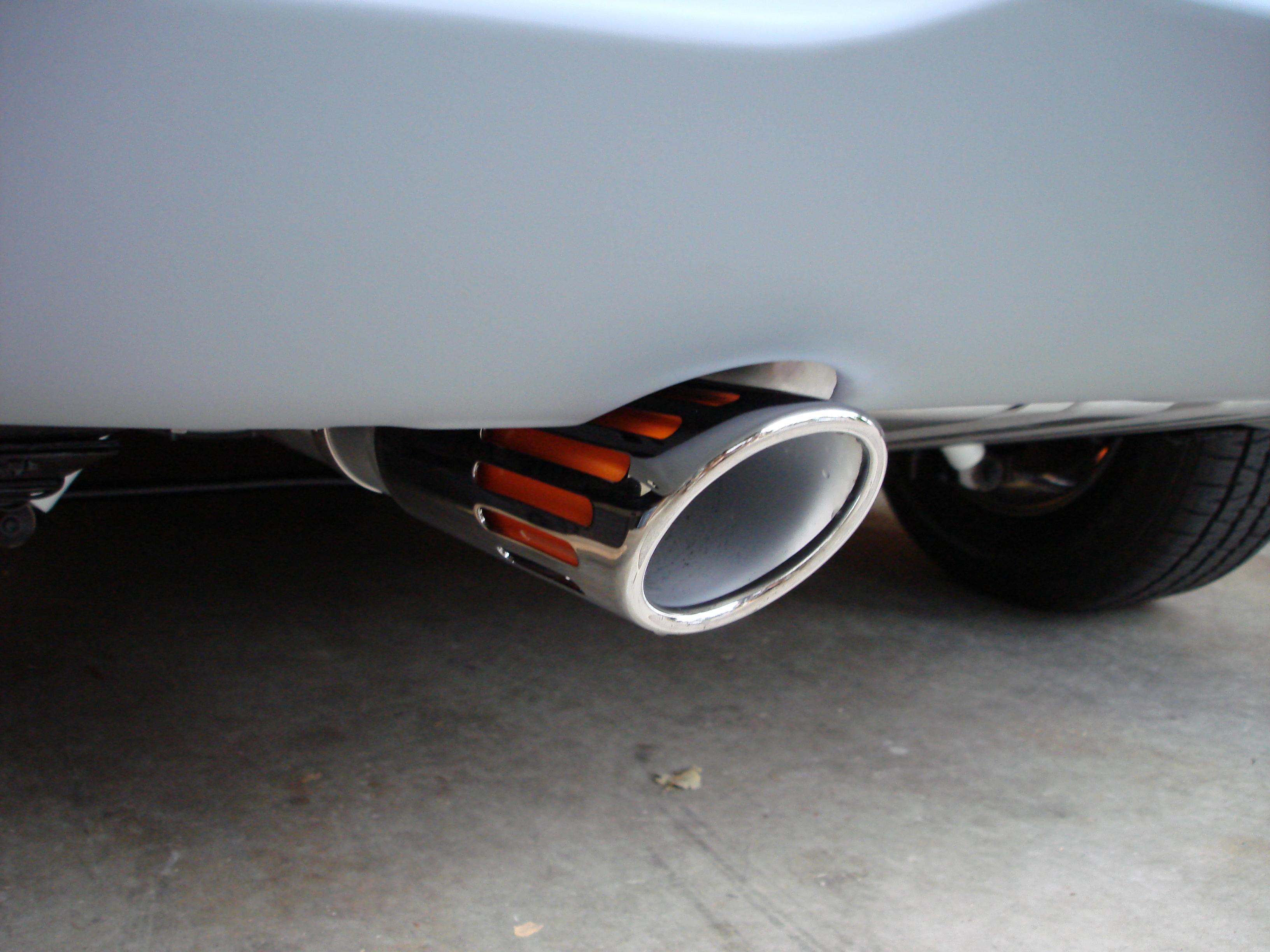

Post by 72RoadRunnerGTX » Sat Aug 09, 2008 8:56 pm
Last body panel in place with the TTI exhaust tips fitted.
4" offset 15x7" Torque thrust II arrived finally.
Last edited by 72RoadRunnerGTX on Sun Apr 10, 2022 10:44 pm, edited 5 times in total.

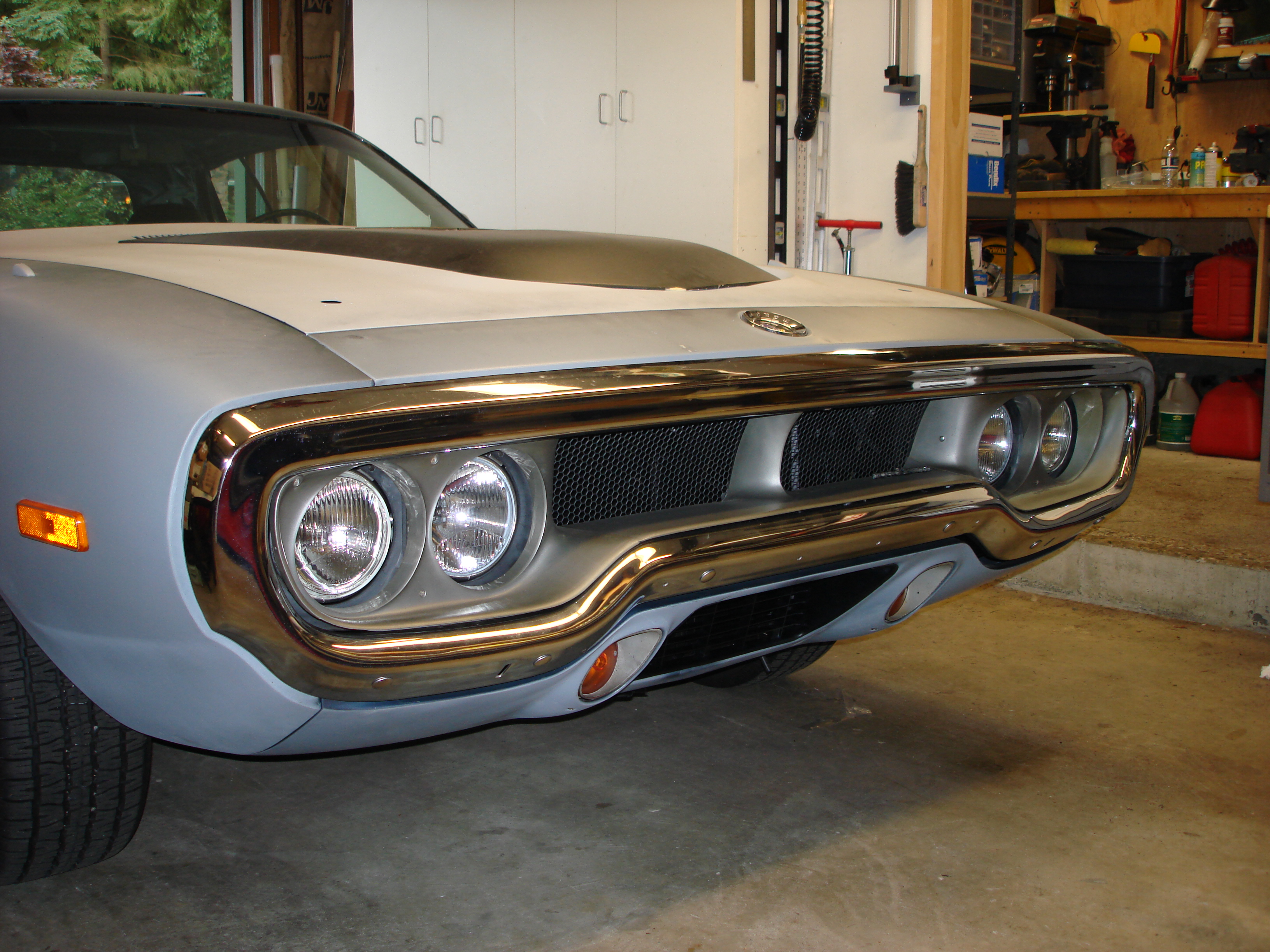

Post by 72RoadRunnerGTX » Thu Aug 21, 2008 9:34 pm
Well it sounds like I'm not going to get N96RR1972's 72' grille parts so I guess I'll have to make do with what I have.

N96RR1972
Posts: 76
Post by N96RR1972 » Fri Aug 22, 2008 4:52 am
why? ... Whats wrong with the ones you have? .. :)
