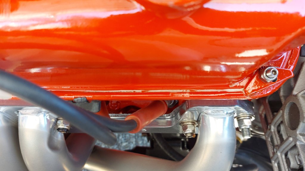

So since August I've had the car out (when the weather has been good) and put about 300 miles on it.
Yesterday that came to a grinding halt... :shock:
Out in the car yesterday with my wife - we were going for ice cream and I noticed while driving in the rear view mirror I was crop dusting behind me.
I wasn't too concerned as I had the rear of the oil pan seal leaking and throwing oil onto the header collector.
What I didn't realize at first that the smoke was not blue but white in color.....
It wasn't until I pulled over and had a look under the hood and heard sizzling noises coming from the engine.
WTF?

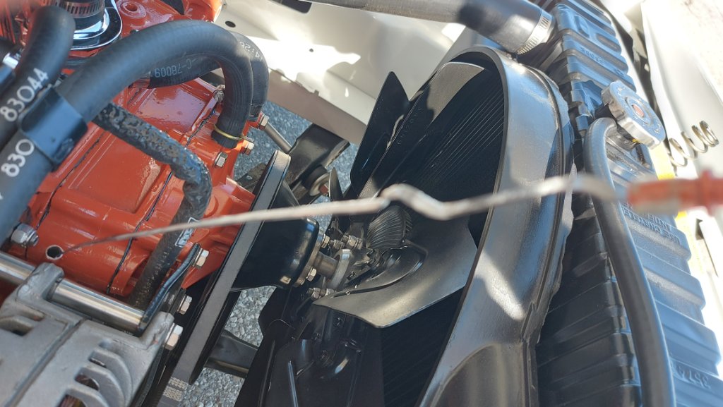

I pull the dipstick to find this..
Oct 5th (3).jpg (115.43 KiB) Viewed 161517 times

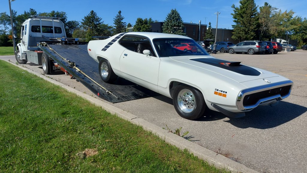

My day is done....call CAA.

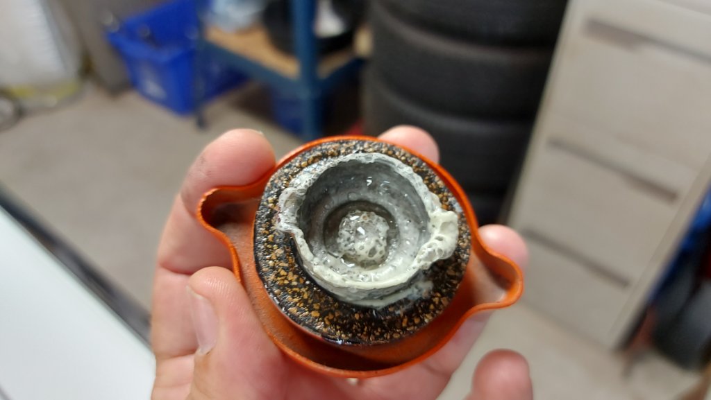

Get it home and back into the garage - open up the oil cap..... :mad:
Oct 5th (10).jpg (64.65 KiB) Viewed 161517 times

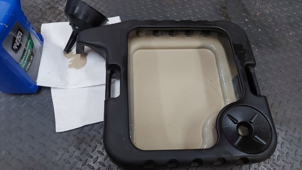

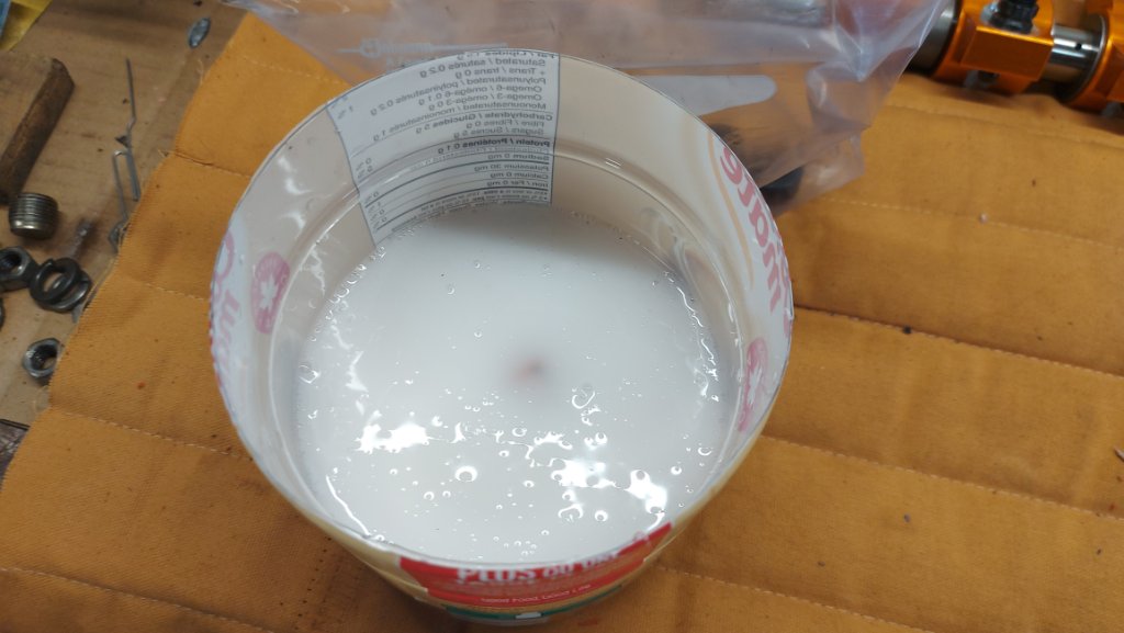

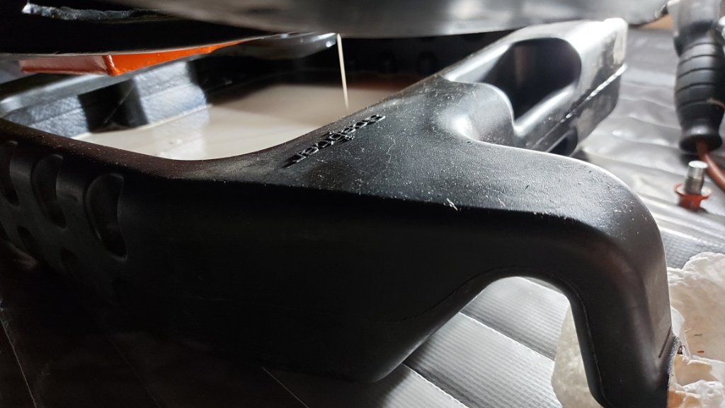

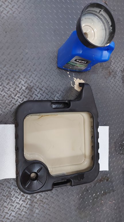

First thing is to see how much water actually got into the crankcase. So lets drain the drain bucket.
Oct 27 (2).jpg (68.13 KiB) Viewed 161008 times
Oct 27 (3).jpg (54.85 KiB) Viewed 161008 times

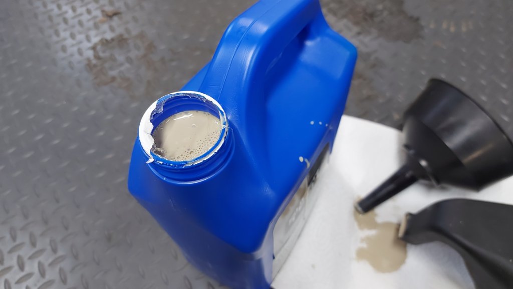

BTW I did buy Walmart's cheapest oil and put it in. The plan is to pull the distributor and intermediate shaft and use my priming tool to flush out the rest of the milkshake crap with clean oil before I pull the heads.
Oct 27 (5).jpg (89.37 KiB) Viewed 161008 times
Not as much water as I thought. I had 5 litres of the Lucas Hot Rod oil in it when it happened. I put back into the Walmart oil container that same amount but there was a skim of milkshake still in the drain pan.

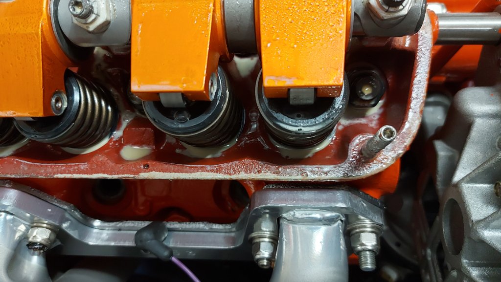

Next on the list, pull the valve cover - passenger side first.... :shock:
Oct 27 (12).jpg (125.75 KiB) Viewed 161008 times
Posts: 746
Post by 71Beeper » Sun Dec 08, 2024 4:08 pm
Well, a bit of time has gone by. There was a period of time where I didn't want to look at the car as I was just deflated over what had happened.
But pick myself up and get my ass back in the garage to figure out what happened.
So, lets dig into the engine.

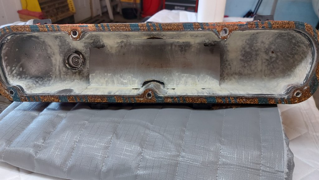

Off with the valve covers.
Oct 27 (13).jpg (134.21 KiB) Viewed 160113 times
Oct 27 (14).jpg (118.51 KiB) Viewed 160113 times
mmmmm - milkshake.

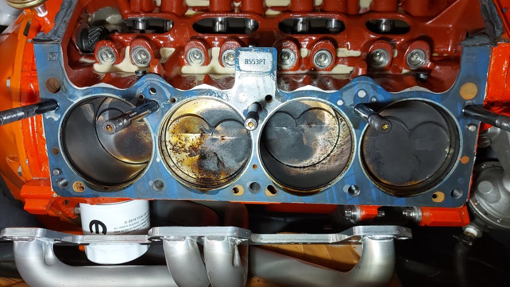

Next, pull the intake.

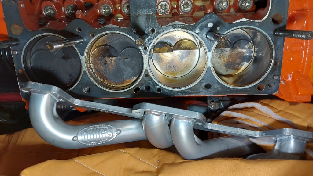

Now the passenger head.
November 17th (8).jpg (151.01 KiB) Viewed 160113 times

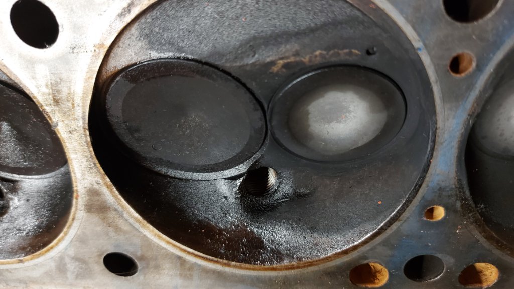

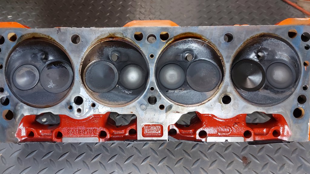

Hmmm, some clean spots in cylinders 3 & 5.
Underside of head doesn't look bad and the head gasket isn't damaged.
November 17th (12).jpg (139.78 KiB) Viewed 160113 times

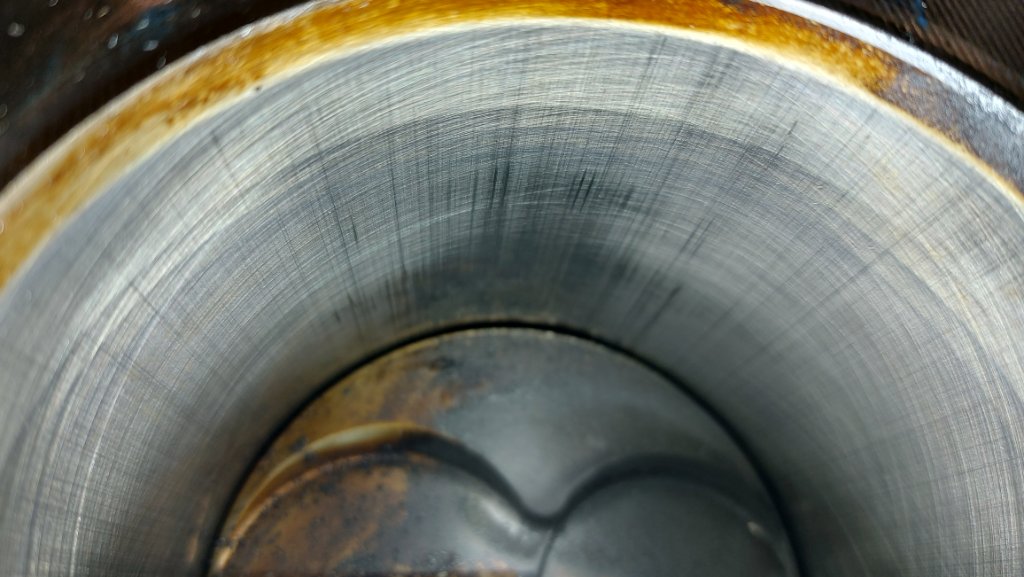

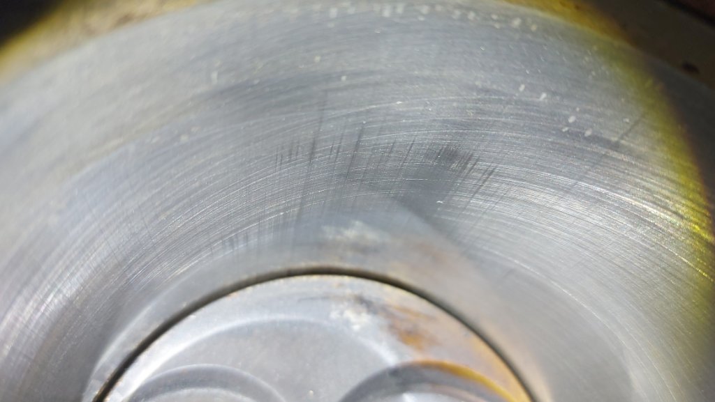

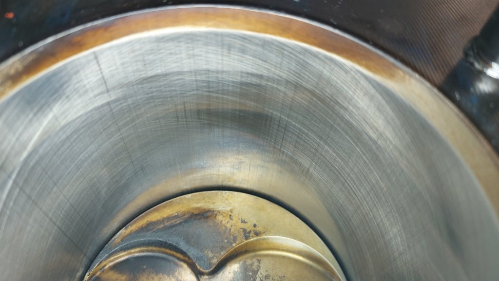

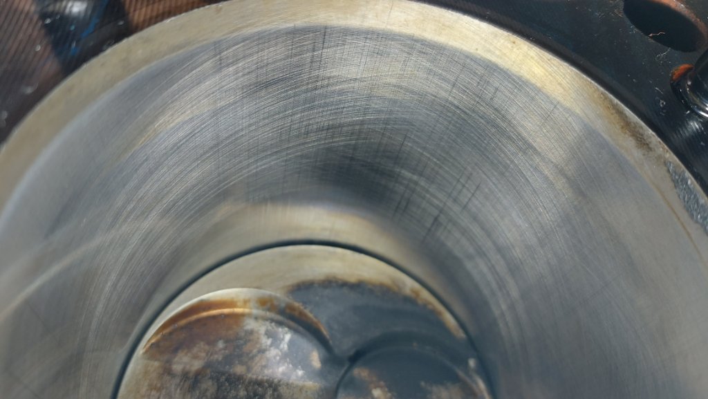

So next order of business is to inspect the bores for any damage.
Cylinder #1
Cyl #1.jpg (73.26 KiB) Viewed 160110 times
Cylinder #3
Cyl #3.jpg (98.25 KiB) Viewed 160110 times
Cylinder #5
Cyl #5.jpg (84.79 KiB) Viewed 160110 times
Cylinder #7
Cyl #7.jpg (87.51 KiB) Viewed 160110 times
Posts: 746
Post by 71Beeper » Sun Dec 08, 2024 4:48 pm
No signs of any cylinder damage.

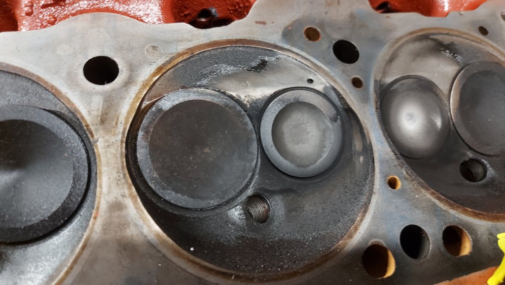

Next, pull the drivers side head.
November 17th (17).jpg (127.29 KiB) Viewed 160110 times
Looks cleaner in cylinder #6.
I checked the bores - they are the same as the passenger side with no damage.

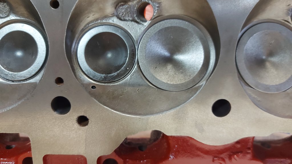

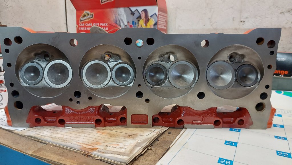

So, I took the heads up to my engine guy (the same place that did the dyno work).
No sooner did I unload the heads from the trunk of my car and carry them in and put them on the bench does he find the issue.... :mad:
December 6th (1).jpg (108.58 KiB) Viewed 160110 times
December 6th (2).jpg (109.36 KiB) Viewed 160110 times
And this is before any pressure testing or magnafluxing has been done, which he will still do.

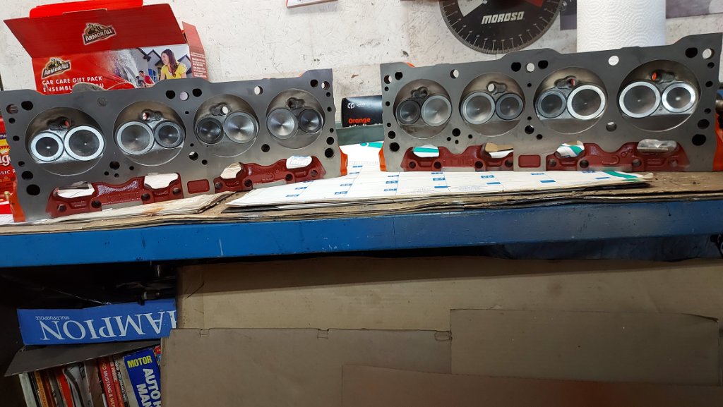

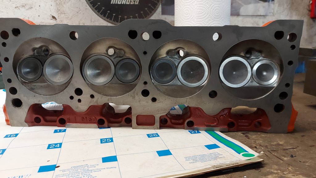

Well...last weekend I went and picked up the heads.
I get there and Al pulls back the shrink wrap one the head with the hole and I see the hole hasn't been fixed.
I said to Al WTF??? :shock:
He says that hole doesn't go anywhere - its not a thru hole.
He did pressure test them and the test was good.
He did say that the head gasket surface was warped and he took off .005" to clean them up.
He replaced the exhaust valve with the crack in it and cleaned up the chambers and installed the inner valve springs I removed when I broke the engine in the car.
Feb 23rd (1).jpg (113.59 KiB) Viewed 152361 times
Feb 23rd (2).jpg (106.7 KiB) Viewed 152361 times
Feb 23rd (3).jpg (115.91 KiB) Viewed 152361 times
Feb 23rd (4).jpg (91.92 KiB) Viewed 152361 times

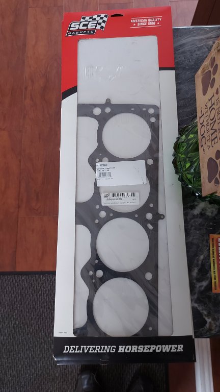

He did get me these MLS head gaskets - I thought they were going to be Cosmetics.
Feb 23rd (5).jpg (54.34 KiB) Viewed 152361 times

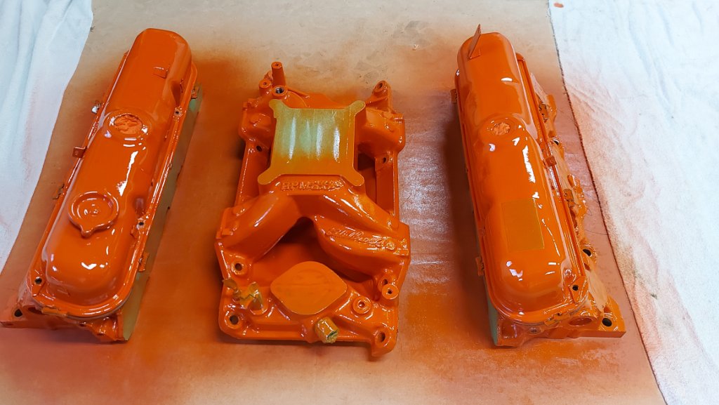

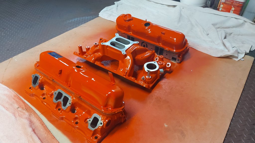

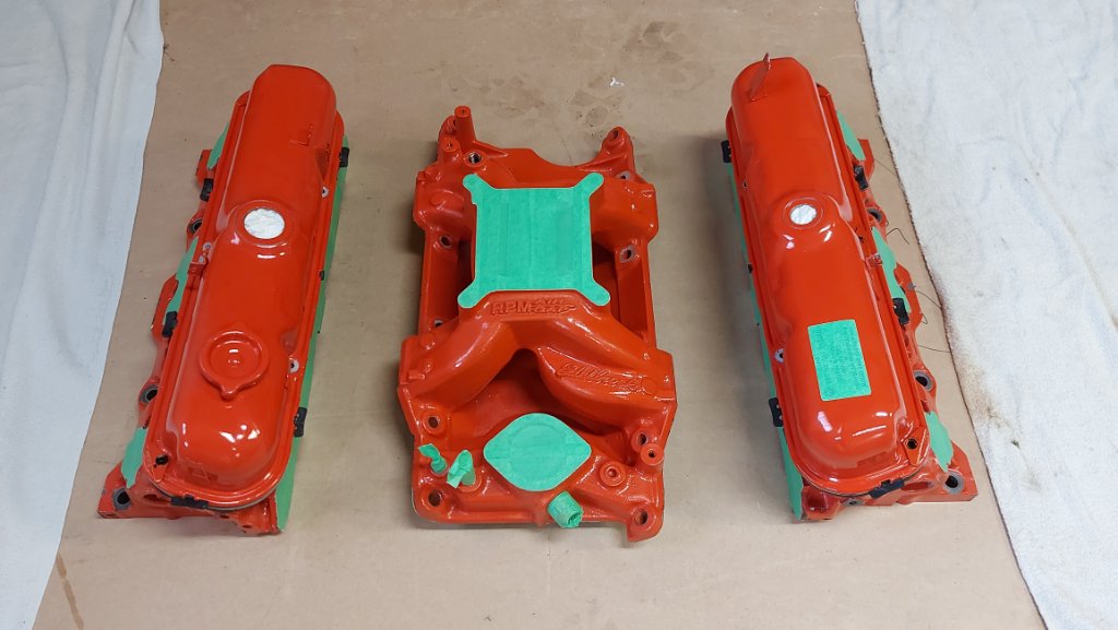

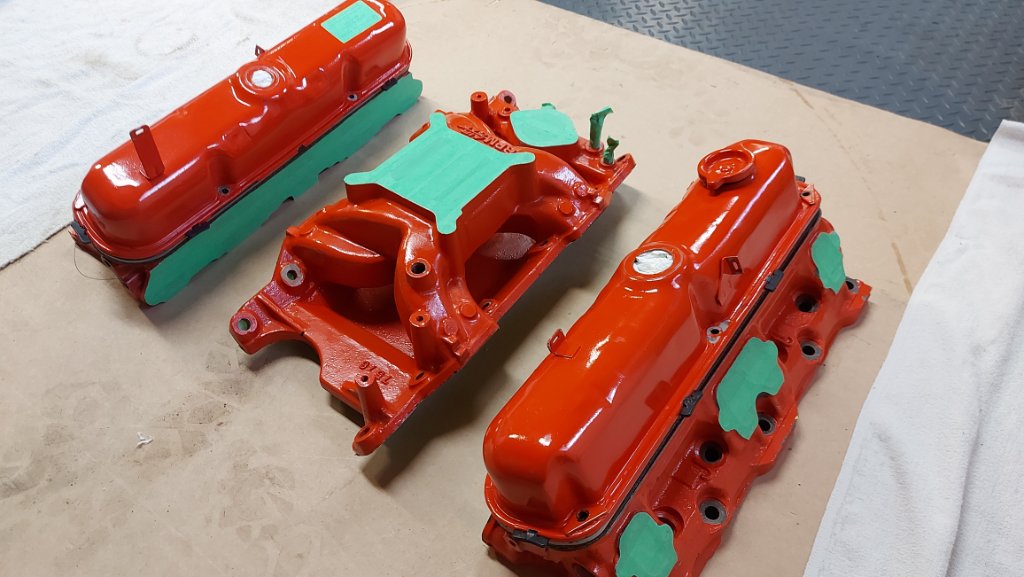

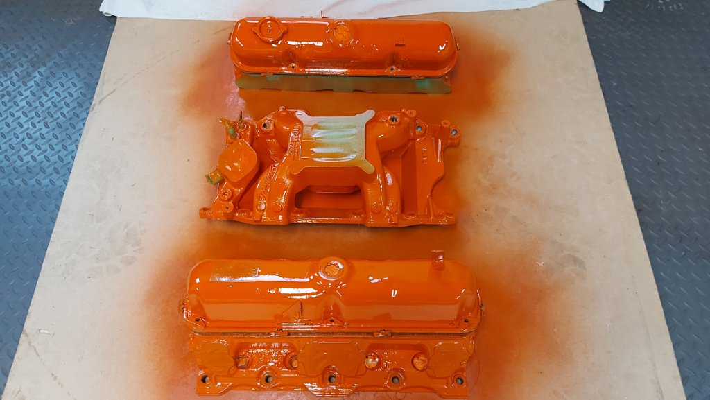

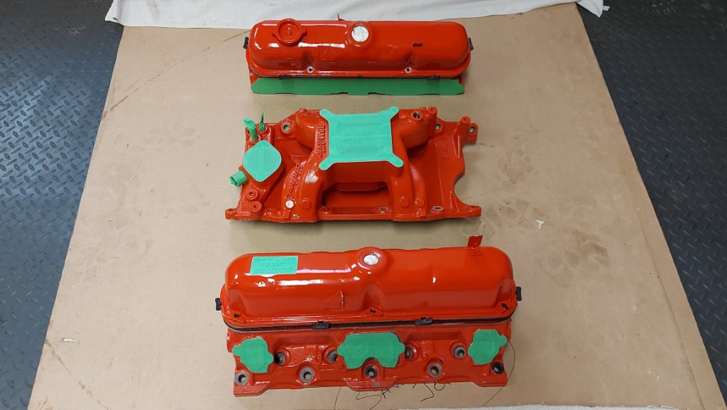

With the weather still a bit too chilly to spread silicone I prepped and painted up some parts to get them ready.
Here they are masked and ready for paint.
March 22 (3).jpg (87.47 KiB) Viewed 8831 times
March 22 (2).jpg (89.37 KiB) Viewed 8831 times
March 22 (5).jpg (103.58 KiB) Viewed 8831 times

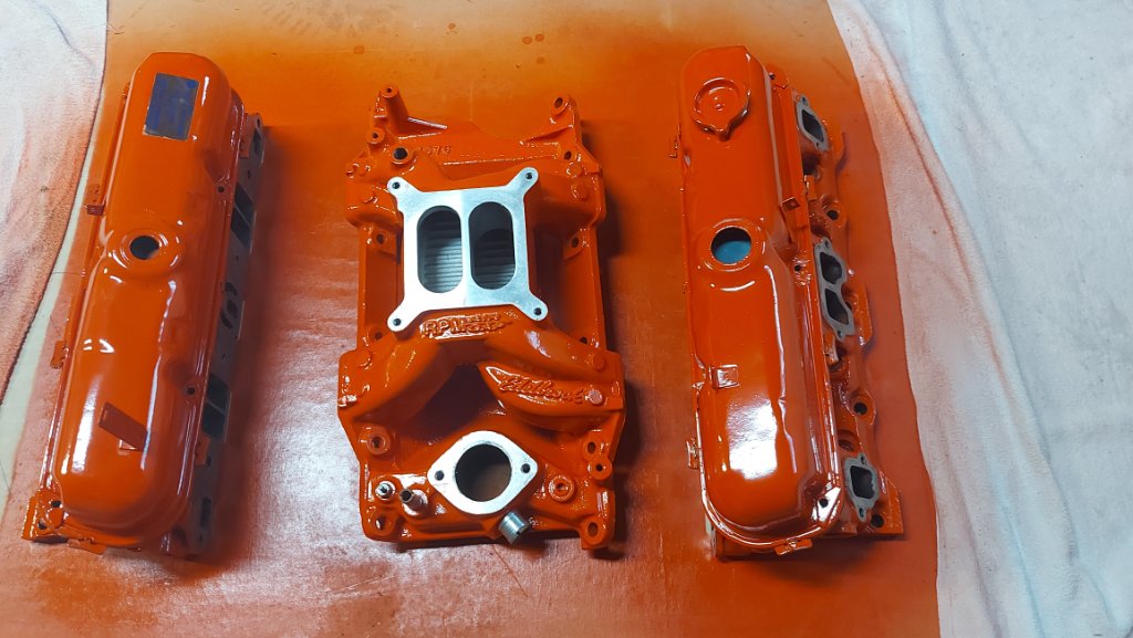

And now some paint.
March 22 (6).jpg (102.77 KiB) Viewed 8831 times
March 22 (7).jpg (91.54 KiB) Viewed 8831 times

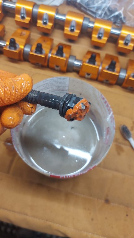

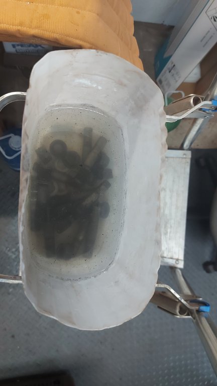

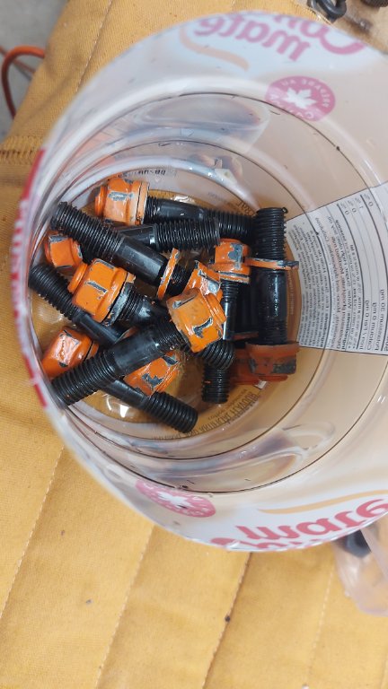

The outer head studs came out with the nuts as they had many coats of engine paint on the threads....so I soaked them in some paint stripper to get the engine paint off them.
March 30 (1).jpg (68.51 KiB) Viewed 8830 times
March 30 (2).jpg (88.92 KiB) Viewed 8830 times
March 30 (3).jpg (73.97 KiB) Viewed 8830 times
The stuff works pretty good.
April 5 (1).jpg (49.03 KiB) Viewed 8830 times
And now to neutralize the stripper with some water.
April 5 (2).jpg (40.18 KiB) Viewed 8830 times

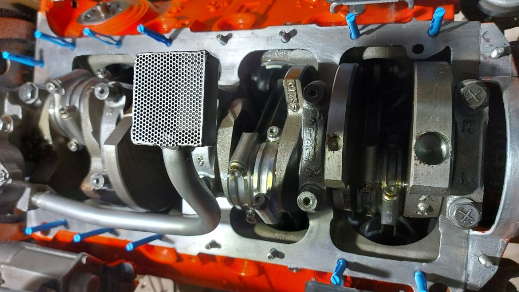

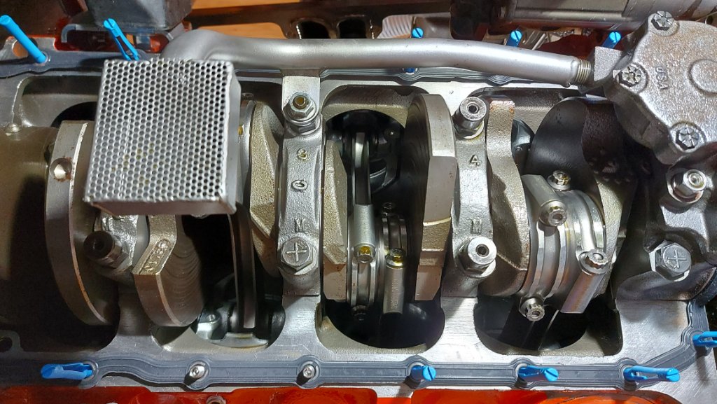

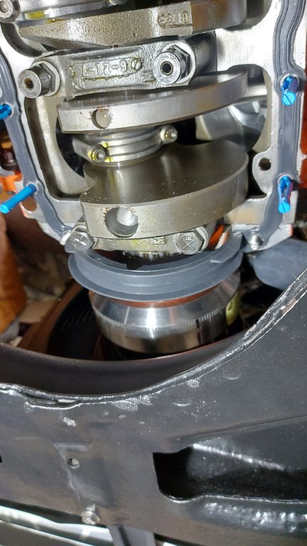

I also pre-fitted the one piece oil pan gasket to see how it will go when it comes to install it.
I installed these things first.
April 5 (13).jpg (81.13 KiB) Viewed 8830 times
April 5 (9).jpg (124.67 KiB) Viewed 8830 times
Posts: 746
Post by 71Beeper » Sun Apr 06, 2025 2:06 pm
Now install the gasket.
April 5 (10).jpg (125.1 KiB) Viewed 8830 times
April 5 (11).jpg (150.73 KiB) Viewed 8830 times
April 5 (12).jpg (76.06 KiB) Viewed 8830 times
Not too bad. Hopefully the job will go smooth once its time to spread some sealant.

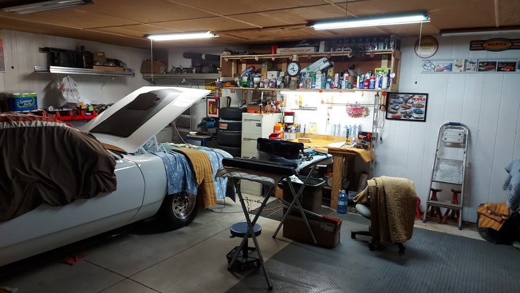

So I finally got a chance to get back in the garage to finish putting the car back together.
May 2nd & 3rd (1).jpg (117.64 KiB) Viewed 1643 times
Now to button up the engine and get it running.

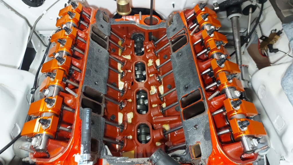

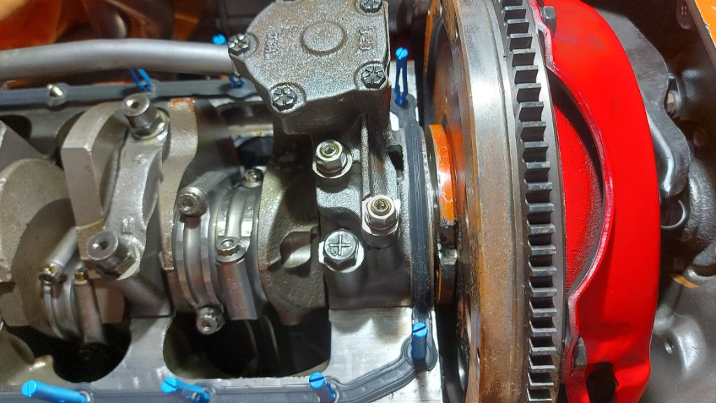

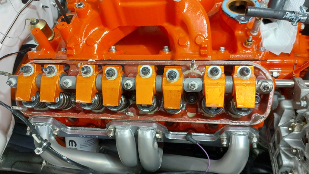

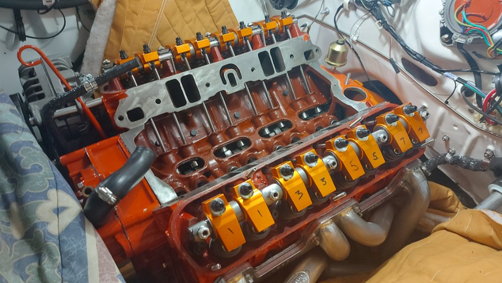

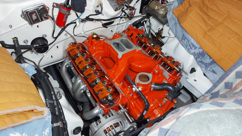

First, put the heads on along with the rocker shafts and rockers.
April 29th (1).jpg (139.08 KiB) Viewed 1643 times
April 29th (2).jpg (143.35 KiB) Viewed 1643 times

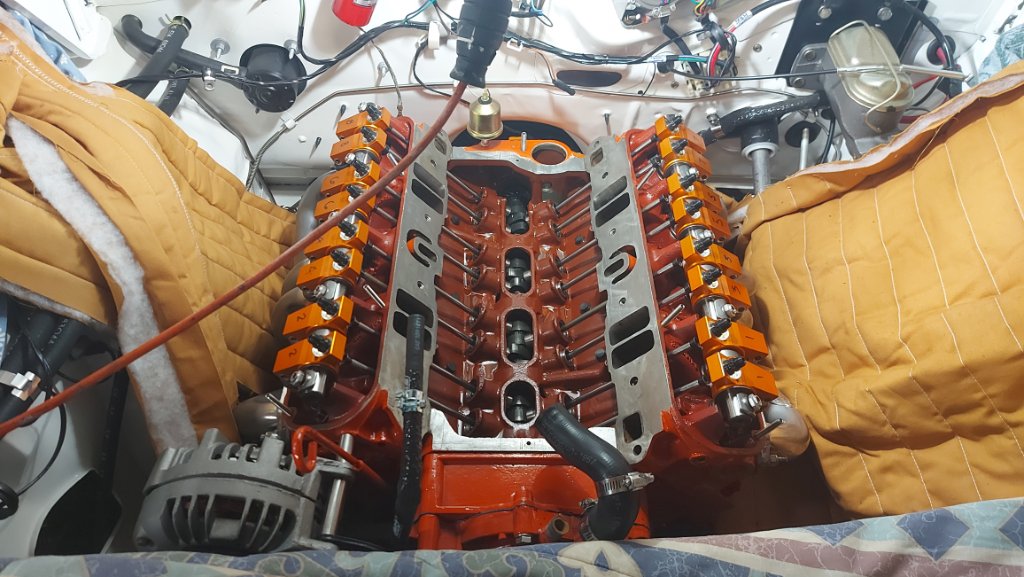

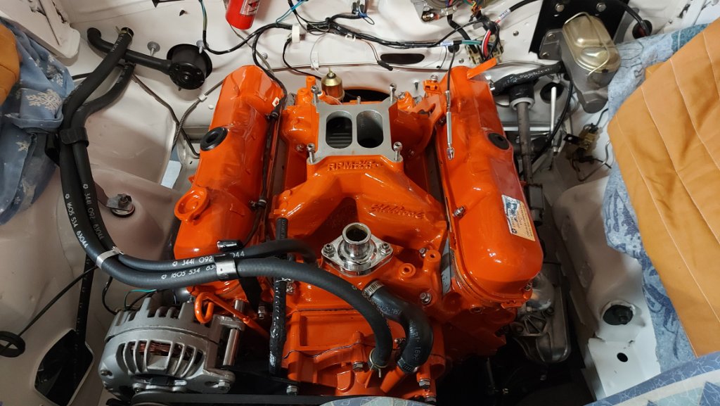

Then all the other little bits and pieces and get her fired up.
So far so good - I did take it for a shakedown run & everything is good.
Now to finally get some miles on it and (fingers crossed) no more bad things happen to her and I can finally enjoy it!
May 2nd & 3rd (4).jpg (151.47 KiB) Viewed 1643 times
May 2nd & 3rd (5).jpg (125.86 KiB) Viewed 1643 times

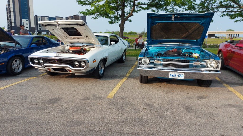

Took her out to a local cruze night. Parked next to my buddy who owns the 69 Dart ragtop.
It was a good night - no issues to report.
