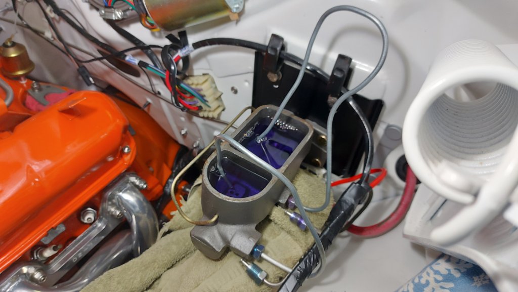

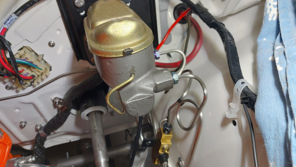

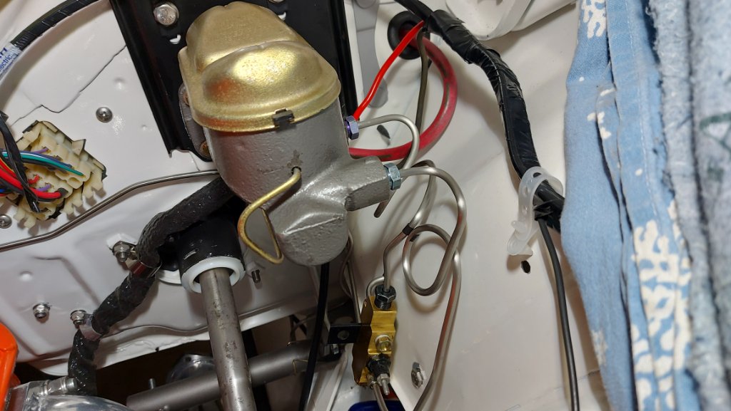

Since everything is new (master cylinder and new stainless brake lines) I have to bleed the master first.
So. make up some lines to loop back into the master, like so..
- Feb 26th (1).jpg (97.07 KiB) Viewed 19976 times
Now attach the proper lines and fill with DOT5 and start bleeding the system.

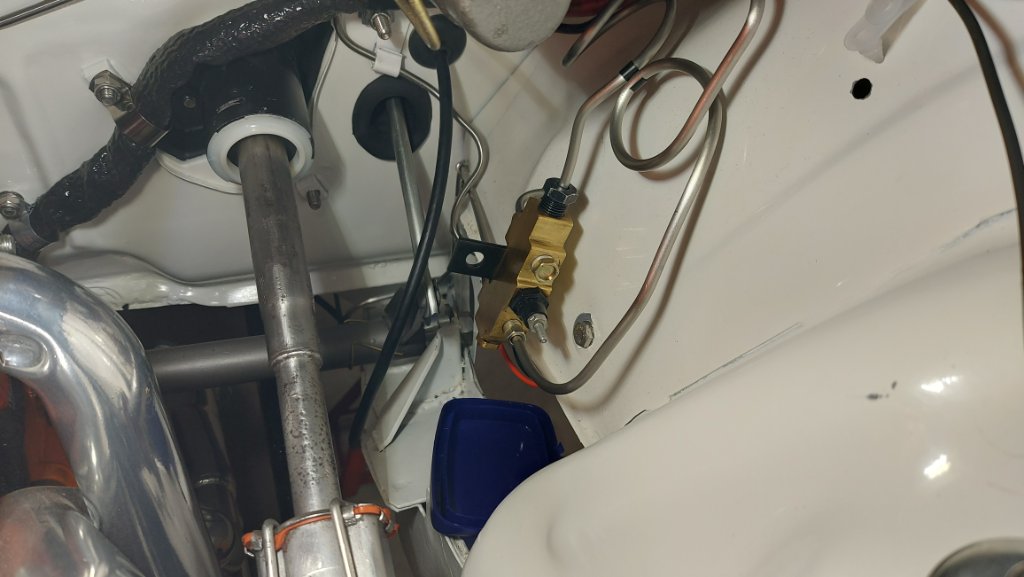

Well no sooner than I get started that I have a major FAIL!....
My line-loc is leaking. So I figure I just need to snug up the fittings......nope, still leaks.
Now I have my clean catch can getting as much of the DOT5 as possible cause this stuff is $$$$.
So I get my eyeballs right up to the unit for a closer look - it's leaking out of the main body near the bottom.
How can that be??? the cannister is a one piece matched unit.

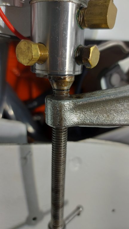

So I get my c-clamp and try to clamp it up to see if it stops leaking.......nope.
Here's a pic of the line-loc with c-clamp on it.
- Feb 26th (3).jpg (54.2 KiB) Viewed 19976 times
And here - the small horizontal slot just above where the clamp is sitting is where it is leaking from...
- Feb 26th (4).jpg (45.53 KiB) Viewed 19976 times
So. I'm frustrated and done for the day. Go in the house and order up another line-loc.
