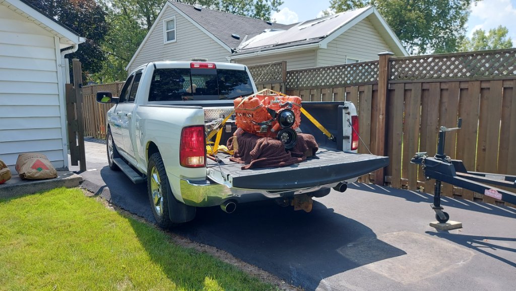

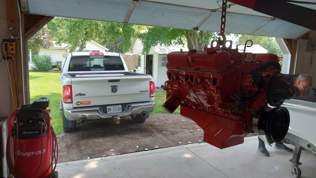

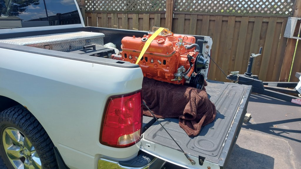

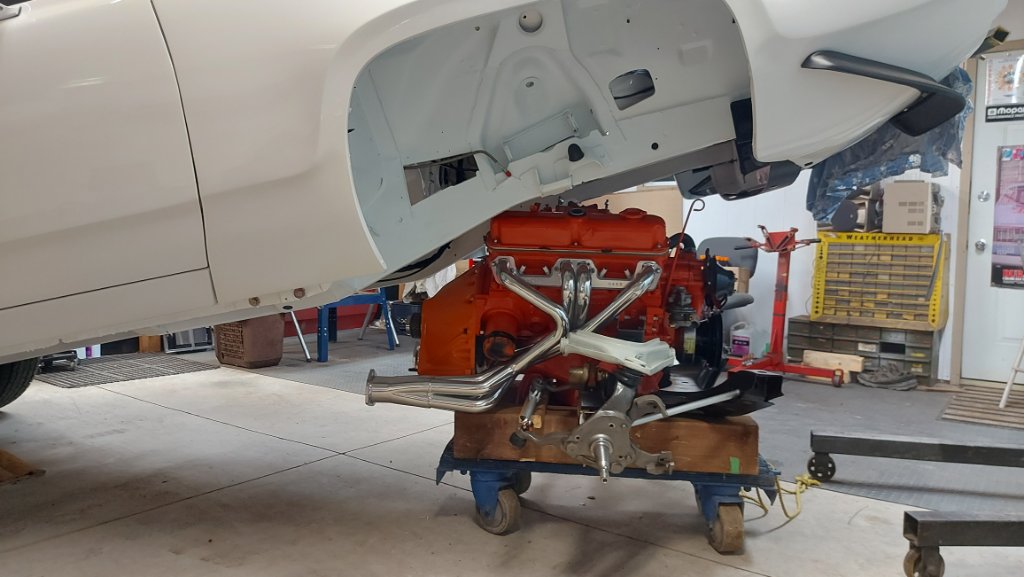

Took another big step today.
With the help of my neighbor who has a truck, we were able to get the engine loaded onto the back of it....
July 23rd (1).jpg (158.69 KiB) Viewed 365003 times
To take it....
July 23rd (2).jpg (130.13 KiB) Viewed 365003 times
To the other garage where the car is.

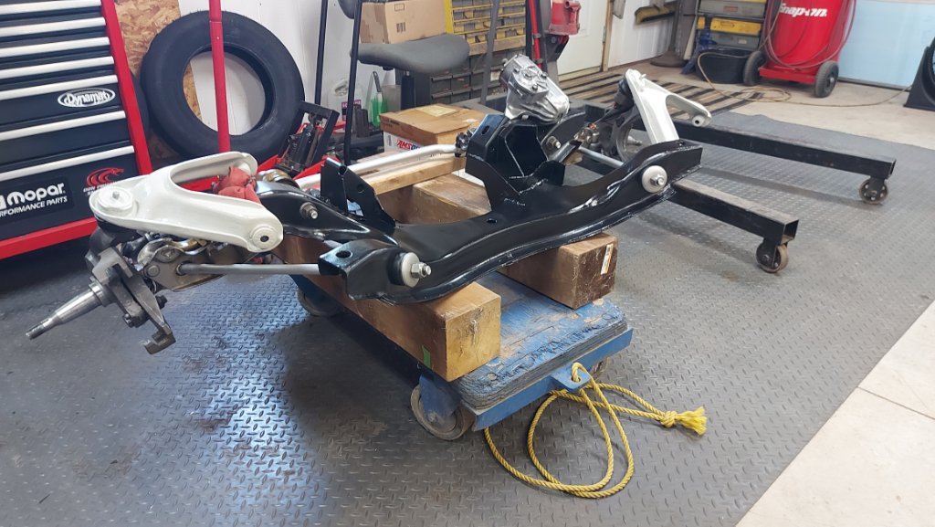

Post by 71Beeper » Fri Aug 04, 2023 4:30 pm

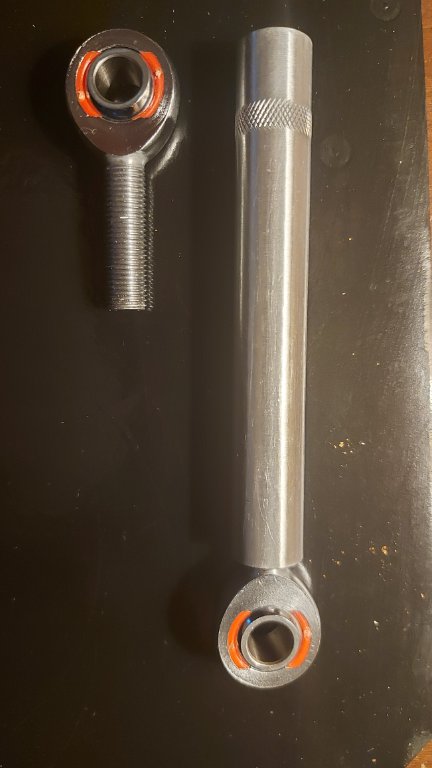

While waiting for ARP fasteners to come in, I ordered parts to make a torque strap.
Aug 4th.jpg (38.66 KiB) Viewed 364938 times
I ordered one of the heim ends with the wrong direction of threads, so I'm waiting got the proper one to come in.
Here's the fit-check.
Aug 4th (3).jpg (80.24 KiB) Viewed 364938 times
Then getting the K-member prepared.
Aug 4th (4).jpg (135.03 KiB) Viewed 364938 times

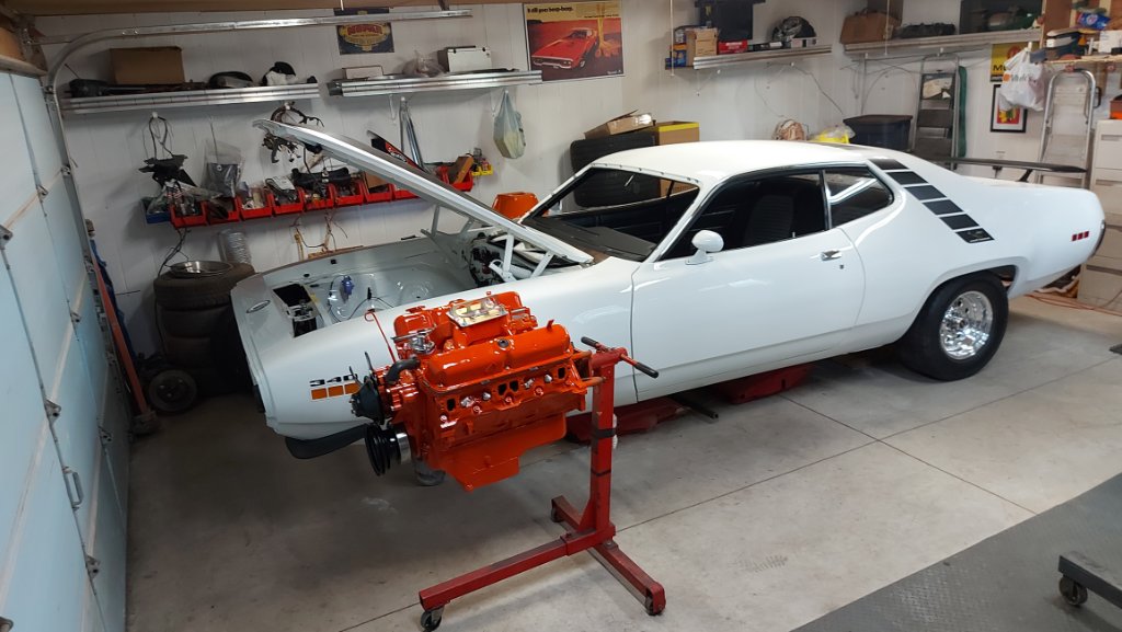

Now have the engine hover over it.

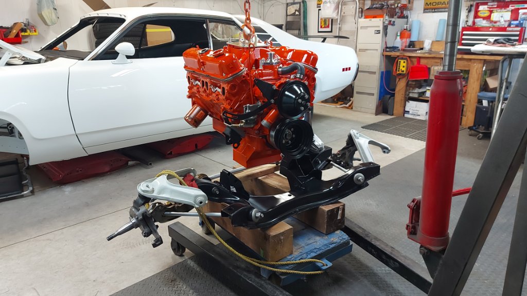

Aug 4th (7).jpg (125.17 KiB) Viewed 364938 times
Finally place it down and tighten all the fasteners.
Aug 4th (1).jpg (130.23 KiB) Viewed 364938 times

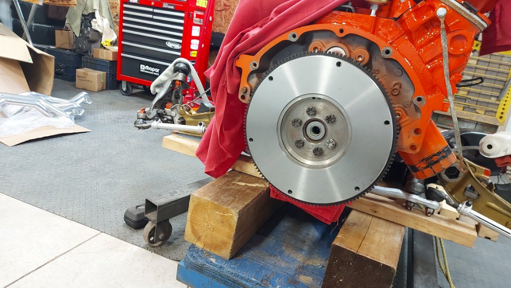

Post by 71Beeper » Sun Aug 27, 2023 7:31 pm
Thanks Gary - yes it's getting closer to being ready to lift the car and slide the engine in.

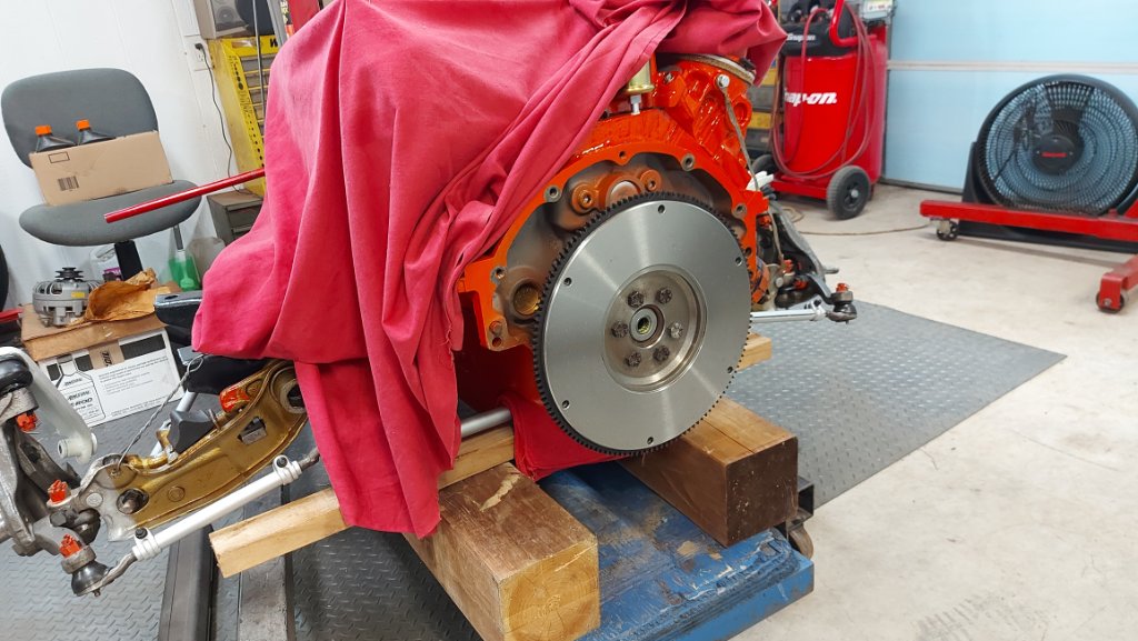

Yesterday, I had the flywheel mounted to the back of the crank.
August 26th (1).jpg (128.04 KiB) Viewed 364783 times
August 26th (2).jpg (143.54 KiB) Viewed 364783 times
I also put the break-in oil in and primed it.

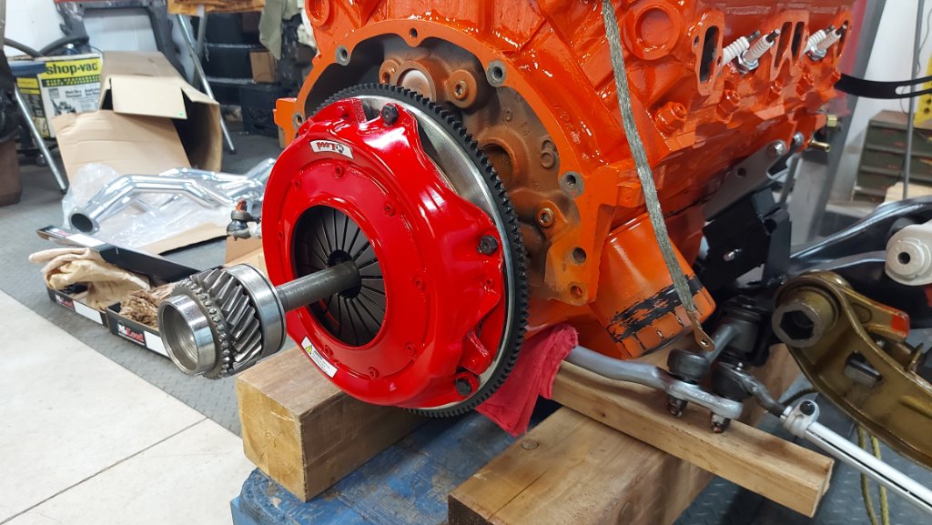

Then I got the new clutch out and ready to install.
August 26th (6).jpg (118.87 KiB) Viewed 364783 times
August 26th (7).jpg (138.44 KiB) Viewed 364783 times

Next step is to get the clutch disk and pressure plate installed.
August 26th (11).jpg (134.4 KiB) Viewed 364783 times

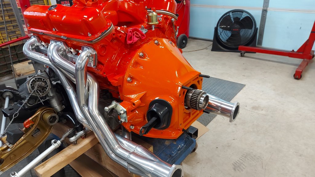

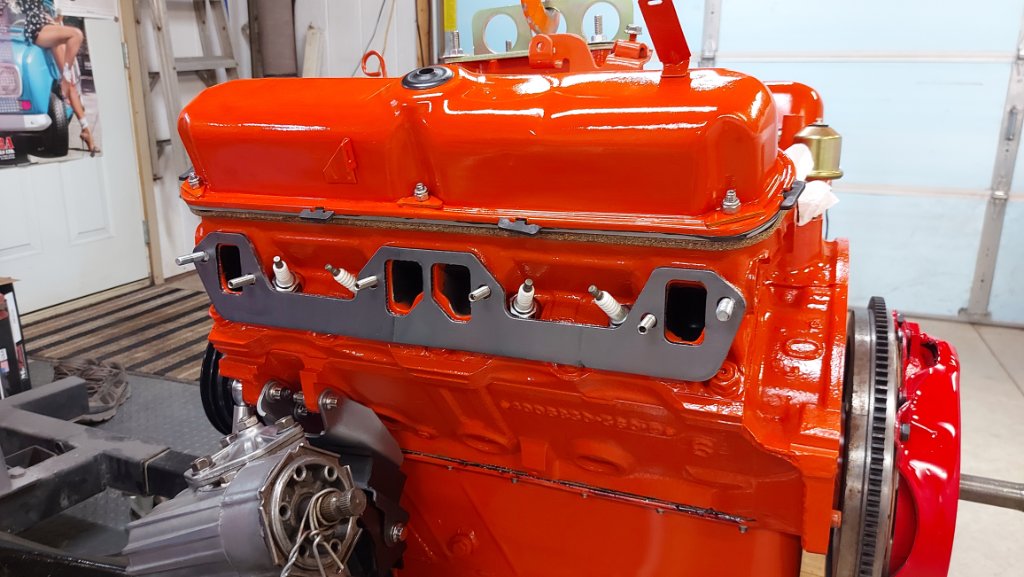

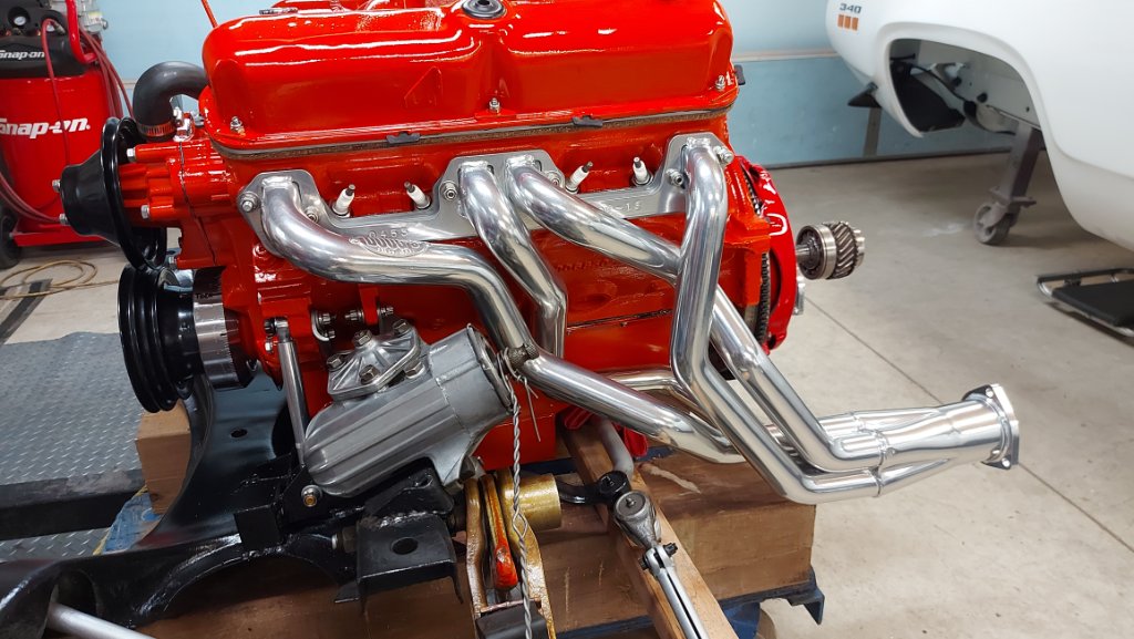

Next, its time to attach the Dougs headers. First install the Rem Flex header gaskets.
August 26th (12).jpg (117.45 KiB) Viewed 364783 times
Then, put on the bling.
August 26th (13).jpg (119.51 KiB) Viewed 364783 times
August 26th (14).jpg (130.16 KiB) Viewed 364783 times
Stupid me didn't realize that the passenger side header would not go on with the oil filter installed, so it had to come off & this AFTER I primed the oil and filled the oil filter.... :mad:
Oh well, it wasn't too bad a mess to clean up.
Lastly was to do a fit-check on the bell housing.
August 26th (16).jpg (141.45 KiB) Viewed 364783 times

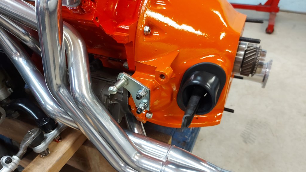

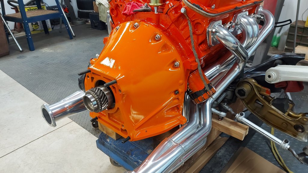

After getting all of the required fasteners for the bellhousing I was able to finally install it for good.
Sept 18th, 2023 (3).jpg (132.05 KiB) Viewed 364706 times
Sept 18th, 2023 (4).jpg (138.65 KiB) Viewed 364706 times
I had to install studs to where the 4 speed is mounted to the bellhousing as the threads were buggered up in the aluminum bellhousing, so I had to wait for fully threaded bolts to come from McMaster Carr.
Sept 18th, 2023 (2).jpg (101.48 KiB) Viewed 364706 times
Sept 18th, 2023 (3).jpg (132.07 KiB) Viewed 364706 times
and to finish off the install, make sure the starter is in.
Sept 18th, 2023 (1).jpg (74.81 KiB) Viewed 364706 times

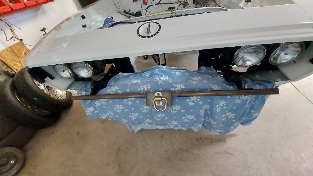

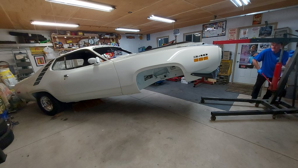

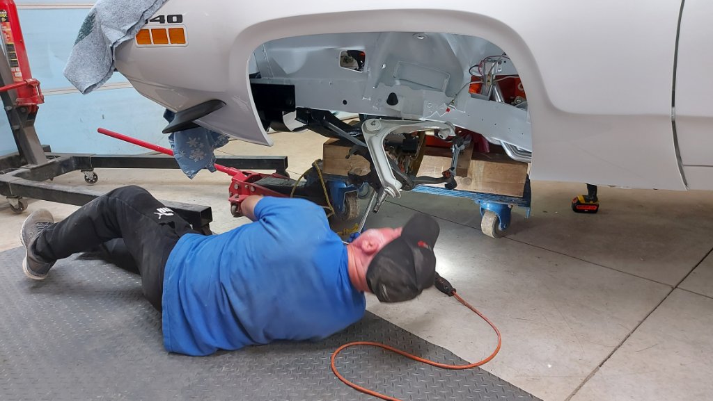

So tonight with the help of my assistant (Many Thanks Hugh) One big hurdle was cleared.
It started off by installing the lifting bar on the front of the car.
Sept 18th, 2023 (7).jpg (99.97 KiB) Viewed 364706 times
Next, getting the hoist in place.
Sept 18th, 2023 (9).jpg (106.61 KiB) Viewed 364706 times
Next step is lifting the body.
Sept 18th, 2023 (14).jpg (103.17 KiB) Viewed 364706 times
Then do a fit-check to see if we have to go any higher.
Sept 18th, 2023 (16).jpg (131.63 KiB) Viewed 364706 times
Then, maneuver the k-member to line up the mounting bolts.
Sept 18th, 2023 (24).jpg (91.58 KiB) Viewed 364706 times

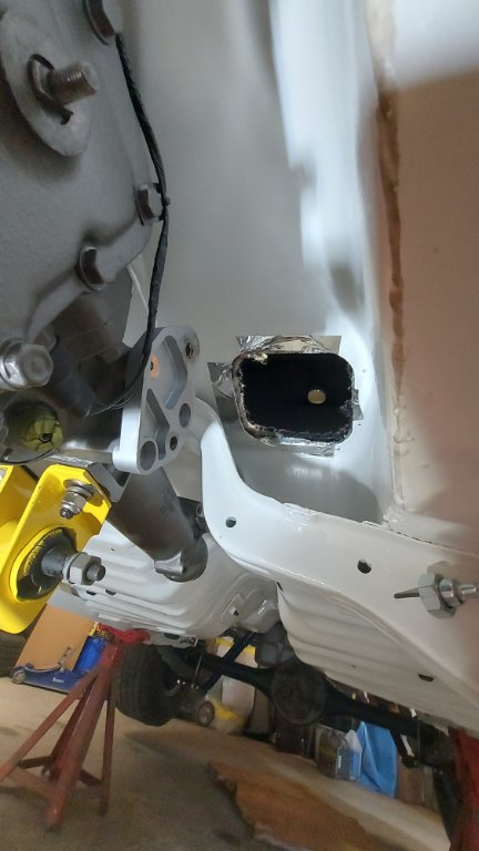

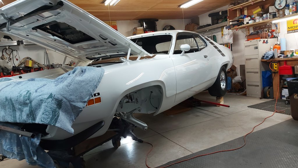

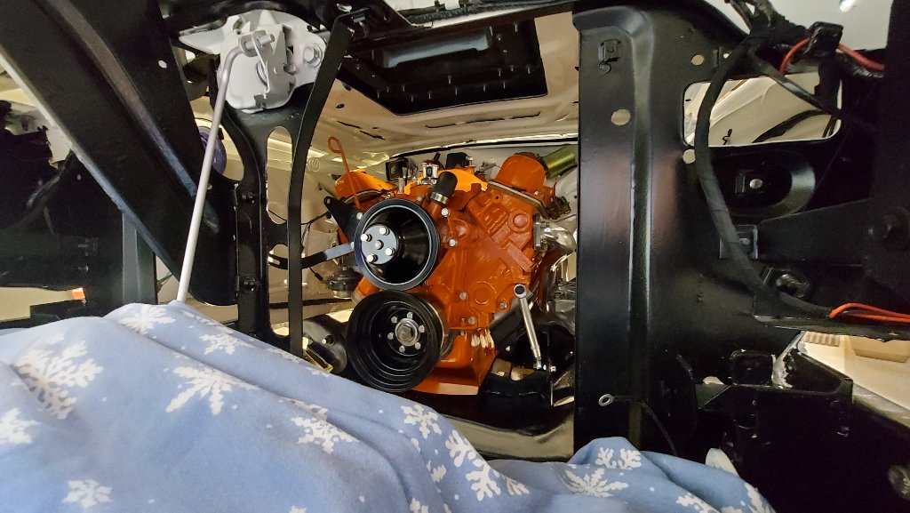

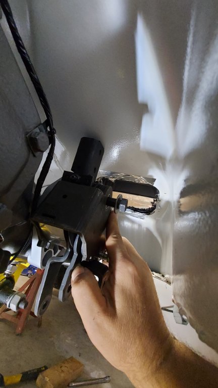

Then came the realization that the back end of the car will have to go up as the header collector was touching the underside of the floor pan.
Sept 18th, 2023 (31).jpg (121.98 KiB) Viewed 364705 times
So now that the body was more level it was time to install the k-member bolts.
Sept 18th, 2023 (32).jpg (99.82 KiB) Viewed 364705 times

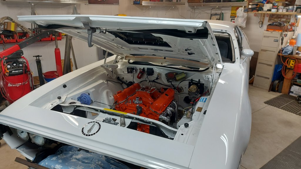

And she finally has an engine in it!!! :beer:
Sept 18th, 2023 (33).jpg (127.5 KiB) Viewed 364705 times
Sept 18th, 2023 (35).jpg (119.35 KiB) Viewed 364705 times
Sept 18th, 2023 (37).jpg (123.22 KiB) Viewed 364705 times

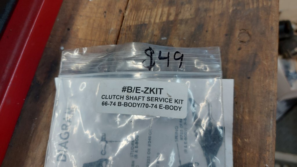

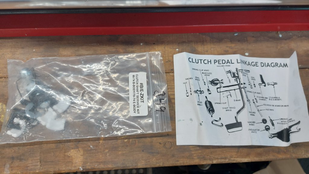

I did install the torsion bars and today I did install the Z-bar for the clutch.
I bought this kit some time ago.
Sept 24th, 2023 (1).jpg (78.7 KiB) Viewed 364642 times
Sept 24th, 2023 (2).jpg (98.73 KiB) Viewed 364642 times
But then remembered that I had this kit too.
Sept 24th, 2023 (3).jpg (123.64 KiB) Viewed 364642 times
So using the Mopar Performance kit, the Z-bar went in nicely.
Sept 24th, 2023 (4).jpg (94.53 KiB) Viewed 364642 times
Sept 24th, 2023 (5).jpg (70.27 KiB) Viewed 364642 times

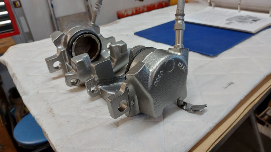

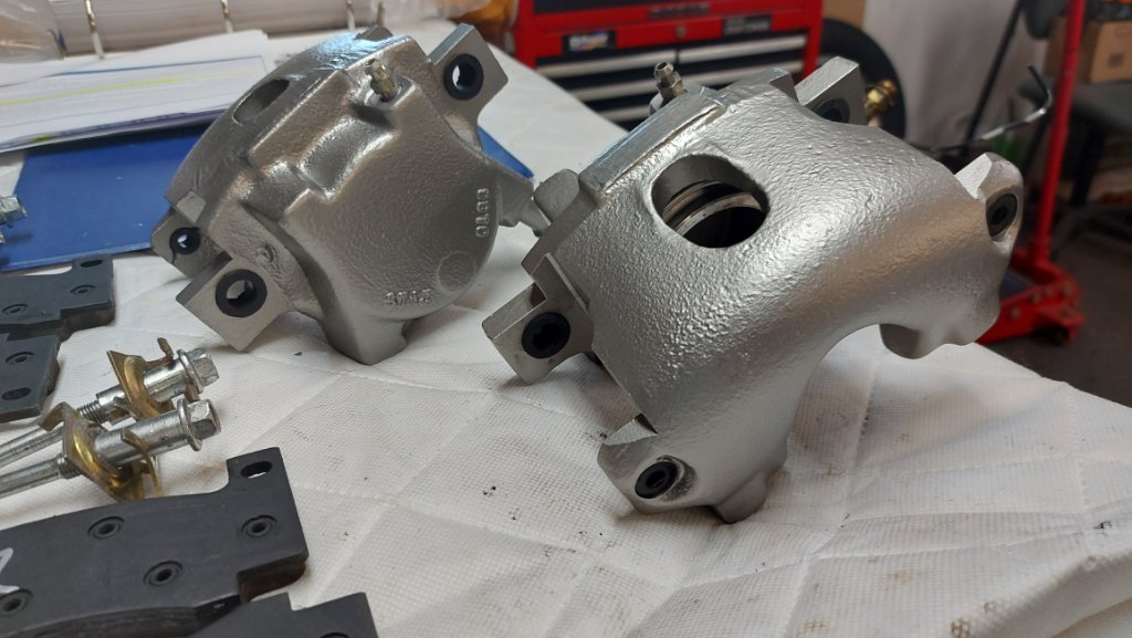

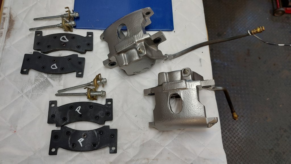

In the meantime I got to work to get the front brakes on the car.
First is to cleanup and paint the calipers.
I sprayed them with some VHT caliper paint.
Oct 1st (1).jpg (80.52 KiB) Viewed 358247 times
Oct 1st (2).jpg (80.15 KiB) Viewed 358247 times
Oct 1st (5).jpg (78.03 KiB) Viewed 358247 times
Oct 1st (7).jpg (103.54 KiB) Viewed 358247 times
Oct 1st (6).jpg (91 KiB) Viewed 358247 times

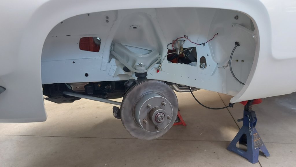

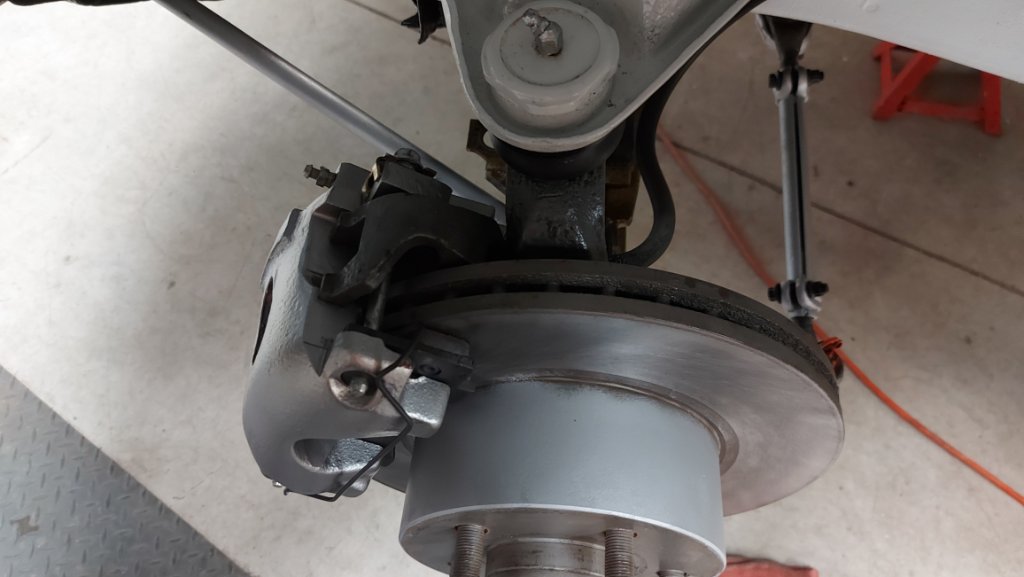

Next is to clean-up the rotors and get them mounted.
Oct 1st (8).jpg (61.47 KiB) Viewed 358247 times
Oct 1st (9).jpg (66.38 KiB) Viewed 358247 times

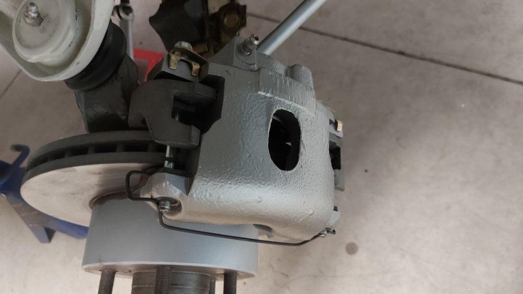

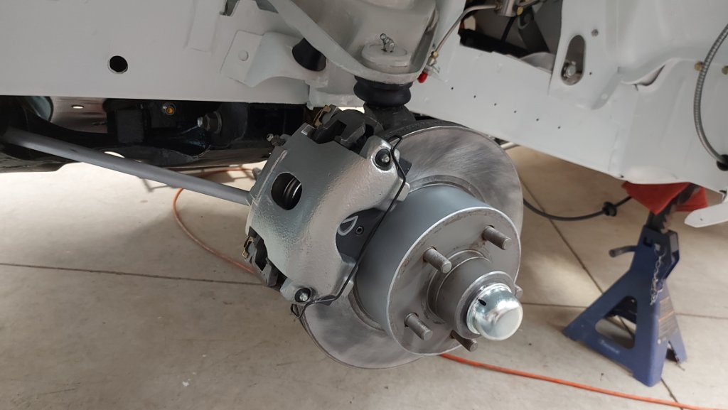

Then install the calipers and pads.
Oct 1st (10).jpg (72.96 KiB) Viewed 358247 times
Oct 1st (12).jpg (66.54 KiB) Viewed 358247 times
Oct 1st (15).jpg (59.3 KiB) Viewed 358247 times

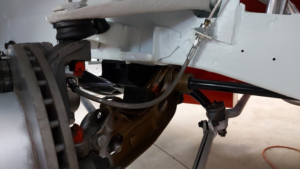

Next is to install the front flex lines.
I bought the kit from fine lines. The rear one is already installed.
Now for the front ones.
Oct 10th (1).jpg (74.83 KiB) Viewed 358246 times
Oct 10th (2).jpg (82.94 KiB) Viewed 358246 times

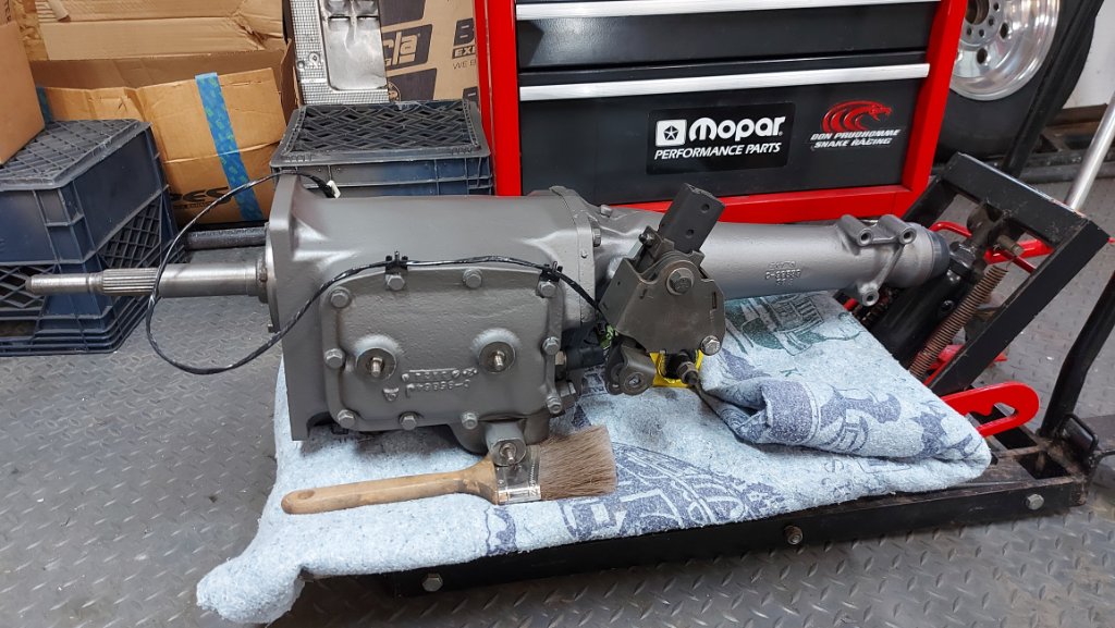

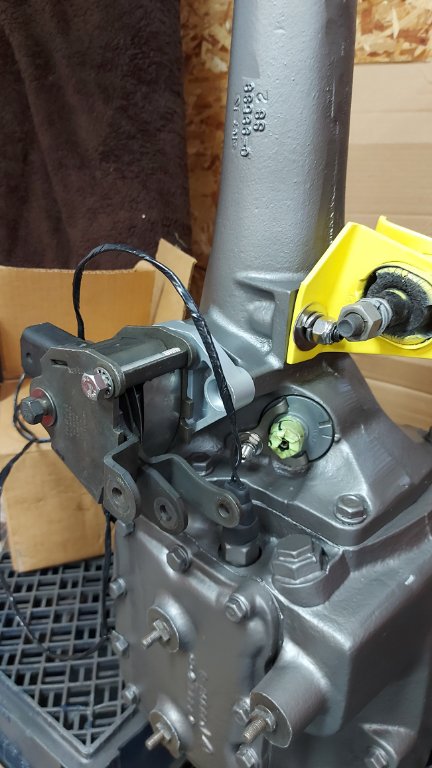

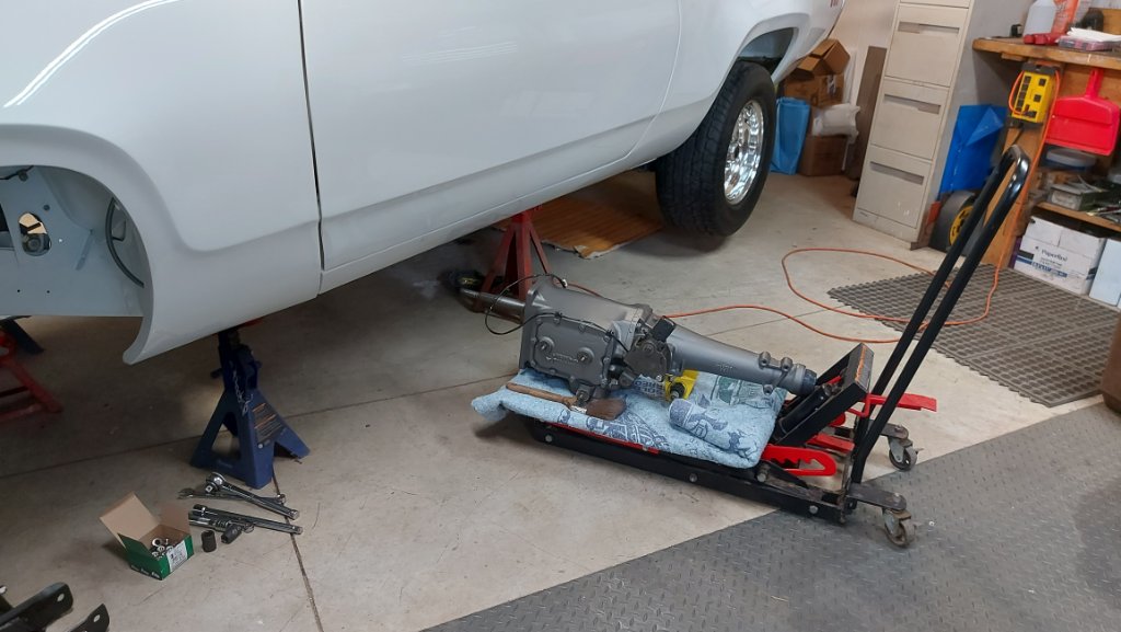

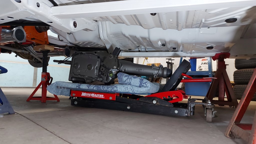

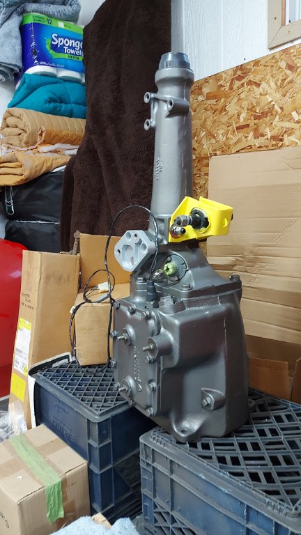

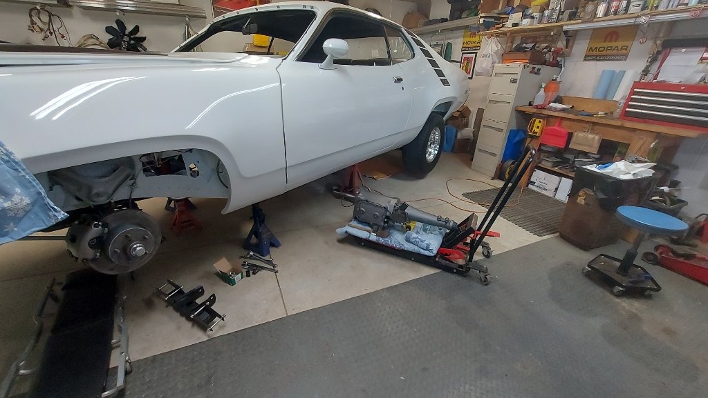

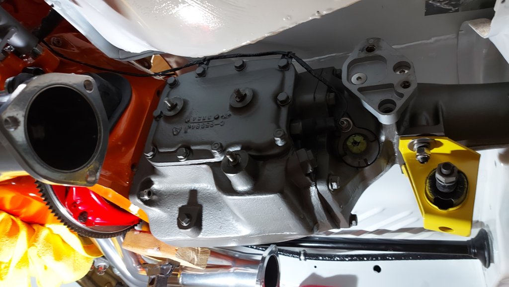

Now the really big job - getting the 4 speed ready to install.
First - mount the shifter adaptor.
Oct 14th (1).jpg (75.74 KiB) Viewed 358246 times
Oct 14th (2).jpg (81.09 KiB) Viewed 358246 times
Now the shifter box.
Oct 14th (3).jpg (67.09 KiB) Viewed 358246 times

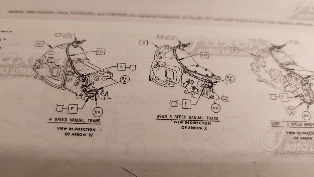

I wasn't sure how the reverse light wiring was to be routed - I assumed it went around the shifter box as shown in the last photo.
So I had a look in this book for a reference photo.
Oct 14th (4).jpg (38.66 KiB) Viewed 358246 times
Sure enough, there it is.
Oct 14th (5).jpg (73.95 KiB) Viewed 358246 times
Next, lets get the gearbox on the jack.
Oct 14th (6).jpg (137.23 KiB) Viewed 358246 times
And now lets get it under the car.
Oct 14th (8).jpg (112.86 KiB) Viewed 358246 times
Oct 14th (9).jpg (96.25 KiB) Viewed 358246 times

Get the gearbox rolled into position. I decided to remove the shifter box at this point as it would be easier to install once the transmission was in place.
Oct 14th (11).jpg (103.22 KiB) Viewed 358245 times
Now bring up the height.
Oct 14th (12).jpg (106.72 KiB) Viewed 358245 times
Slide her in and do up the fasteners and she's in!
Mind you she did fight me the whole time..... :rant:
Oct 14th (15).jpg (100.28 KiB) Viewed 358245 times
So I go to put the shifter box back in place and uh-oh....Houston we have a problem... :shock:
Oct 14th (13).jpg (50.08 KiB) Viewed 358245 times
Oct 14th (14).jpg (52.08 KiB) Viewed 358245 times
