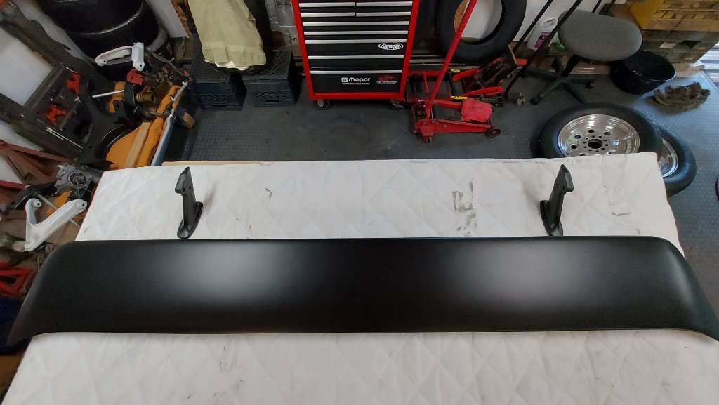

Post by 71Beeper » Sun May 28, 2023 7:42 pm

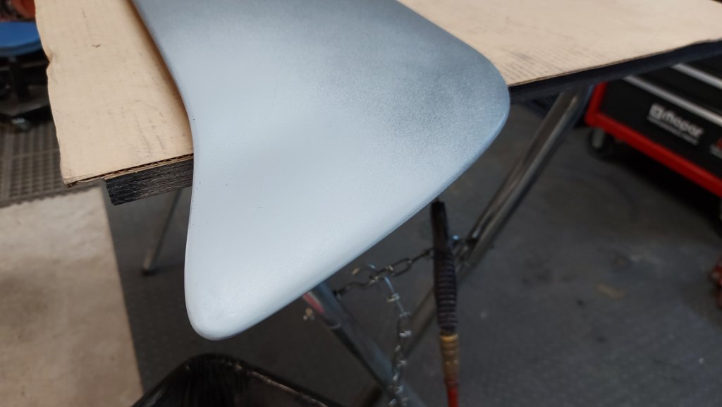

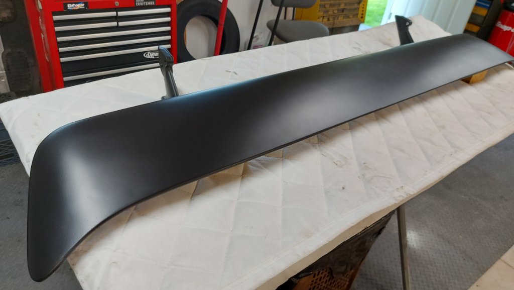

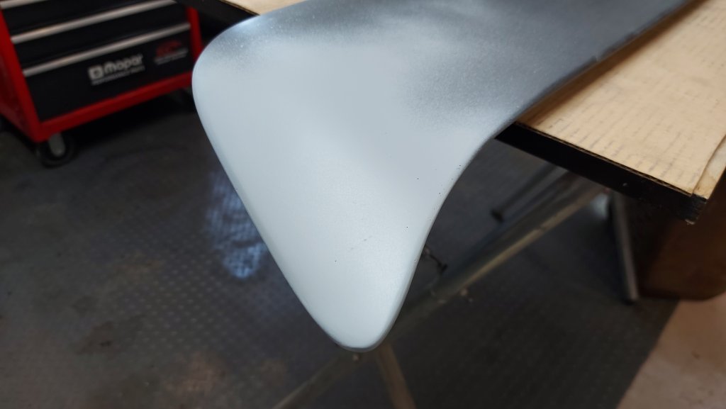

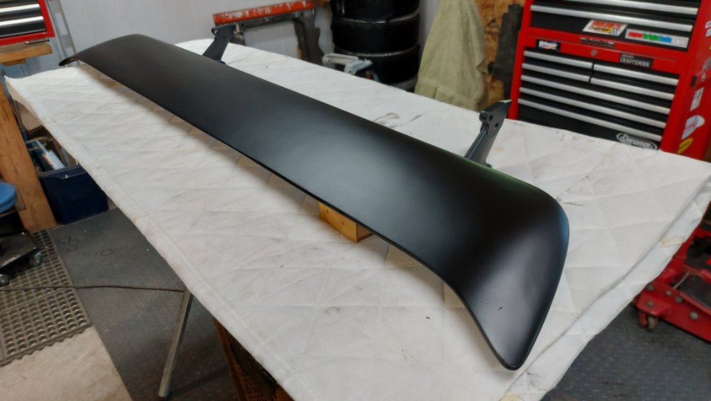

So, I put some putty on the wing tips and ground down the heads of the countersunk screws and reinforcement plates and sprayed some primer.
May 28th (1).jpg (43.04 KiB) Viewed 240502 times
May 28th (2).jpg (49.78 KiB) Viewed 240502 times
May 28th (3).jpg (102.02 KiB) Viewed 240502 times

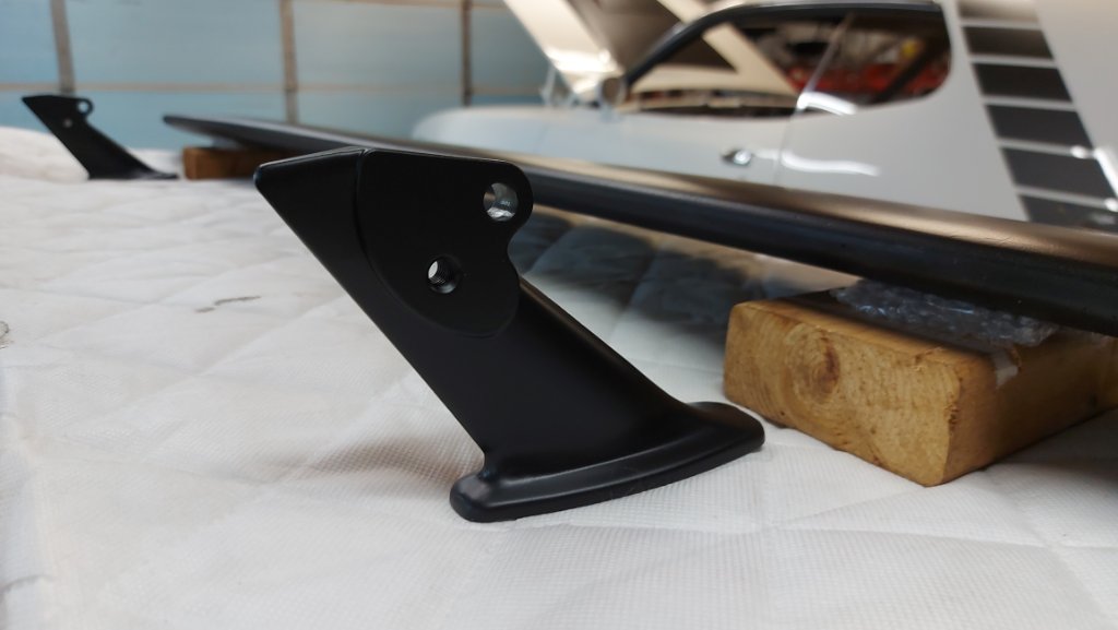

My new pedestals came in from Dantes, but were a little too shiny, so I scuffed them down and painted them and the wing with the SEM landau black.
May 28th (9).jpg (67.48 KiB) Viewed 240502 times
Post by 71Beeper » Sun May 28, 2023 7:44 pm
Here's the finished products.
May 28th (6).jpg (92.06 KiB) Viewed 240502 times
May 28th (7).jpg (82.24 KiB) Viewed 240502 times
May 28th (8).jpg (70.91 KiB) Viewed 240502 times
May 28th (4).jpg (60.65 KiB) Viewed 240502 times
May 28th (5).jpg (59.32 KiB) Viewed 240502 times

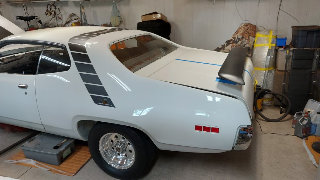

Yesterday was the nerve racking day to drill holes in the trunk lid for the gull wing.

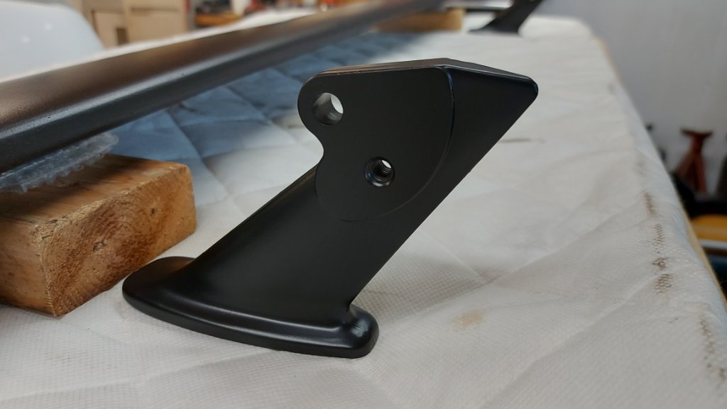

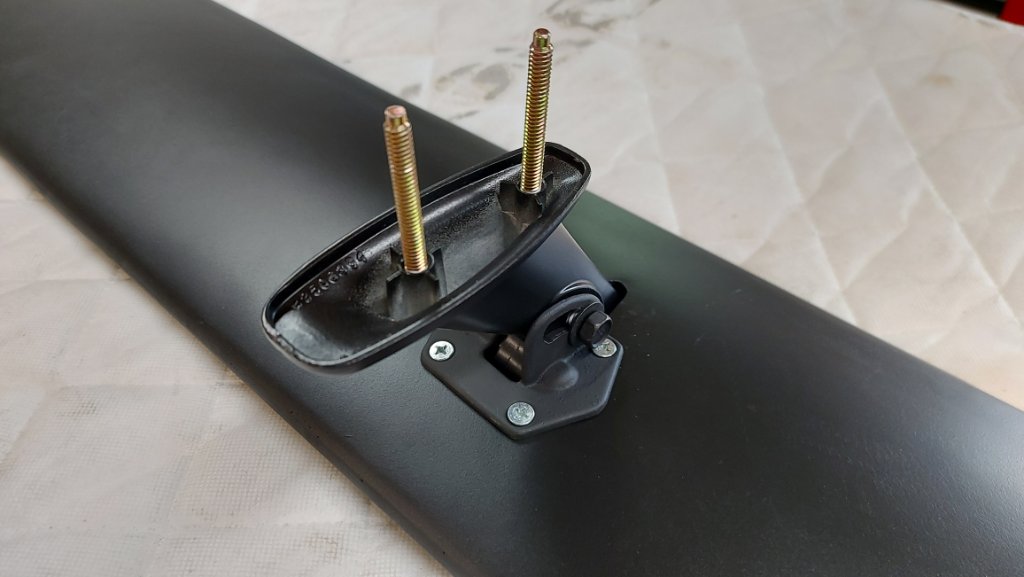

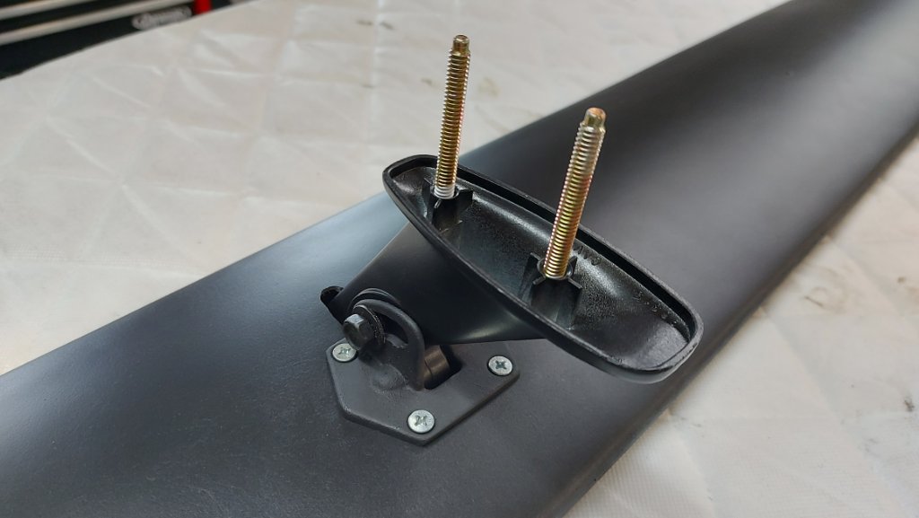

But first I had to put the wing together.

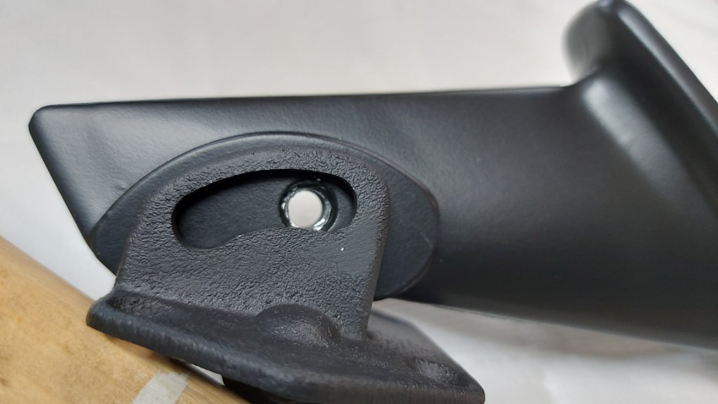

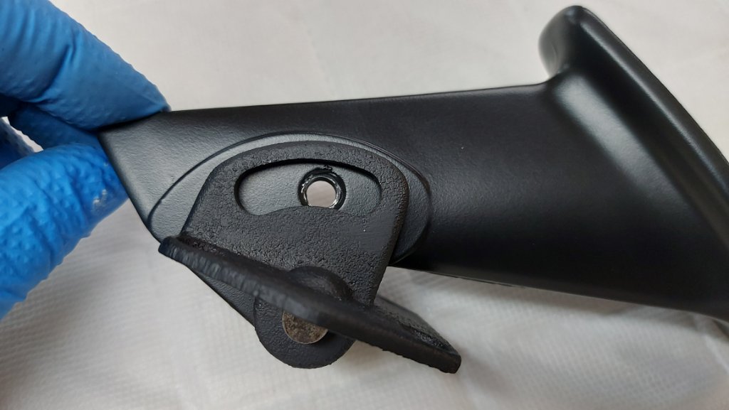

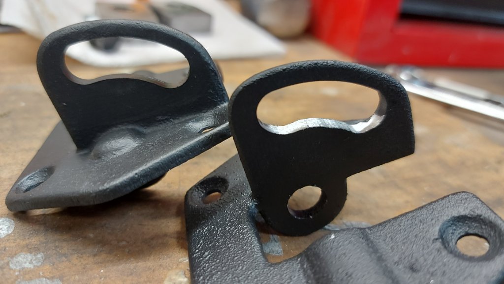

The first hiccup - the adjustment plate and the hole in the pedestal were slightly off.
I went to put the bolt in and it started going in fur-cocked...... :mad:
June 8th (4).jpg (71.22 KiB) Viewed 240452 times
June 8th (3).jpg (67.33 KiB) Viewed 240452 times
So I had to take a Dremel and open up the slot.
Here's the before and after shot.
June 8th (5).jpg (88.07 KiB) Viewed 240452 times
Then give them a coat of the SEM landau black.
Next is put everything together and on the wing.
June 11th (2).jpg (62.93 KiB) Viewed 240452 times
June 11th (3).jpg (61.57 KiB) Viewed 240452 times

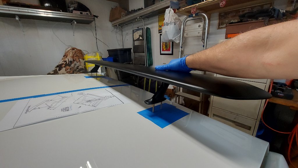

Post by 71Beeper » Sun Jun 11, 2023 4:43 pm

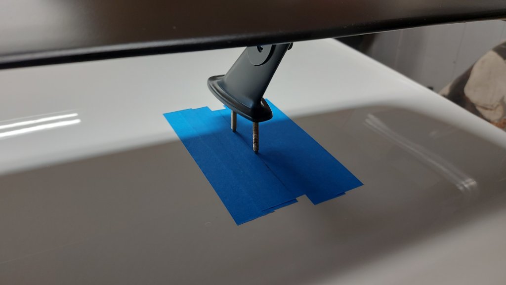

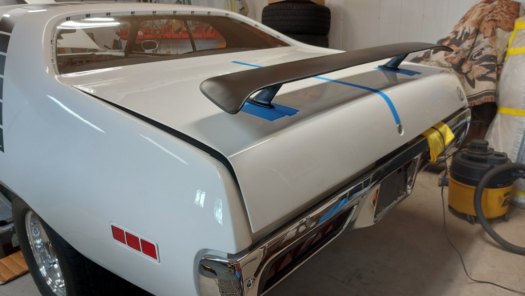

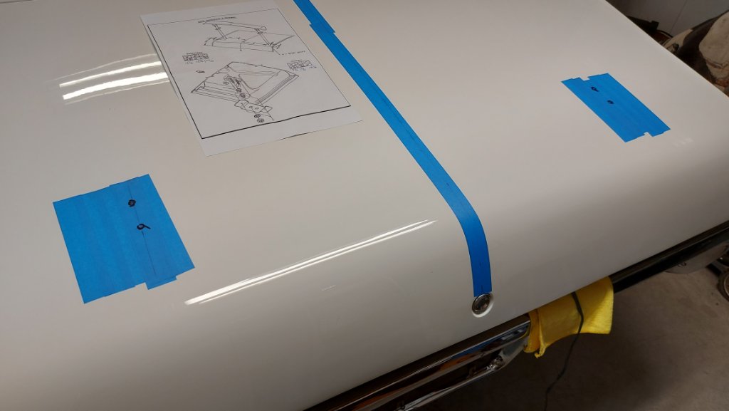

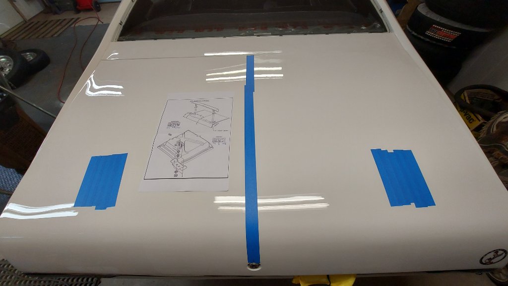

Next step - get some tape on the trunk lid and start to lay out where the holes will be.
June 11th (5).jpg (63.45 KiB) Viewed 240452 times

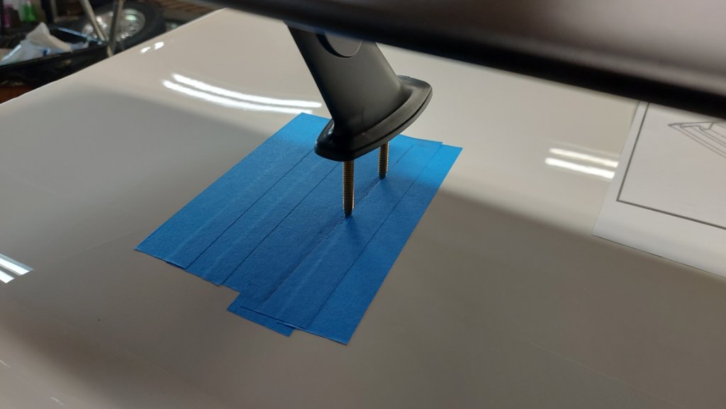

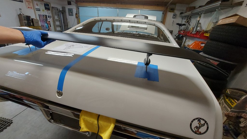

Next verify the locations by putting the wing on to see if my measurements were correct.
June 11th (6).jpg (45.88 KiB) Viewed 240452 times
June 11th (7).jpg (36.44 KiB) Viewed 240452 times
Just a couple of photos to see how it will look.
June 11th (8).jpg (101.1 KiB) Viewed 240452 times
June 11th (9).jpg (86.65 KiB) Viewed 240452 times
Post by 71Beeper » Sun Jun 11, 2023 4:48 pm
Next - I held the wing in place and had my assistant (wife) draw around the stud holes.
That would be the final location for the holes.
June 11th (10).jpg (49.04 KiB) Viewed 240451 times
Then say a prayer and get out the drill.
Starting with a very small starter hole, then move up in sizes.
The final hole size is 5/16".
Now put the studs thru the holes to check.
June 11th (11).jpg (73.88 KiB) Viewed 240451 times
June 11th (12).jpg (81.37 KiB) Viewed 240451 times
June 11th (13).jpg (88.78 KiB) Viewed 240451 times
It fits!!! :beer:

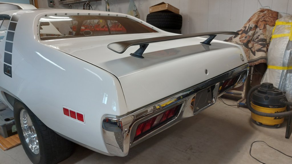

Post by 71Beeper » Sun Jun 11, 2023 4:53 pm
Now to remove the tape from the topside and get started on the underside.
June 11th (17).jpg (55.86 KiB) Viewed 240451 times

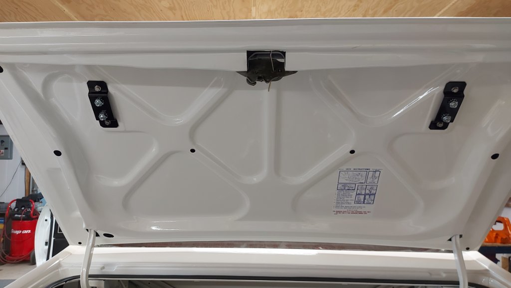

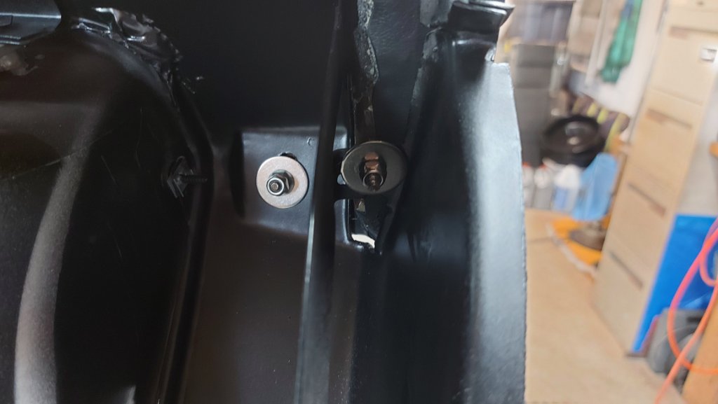

When I drilled the topside holes I went all the way thru the ribbing on the underside.
Then I used a step drill to get the hole big enough for the flanged nuts to go thru.
June 11th (18).jpg (76.8 KiB) Viewed 240451 times

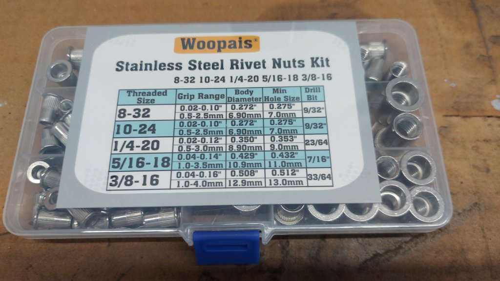

For the reinforcement plate that gets mounted to the underside I used stainless riv-nuts for the fasteners.
June 11th (19).jpg (100.19 KiB) Viewed 240451 times
Then install the plates and button it up.
June 11th (21).jpg (61.59 KiB) Viewed 240451 times
Here's the final look - Man am I relieved that's over...
June 11th (22).jpg (83.97 KiB) Viewed 240451 times

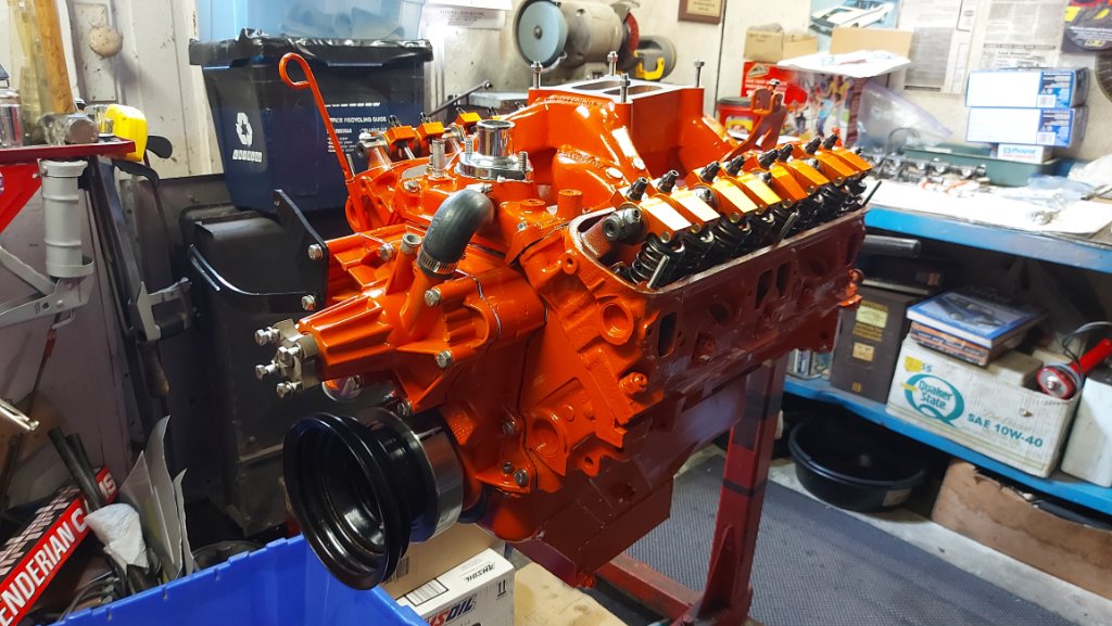

With that big task out of the way, it's back to working on the engine.

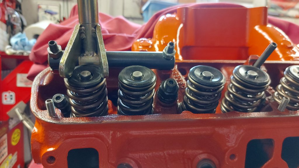

First order of business is to remove the inner valve springs.
June 11th (14).jpg (144.37 KiB) Viewed 240337 times
June 11th (15).jpg (127.71 KiB) Viewed 240337 times
June 11th (16).jpg (106.76 KiB) Viewed 240337 times
Then get the timing cover installed.
June 15th.jpg (82.94 KiB) Viewed 240337 times

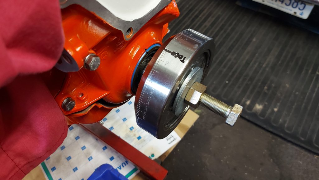

And now put the Romac harmonic balancer on.
June 20th (3).jpg (85.64 KiB) Viewed 240337 times

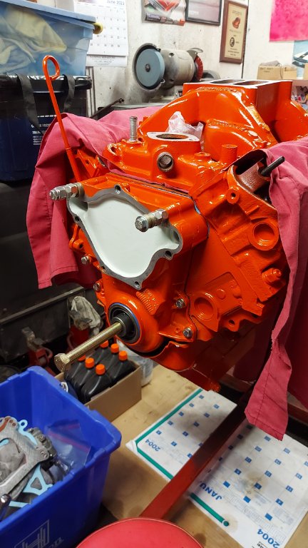

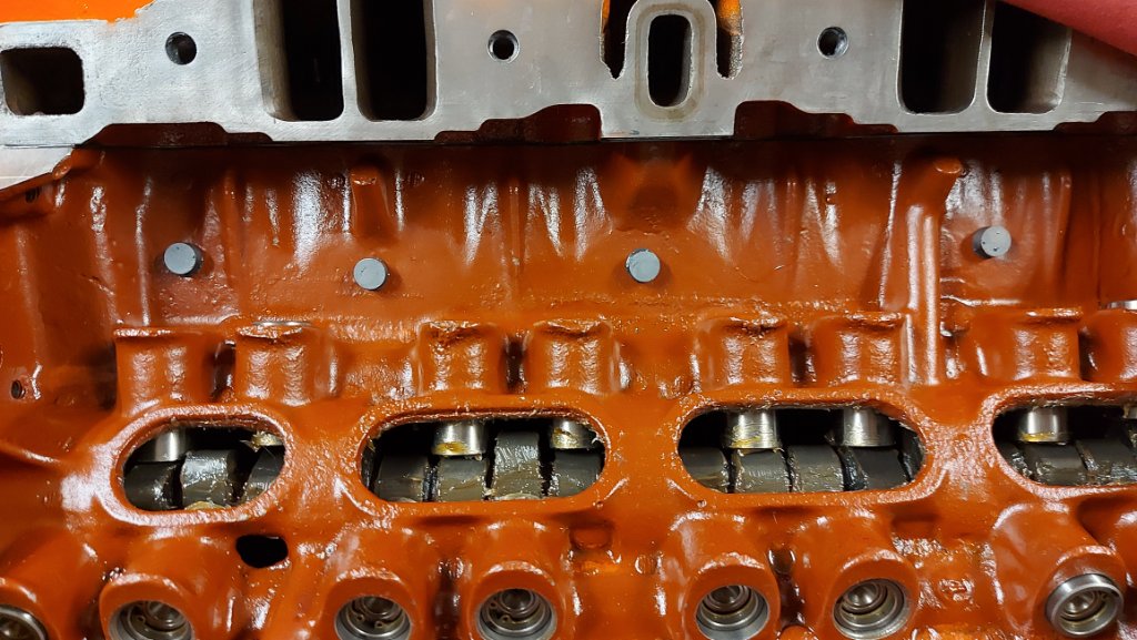

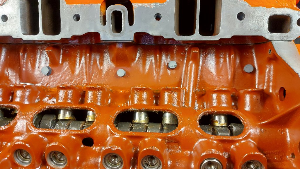

Post by 71Beeper » Sat Jun 24, 2023 3:24 pm
Next - I installed some magnets in the lifter valley.
8 magnets in total.
My engine does this with all the roundy round engines he builds - makes them live longer.
June 20th (1).jpg (144.89 KiB) Viewed 240337 times
June 20th (2).jpg (154.43 KiB) Viewed 240337 times

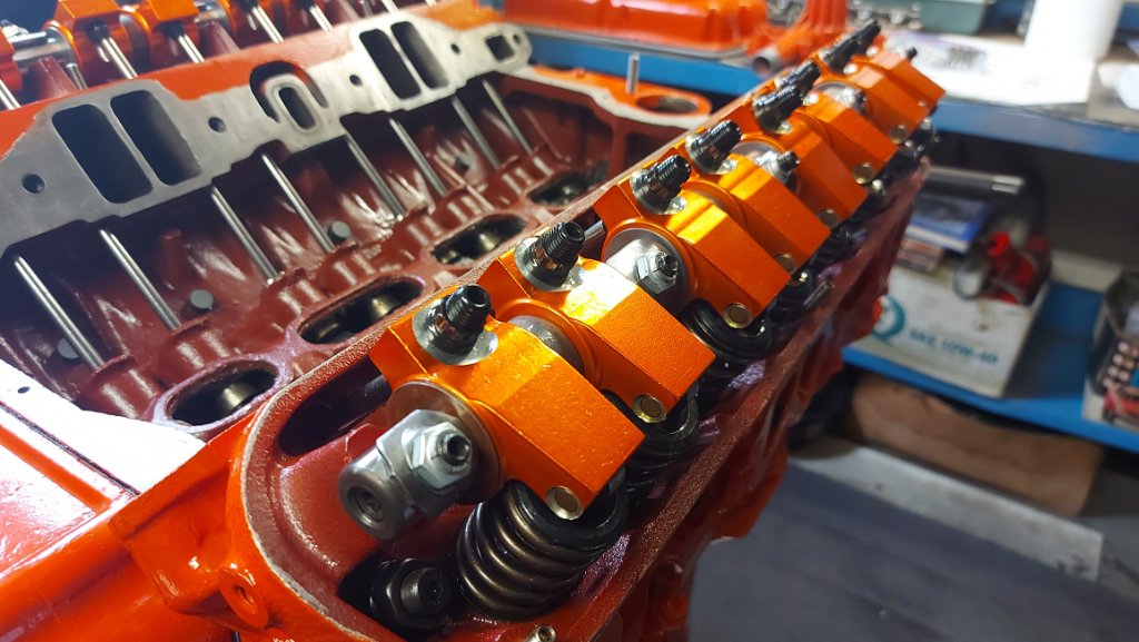

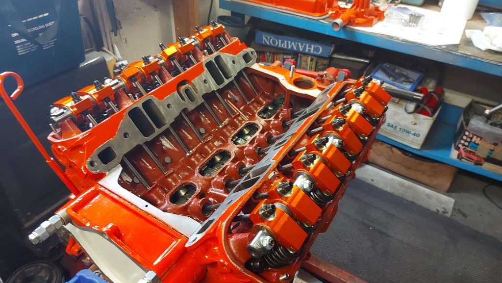

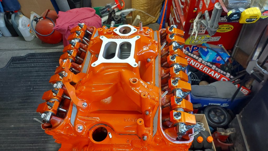

Next is to install and adjust the Harland Sharpe 1.6 rockers using the Mopar adjustment chart.
June 24th (4).jpg (60.76 KiB) Viewed 240337 times
Lash was set at .015"
June 24th (1).jpg (120.31 KiB) Viewed 240337 times
June 24th (2).jpg (137.15 KiB) Viewed 240337 times
June 24th (3).jpg (117.25 KiB) Viewed 240337 times

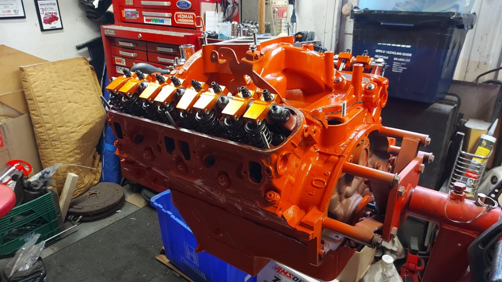

Post by 71Beeper » Thu Jul 06, 2023 8:12 pm

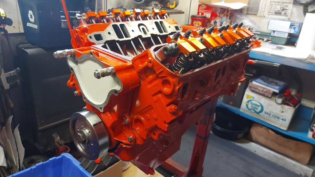

I finally got the rest of the engine bits back on it.
All there is left is the valve covers & alternator and fan.
Oh, don't forget headers and carb along with distributor.
July 6th (3).jpg (138.19 KiB) Viewed 240211 times
July 6th (4).jpg (140.59 KiB) Viewed 240211 times
July 6th (2).jpg (144.78 KiB) Viewed 240211 times
Soon enough I'll be able to put it on the K-member and get the headers mounted along with bellhousing, clutch & starter.

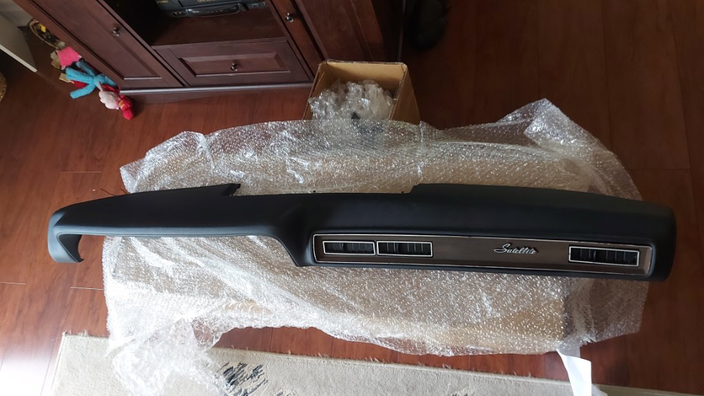

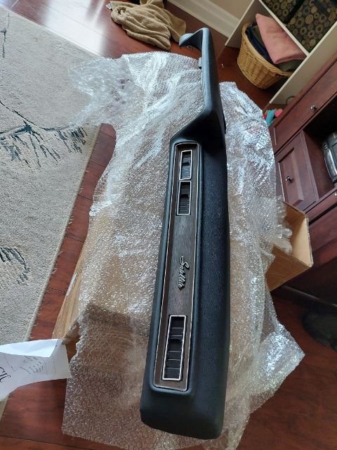

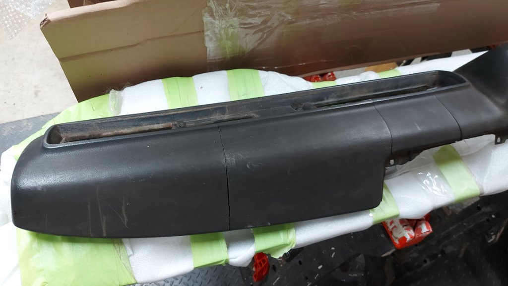

I was finally able to score the most sought after part for this project...........the coveted dash pad.. :shock:
I'd been searching for a replacement pad for about 2 years now as the one that came in the car was had the typical cracks on it.
July 3rd (12).jpg (74.34 KiB) Viewed 240210 times
July 3rd (13).jpg (58.23 KiB) Viewed 240210 times
A little backstory on this crusade.
I had an order for one with a company called Moparts Canada located in Windsor, Ontario.
Well after dickin me around for a year they still could not come up with one, so I cancelled my order.
A local Mopar guy was getting them from a company in El Paso, Texas (but wouldn't tell me the name of said company) so I had him order one for me - that was in March of this year.
I heard nothing about mine until recently I messaged him and he said that he cancelled all his orders and stopped payment.
So I asked about my order to which the reply was "sorry, I might go to Carlisle and find one."
So I figured my chances of him finding one was a snowballs chance in he!! :rant:
Last week I was looking on the for B-Bodies site under interior parts for sale and lo & behold there's a dash pad for sale!!!
Long story short I made contact with the seller who agreed to ship it to my US mailbox.
I picked it up on July 3rd.
I couldn't be happier... :D
July 3rd (1).jpg (81.51 KiB) Viewed 240210 times
Dash pad pics (12).jpg (83.67 KiB) Viewed 240210 times
July 3rd (2).jpg (109.9 KiB) Viewed 240210 times

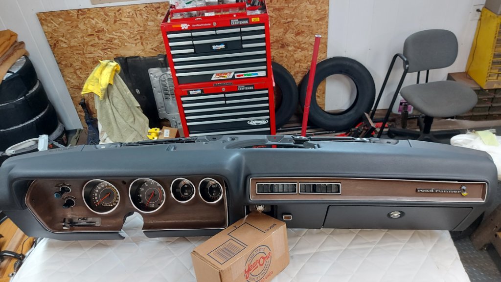

Post by 71Beeper » Thu Jul 06, 2023 8:37 pm
Along with the dash pad which was done by ABC Moparts I also got a complete set of ducting for an A/C setup.
I also got a speaker grille and under dash fasten seat belt / map light panel.
Today I finally got the chance to try it on the frame.
It fits great!
July 6th (15).jpg (100.08 KiB) Viewed 240210 times
July 6th (13).jpg (116.56 KiB) Viewed 240210 times

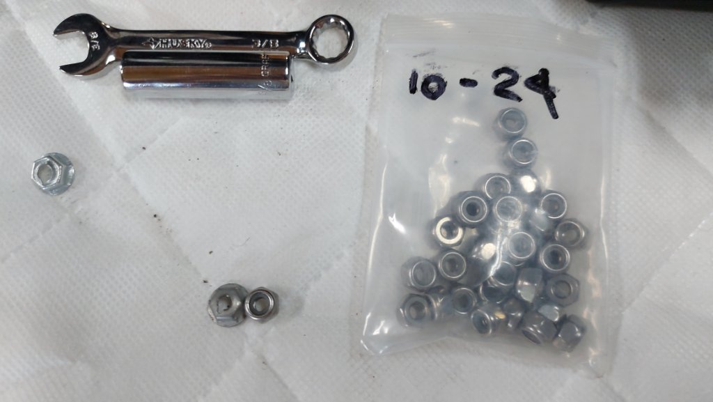

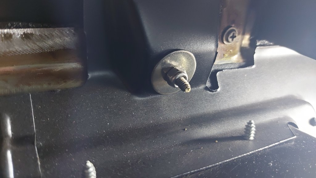

A little hint to getting a great fit - don't use the speed nuts that are normally used to fasten the dash to the frame, instead use #10-24 ny-loks like I did along with #10 fender washers.
July 6th (6).jpg (68.38 KiB) Viewed 240210 times
July 6th (7).jpg (55.81 KiB) Viewed 240210 times
July 6th (11).jpg (82.25 KiB) Viewed 240210 times

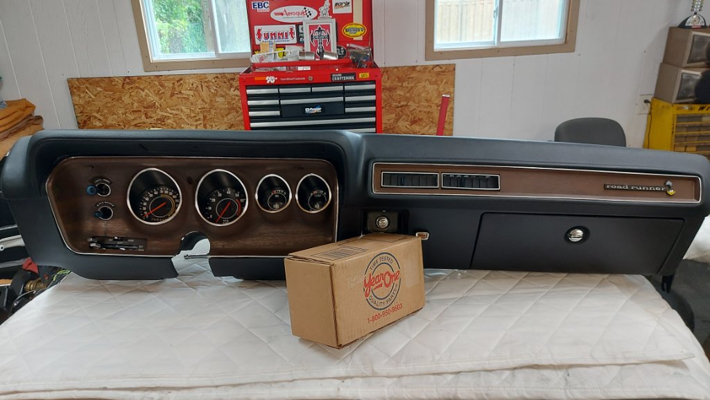

Post by 71Beeper » Sat Jul 08, 2023 4:08 pm

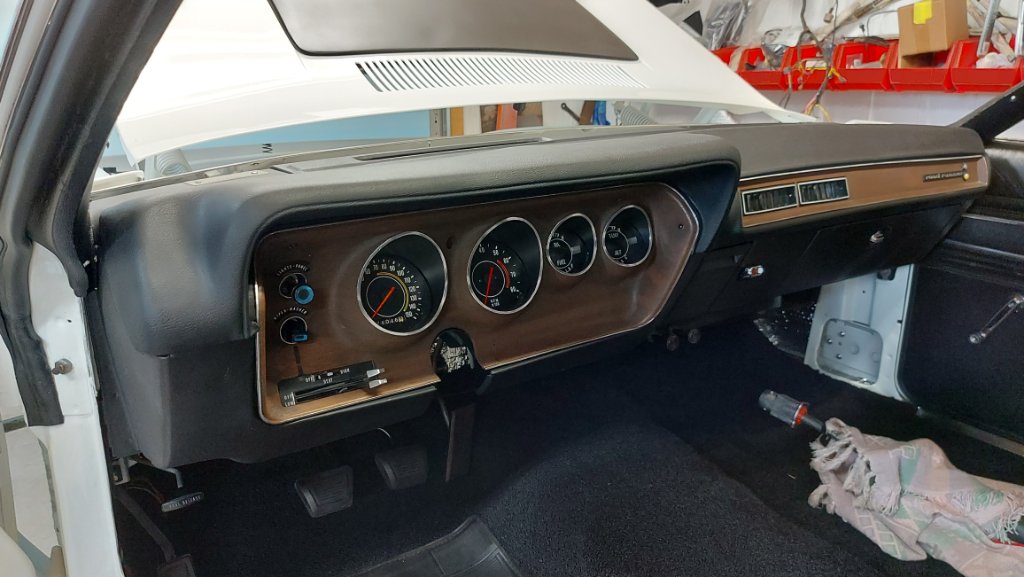

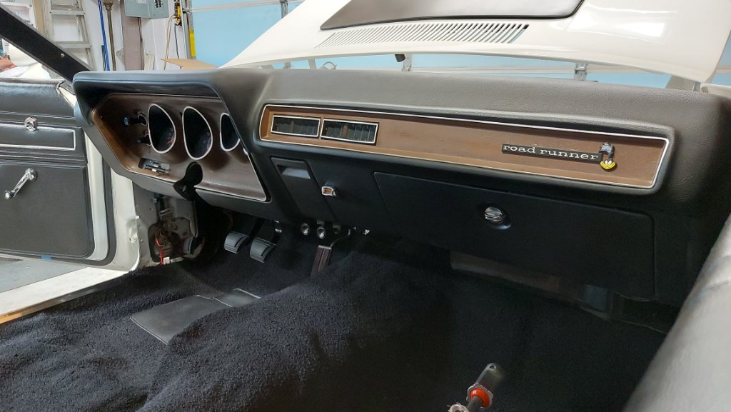

Well guys, I've waited a long time for this.
I was finally able to install the complete dash assembly into the car.
July 8th (10).jpg (89.72 KiB) Viewed 240195 times
July 8th (11).jpg (101.44 KiB) Viewed 240195 times
July 8th (12).jpg (104 KiB) Viewed 240195 times

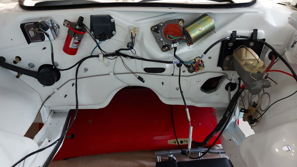

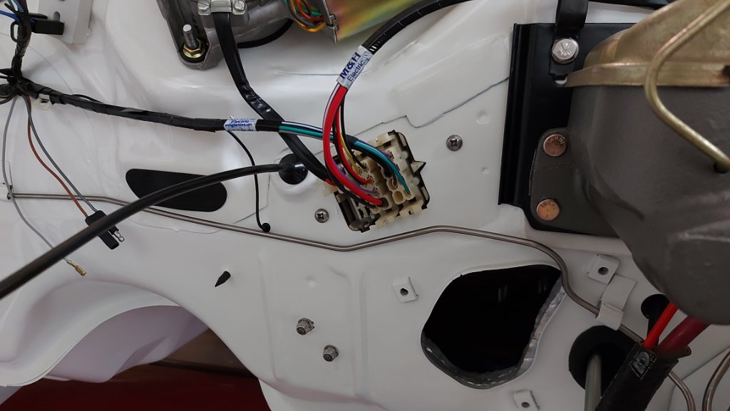

And got the bulkhead connectors attached.
July 8th (13).jpg (94.58 KiB) Viewed 240195 times
July 8th (14).jpg (78.93 KiB) Viewed 240195 times
It's been a big hurdle for me.
Not I can celebrate with a :beer:
Now I can prepare for the engine install.

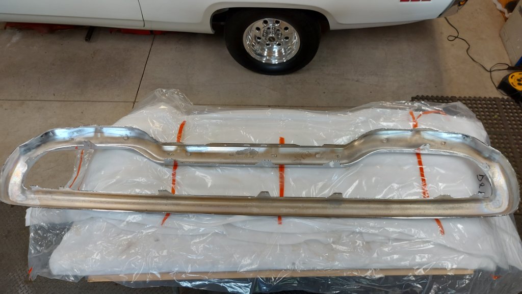

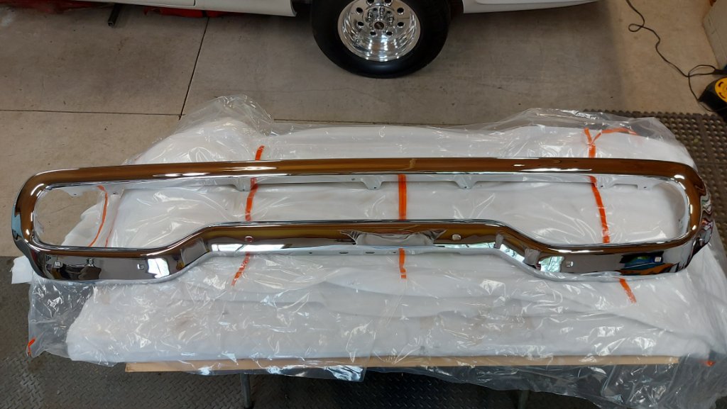

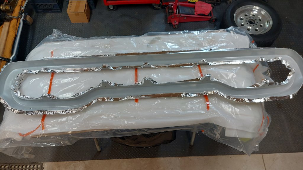

Dug out the front bumper.
July 22nd (1).jpg (103.72 KiB) Viewed 240046 times
Time to get some primer on the underside of it.
July 22nd (6).jpg (103.97 KiB) Viewed 240045 times
And 2 coats of white paint to protect it.
July 23rd (8).jpg (108.68 KiB) Viewed 240046 times
July 22nd (2).jpg (96.13 KiB) Viewed 240046 times
