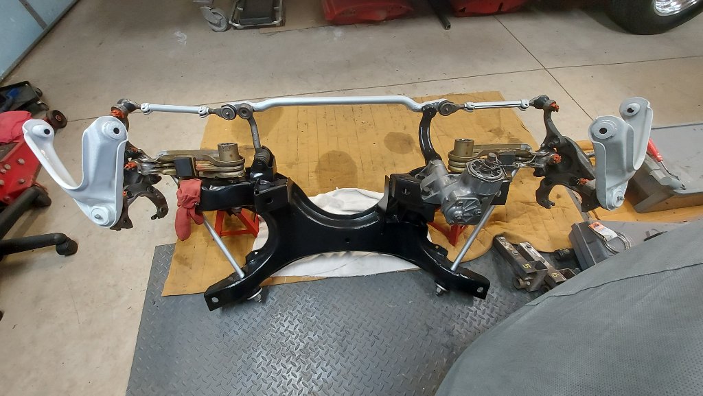

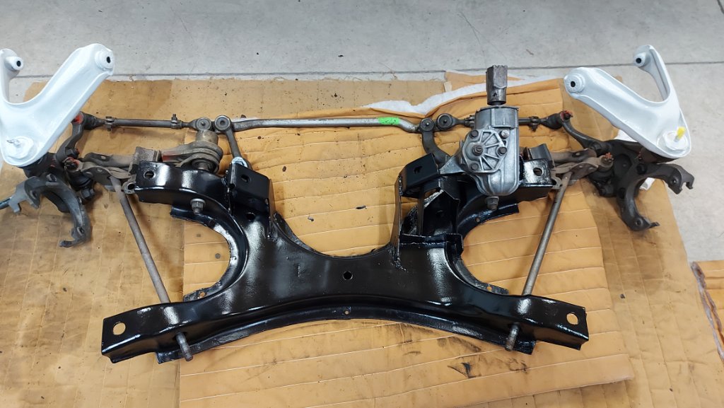

Got in the shop this morning - the paint is almost dry.
Still tacky in a few places.
Here's what semi-gloss black looks like.
March 5th 2023.jpg (121.19 KiB) Viewed 249675 times
Next thing to clean-up is the upper and lower control arms & strut rods.

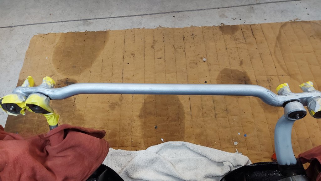

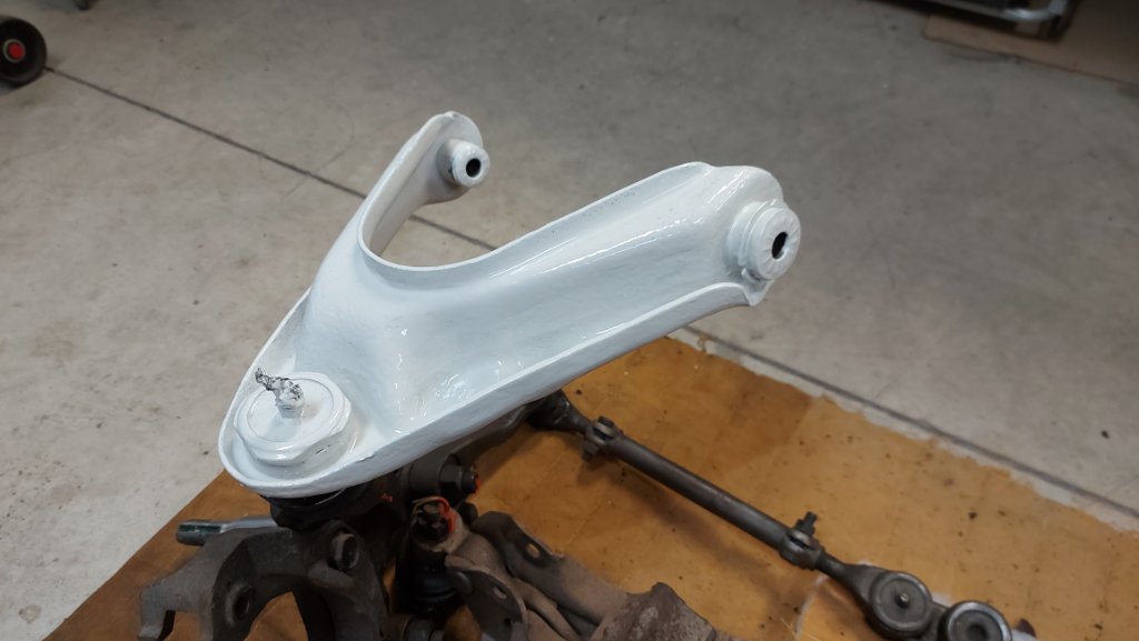

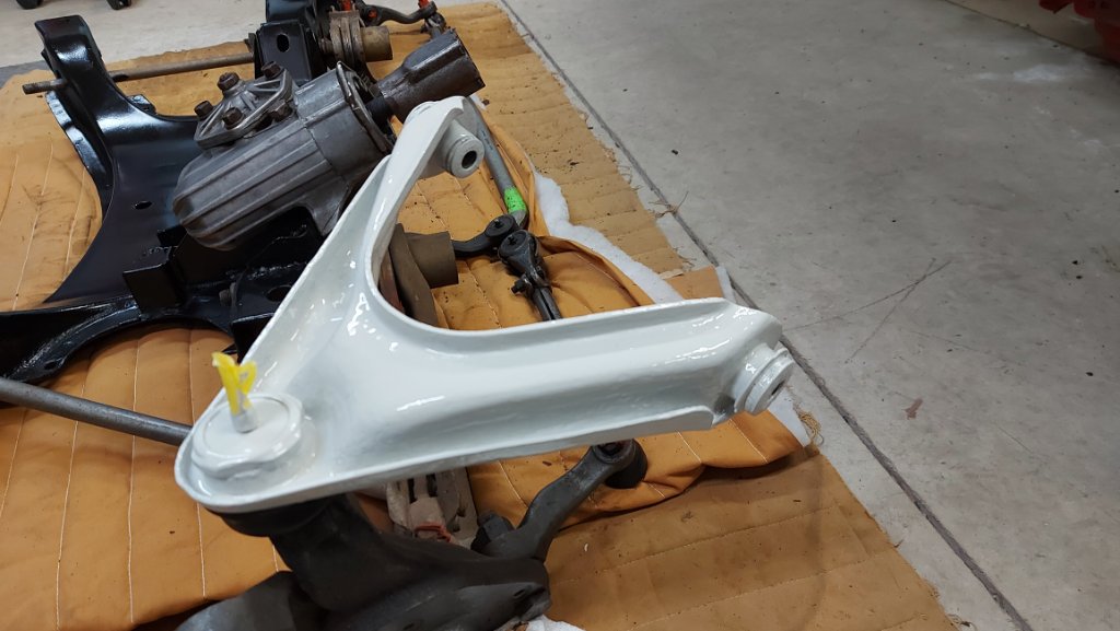

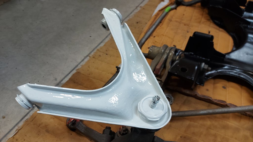

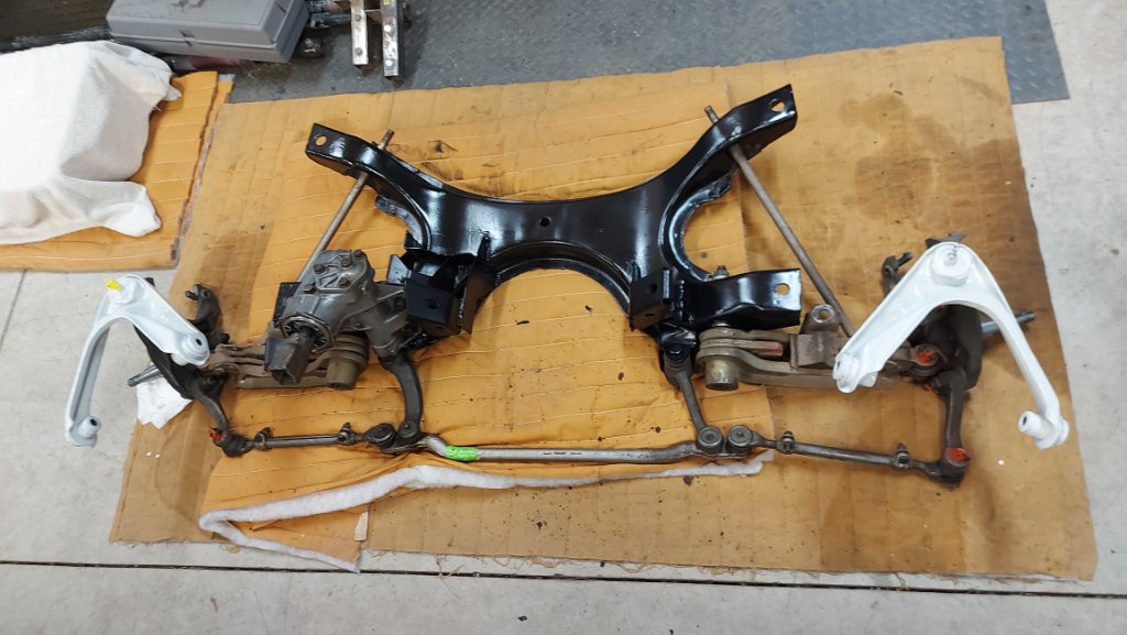

Next step is do paint the control arms. The current aluminum color that's on them need some freshening up.
I scuffed them down and applied a light grey paint to them.
March 12th (5).jpg (94.04 KiB) Viewed 249602 times
March 12th (6).jpg (76.35 KiB) Viewed 249602 times
March 12th (7).jpg (64.71 KiB) Viewed 249602 times
March 12th (4).jpg (109.67 KiB) Viewed 249602 times
March 12th (1).jpg (116.16 KiB) Viewed 249602 times
Future plans call for changing the upper arms for some tubular ones.

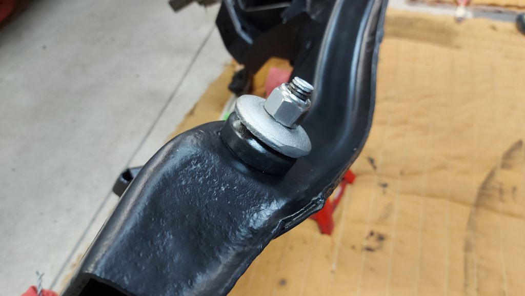

Moving along, the strut rods are next.
Scuff em down and paint them with a nice steel color VHT caliper paint.
Also put new stainless hardware on the ends.

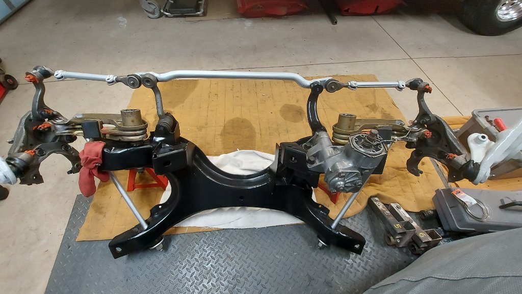

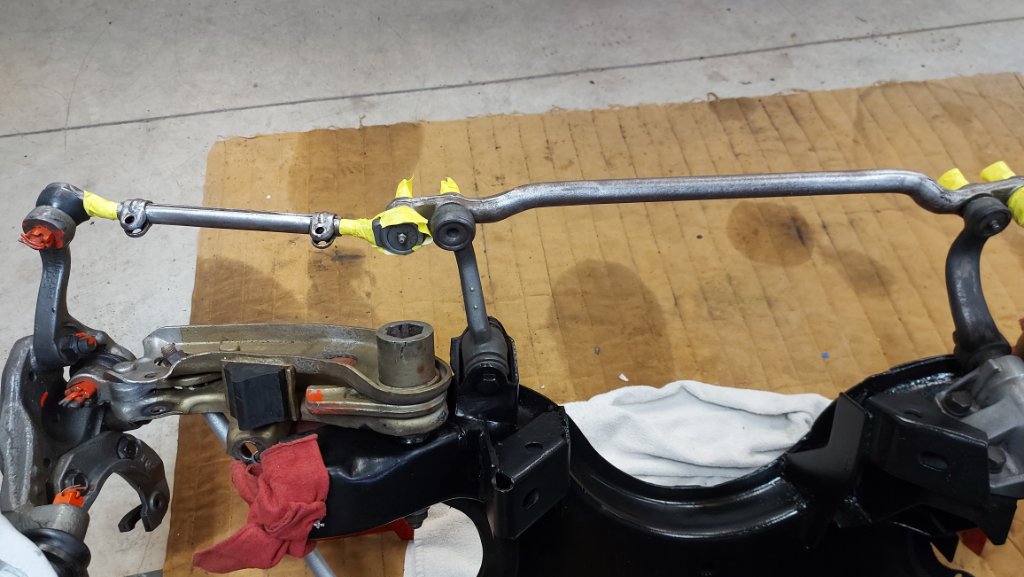

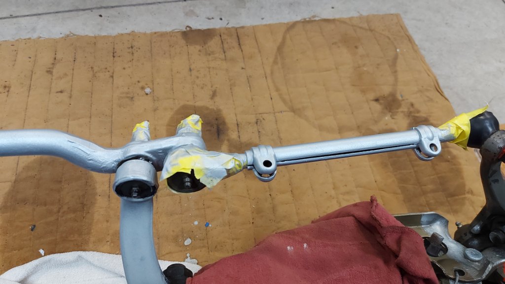

Now its on to prepping the steering components.
Scuff them down with my fiber wheel.
Wash them up with lacquer thinner & do some masking too.
March 26th (11).jpg (103.05 KiB) Viewed 249602 times
March 26th (12).jpg (114.16 KiB) Viewed 249602 times
March 26th (13).jpg (119.67 KiB) Viewed 249602 times
March 26th (14).jpg (116.72 KiB) Viewed 249602 times
March 26th (15).jpg (101.59 KiB) Viewed 249602 times

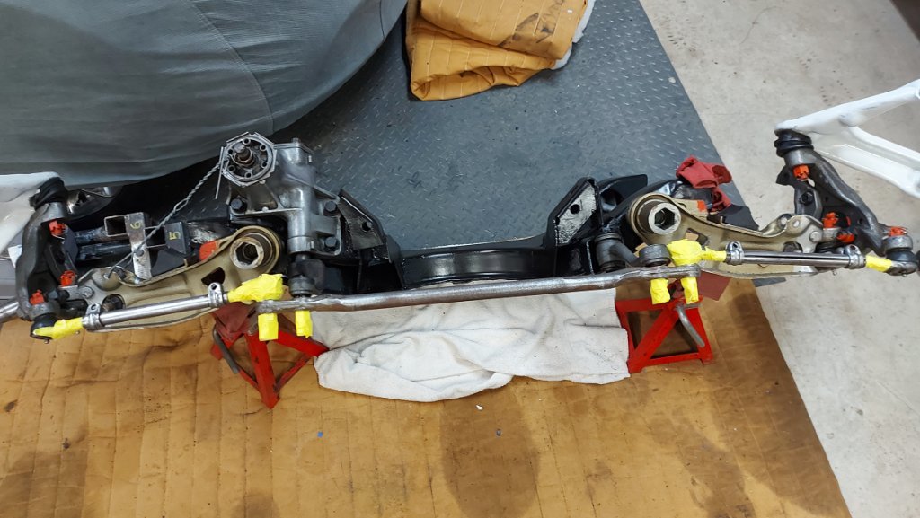

I'll do 2 coats of primer followed by the same VHT caliper steel colored caliper paint.
Posts: 746
Post by 71Beeper » Mon Apr 10, 2023 8:04 pm
Two coats of primer later......followed by 2 coats of VHT caliper paint.

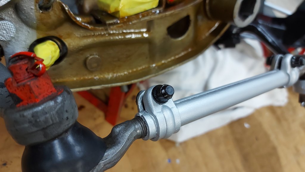

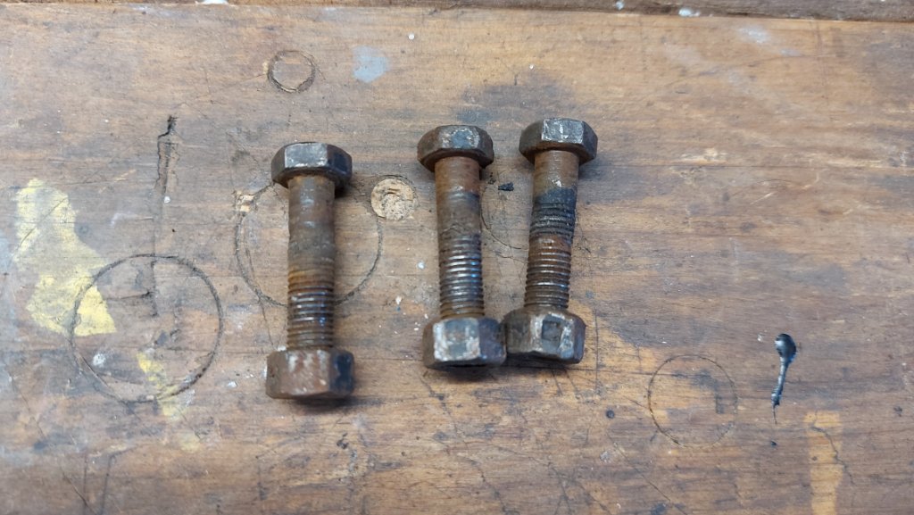

I did remove the old hardware that was on the tie-rod sleeve clamps.
April 10th (4).jpg (119.71 KiB) Viewed 249518 times
Not going to re-use those.

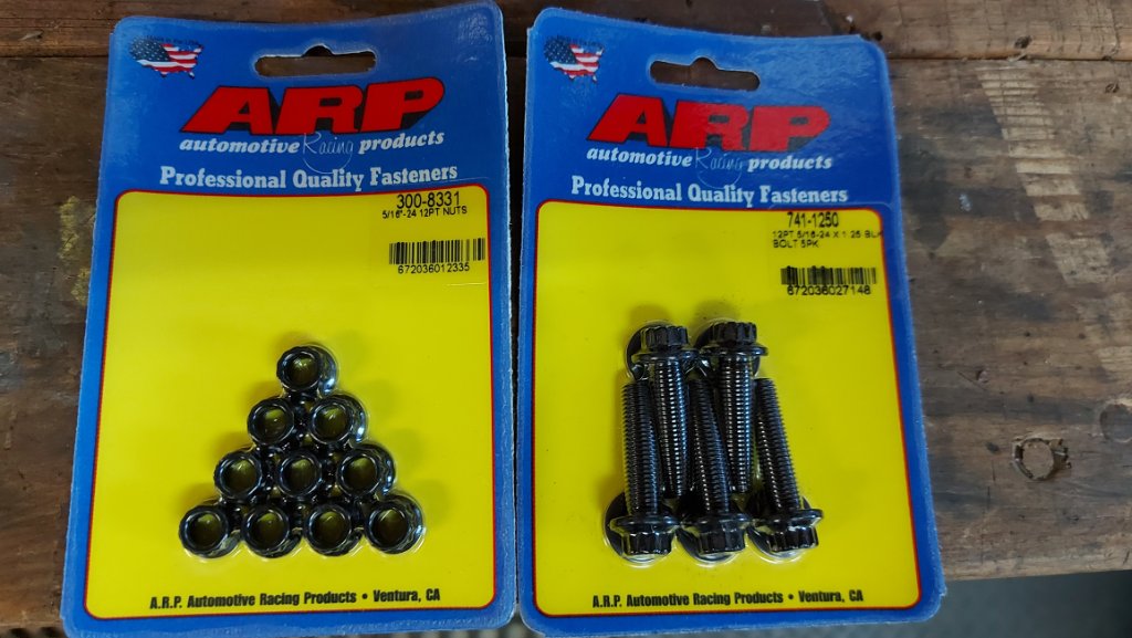

Instead I bought these.
April 10th (3).jpg (108.92 KiB) Viewed 249518 times
They will look much better.

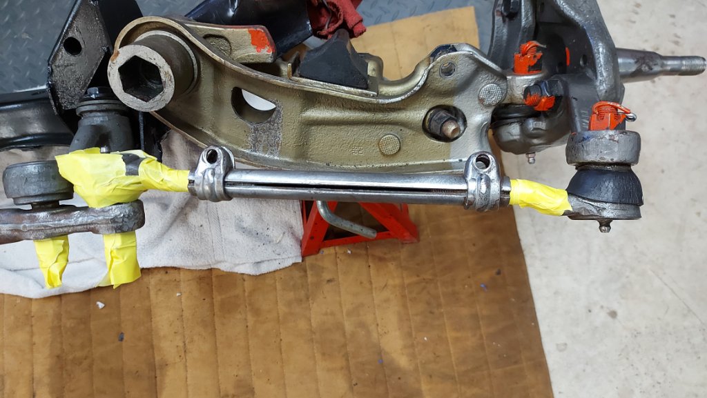

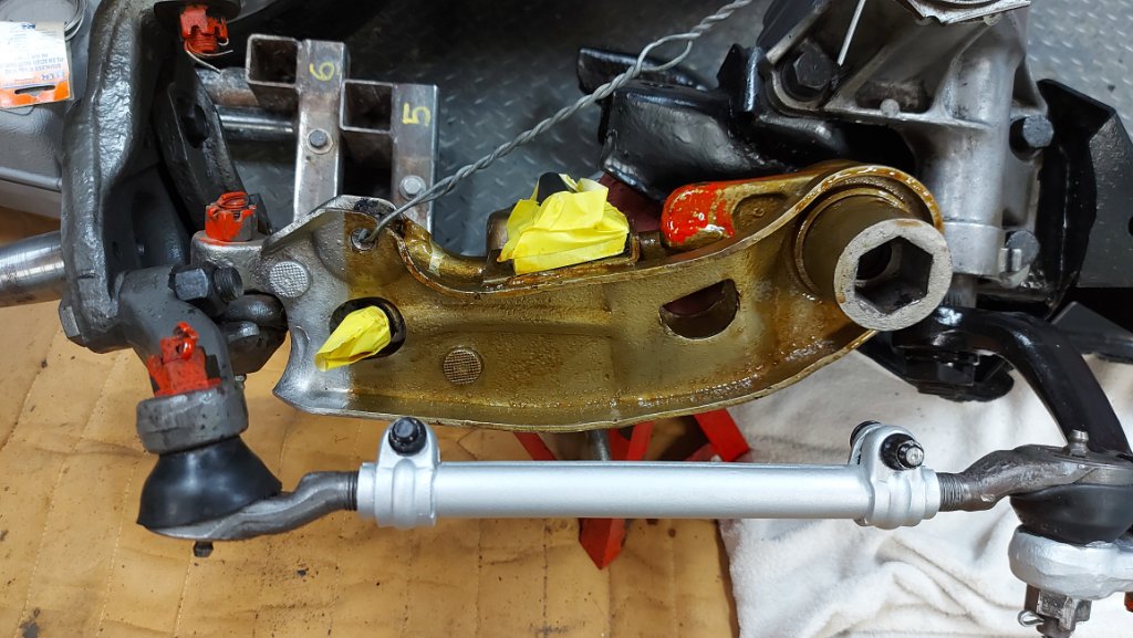

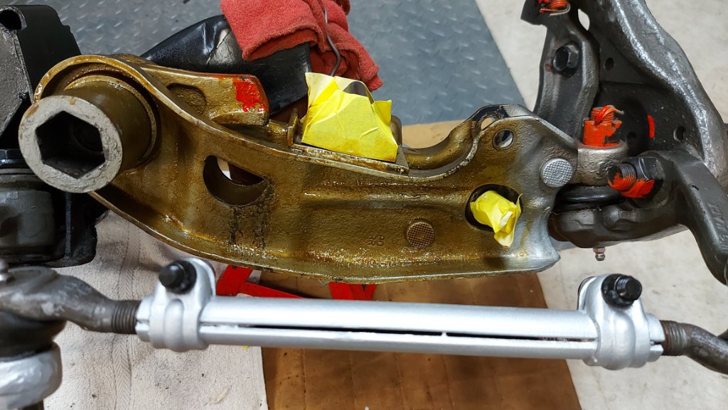

I also got around to applying actual cosmoline coating to the control arms just to bring back some of the amber color.
This stuff goes on wet and dries to a dry type of wax finish.

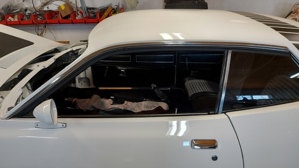

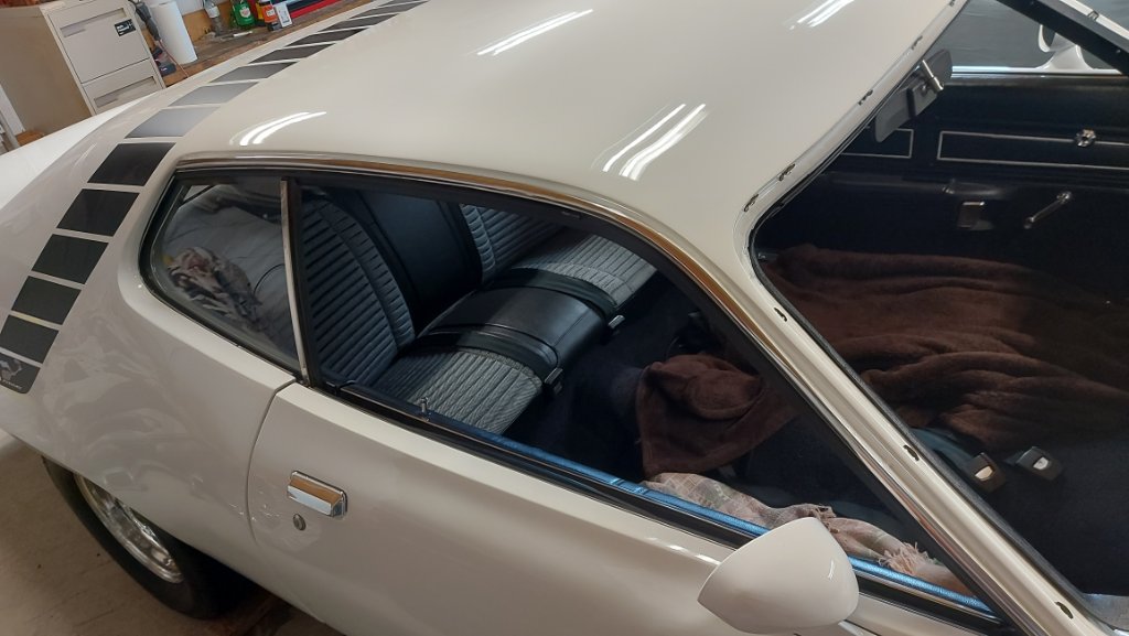

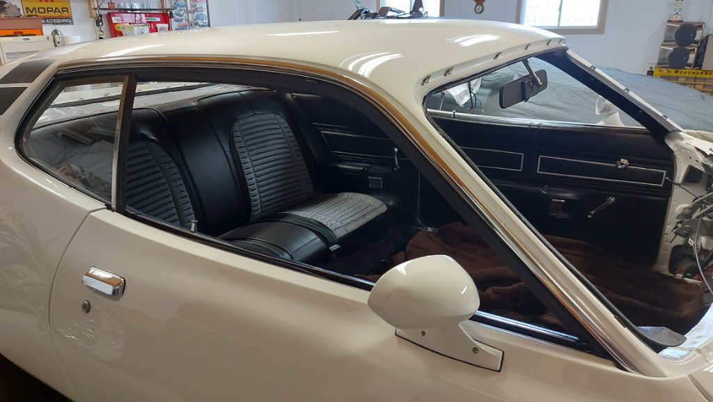

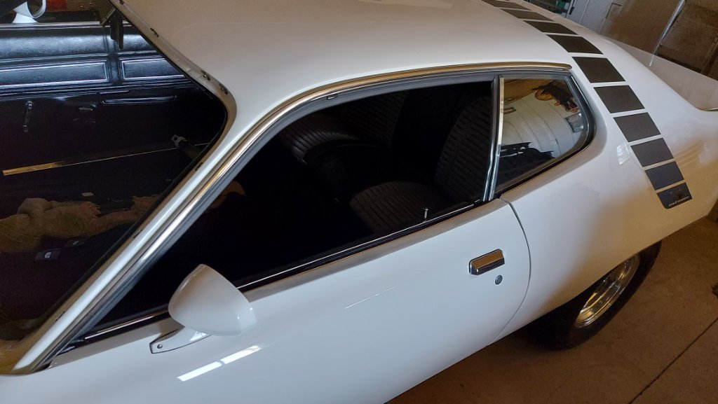

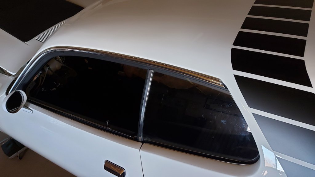

Finally I was able to put the rain gutter trim back on the car.
Problem with a white car is that stainless trim doesn't pop out as much compared to if it was painted a darker color.

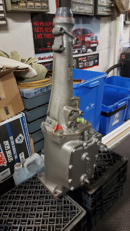

So I finally was able to get the tailstock on my 4 speed changed.
If you remember the shifter box mounting holes were damaged when I bought the 4 speed.
Feb 26th (4).jpg (91.68 KiB) Viewed 249425 times
And I was able to find a good replacement tailstock.
Feb 23rd (3).jpg (100.33 KiB) Viewed 249425 times

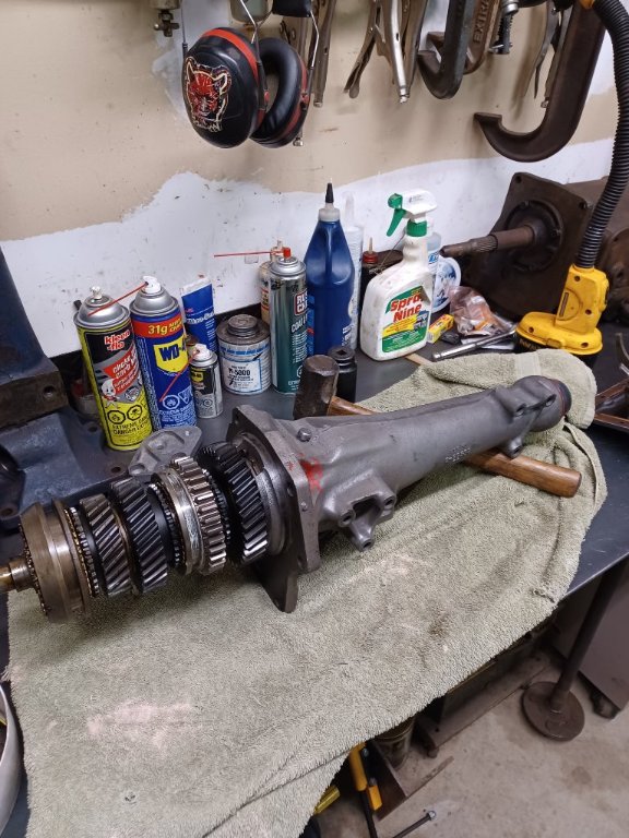

So, after ordering the correct gasket kit from Brewers I took the 4 speed to my good buddy Kevin's place to get it switched.
Here it is on the bench ready to go back together again.
April 22nd (4).jpg (114.64 KiB) Viewed 249425 times

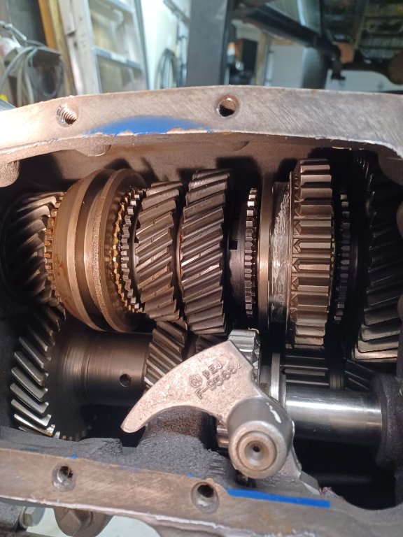

Here's a look at the internals - Kevin said it was in great shape.
April 22nd (2).jpg (90.97 KiB) Viewed 249425 times
And here it is back together again waiting for me to pick it up.
April 22nd (1).jpg (94.57 KiB) Viewed 249425 times
Posts: 746
Post by 71Beeper » Sun Apr 23, 2023 8:11 pm
Oh, I forgot to mention, he did change out the bushing in the tailstock as well.
April 22nd (3).jpg (58.22 KiB) Viewed 249425 times
Here it is back home.
April 21st (1).jpg (87.38 KiB) Viewed 249425 times
Next step is to prep and paint it.

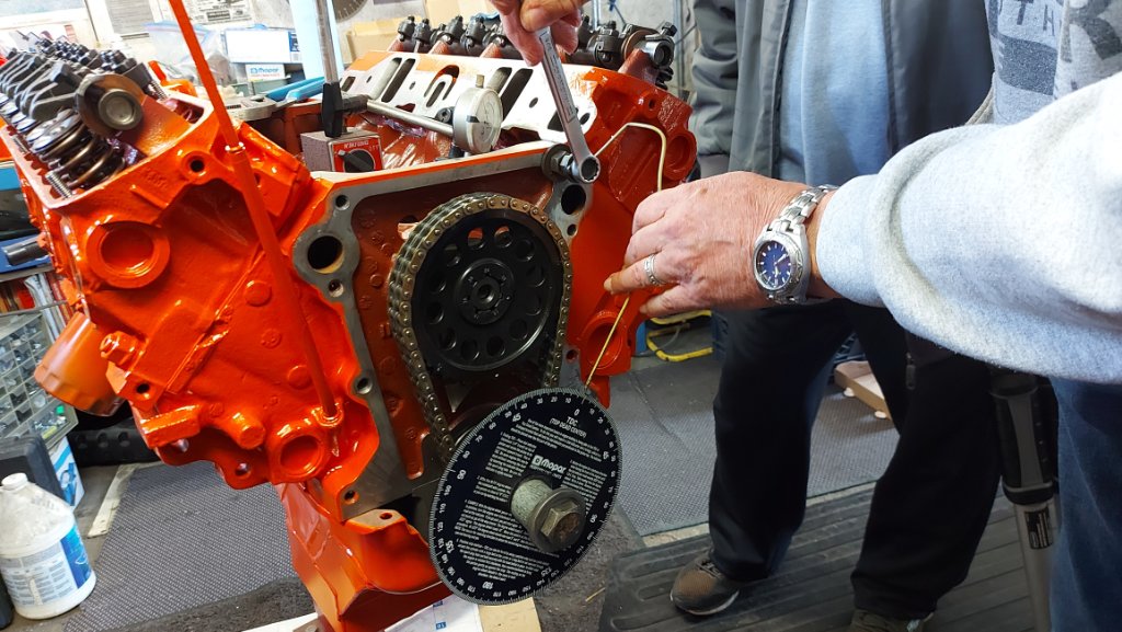

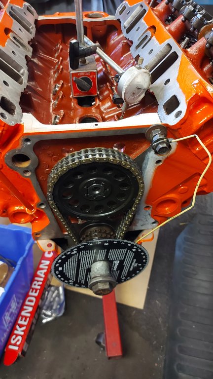

My buddy who assembled my engine, Brad came over yesterday and degreed the new Isky cam.
It was installed straight up as it already has 4 degrees of advance ground into it.

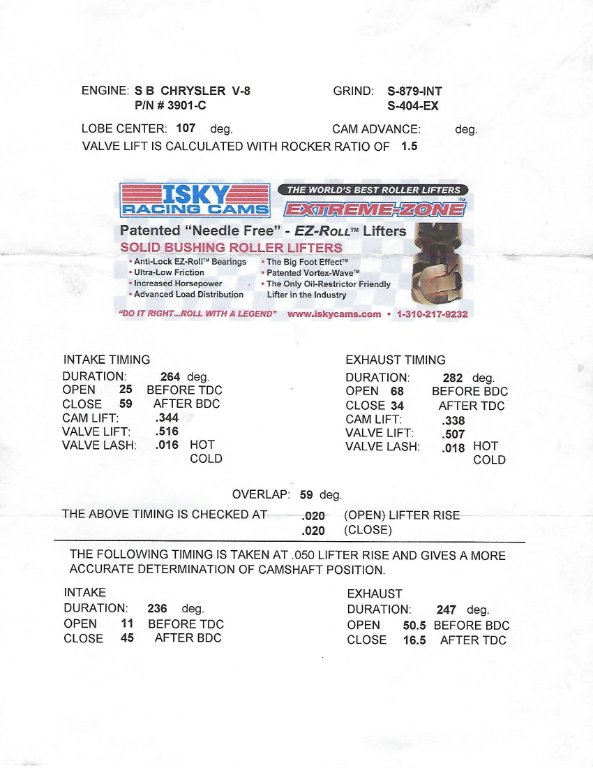

Here's the cam info.
Isky cam info.jpg (77.7 KiB) Viewed 249322 times

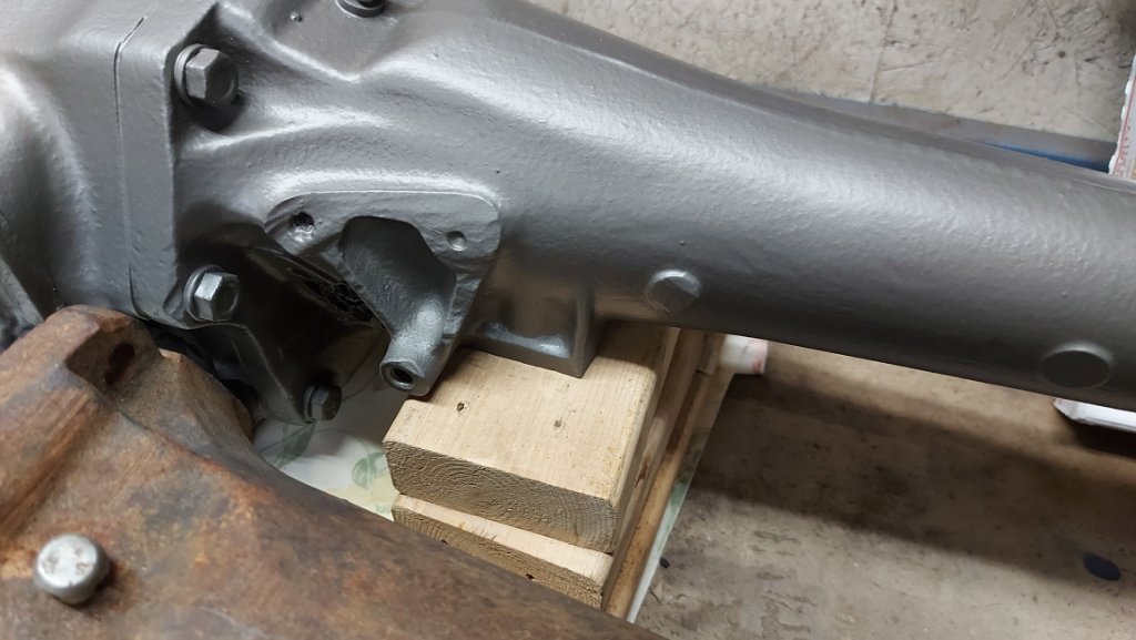

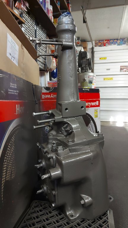

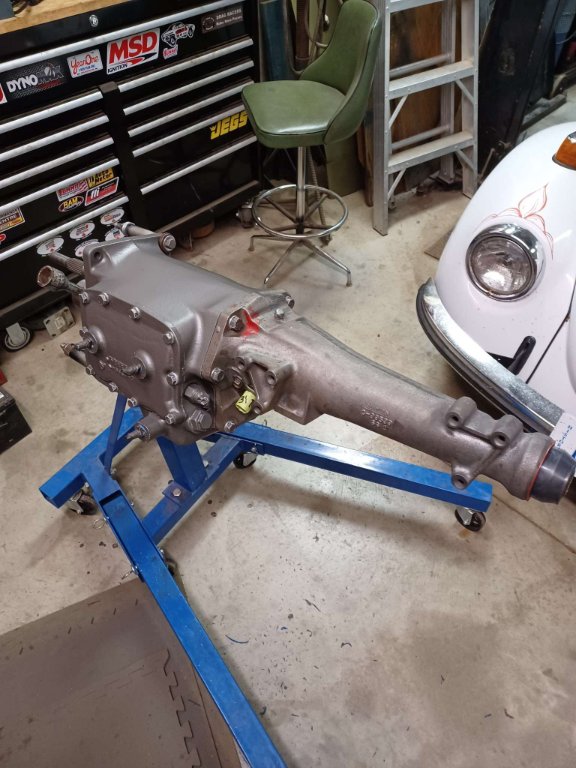

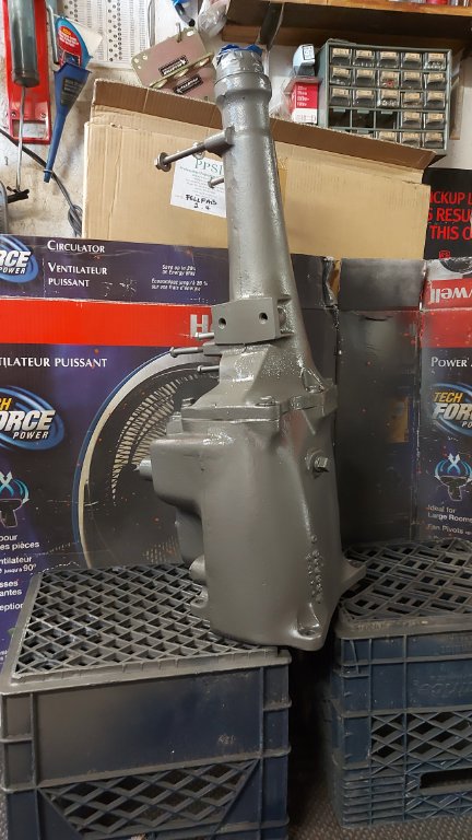

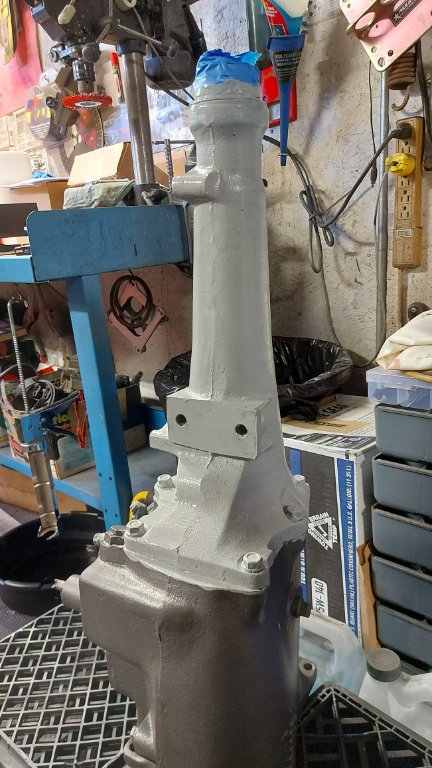

Finally got some time to put some primer on the 4 speed.
May 18 (1).jpg (77.9 KiB) Viewed 249161 times
May 18 (2).jpg (90.96 KiB) Viewed 249161 times
Then ruffed it up with some scotchbrite and sprayed some cast paint.
May 18 (4).jpg (81.84 KiB) Viewed 249161 times
May 18 (5).jpg (80.33 KiB) Viewed 249161 times
May 18 (6).jpg (66.31 KiB) Viewed 249161 times
I'll do a second coat tomorrow.

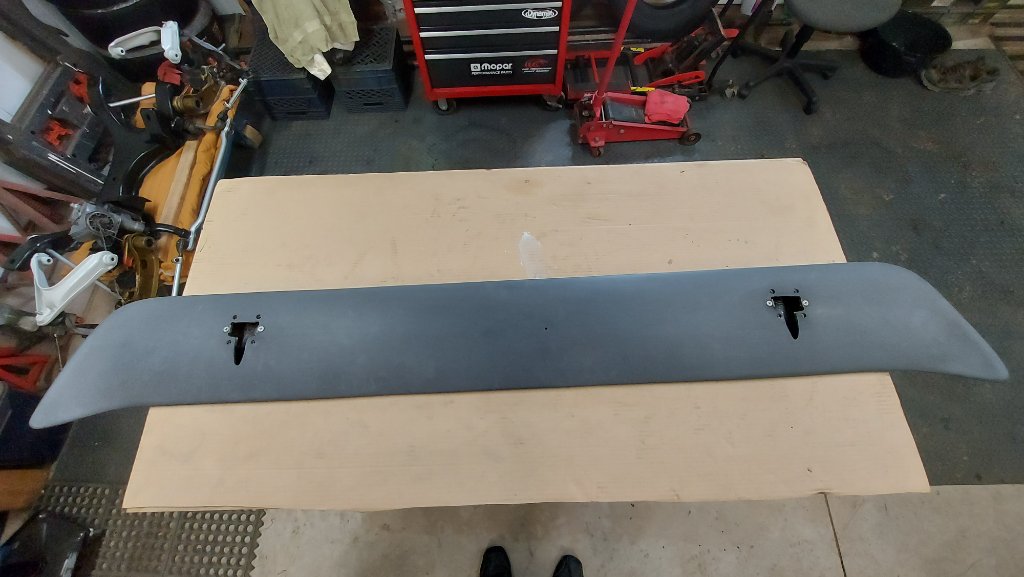

I did some horse trading and managed to get a gull wing.
May 22nd (5).jpg (87.72 KiB) Viewed 249113 times

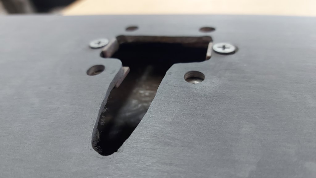

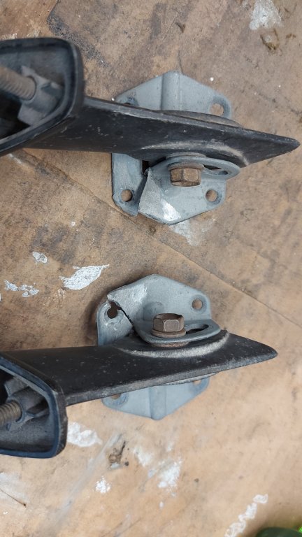

But, the mounting brackets are broken.
May 22nd (8).jpg (65.93 KiB) Viewed 249113 times
Probably due to the fact the mounting surface was not flat...you can see the reinforcement plates and the screw heads are not flush.

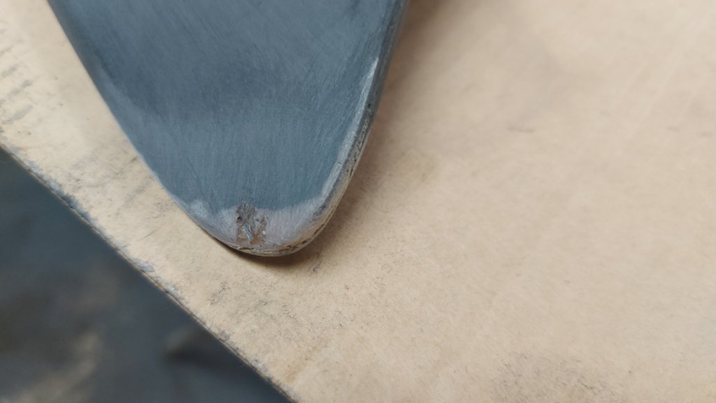

And the corner tips need a bit of putty and clean-up.
