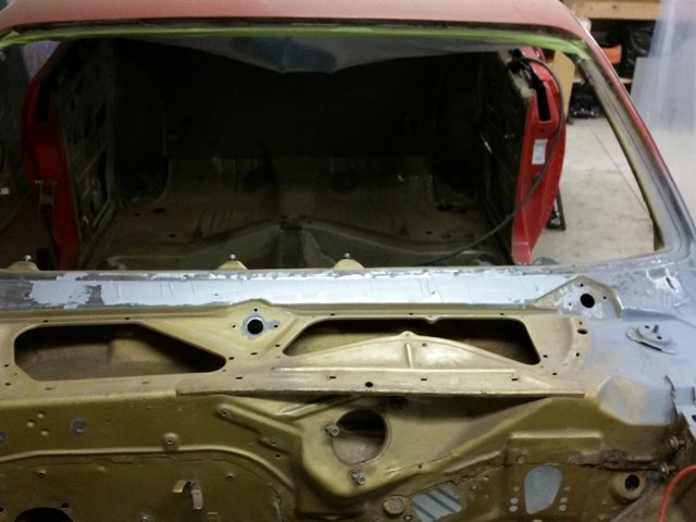

Little by little when I have the time. Prepped the passenger side door jamb and cowl and got an initial layer of paint on it. Will seam seal the cowl area and put a second coat on in the future. Cut the rust out of the lower passenger side windshield area and tack welded in the patch. I will work on getting the windshield channel patch made before doing final welding and paint.

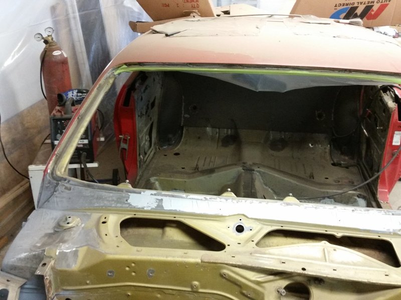

Making the rust go away! Used the existing window channel to fabricate the patch. Slapped on some weld through primer and zapped it down. Forgot to take a picture of the finished and polished welds before I zapped it with chassis black. On to the other corner of the windshield!

Driver's side windshield channel corner has been repaired. Got some primer on the driver's door jamb area too while the weather was nice. Still have a few more windshield channel repairs to go!

Keepin' it going. One last patch was needed in the lower windshield channel. The weather has been holding pretty good up here in the great white north. Was warm enough one day to get some primer laid down. Now on to the two bad spots in the upper section of the windshield channel.

Last two patches are in - the windshield channel is completely finished now. Also scored an Edelbrock Performer intake for my little souped-up 318 build.
