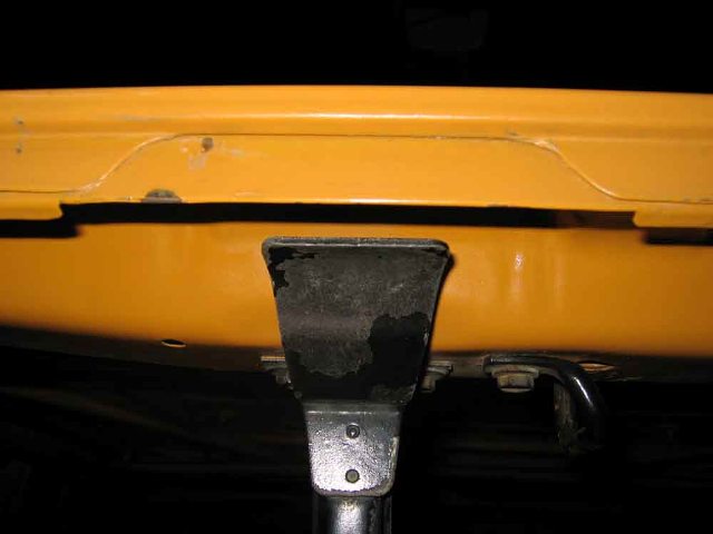

Re: Curious Yellow Runner
The hood on my butterscotch car has the same thing (no punch out where your hand goes to open the hood)farmboy70 wrote:After cleaning my original hood I found it is beyond repair.![]()
I did locate a Satellite hood that is going to be a doner hood replacement for my air grabber.
While comparing the two hoods side by side I found an odd thing on my hood, the area where your hand go's in to open is not punched out.
Anyone with a original have this too? Or just a mistake in the stamping?
Anyway the undersides are very close to matching other than the box area in the right corner of this picture is not present in the Sat hood, we will add it and a small structure hole is oval instead of round in my original.
I wonder why they would do that, it wouldn't add anything to the strength I would guess.
I thought maybe mine was that way because of the early build and a new body style for the year. Not all the bugs worked out yet.
mine is an early build car too, built at the LA plant in august
