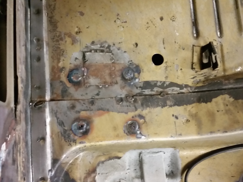

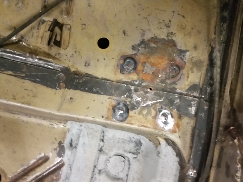

So, my progress for this weekend was plug welding up the holes that held the roll cage in.
With some help from my assistant (my wife) I was able to get that done.

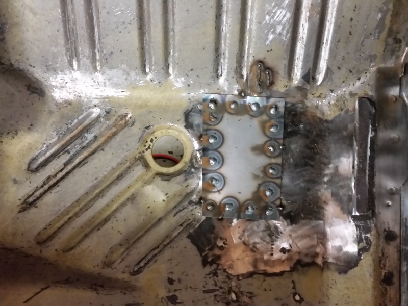

Then I started working on the passenger side floor where the front mount was for the roll bar.
I'm thinking of putting a patch on it like this.....

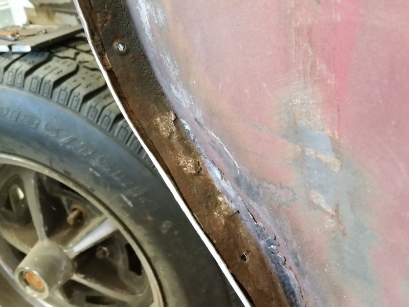

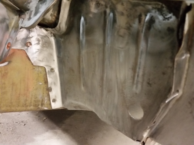

After I get done with that, I'll be moving on to this area.

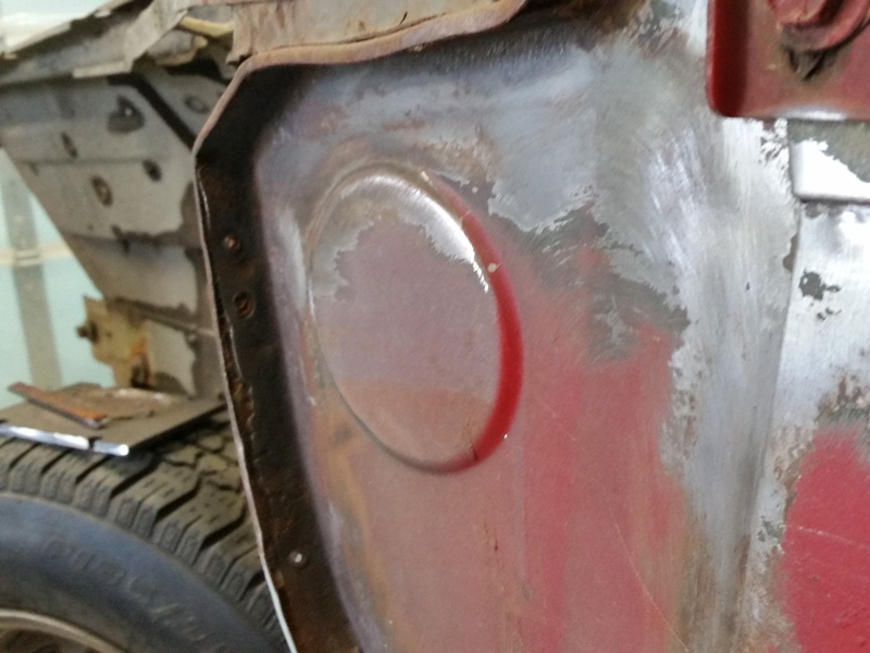

Specifically where the lip is.
as it needs some work.

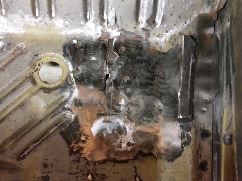

First I patched up the area where the plate for the roll cage was on the passenger side floor.
Here it is cleaned up.

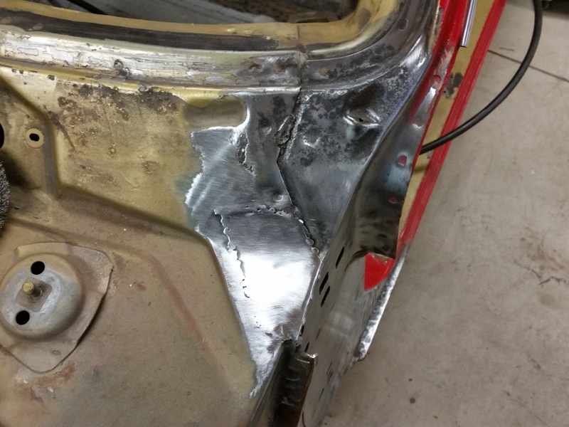

Next I found another surgery spot on the top of the cowl on the drivers side.
This area required one patch on top of another.
This is the first patch.
same patch cleaned up.

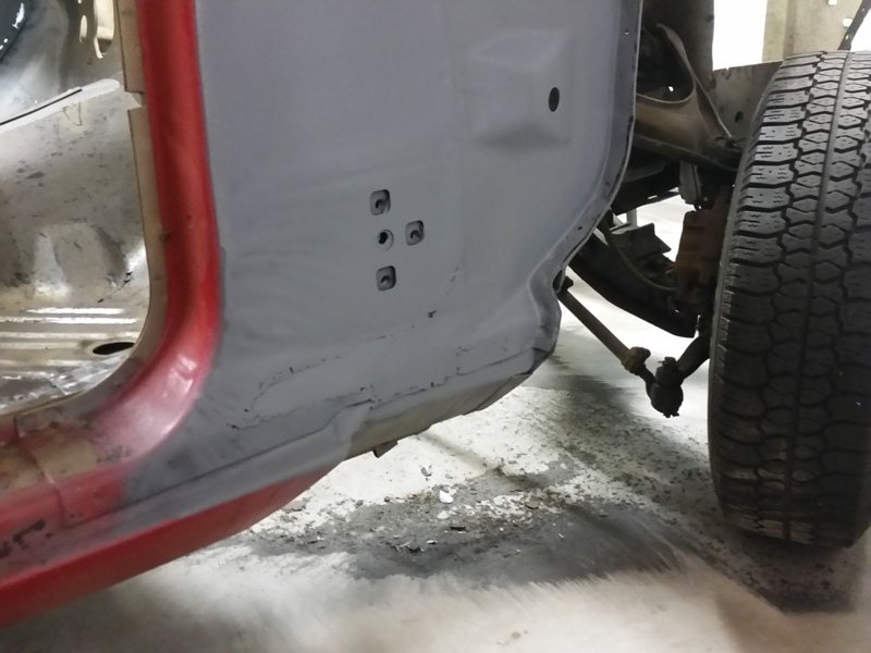

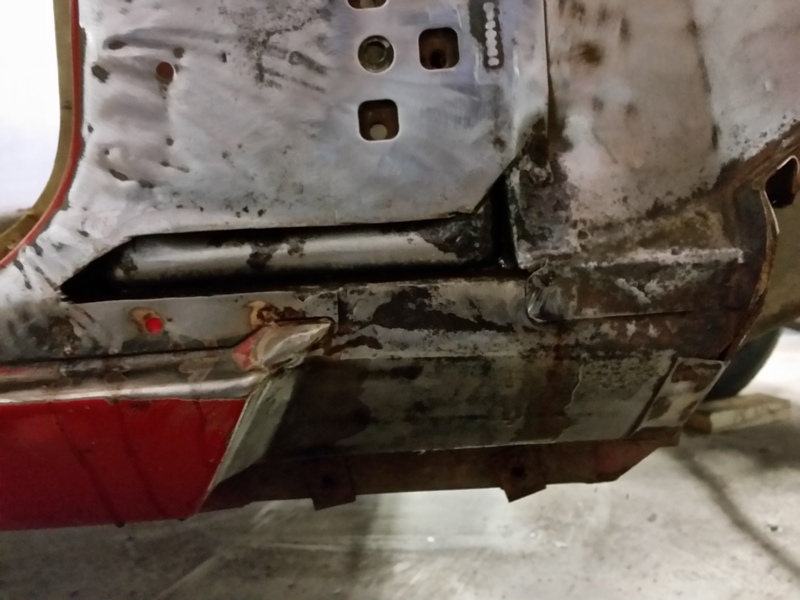

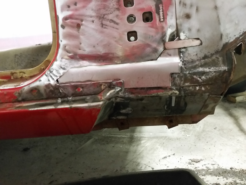

The final area that needs attention is the bottom of that side piece just to the left of the bottom door hinge.
That will be for next weekend.

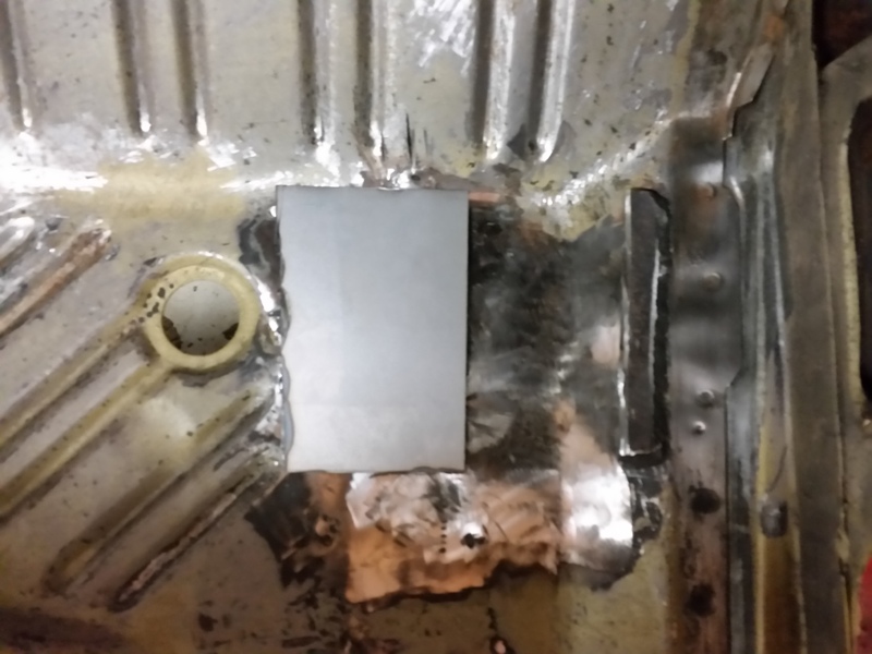

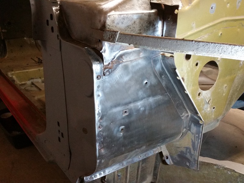

So I was able to put a patch in and finish up the drivers side. Unfortunately I forgot to take a picture of that area, but I'll post it the next time I get into the garage. Now to tackle the passenger side - here's what I have.

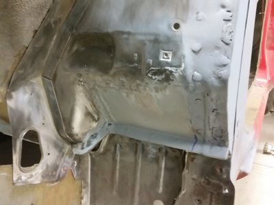

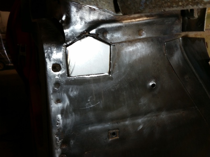

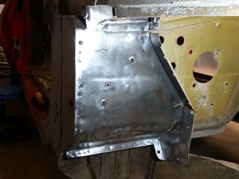

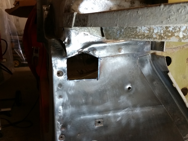

so I cut out the rusted area.
and fitted the patch (with magnet holding it in place.
before welding it in I painted inside the opening with rust encapsulator and then some paint. Then welded the patch in and put a coat of primer on the whole area.
I'll add that I do use the copper weld primer on the backside of any patches to prevent further rust after they have been welded in.

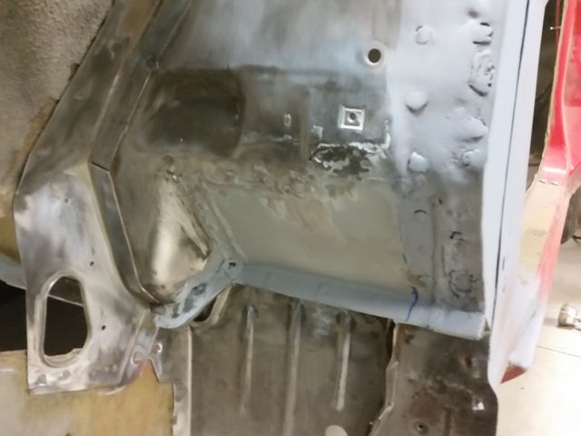

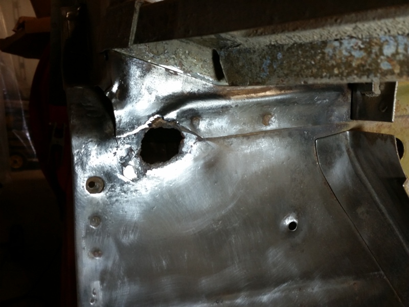

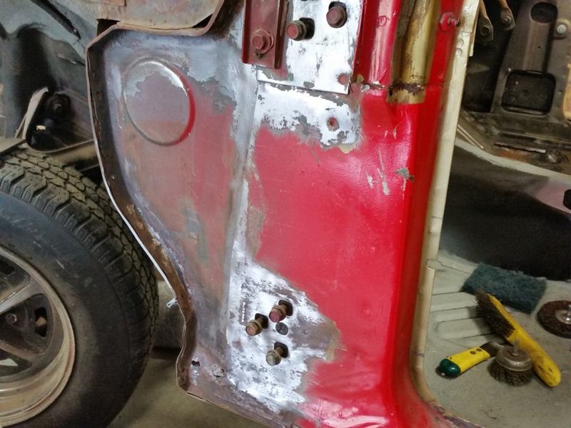

So, onto the pass side front area, I started prepping the area for primer.

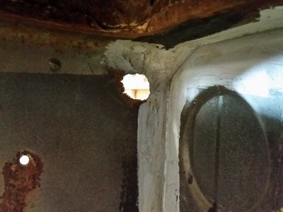

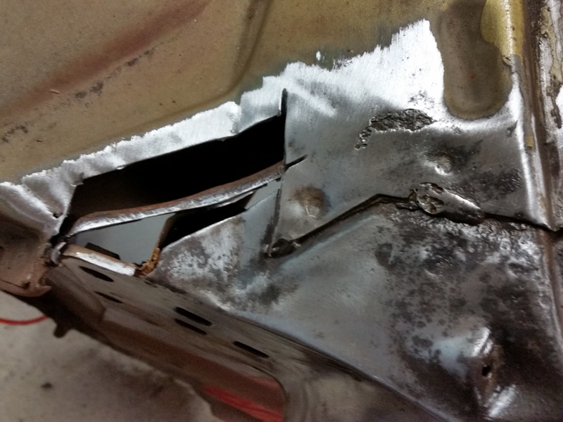

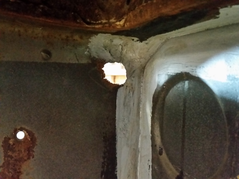

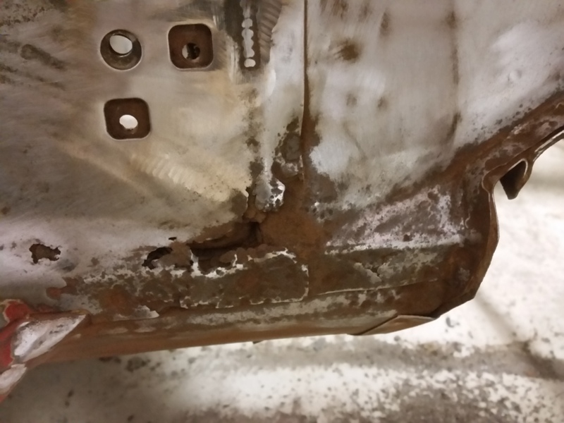

Then *oops* I find this.

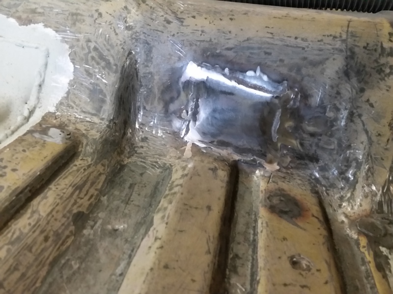

here's from the inside.

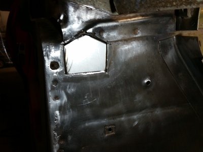

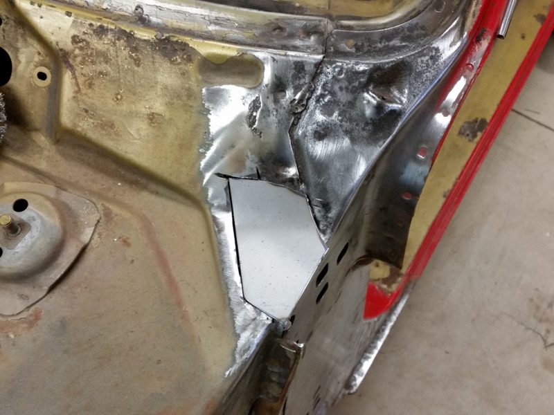

So trim it up for a patch.
And make the patch and get it ready for welding.

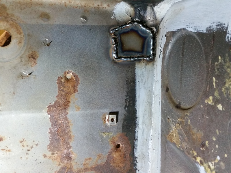

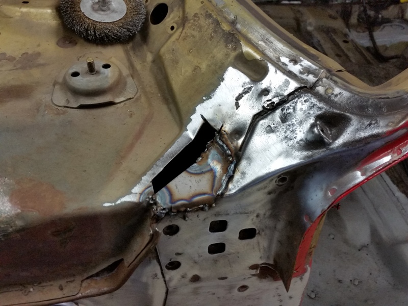

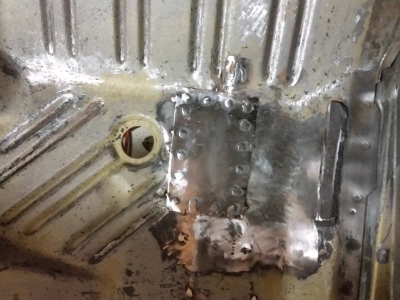

Here's the welding from inside the car.
And there it is all ready for some primer.

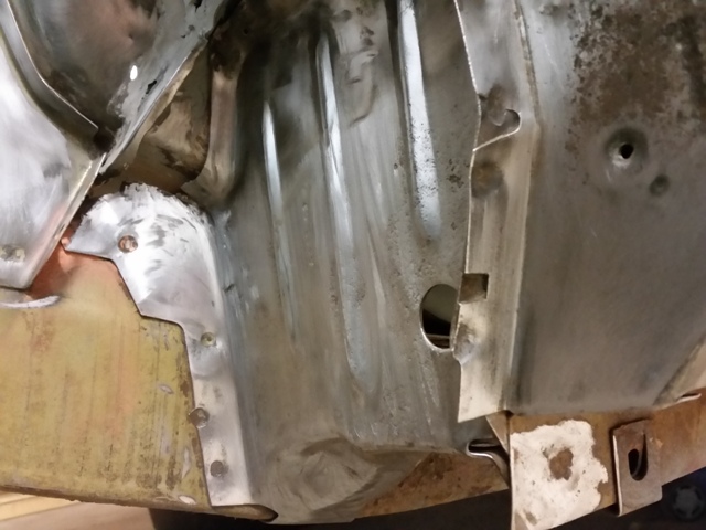

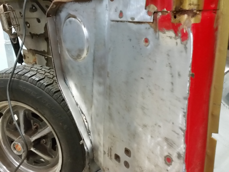

So back to the drivers side and I started at the bottom, that area cleaned up well.
Here's the middle section.

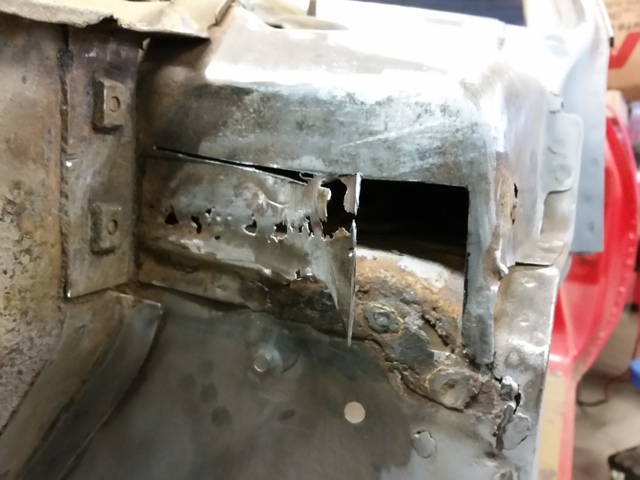

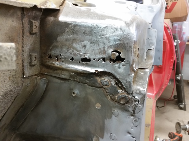

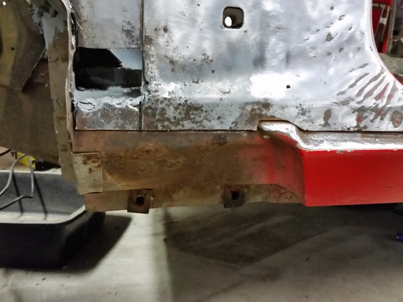

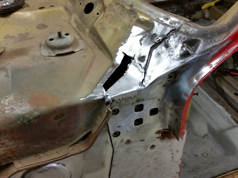

Then I get to the top and find this.
So it's time to cut it all out.
