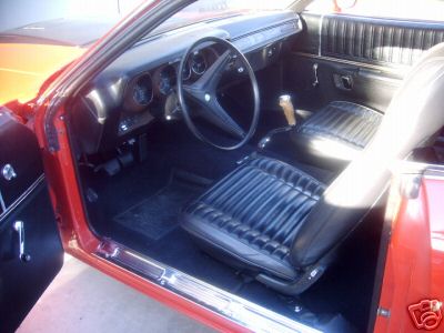

Okay. Try this one...
Don't have a legible picture of the fender tag, but this 72 four speed car was coded for C56 bucket seats (but no C16). That looks like a bench seat type shifter to me.
Post by 71440 gtx » Thu Jul 31, 2008 10:37 pm
yes its bench seat type shifter
:beer:
Posts: 515
Post by 471Magnum » Thu Jul 31, 2008 10:49 pm
After a closer comparison, it looks like the location is actually the same as a console car. I guess it's just an incorrect bench shifter handle that's throwing me a curve.
