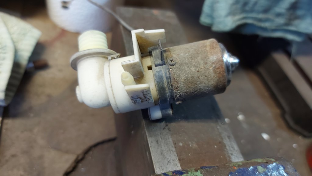

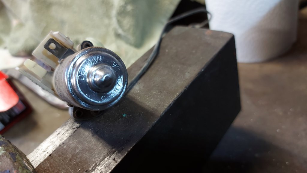

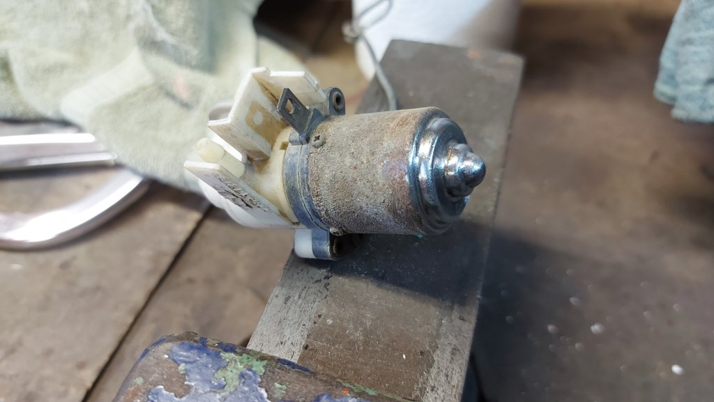

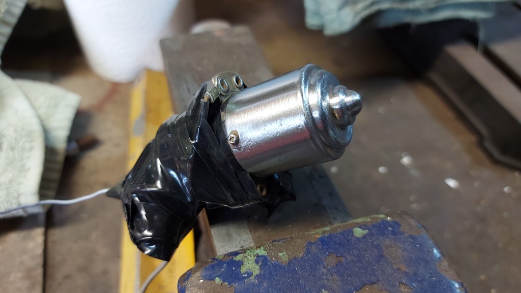

So continuing on, I found the original windshield washer pump.
The washer bottle had a big crack in it and was very brittle, So I bought a reproduction one at my local Mopar car show.
The pump itself was looking ruff, but it does work (I tested it).
Dec 29th (1).jpg (76.24 KiB) Viewed 273228 times
Dec 29th (2).jpg (62.96 KiB) Viewed 273228 times
So it's time to give it a clean-up.
Dec 29th (3).jpg (67.8 KiB) Viewed 273228 times
Dec 29th (10).jpg (74.97 KiB) Viewed 273228 times
Right down to bare steel.
Dec 29th (11).jpg (71.63 KiB) Viewed 273228 times
Then I'll shoot some clearcoat on it and install it to the new washer bottle.

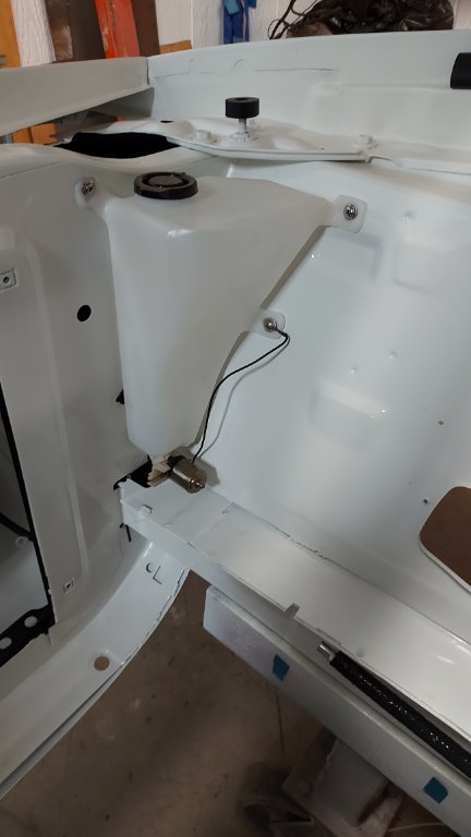

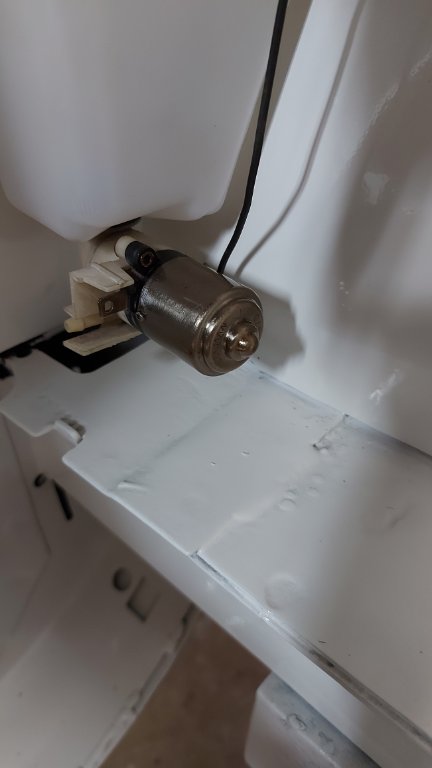

Here's the washer bottle with pump installed.
Dec 31st (3).jpg (36.73 KiB) Viewed 273228 times
Dec 31st (4).jpg (27.57 KiB) Viewed 273228 times

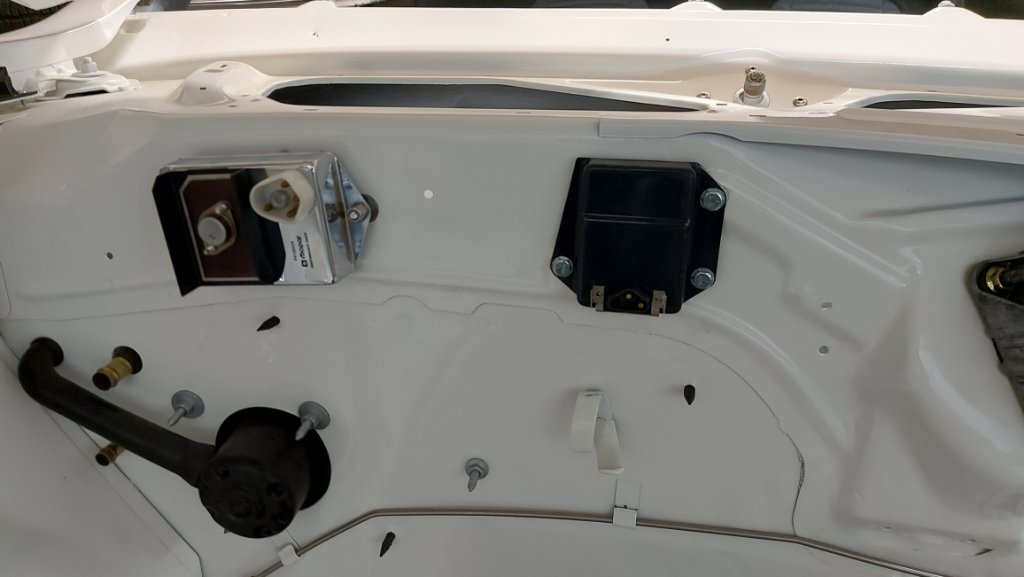

Next its time to mount some accessories in the engine bay.

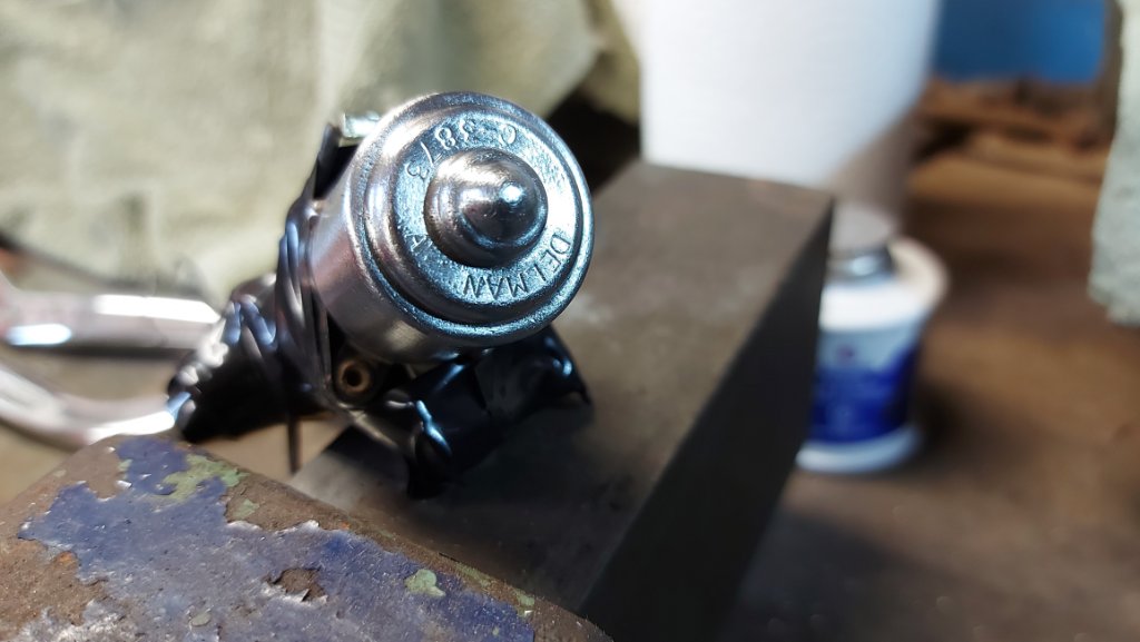

First is the chrome ignition box.
Dec 31st (1).jpg (50.72 KiB) Viewed 273228 times

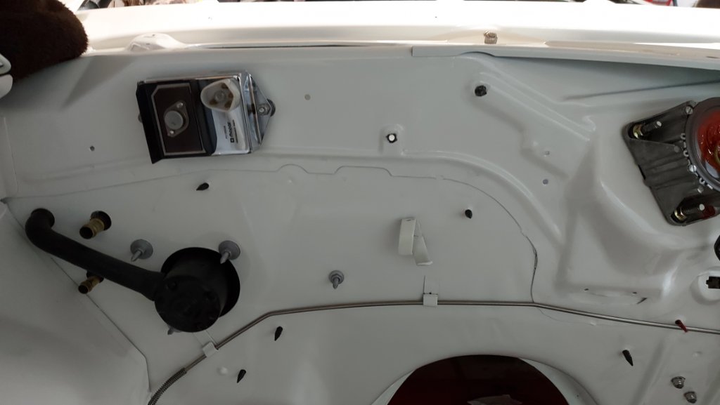

Next is the voltage regulator..
Dec 31st (7).jpg (56.15 KiB) Viewed 273228 times

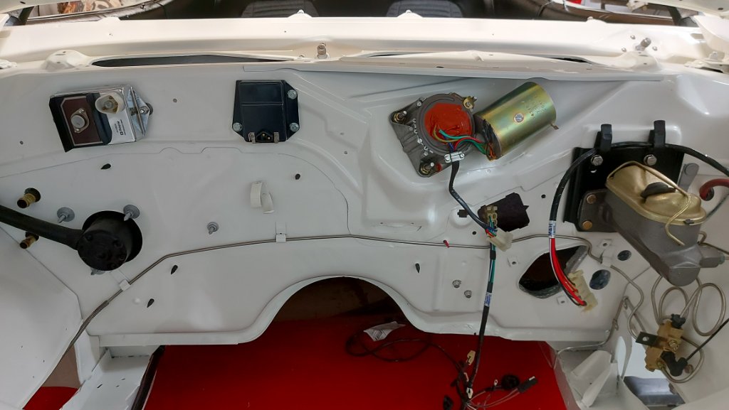

Here's the firewall look so far.
Dec 31st (5).jpg (84.75 KiB) Viewed 273228 times
I still need to mount the coil and the throttle cable and the beep beep horn.

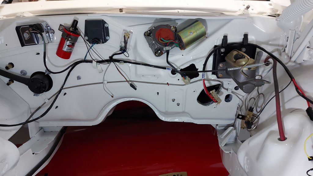

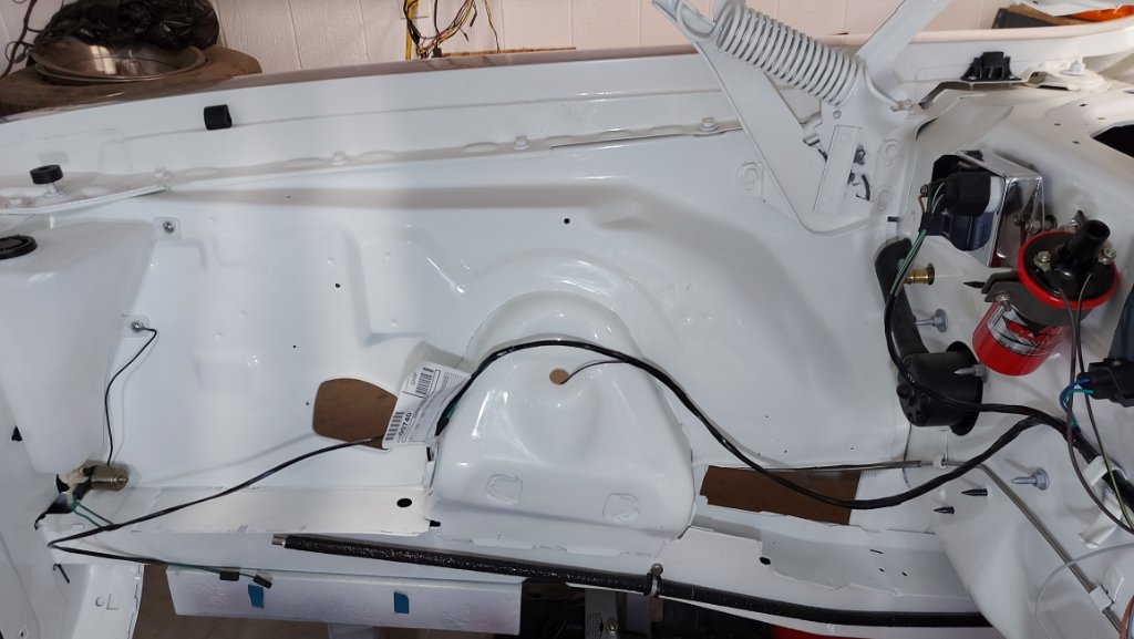

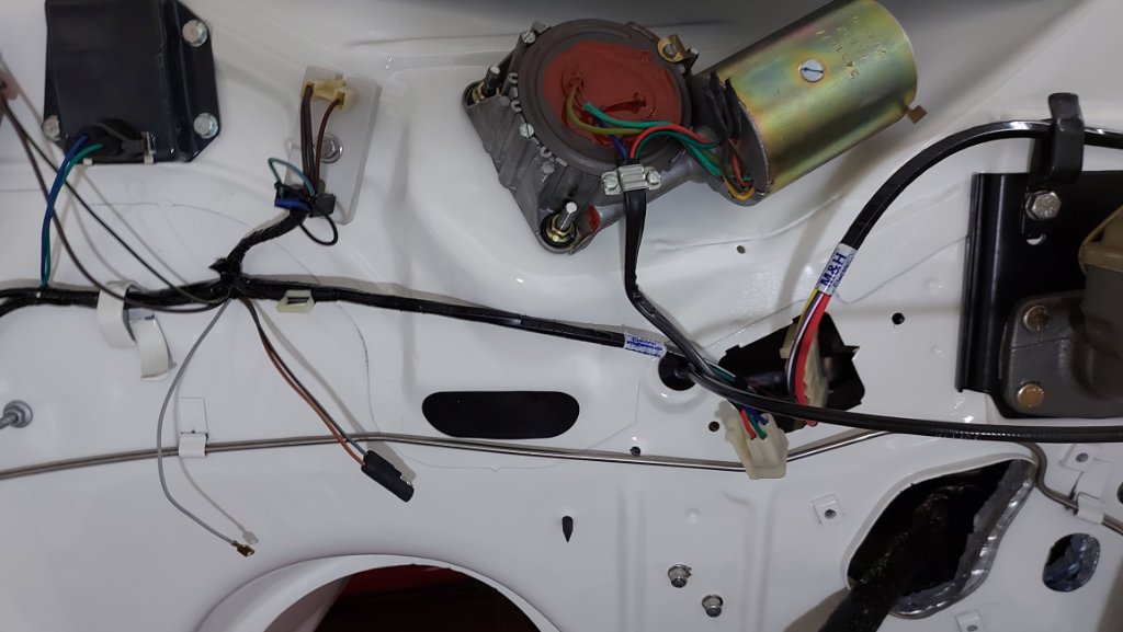

Today I was able to mount the coil and the ballast resistor as well as the throttle cable and hook up the wiring harness to all the bits.
Jan 8th, 2023 (2).jpg (94.73 KiB) Viewed 273219 times

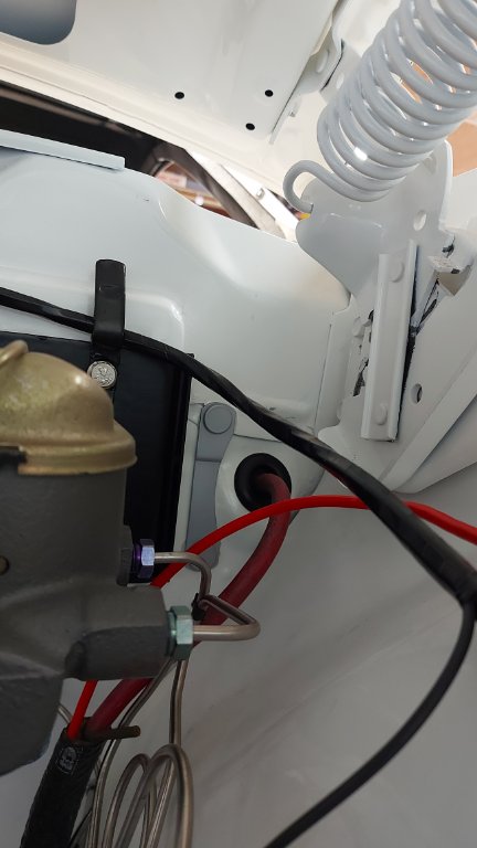

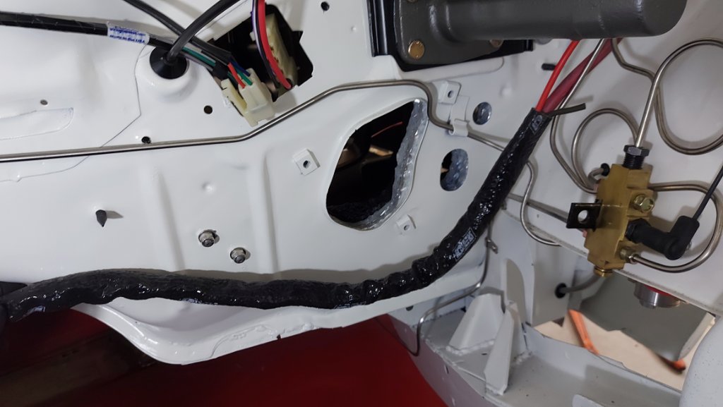

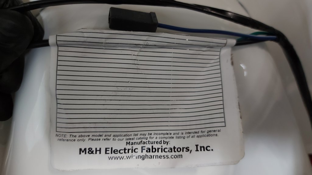

I also provided a positive feed wire from the starter solenoid to the headlight relay harness. I wrapped the feed wire into the existing wiring harness that runs to the front of the car.
Jan 8th, 2023 (1).jpg (72.4 KiB) Viewed 273219 times

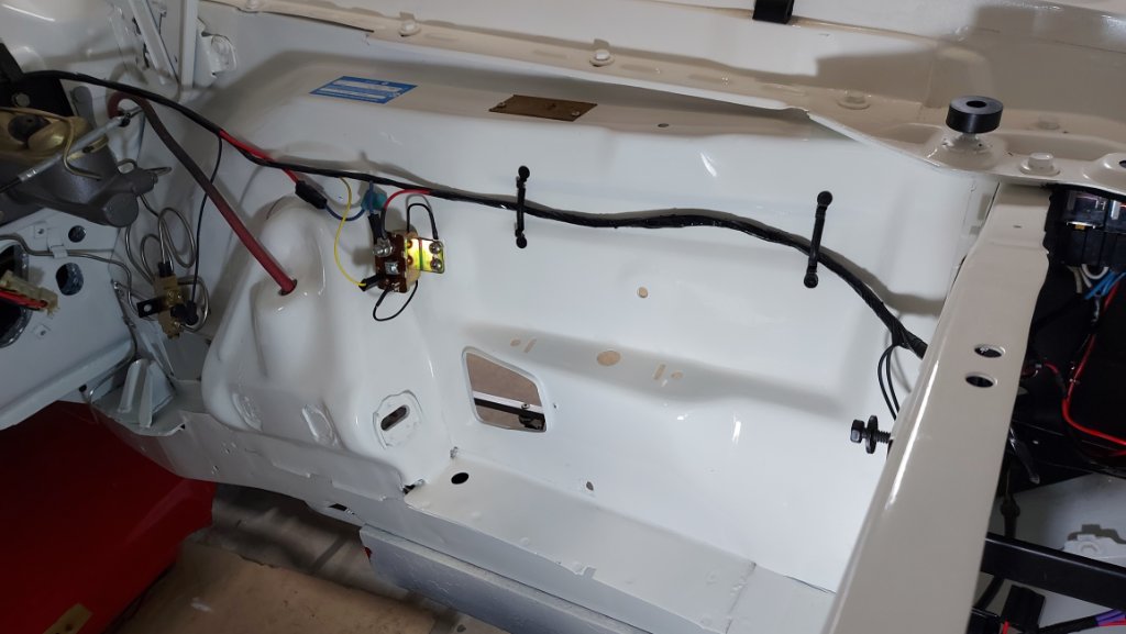

Here's some more of the wiring harness used on the passenger side.
Jan 7th, 2023 (1).jpg (67.79 KiB) Viewed 273219 times
Jan 7th, 2023 (2).jpg (72.5 KiB) Viewed 273219 times
Jan 8th, 2023 (4).jpg (83.24 KiB) Viewed 273219 times

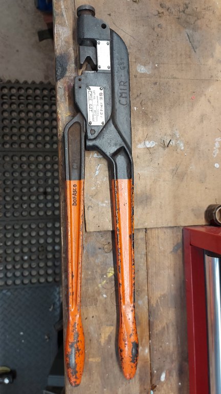

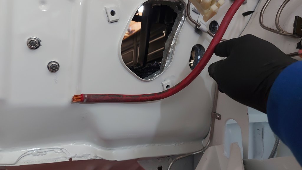

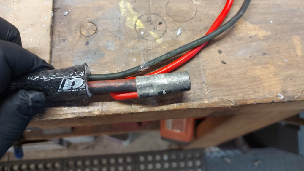

Today I was able to finish up the positive cable that runs to the starter.
Since I'm leaving the battery in the trunk, I needed to connect the starter cable to the battery cable.
So, I borrowed a big ass crimper from my buddy Lloyd.
Jan 22th,2023 (9).jpg (69.21 KiB) Viewed 273154 times

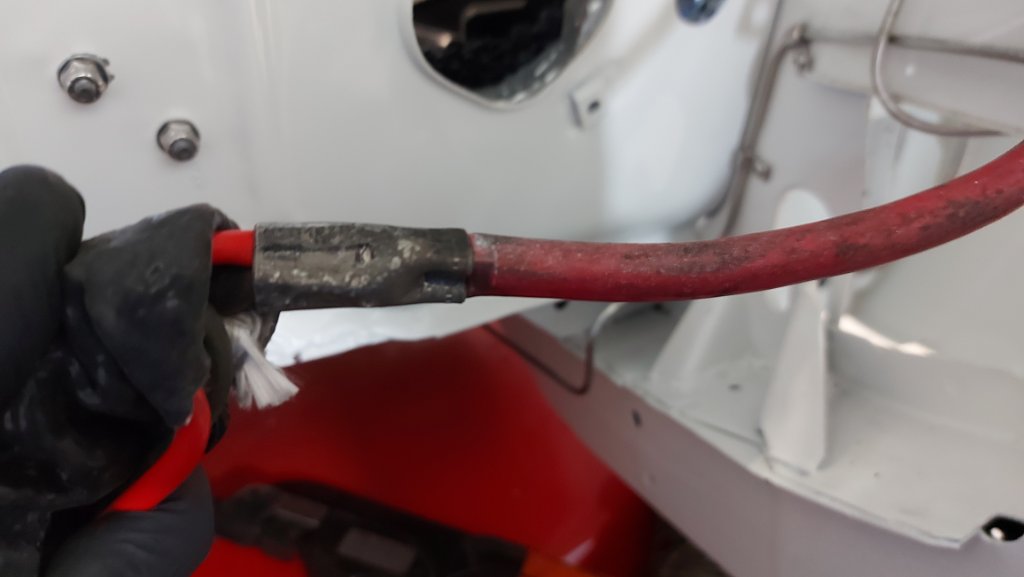

Then, cleaned up the battery cable end.
Jan 22th,2023 (2).jpg (54.91 KiB) Viewed 273154 times
Now the starter cable end along with some DEI heat sleeving.
Jan 22th,2023 (3).jpg (115.76 KiB) Viewed 273154 times
Here's the big butt connector on the starter cable side.
Jan 22th,2023 (4).jpg (83.31 KiB) Viewed 273154 times

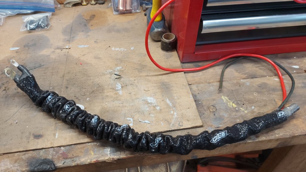

Now the whole thing together.
Jan 22th,2023 (6).jpg (44.73 KiB) Viewed 273154 times
I left the smaller 2 wires that run to the solenoid longer - when the engine is in the car and the starter hooked up I'll be able to finish up those two wires.

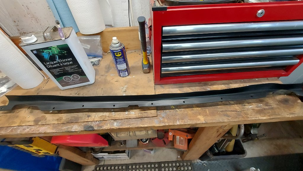

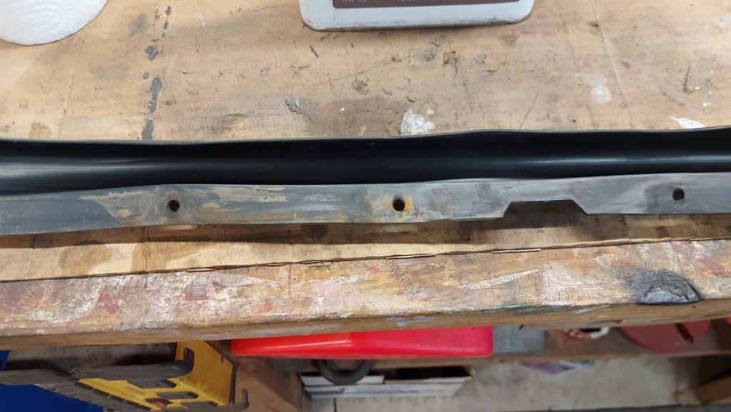

After that was done, I tackled the under hood to rad support seal.
The original one wasn't broken or ripped, just dirty.
Jan 22th,2023 (12).jpg (104.71 KiB) Viewed 273154 times
Jan 22th,2023 (11).jpg (105.41 KiB) Viewed 273154 times
So I used a combination of lacquer thinner along with some WD40 to clean it up.
Jan 22th,2023 (13).jpg (105.14 KiB) Viewed 273154 times
Jan 22th,2023 (14).jpg (105.05 KiB) Viewed 273154 times
Jan 22th,2023 (15).jpg (132.64 KiB) Viewed 273154 times
So far so good.

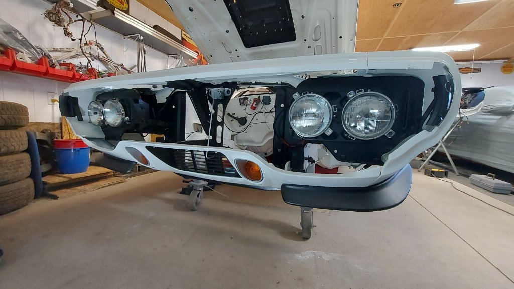

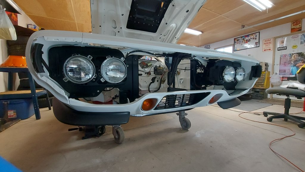

Next was the high beams - I couldn't wait for Amazon to get the high beams as they are on back order, so I bought a set at my local auto parts place at twice the price each... :mad:
Feb 11th (29).jpg (101.55 KiB) Viewed 272994 times
Now she has 4 eyes...
Feb 11th (30).jpg (112.6 KiB) Viewed 272994 times
Feb 11th (31).jpg (113.61 KiB) Viewed 272994 times

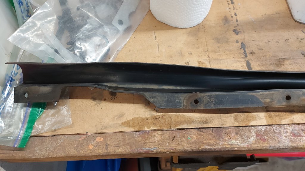

Post by 71Beeper » Sat Feb 11, 2023 6:14 pm

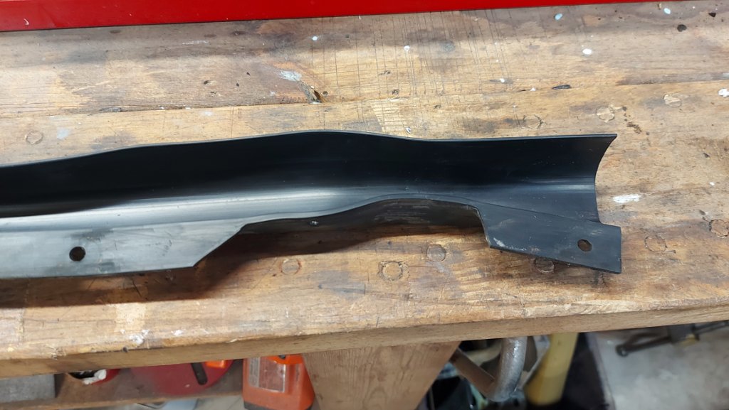

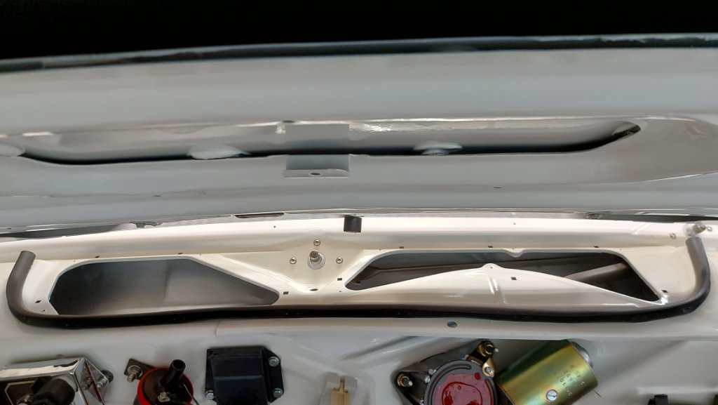

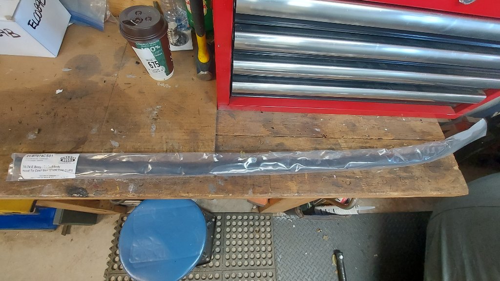

Next item is the cowl to under hood seal.
Feb 11th (24).jpg (78.73 KiB) Viewed 272994 times
Feb 11th (25).jpg (128.14 KiB) Viewed 272994 times
And mounted.
Feb 11th.jpg (67.09 KiB) Viewed 272994 times

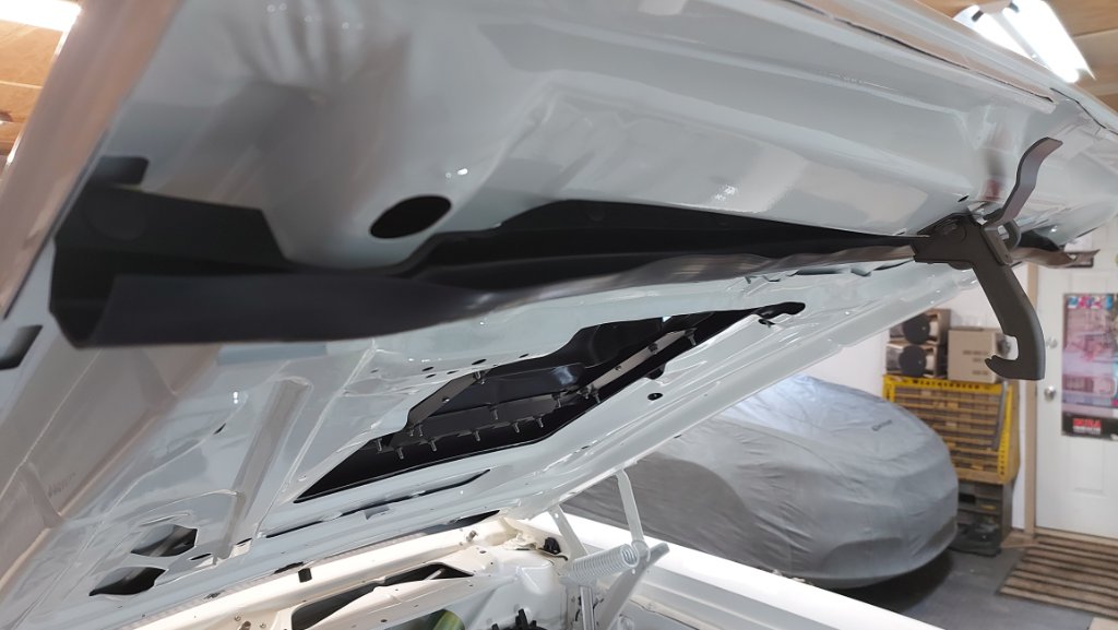

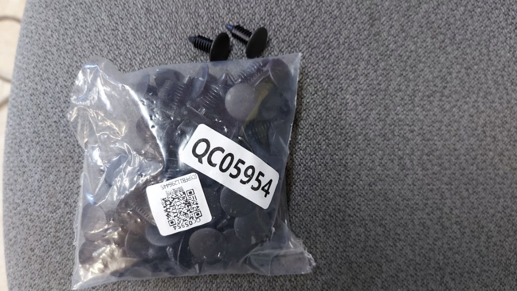

Next thing is the under hood to rad support seal.
Instead of using the steel clips like the factory did, I went ahead and bought these ribbed push pins from Amazon.
Feb 11th (19).jpg (133.11 KiB) Viewed 272994 times
And installed.
Feb 11th (21).jpg (79.98 KiB) Viewed 272994 times

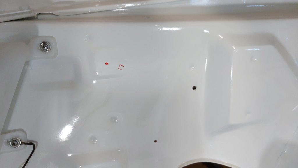

Post by 71Beeper » Sat Feb 11, 2023 6:18 pm

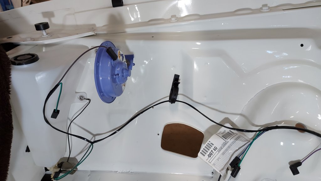

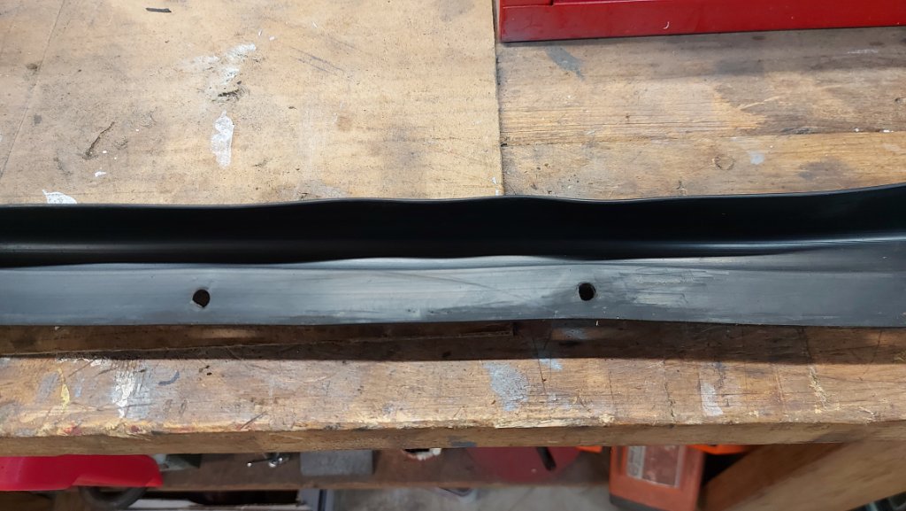

Last item is the beep beep horn.

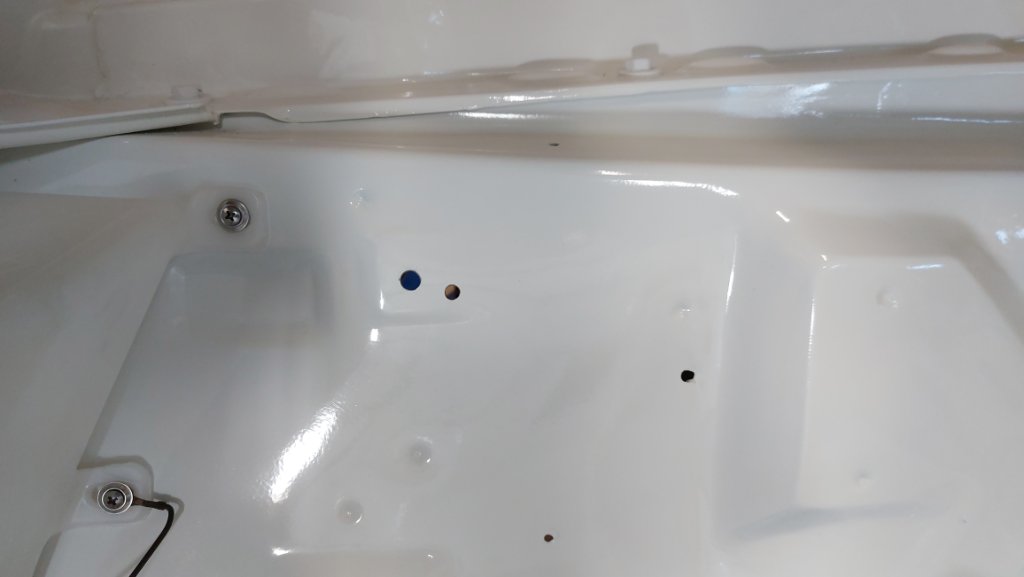

Unfortunately my repop inner fender did not come pre-drilled for the horn mounting.
I had to do it myself.
First, locate the 2 holes that will have to be drilled.... :shock:
Feb 11th (32).jpg (29.97 KiB) Viewed 272994 times
Next, do the deed.
Feb 11th (33).jpg (31.04 KiB) Viewed 272994 times
Lastly install the horn and all is good.
Feb 11th (34).jpg (67.01 KiB) Viewed 272994 times
Feb 11th (35).jpg (42.58 KiB) Viewed 272994 times

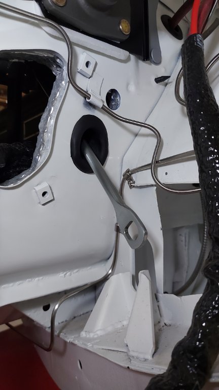

The clutch rod that goes thru the firewall along with it's boot.
Feb 20th (15).jpg (51.31 KiB) Viewed 272861 times

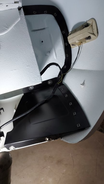

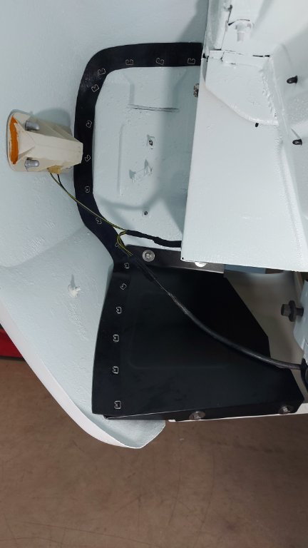

Next was the splash shields that fit under the headlights.
Feb 20th (10).jpg (47.23 KiB) Viewed 272861 times
Feb 20th (11).jpg (37.2 KiB) Viewed 272861 times

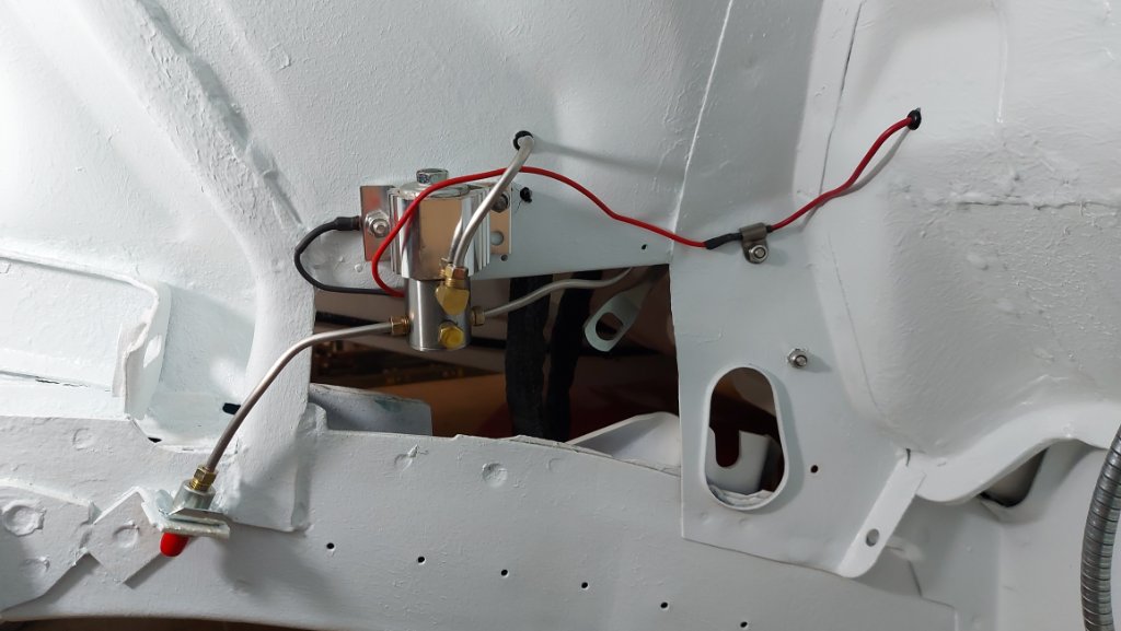

Then hook-up the power wire for the line-loc.
Feb 20th (12).jpg (76.39 KiB) Viewed 272861 times

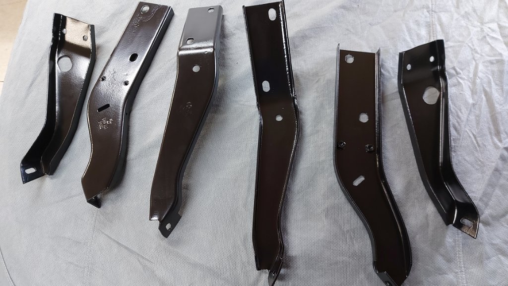

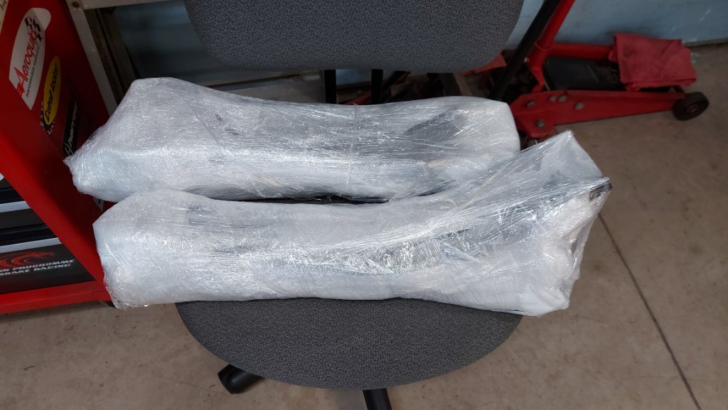

Then it was time to unwrap the front bumper brackets I had powder coated.
Feb 20th (1).jpg (105.23 KiB) Viewed 272861 times
Post by 71Beeper » Mon Feb 20, 2023 5:43 pm
And here they are - they turned out nice.
Feb 20th (8).jpg (143.35 KiB) Viewed 272861 times

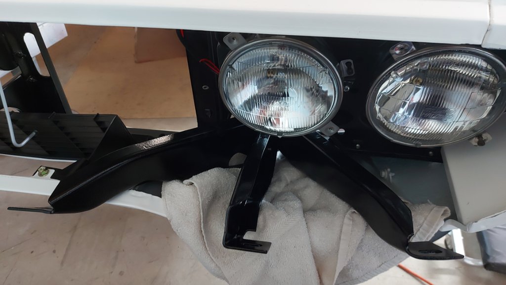

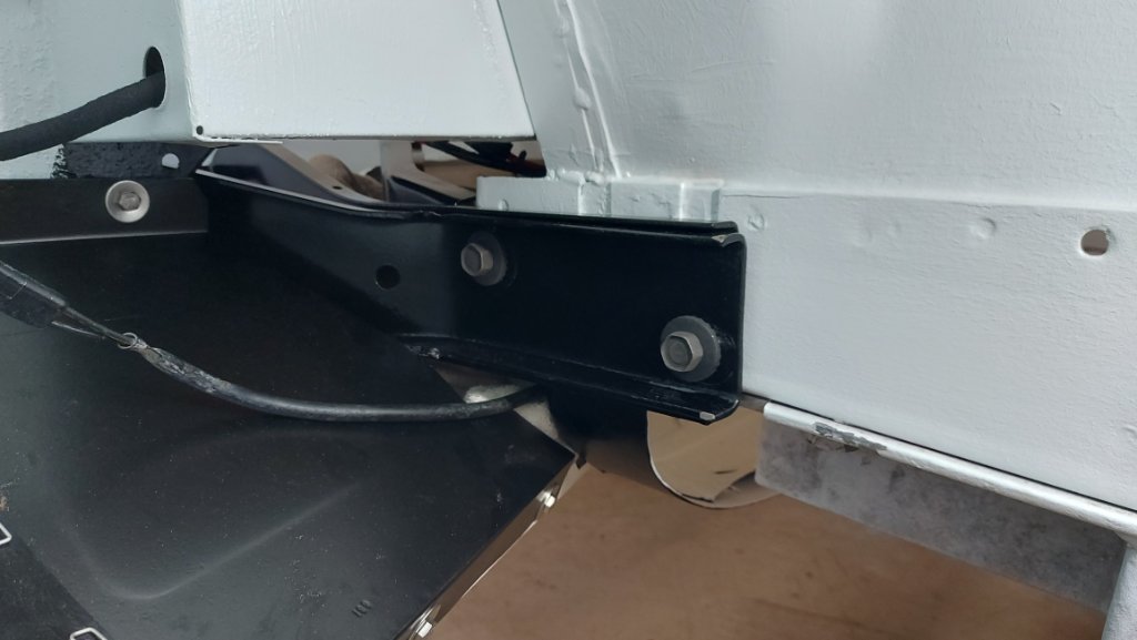

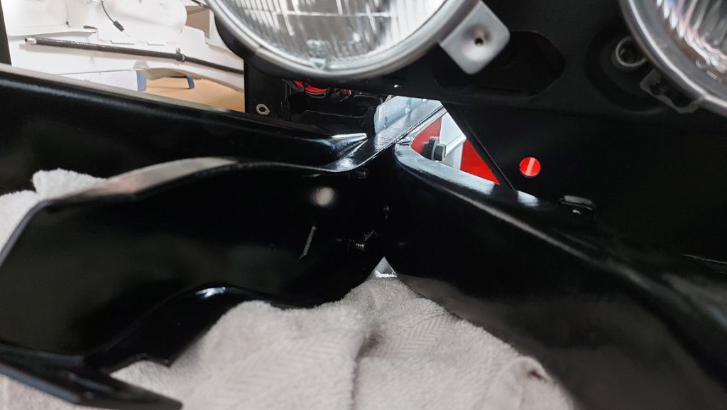

Now to trial test fit the drivers side bumper brackets.
Feb 20th (13).jpg (59.99 KiB) Viewed 272861 times
Feb 20th (14).jpg (87.12 KiB) Viewed 272861 times
Feb 20th.jpg (65.95 KiB) Viewed 272861 times

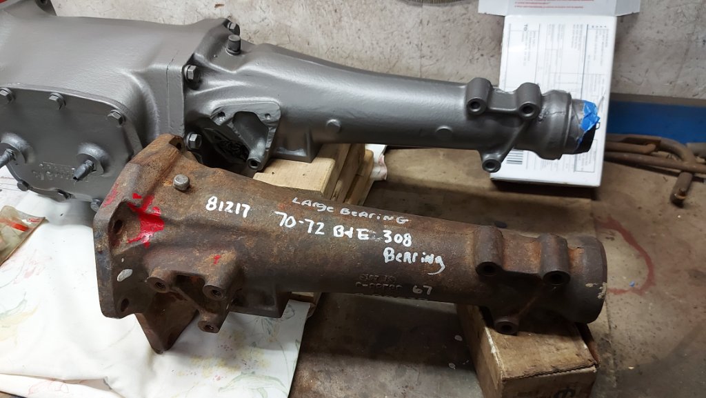

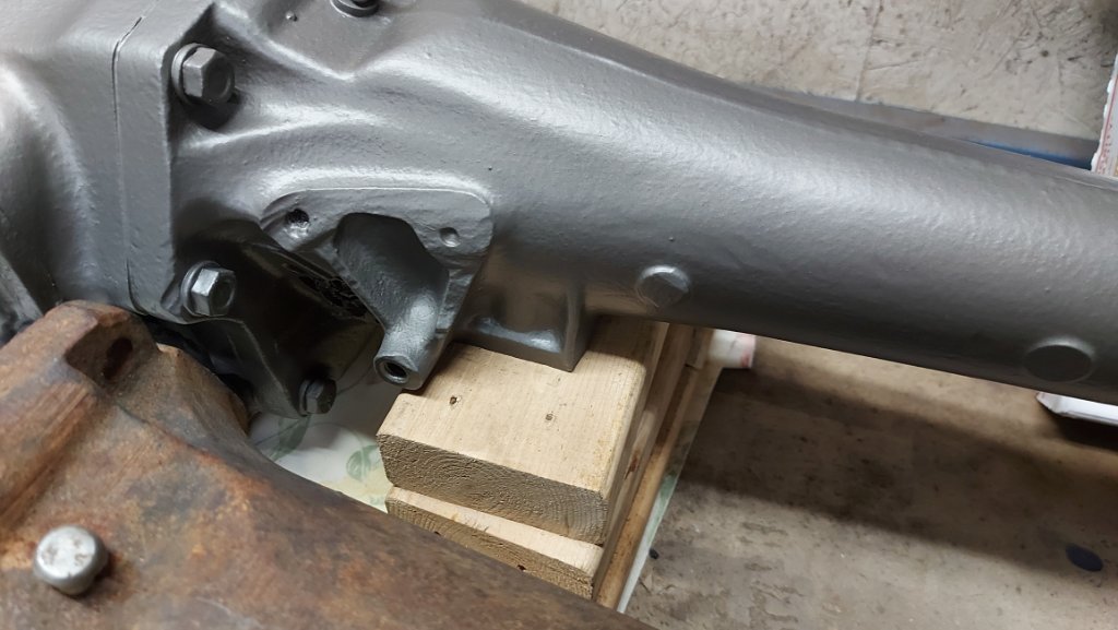

I was able to find another tail housing for my 4 speed locally thru a Mopar buddy.
Feb 26th (3).jpg (100.37 KiB) Viewed 272817 times
I need to change it due to the original one's front mount pad for the shifter box is unrepairable.
Feb 26th (4).jpg (91.71 KiB) Viewed 272817 times
Bonus is that it comes with the driveshaft bushing already in place.
Feb 26th (1).jpg (74.91 KiB) Viewed 272817 times
So off it goes into the evaporust vat to get cleaned up.

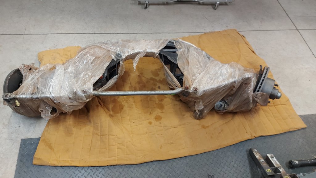

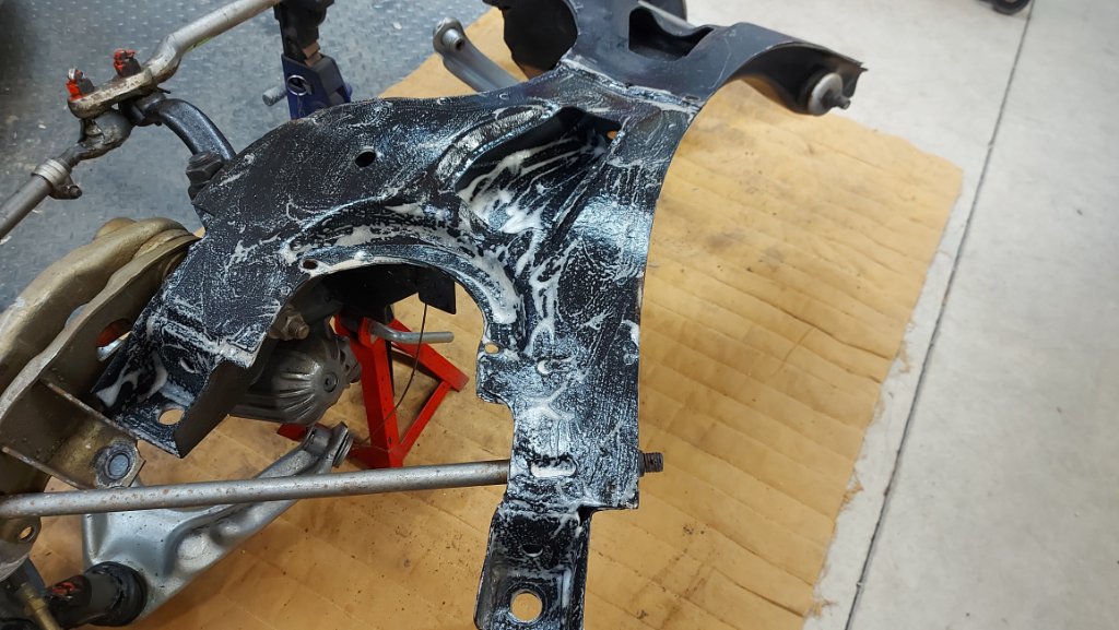

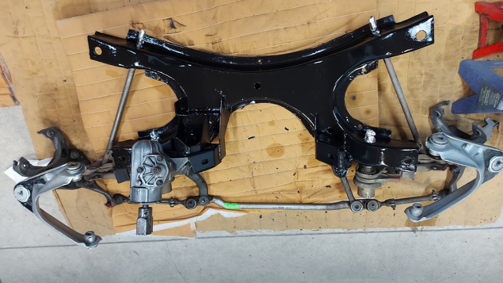

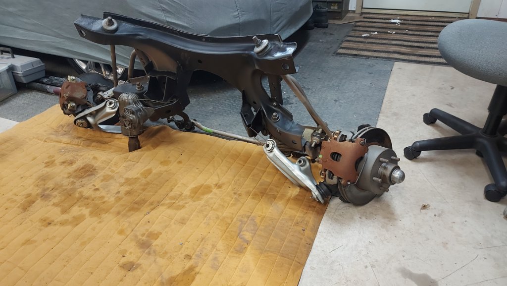

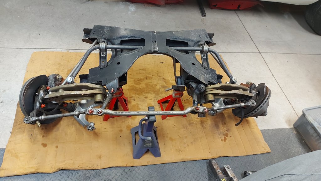

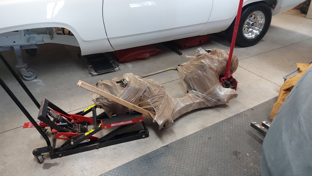

In the meantime it's time to drag out the engine K-member and get started on cleaning it up.
It's a 2 hydraulic jack trolley job to move it.
Feb 26th (10).jpg (102.04 KiB) Viewed 272817 times
Feb 26th (12).jpg (98.92 KiB) Viewed 272817 times

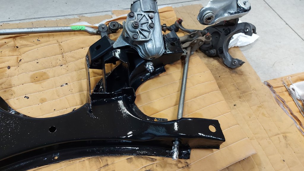

Post by 71Beeper » Sun Feb 26, 2023 4:09 pm
Pulling the shrink wrap off, I get this....
Feb 26th (13).jpg (110.31 KiB) Viewed 272816 times
I'll start with the underside first.
Feb 26th (15).jpg (110.99 KiB) Viewed 272816 times
Clean up the dirt and other stuff off of it with this.
Feb 26th (19).jpg (57.09 KiB) Viewed 272816 times
See the foaming action.... :D
Feb 26th (18).jpg (131.68 KiB) Viewed 272816 times
Next, scuff it with a coarse scotch brite pad then apply some semi-gloss black. It looks shiny now because the paint has just been applied.
Feb 26th (24).jpg (109.28 KiB) Viewed 272816 times

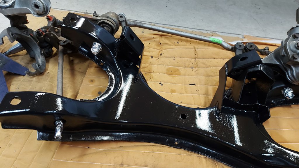

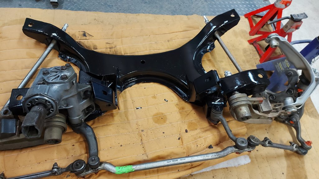

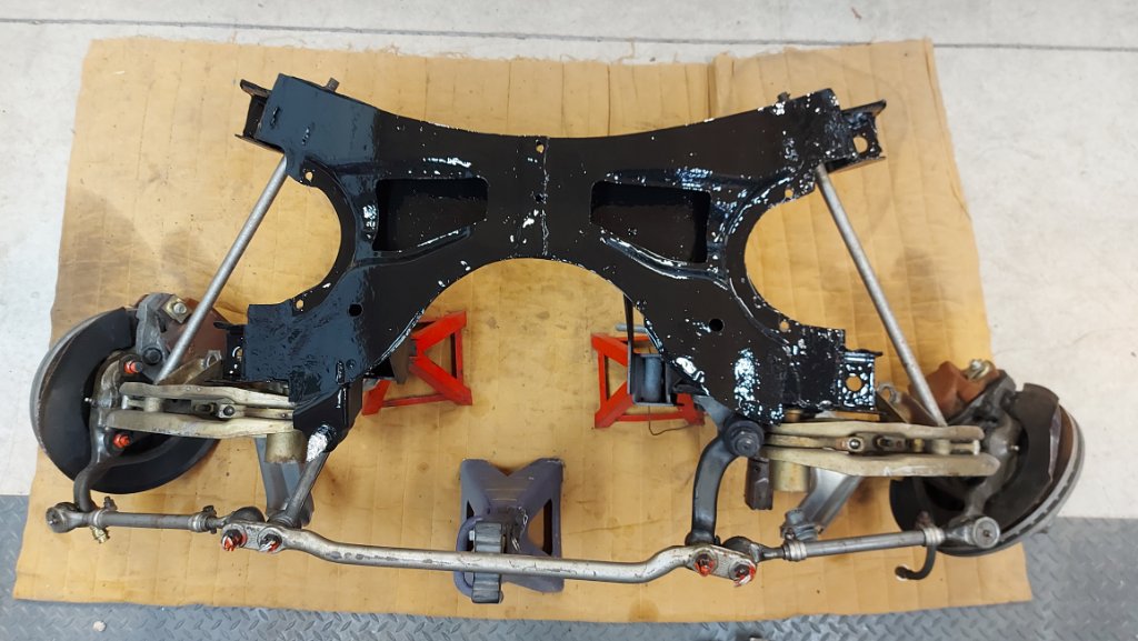

Post by 71Beeper » Sat Mar 04, 2023 5:50 pm
I had time today to flip the K-member over and paint the topside.
March 4th 2023 (1).jpg (119.4 KiB) Viewed 272757 times
March 4th 2023 (2).jpg (118.19 KiB) Viewed 272757 times
March 4th 2023 (3).jpg (119.72 KiB) Viewed 272757 times
March 4th 2023 (4).jpg (126.31 KiB) Viewed 272757 times
