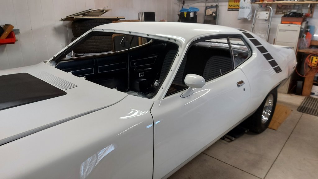

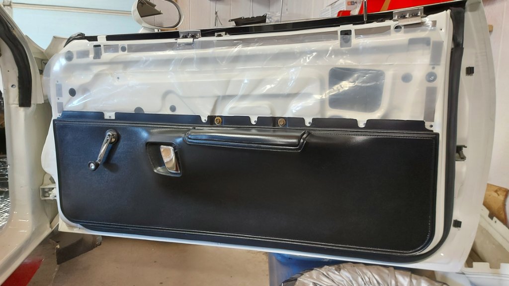

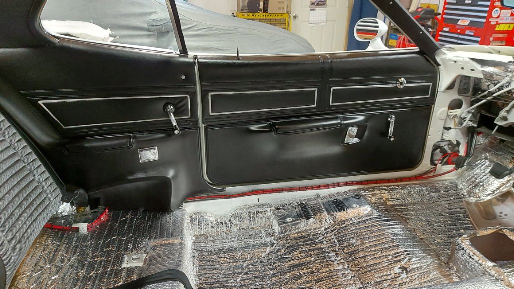

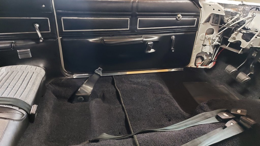

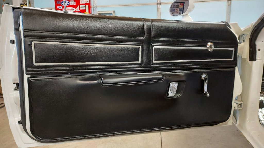

Post by 71Beeper » Sun Jan 30, 2022 6:20 pm

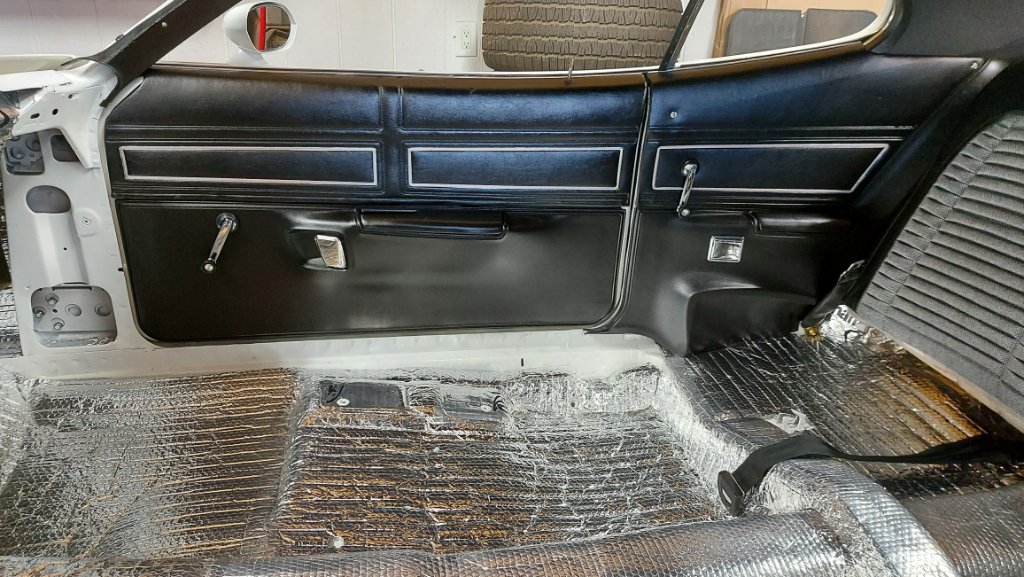

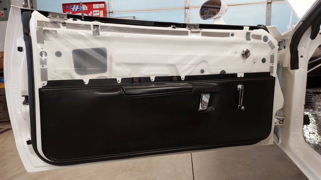

With alot of grunting and groaning and swearing I might add, the door panels are finally on.
I was surprised that the lower panels gave me more grief than the upper panels.
I figured it was gonna be the other way round.
Jan 30th (1).jpg (81.58 KiB) Viewed 91733 times
Jan 30th (2).jpg (89.15 KiB) Viewed 91733 times
Jan 30th (3).jpg (105.4 KiB) Viewed 91733 times
Jan 30th (4).jpg (171.13 KiB) Viewed 91733 times
Jan 30th (5).jpg (162.87 KiB) Viewed 91733 times

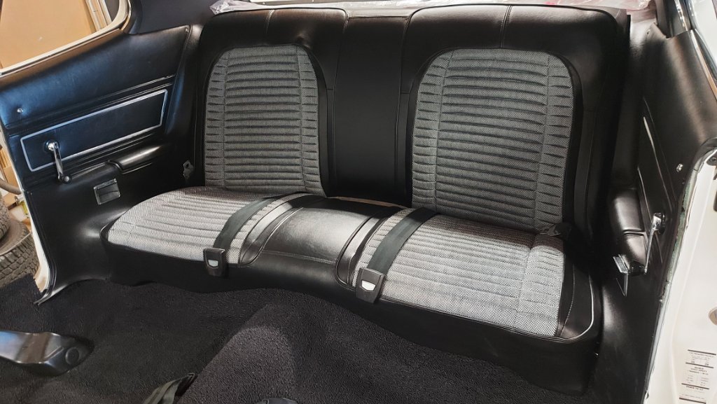

Post by 71Beeper » Sun Jan 30, 2022 6:23 pm
I also installed the rear seatbelts.
Jan 30th (7).jpg (182.43 KiB) Viewed 91732 times
It's nice that the car is finally starting to have some contrasting color on it.
Jan 30th (9).jpg (74.37 KiB) Viewed 91732 times
Jan 30th (10).jpg (74.56 KiB) Viewed 91732 times

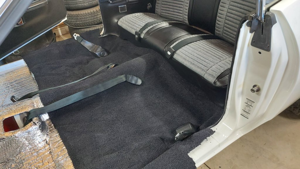

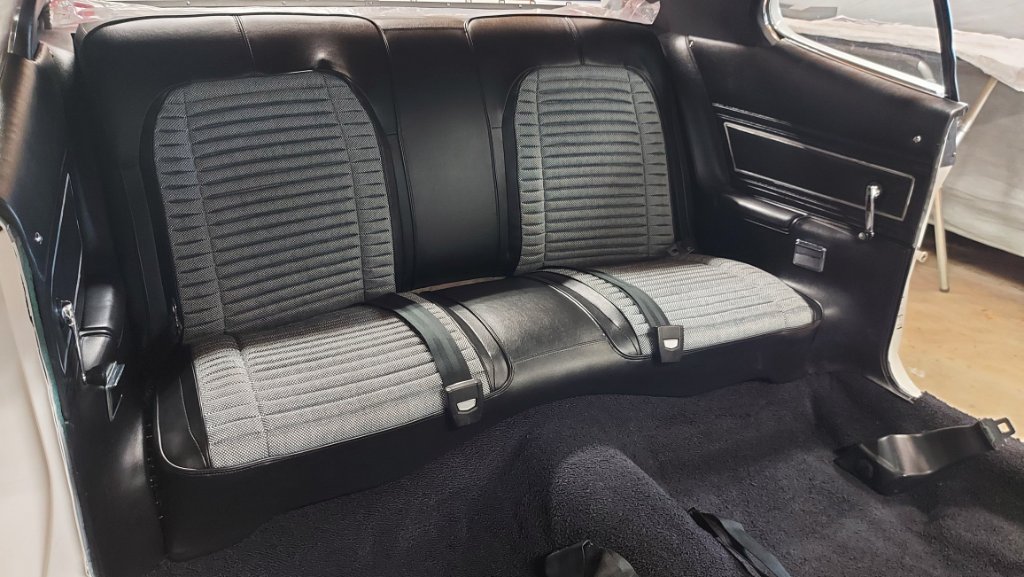

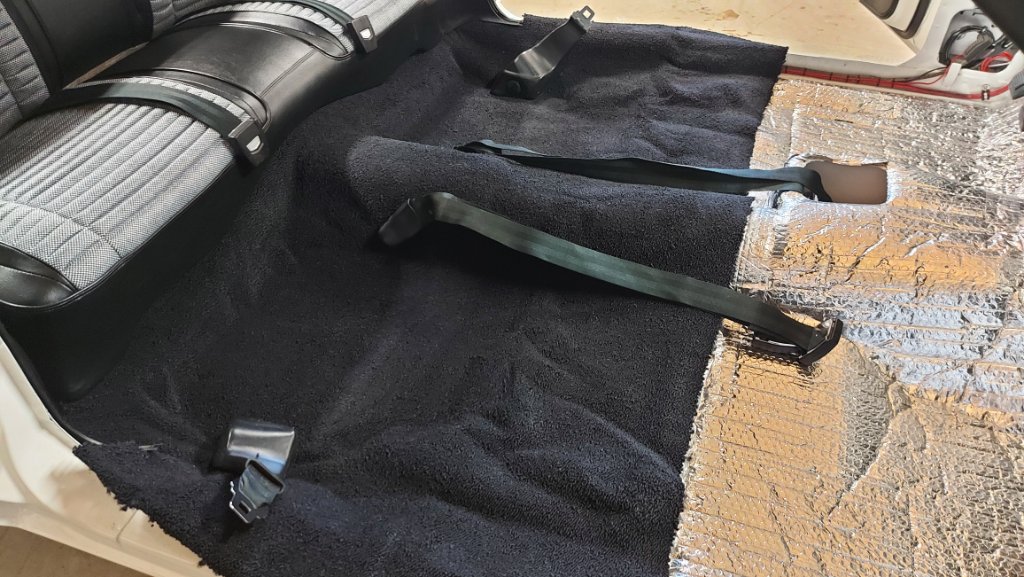

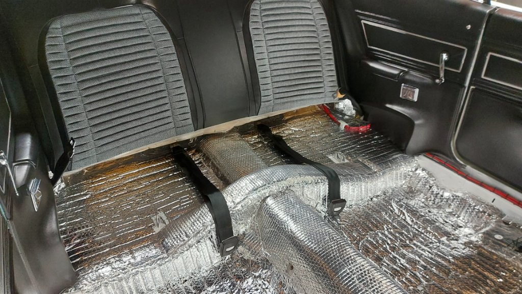

Post by 71Beeper » Sun Feb 06, 2022 5:17 pm

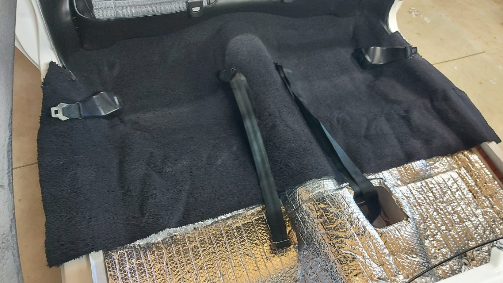

Got a little more done today.
Even tho its in the high thirties in the garage today I managed to get the rear half of the carpet installed along with the back seat bottom.
Feb 6th (7).jpg (138.57 KiB) Viewed 91681 times
Feb 6th (9).jpg (158.26 KiB) Viewed 91681 times
Feb 6th (11).jpg (136.96 KiB) Viewed 91681 times
Feb 6th (8).jpg (126.84 KiB) Viewed 91681 times
Feb 6th (10).jpg (119.26 KiB) Viewed 91681 times
Hopefully when the warmer weather arrives it will relax the carpet, so it lays flatter.

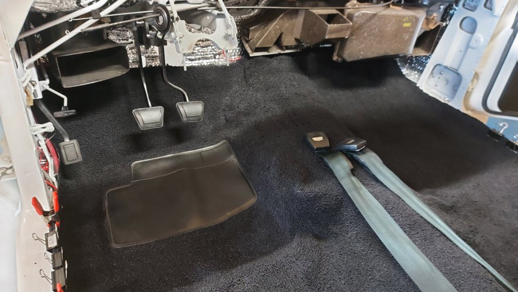

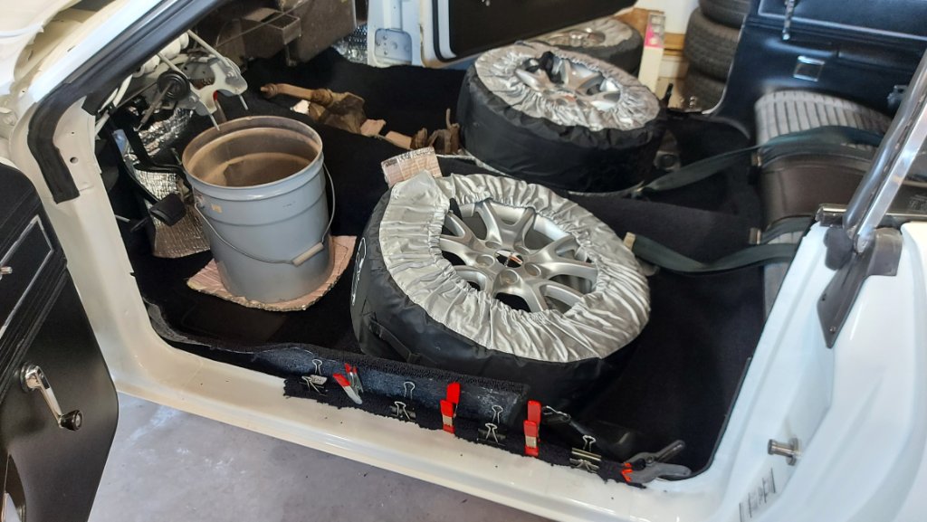

Post by 71Beeper » Mon Feb 21, 2022 4:26 pm
So continuing on with the carpet install, I had time to put in the front section.
Feb 21st (11).jpg (110.92 KiB) Viewed 91544 times
Of course I had to add some weights to flatten it some..... :D
Feb 21st (12).jpg (144.56 KiB) Viewed 91544 times

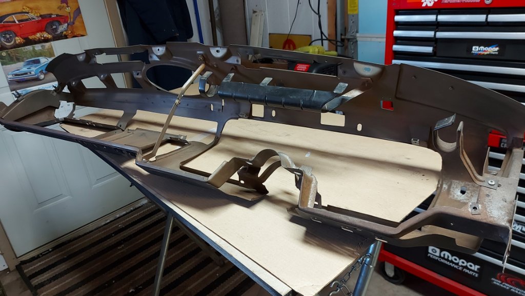

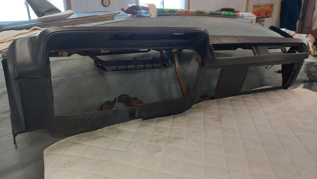

Post by 71Beeper » Mon Feb 21, 2022 4:31 pm

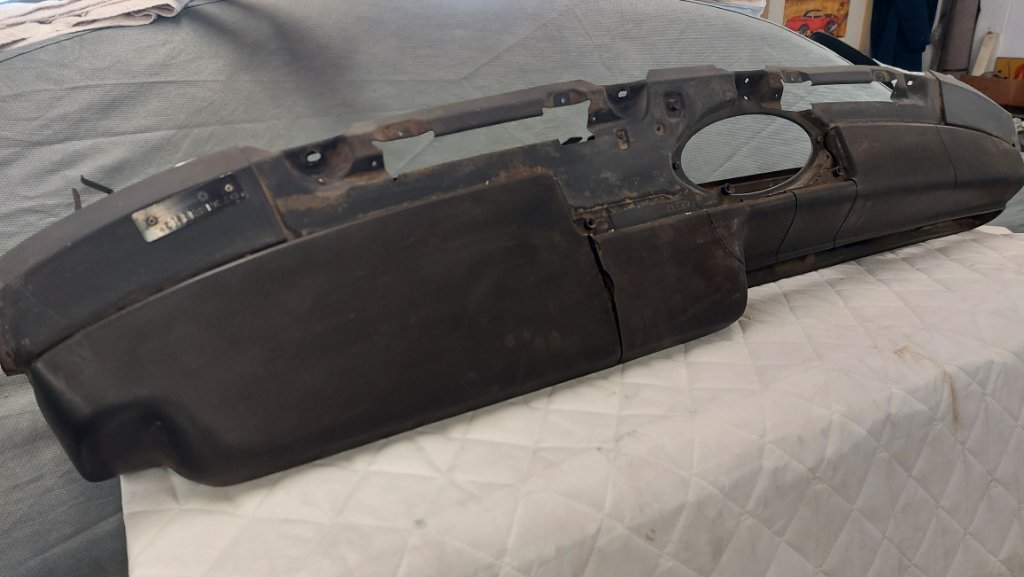

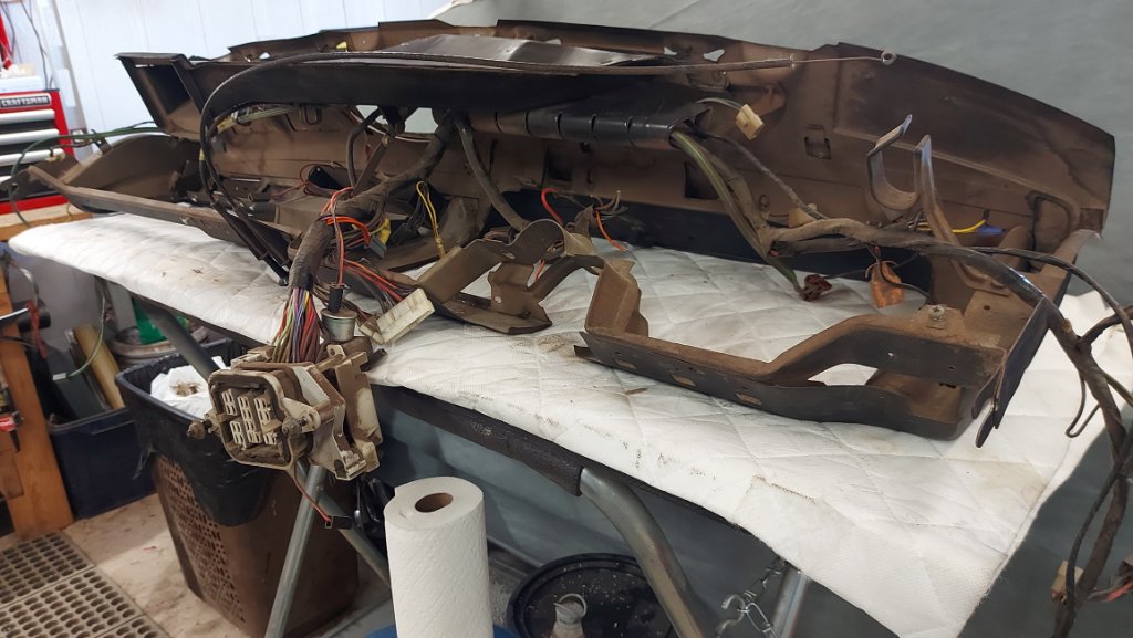

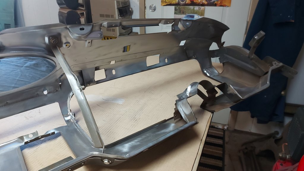

Next step.....I dug the dash frame out of storage and took some photos before I start to take it apart.
Feb 19th (5).jpg (111.55 KiB) Viewed 91544 times
Yup, the dash pad is beat to crap....
Feb 19th (17).jpg (82.34 KiB) Viewed 91544 times
Feb 19th (18).jpg (71.38 KiB) Viewed 91544 times

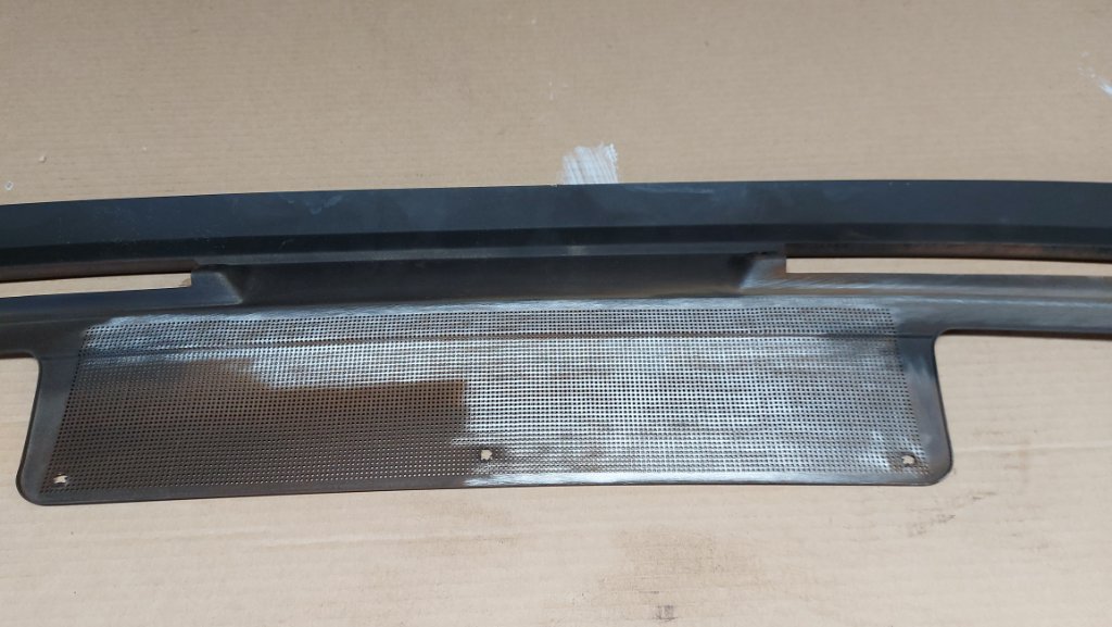

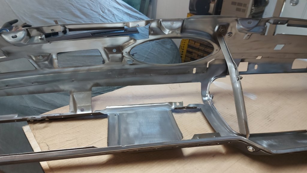

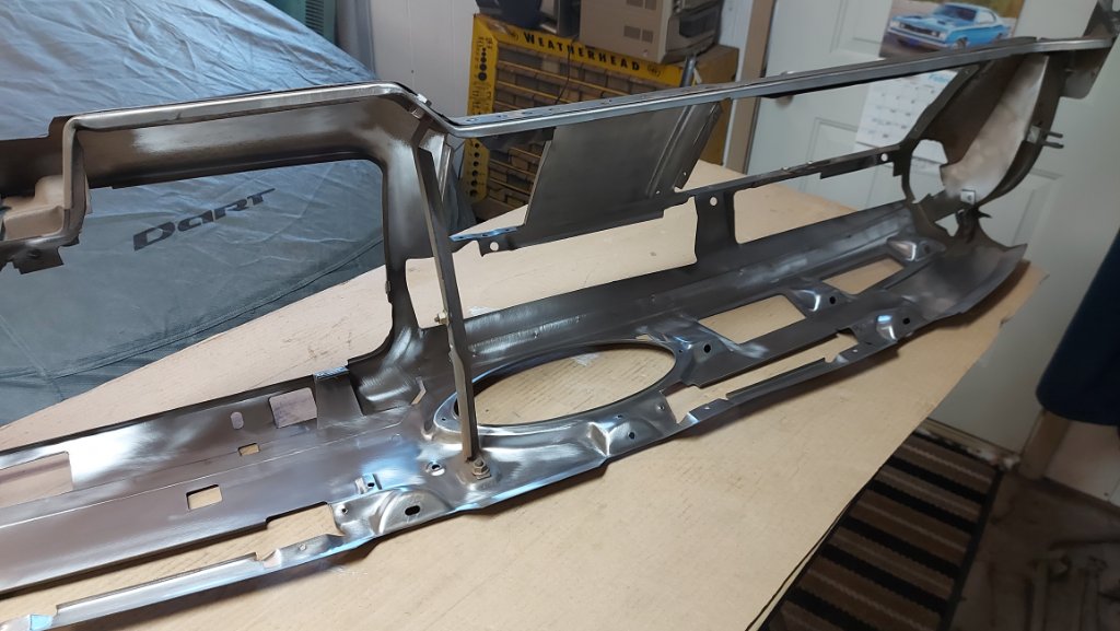

Started cleaning up the underside of the speaker cover....
Feb 20th (5).jpg (93.42 KiB) Viewed 91544 times

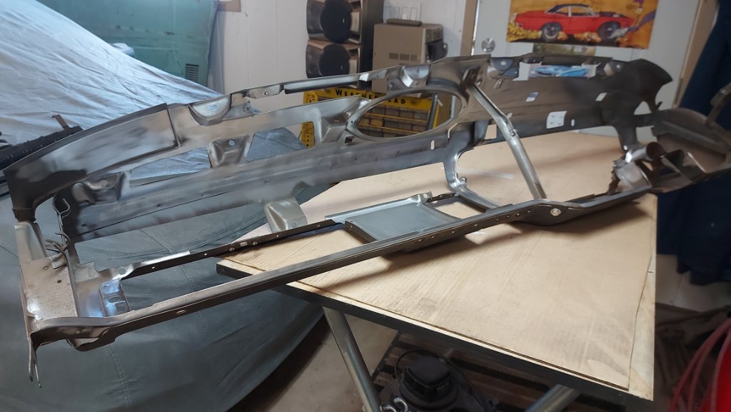

And start on the underside of the dash frame as it left the factory with no paint. Good thing mine only has surface rust.
Feb 20th (9).jpg (113.23 KiB) Viewed 91544 times

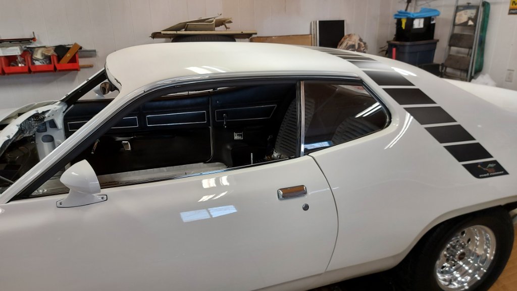

Post by 71Beeper » Mon Feb 28, 2022 9:37 pm
I love the sound of that Scott... :beer:

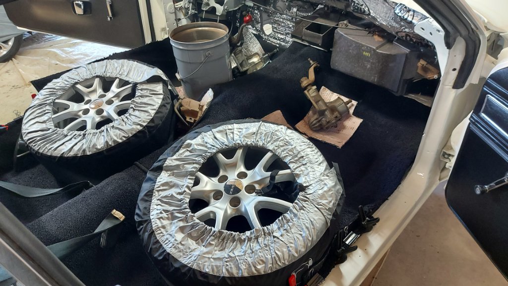

Engine break-in = $600 CDN
Is it discouraging??? a little, but I'm not letting that stop me.
So in the meantime I keep going.

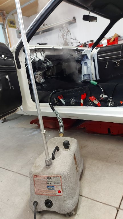

On the weekend I was able to borrow a steamer from my work.

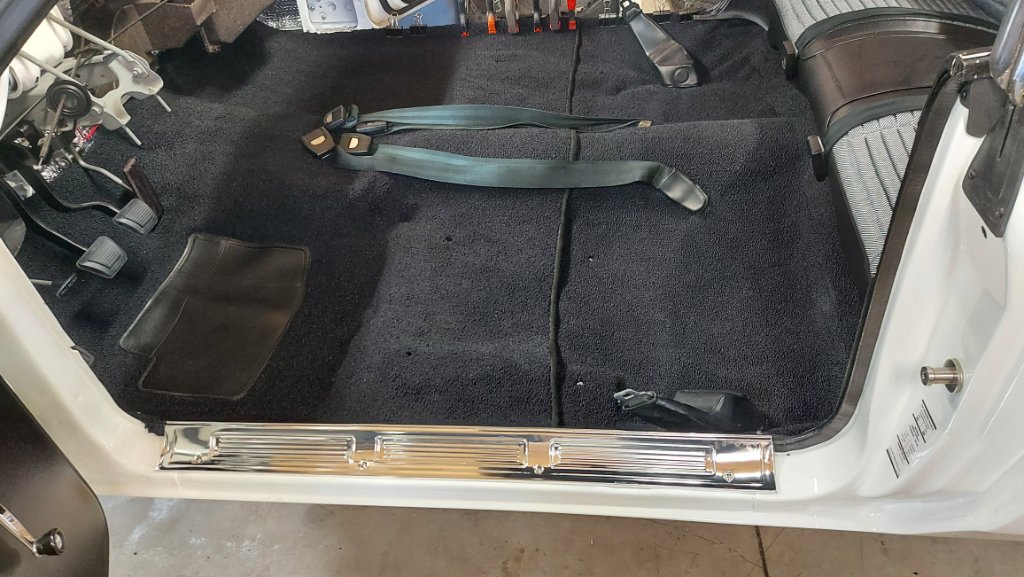

Feb 27th (10).jpg (140.86 KiB) Viewed 91473 times

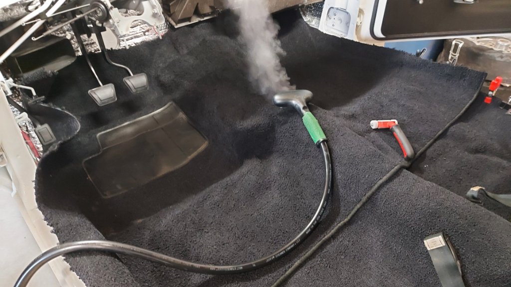

So I can put some steam on the carpet to get it to lay flat.
Feb 27th (6).jpg (63.15 KiB) Viewed 91473 times
Took a bit of effort....
Feb 27th (5).jpg (116.14 KiB) Viewed 91473 times
But all in all it turned out just fine.
I trimmed up the edges where the sill plates go too.
I did use some Alien Tape on the 4 spd hump to keep the carpet molded properly.
Feb 27th (9).jpg (130.32 KiB) Viewed 91473 times
Feb 27th (8).jpg (121.09 KiB) Viewed 91473 times
ct71rr
Posts: 344
Location: Massachusetts
Post by ct71rr » Tue Mar 01, 2022 1:58 pm
Looks great! What was giving you trouble with the lower door panels?

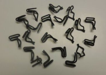

Post by 71Beeper » Wed Mar 02, 2022 8:25 pm
ct - the trouble I had with the lower door panels were the clips.
I bought brand new clips from a Mopar guy up here in Ontario.
The issue was when I started on one nd of the door with the installation.....by the time I got to the other end the clips were nowhere near their respective holes that they had to go into.... :mad:
So I had to remove all of them and start over.
In addition to that, you know what the end of the clip looks like right?
Door clips.jpg (14.91 KiB) Viewed 91440 times
If you don't get the crossed end into the hole completely, it won't stay in place.
A couple of them I had only one of the ends in the hole while the other was beside the hole and when I slammed against the panel and it didn't stay in place, I pried between the door and panel to see the clip bent like a pretzel.
I'm makin it sound worse than it really was.... :rant:
I guess I learned something because the upper panels went in easier......maybe because I knew what to look for.

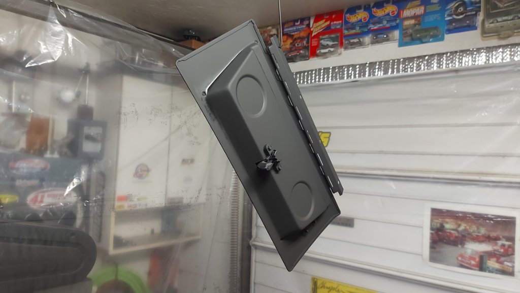

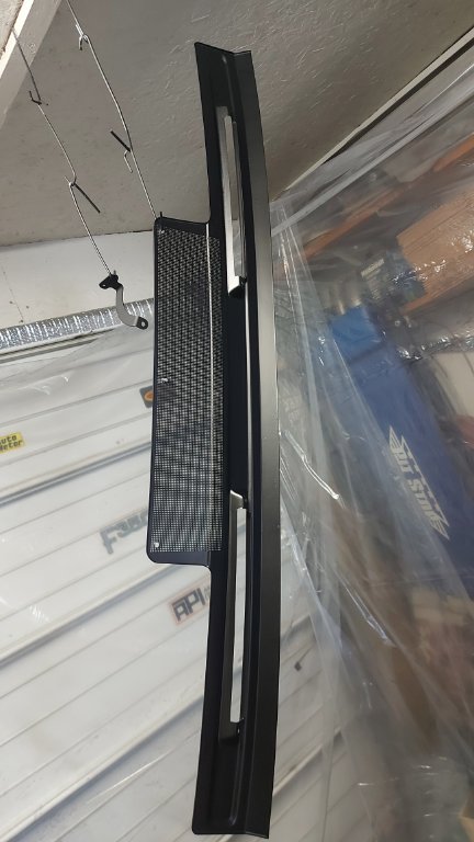

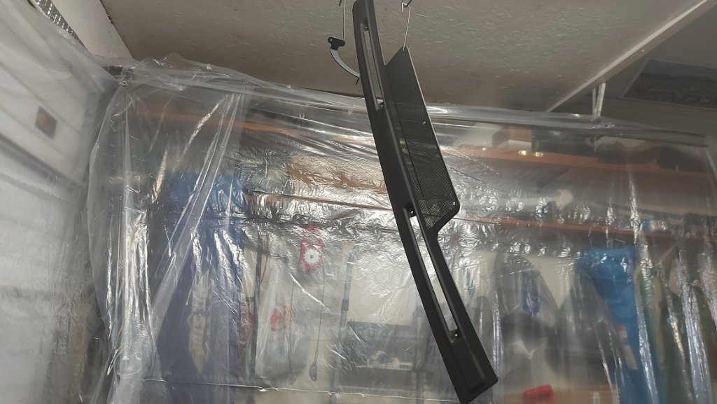

Post by 71Beeper » Sun Mar 06, 2022 9:13 pm

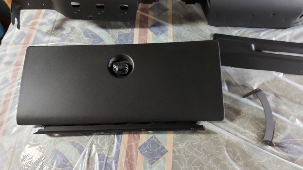

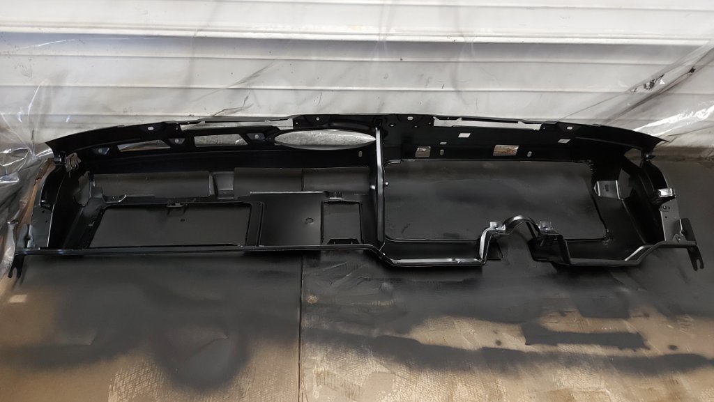

We had a warm spell of weather this weekend so I got a chance to prime and paint the dash frame.
March 6th (4).jpg (67.45 KiB) Viewed 91388 times
March 6th (5).jpg (76.45 KiB) Viewed 91388 times
March 6th (7).jpg (104.41 KiB) Viewed 91388 times
Then I painted the underside with some left over Rustoleum satin black.
March 6th (8).jpg (77.32 KiB) Viewed 91388 times
March 6th (9).jpg (56.27 KiB) Viewed 91388 times

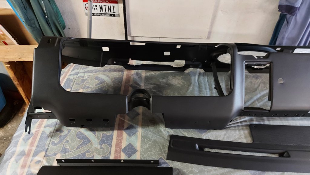

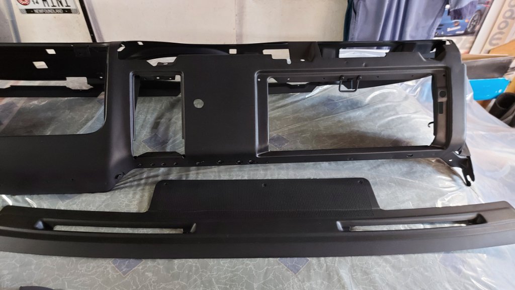

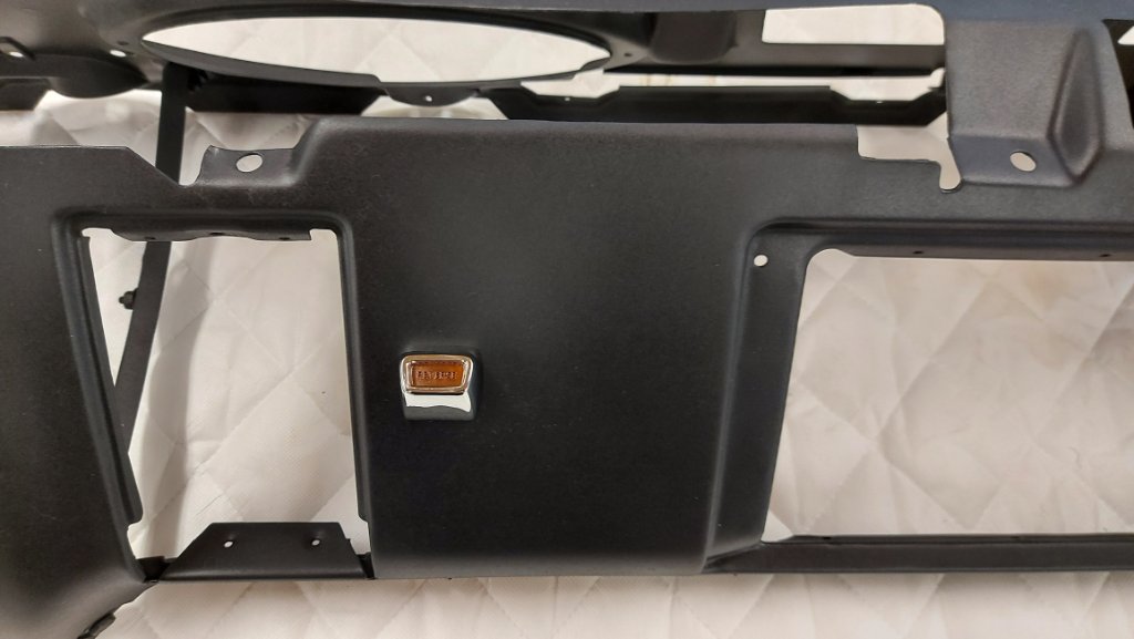

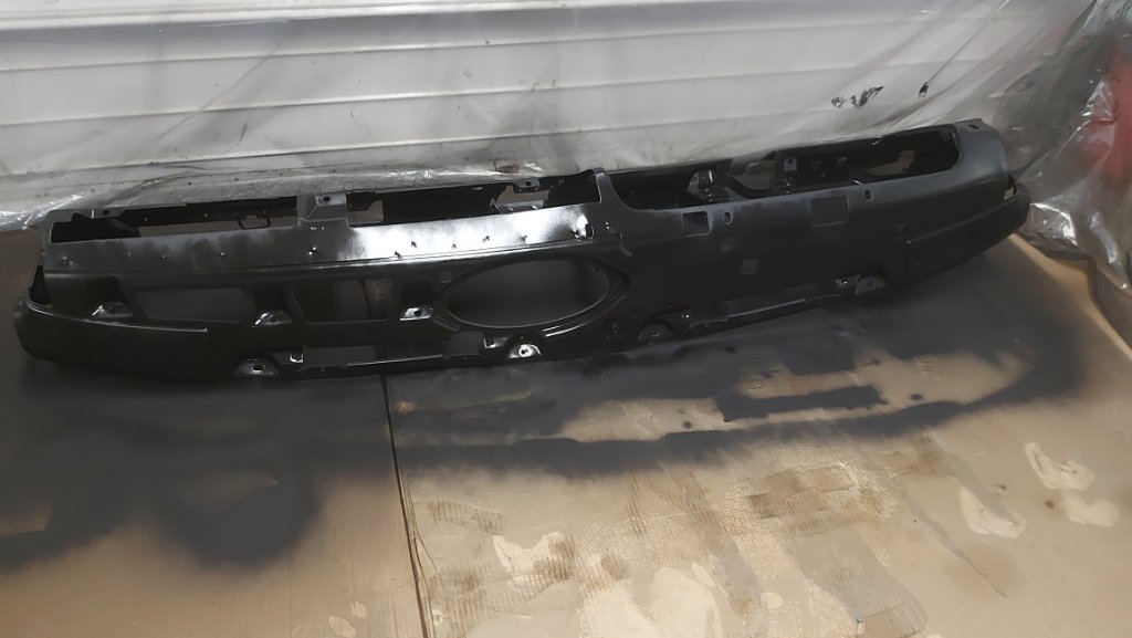

Post by 71Beeper » Sun Mar 06, 2022 9:14 pm
The final coat on the topside is flat black followed with a coat of textured suede also by Rustoleum.
March 6th (10).jpg (91.43 KiB) Viewed 91388 times
March 6th (11).jpg (89.46 KiB) Viewed 91388 times
March 6th (12).jpg (78.69 KiB) Viewed 91388 times

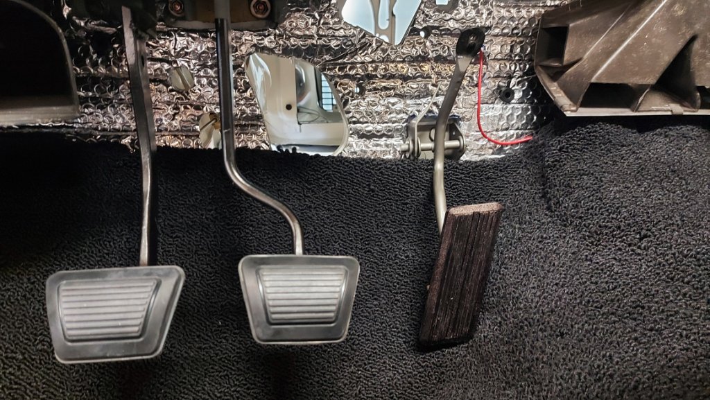

Post by 71Beeper » Sun Mar 13, 2022 3:28 pm
Not too much done this weekend other than install the go pedal..... :D
March 13th (1).jpg (177.23 KiB) Viewed 91273 times

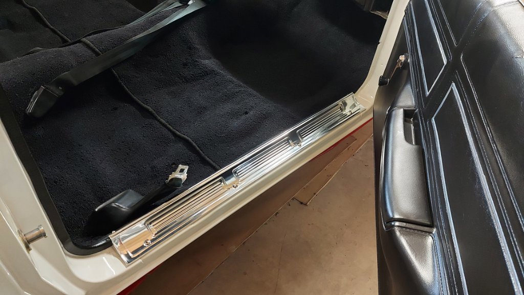

And put the sill plates on.
March 13th (2).jpg (131.19 KiB) Viewed 91273 times
March 13th (3).jpg (116.59 KiB) Viewed 91273 times
March 13th (4).jpg (116.95 KiB) Viewed 91273 times
Now I can close the doors again.

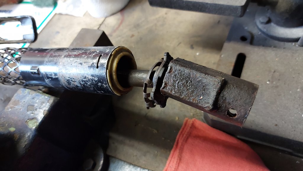

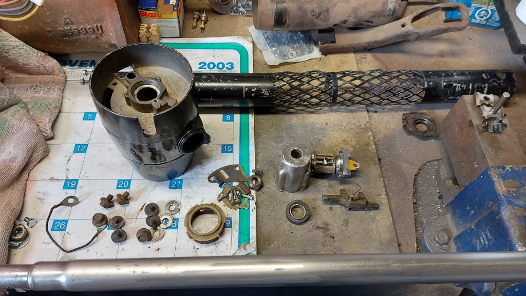

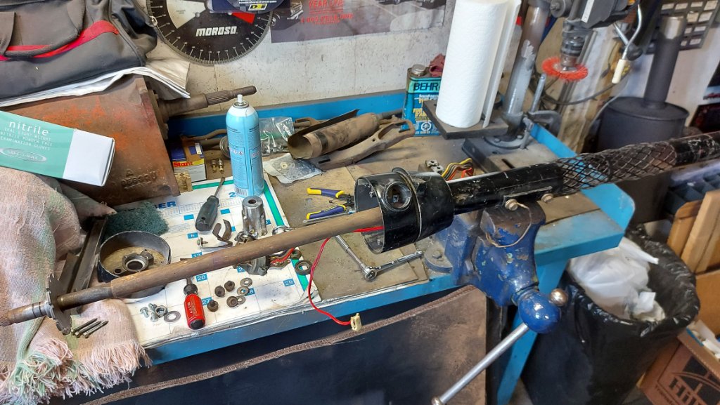

Post by 71Beeper » Sun Mar 20, 2022 5:43 pm

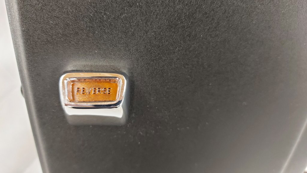

While waiting for dash parts to come in I had a chance to install the reverse light.
March 20th (1).jpg (88.57 KiB) Viewed 91177 times
March 20th (2).jpg (66.05 KiB) Viewed 91177 times
March 20th (3).jpg (69.36 KiB) Viewed 91177 times

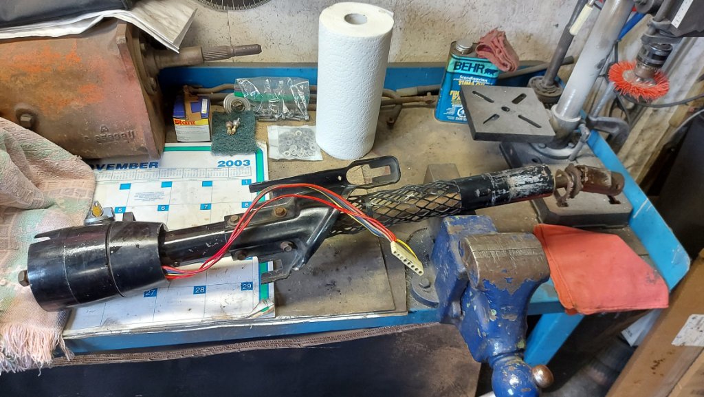

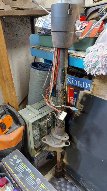

Then I dug out the steering column and get started to taking it apart.
March 20th (4).jpg (141.96 KiB) Viewed 91177 times
March 20th (5).jpg (87.94 KiB) Viewed 91177 times

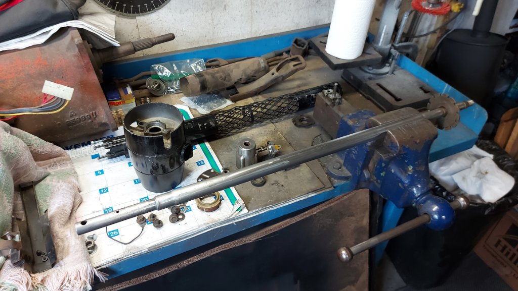

Post by 71Beeper » Sun Apr 03, 2022 2:48 pm
Got the steering column apart.
First is to get the main shaft out.
March 27th (1).jpg (146.91 KiB) Viewed 90942 times
Here are some of the bits.
March 27th (2).jpg (148.29 KiB) Viewed 90942 times
Then clean up the main shaft.
March 27th (3).jpg (124.63 KiB) Viewed 90942 times
I have a power steering column that came out of the car. I will be taking the mounting plates from it to use on this manual steering column.
March 27th (4).jpg (95.61 KiB) Viewed 90942 times
