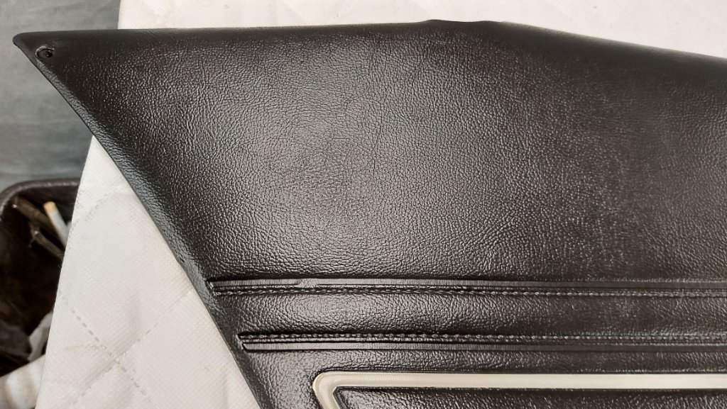

Post by 71Beeper » Tue Dec 21, 2021 9:25 pm

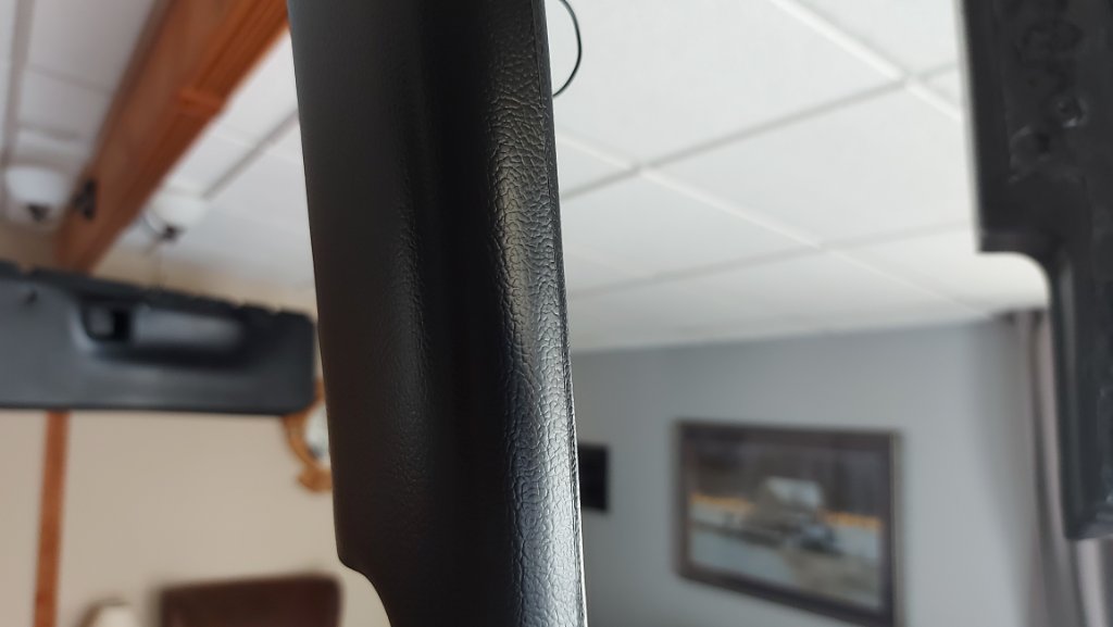

Scott - yes sir I was able to get all of the trim including the two A-pillar pieces done with one can of SEM.
I did use a black primer first.
Screenshot 2021-12-21 202235.jpg (24.32 KiB) Viewed 49861 times
And one coat of the SEM Landau black.
Screenshot 2021-12-21 202415.jpg (44.49 KiB) Viewed 49861 times

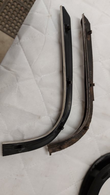

Now, I have a little dilemma - I had bought the 10pc window fuzzies kit from Top Cat.
Dec 19th (7).jpg (91.83 KiB) Viewed 49861 times

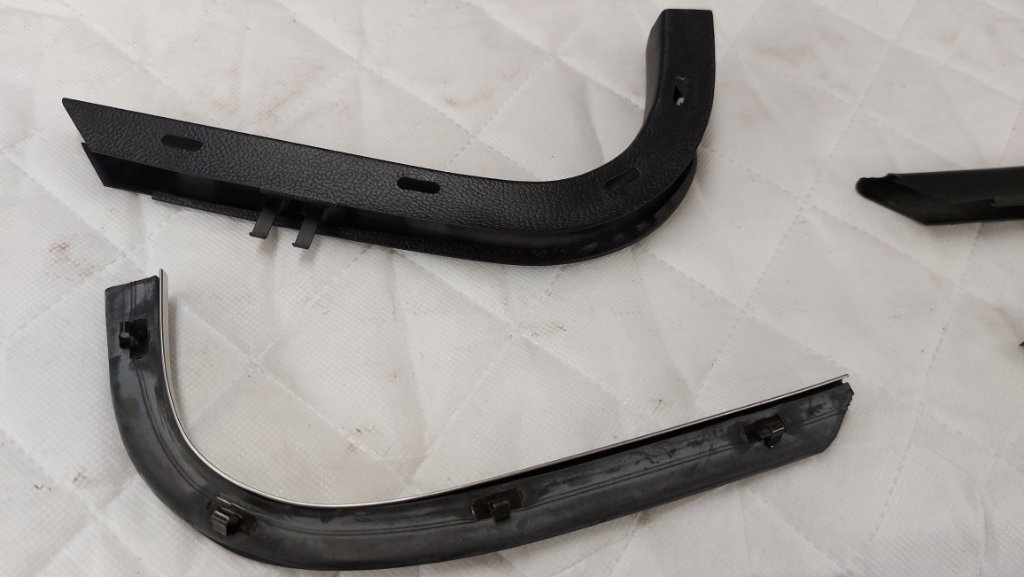

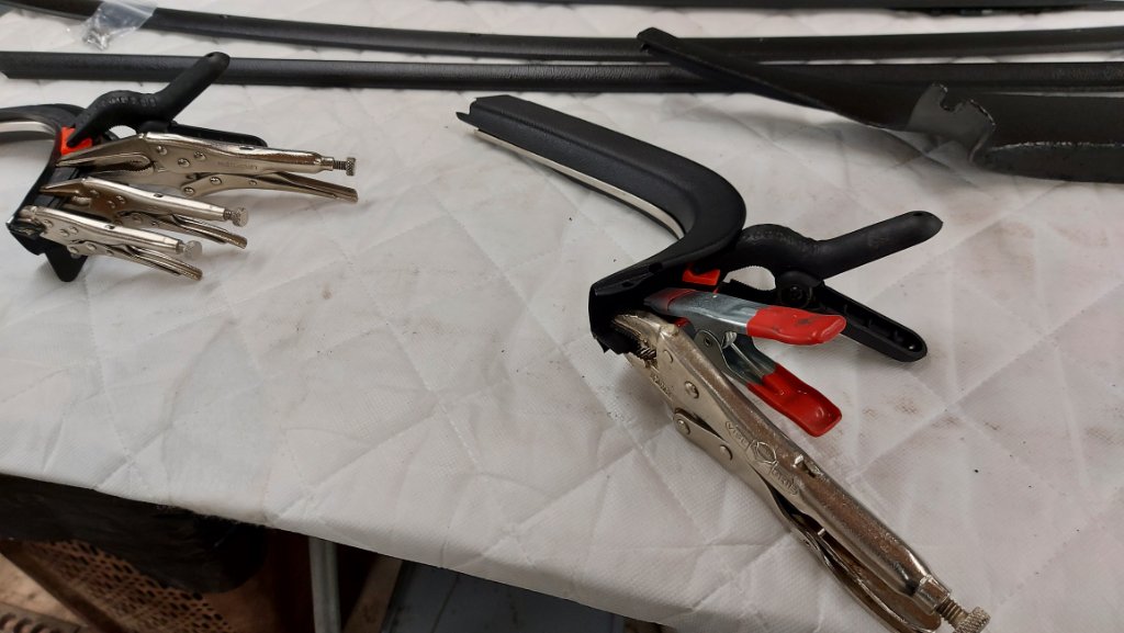

Included in it are the 2 pieces that attach to the side window trim piece.
Dec 19th (3).jpg (67.44 KiB) Viewed 49861 times
If you look carefully, the mounting tabs that are located on the curved section are spaced farther apart than the slot locations on the trim piece. The 2 tabs on the straight portion will work along with the tab at the start of the curve, but the last one at the top of the curve - no way.
So I dig out the old rubber piece that I took off the trim piece and compare them.
Dec 19th (8).jpg (40.1 KiB) Viewed 49861 times
See the difference?
Looks to me that the previous owner must have MacGyvered the rubber to fit the trim.
Has anyone else had an issue with this piece?
Looks like I'm gonna have to remove the offending tab and then glue the piece in that area right to the trim piece.

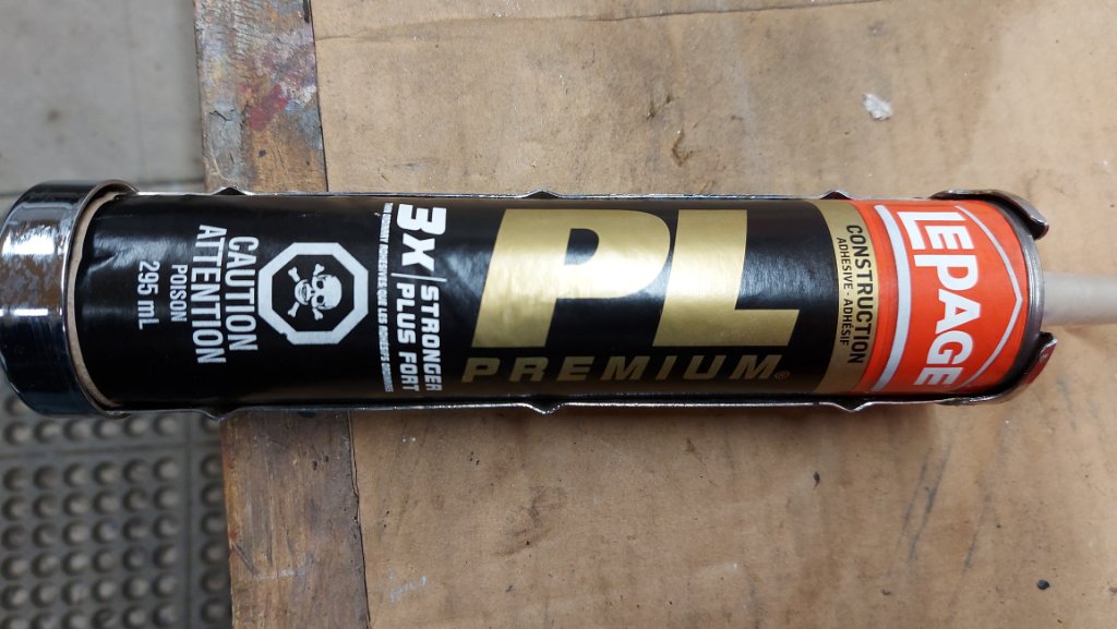

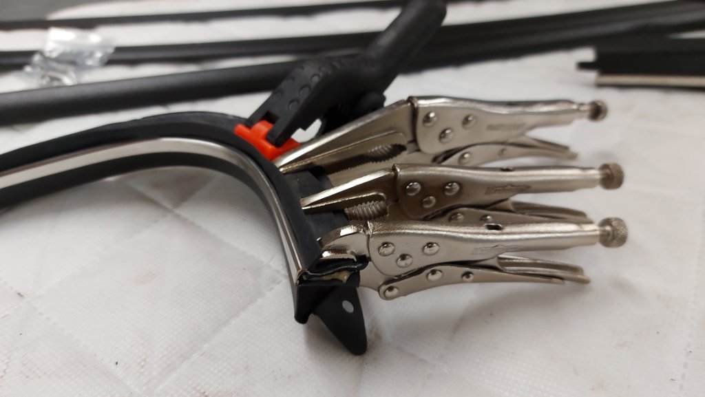

I used this stuff to glue it in place.
Dec 23rd (6).jpg (101.29 KiB) Viewed 49781 times

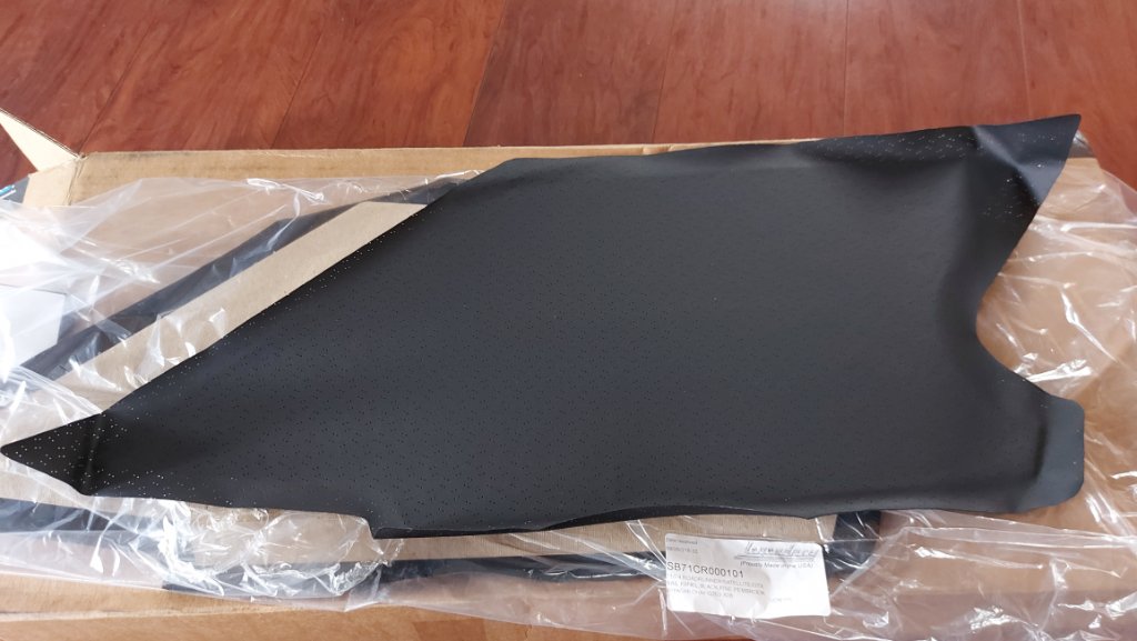

My sail panels finally arrived - I ordered them thru Classic Industries.
Dec 23rd (1).jpg (83.77 KiB) Viewed 49781 times
But look where they actually came from..... :mad:
Dec 23rd (2).jpg (84.46 KiB) Viewed 49781 times

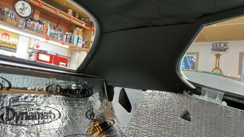

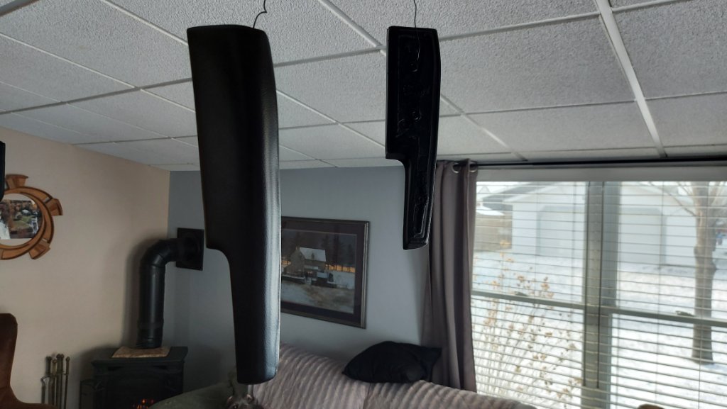

Post by 71Beeper » Thu Dec 30, 2021 9:10 pm

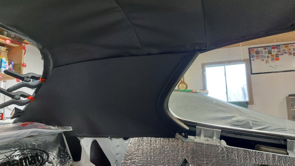

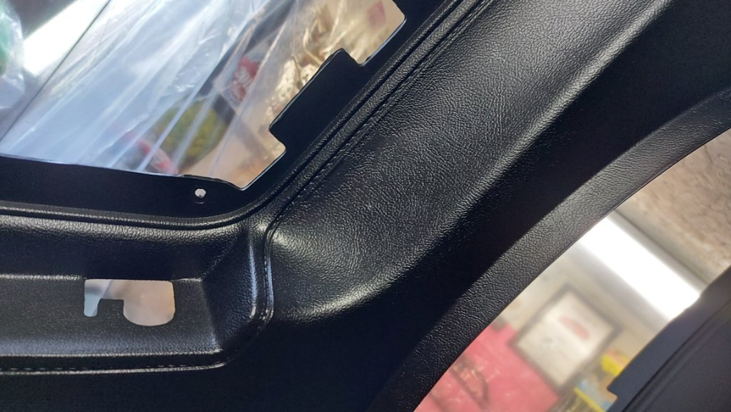

I did a fit check of the sail panel with the trim piece next to it.
Dec 26th (2).jpg (95.89 KiB) Viewed 49781 times

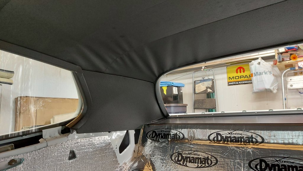

Then, I did the final install of both of them.
Dec 30th (4).jpg (114.79 KiB) Viewed 49781 times
Dec 30th (5).jpg (136.11 KiB) Viewed 49781 times
I'm gonna have to use a steamer come spring to get the headliner wrinkles out just above the sail panels.

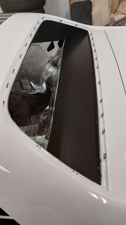

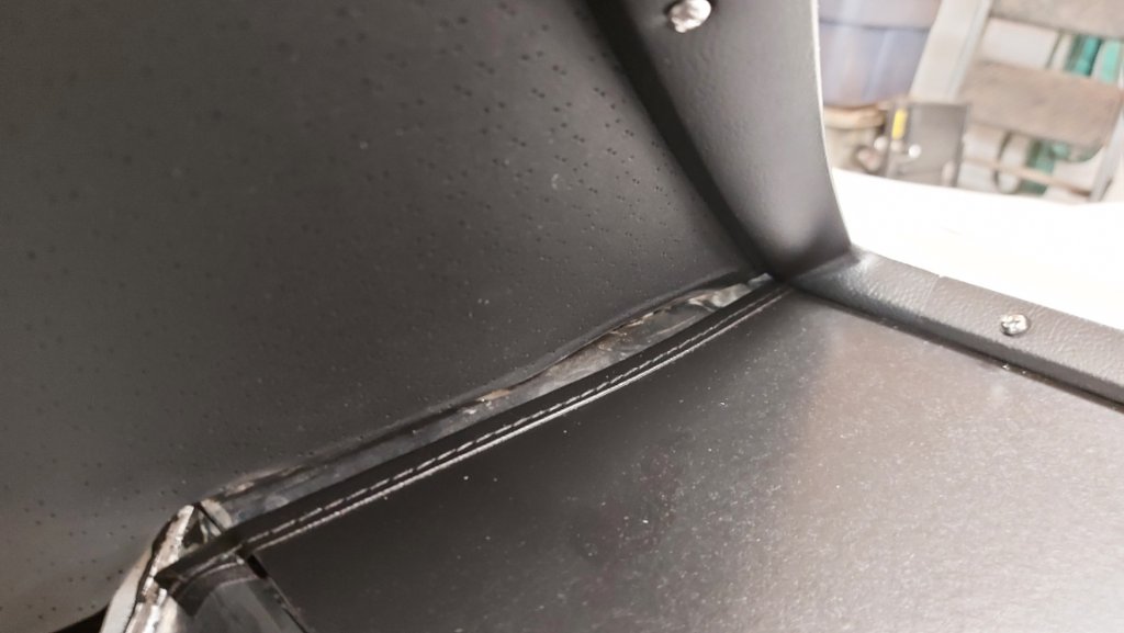

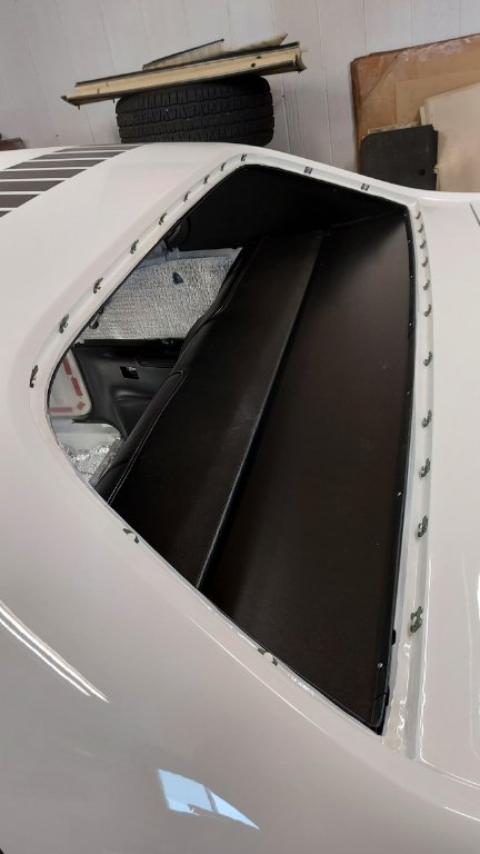

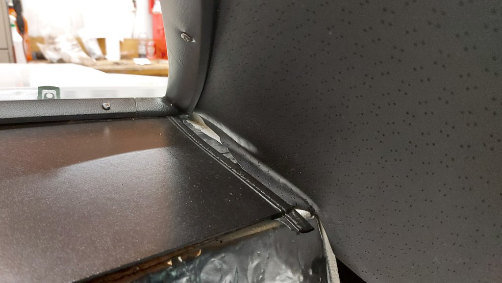

Post by 71Beeper » Thu Dec 30, 2021 9:12 pm
I ordered the package tray from RM reproductions & am not happy with the fit.
It looks to be too narrow.
I have a gap on both sides.
Dec 30th (8).jpg (86.41 KiB) Viewed 49781 times
Dec 30th (9).jpg (60.23 KiB) Viewed 49781 times
Are they suppose to have a gap?
Since I didn't have one to begin with, I don't know what the final fit should look like.

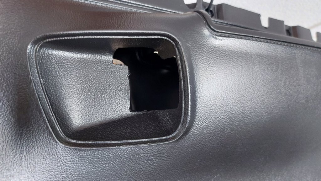

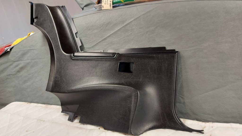

Post by 71Beeper » Sat Jan 01, 2022 8:51 pm

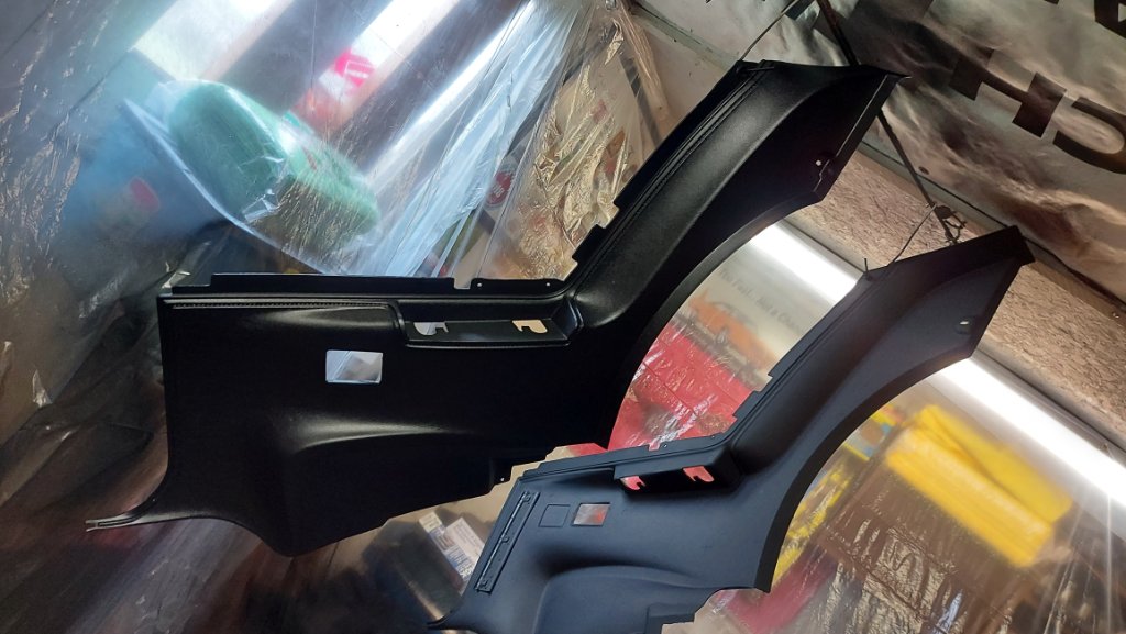

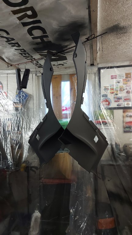

I got a chance to spray some black primer followed by the SEM Landau black on the rear side panels.
Dec 26th (5).jpg (68.46 KiB) Viewed 49767 times
Then, spray some trim paint.
Dec 30th (1).jpg (106.82 KiB) Viewed 49767 times
Dec 30th (2).jpg (117.83 KiB) Viewed 49767 times
I do like the finish that the SEM paint gives.

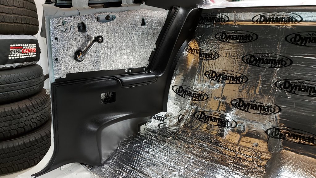

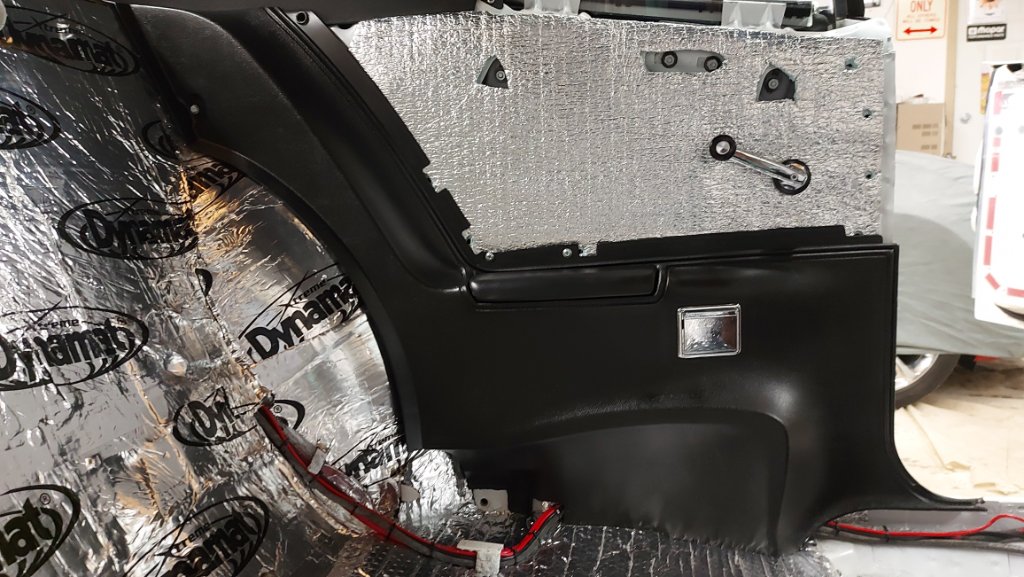

Post by 71Beeper » Sat Jan 01, 2022 9:01 pm

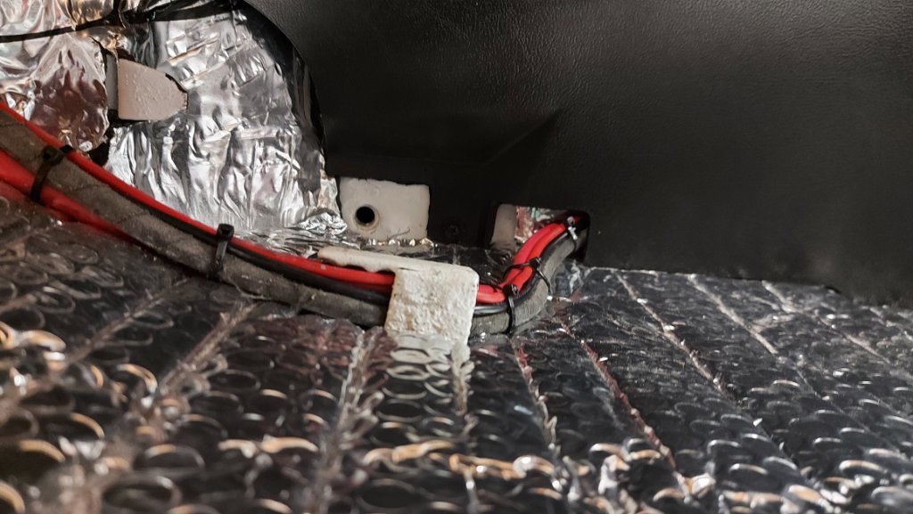

With the sound deadner in place, the panel had to be pushed down on the deadner to get it in place. Plus get the wires that run front to back in place behind the panel.
Jan 1st (2).jpg (114.52 KiB) Viewed 49767 times
I don't have the ash tray for the other side - so I ordered one from airgrabber.com website.
I don't need to have brand new ones - besides the cost of $100 each! I'll make due with used ones.

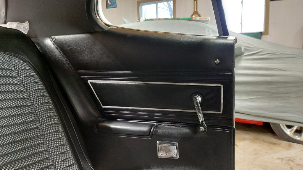

I went ahead and installed the right side rear panel.
Jan 1st (5).jpg (178.67 KiB) Viewed 49767 times
Here's the both of them installed.
Jan 1st (6).jpg (182.99 KiB) Viewed 49767 times

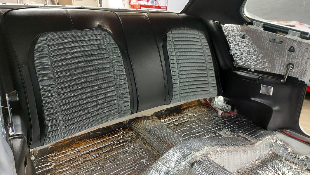

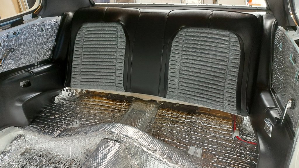

Next step - get the rear seat backrest in place.
Post by sdweatherman » Tue Jan 04, 2022 2:32 pm
Yeah, I would not like the fit on that rear package tray piece also. Throw a tape measure on that baby and let me know how long it is. I have my broken original that I can measure to see if the lengths match up or not.
Post by 71Beeper » Tue Jan 04, 2022 8:49 pm
Scott, I went out and measured it and I get 58 1/2".

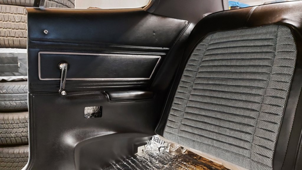

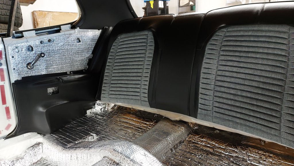

I did have time to put the rear seat backrest in place.
Jan 2nd (2).jpg (174.85 KiB) Viewed 49726 times
Jan 2nd (3).jpg (173.74 KiB) Viewed 49726 times
Jan 2nd (4).jpg (175.13 KiB) Viewed 49726 times
Jan 2nd (1).jpg (39.62 KiB) Viewed 49726 times
Can anyone tell me if the lower mounting tab for the backrest - does the frame just sit on that tab or does the tab have to be bent to hold the frame securely?

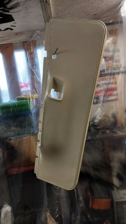

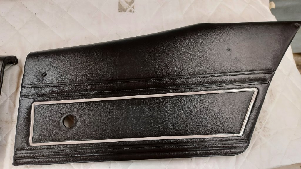

Post by 71Beeper » Sun Jan 09, 2022 8:23 pm
Next step is to pick out the best lower door panels from my stash and get them cleaned up and ready for black primer.

Post by sdweatherman » Mon Jan 10, 2022 12:04 pm
Finally remembered to measure my original package tray piece - and you are spot on with 58 1/2". If I end up with gaps like that, I might have to just lay some extra material in the gaps to hide the metal showing through. For the lower tabs on the upper rear seat frame - my tabs are slightly bent in the outboard direction to secure the seat frame. But once the lower rear seat frame is set in place - it kind of holds the bottom part of the upper seat frame in place. Great progress!!!
Post by 71Beeper » Sat Jan 22, 2022 2:23 pm
Thanks for the info Scott.
I think once the rear glass is in place that area will hardly be noticeable.

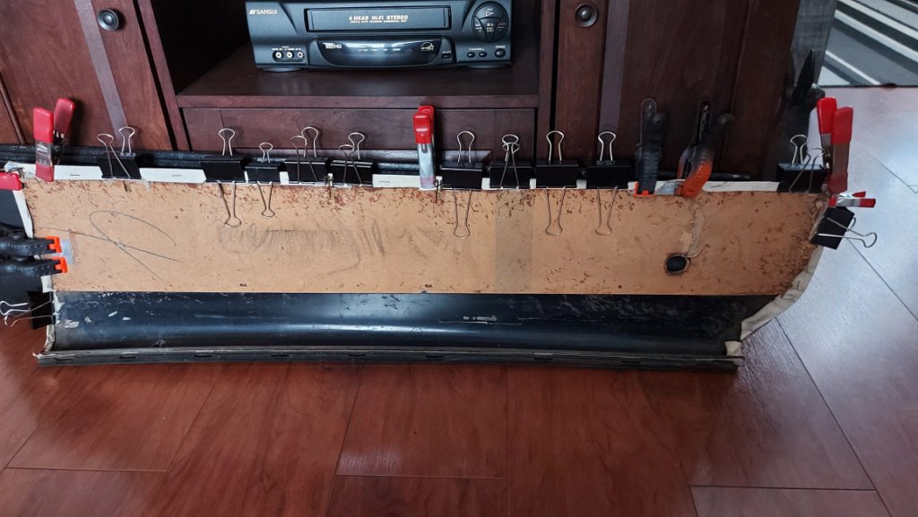

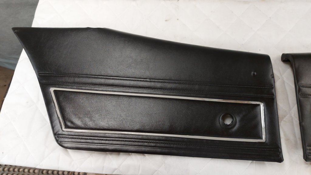

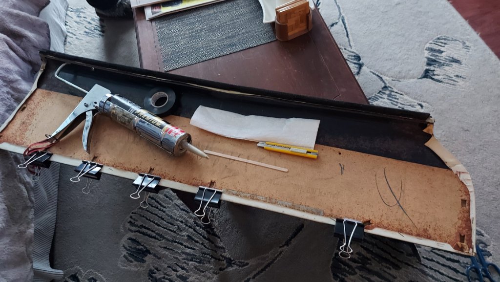

In the meantime I had to start repairing my door panels.
I can't justify the nearly $500 CDN a pair of re-pop door panels cost. Not mention shipping and duty and all that other crap.... :mad:
So I'll fix these and dye them.
First order of business, get the carboard fixed by gluing.
Jan 15th (9).jpg (126.75 KiB) Viewed 49515 times
Jan 15th (10).jpg (102.7 KiB) Viewed 49515 times

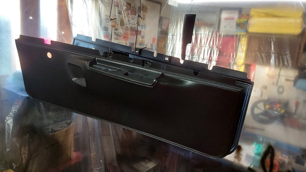

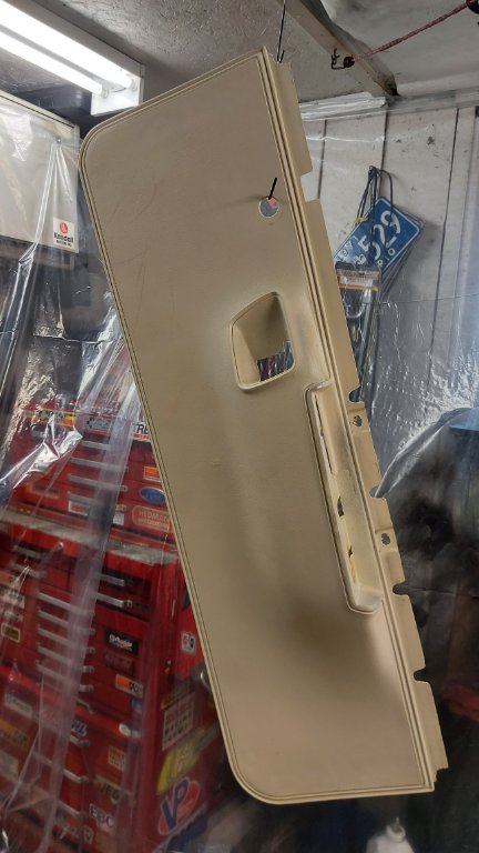

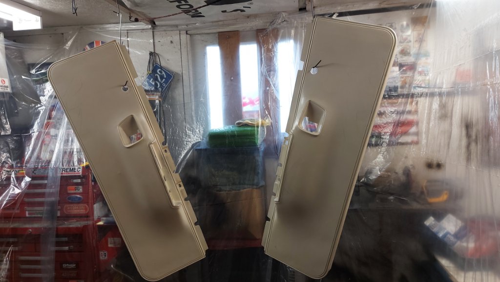

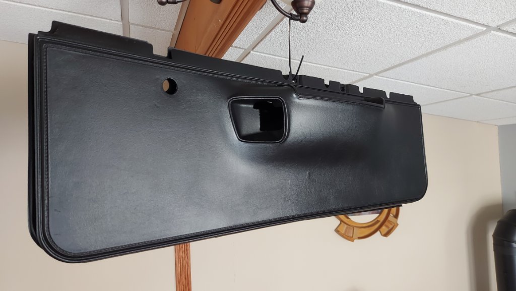

While the glue is setting I can dye the lower door panels and arm rests.
Here's the door panels.
Jan 15th (3).jpg (88.16 KiB) Viewed 49515 times
Jan 15th (7).jpg (88.29 KiB) Viewed 49515 times
Jan 15th (8).jpg (128.93 KiB) Viewed 49515 times
