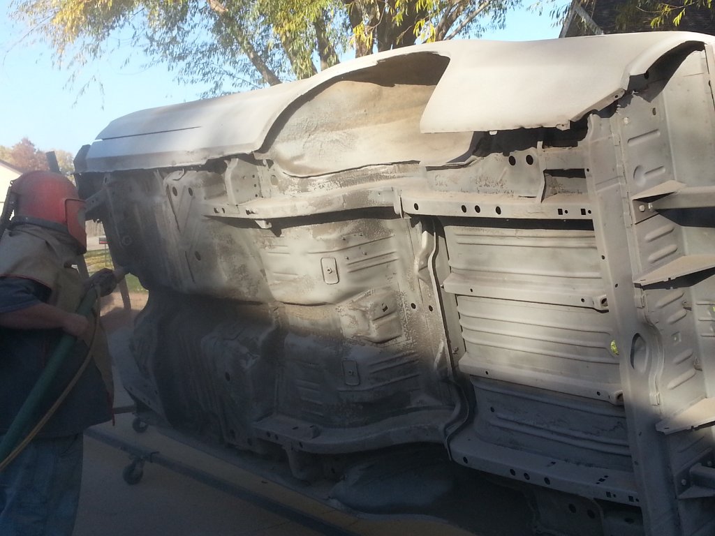

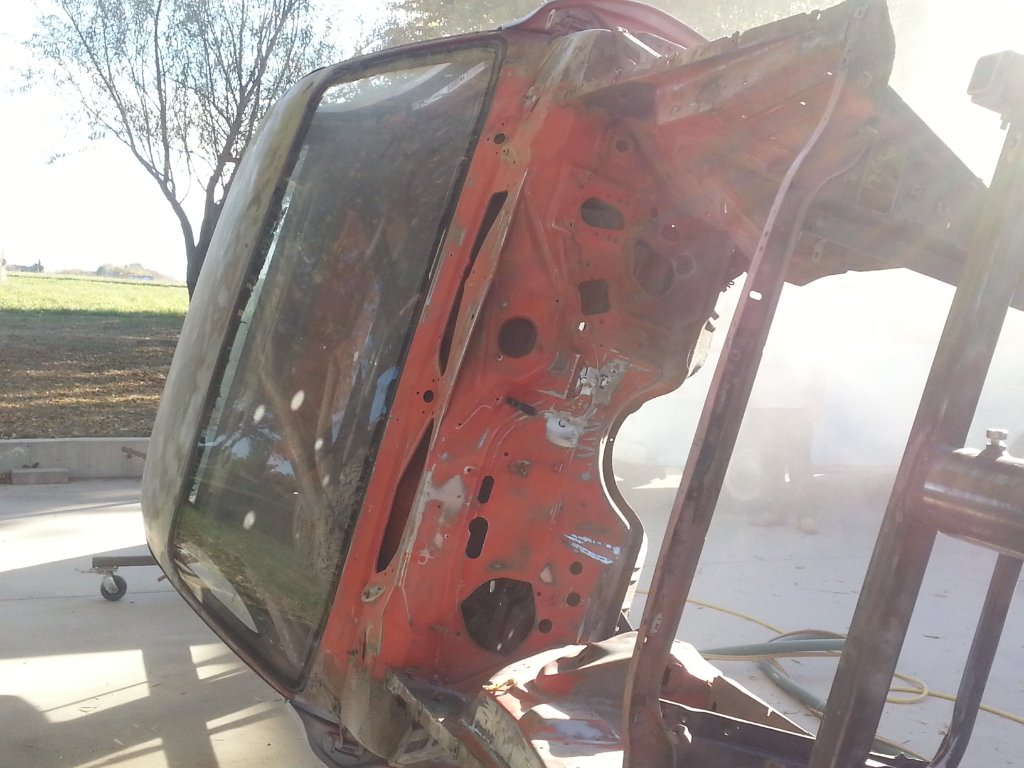

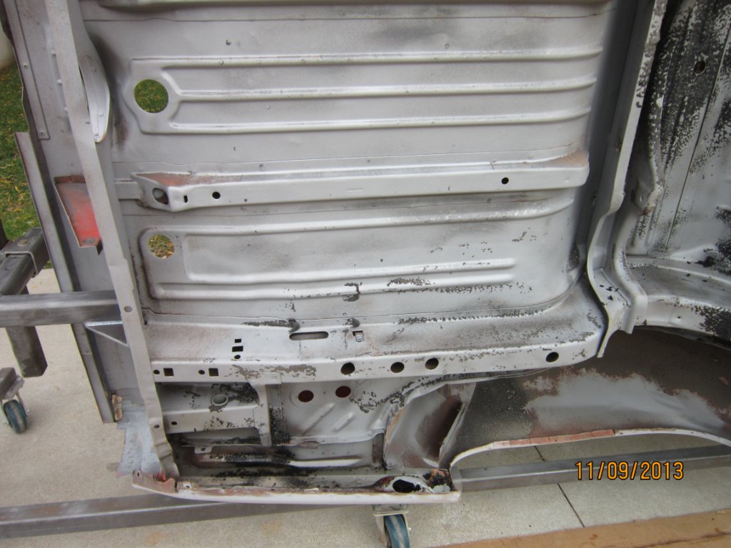

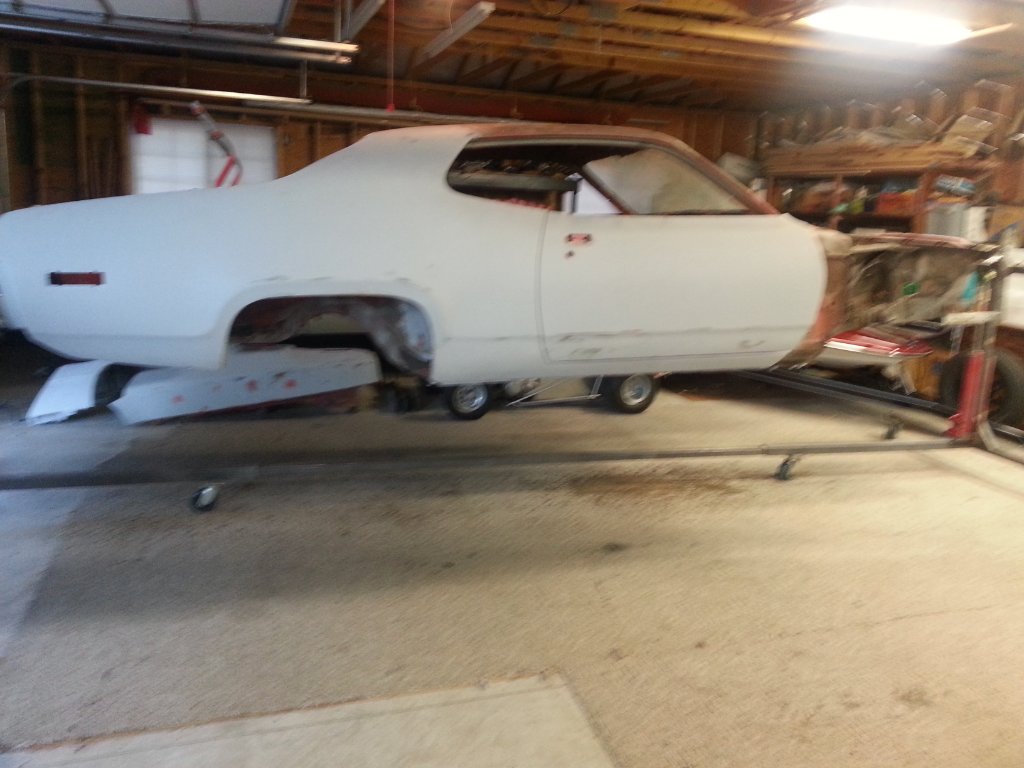

A few pictures before the car went to the body shop. We made this rotisserie for little to nothing and worked out great. My friends brother-in-law had the steel. So it took time to lay them out, weld them, and bought hydraulic ram from Harbor Freight and viola. Add in some beer too :D

Nice project you have there! I dig the rotisserie.

Thanks. The rotisserie was fairly easy to build. I only had to buy the wheels and the hydraulic jacks, and of course some beer. It's been used for 3 cars now. Mine, my friends '69, and his brother-in-law's Challenger

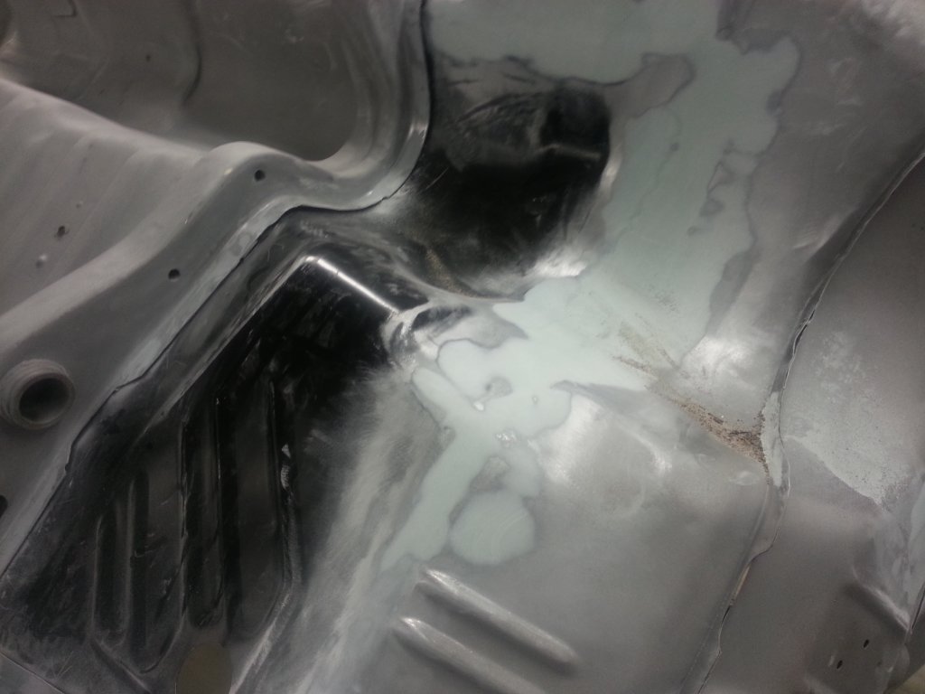

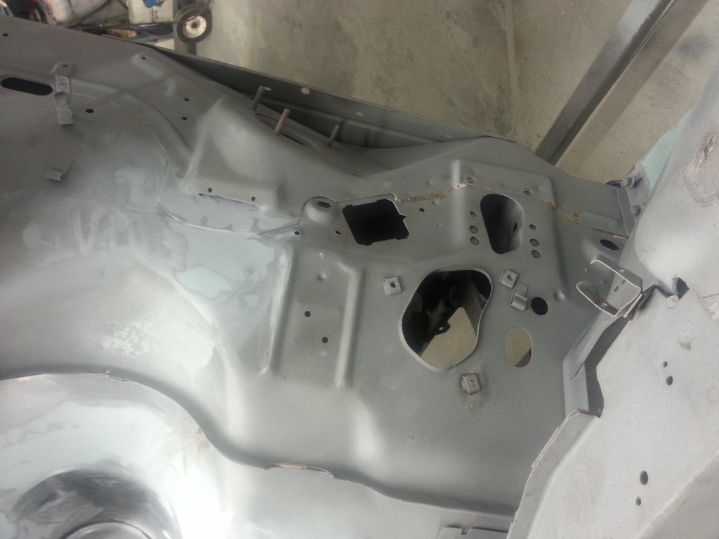

Had to replace a section of the center hump. Before the car came to be in my family, the previous owner had it for only 2 years, from the original owner, until my dad bought it. Anyway, there was some damage to the front of the K, the tranny tunnel, mainly to the underside. The tranny tunnel, for some reason, had 2" shee metal screws from the interior side, pointing down on the underside :shock: . So, I had to replace a section. This photo is after I replaced it

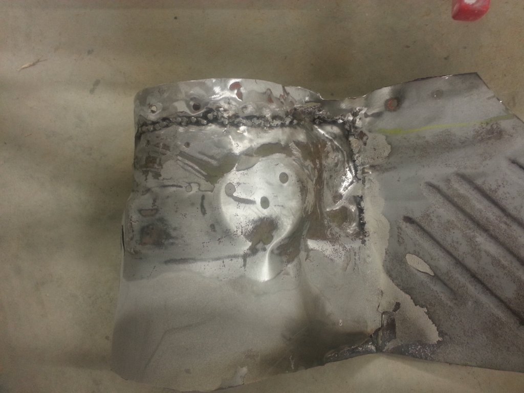

Post by rr6pak » Wed May 09, 2018 6:32 pm
Here is the section I cut out

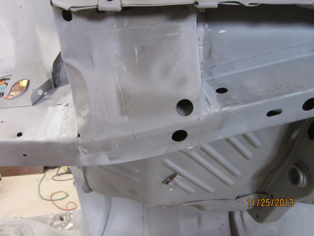

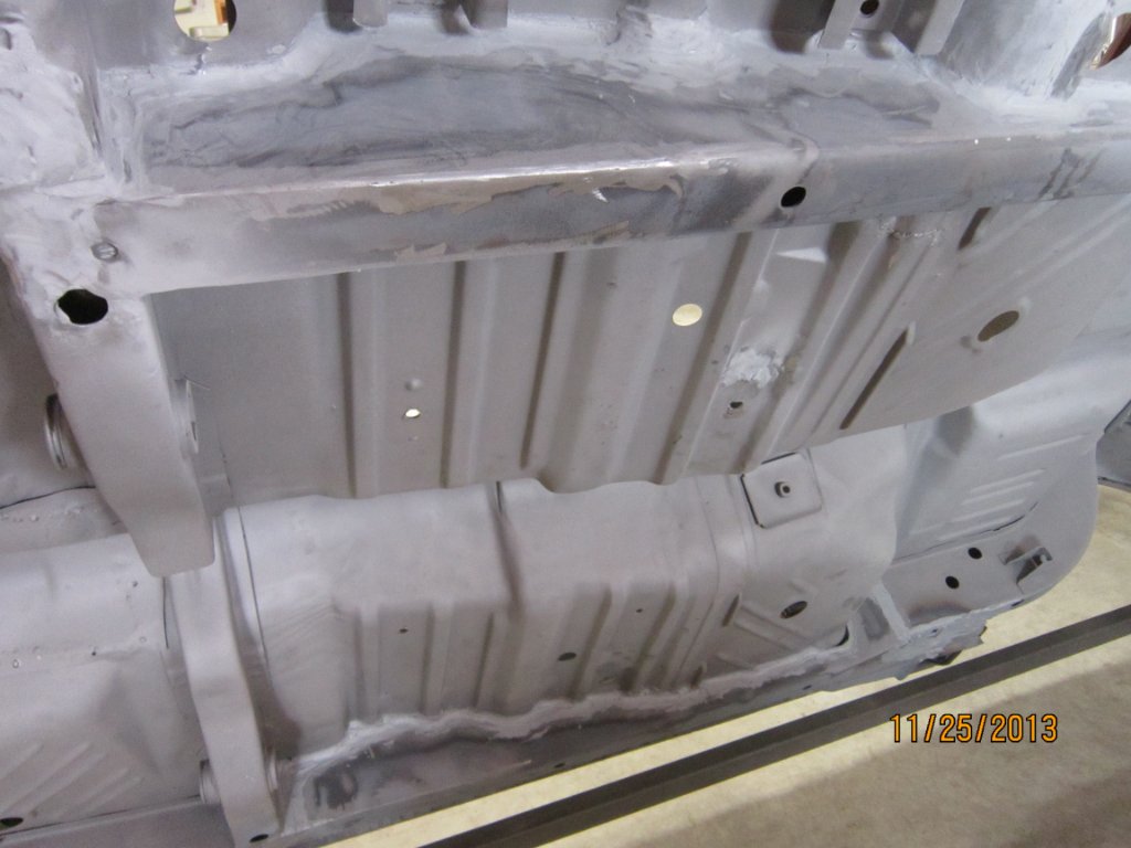

Little more body work done, frame connectors installed, and torque boxes

How was the fitment of your front torque boxes?
Did they need some massaging to get them to fit?
I ask because mine will need some massaging to get them to look like yours.
Next time I do a fit-check I'll post some pics.
Re: My RR resto project
Post by rr6pak » Mon Aug 13, 2018 11:43 pm
Thanks. The fitment of the torque boxes was great. Little to no trimming. Got mine from Resto Rick
Post by rr6pak » Tue Aug 14, 2018 9:28 am

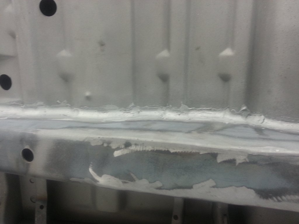

Frame connectors needed a little trimming. They're designed mainly for a E body but the floor for the B's is simmular. A little trimming here and there, place it back in, remove, a little more trimming and done. Welded it in and used "All metal" to fill in any areas as needed. Happy with the results :) . It really looks nice after you paint it because it looks factory almost.

For any of you who don't know, "All metal" is a filler (a little) with metal in it. It is used as a filler for like after welding to make sure everything is covered while having metal in it. This stuff can be painted so this is what we used. Here is a close up of the frame connector with the "All metal" as needed

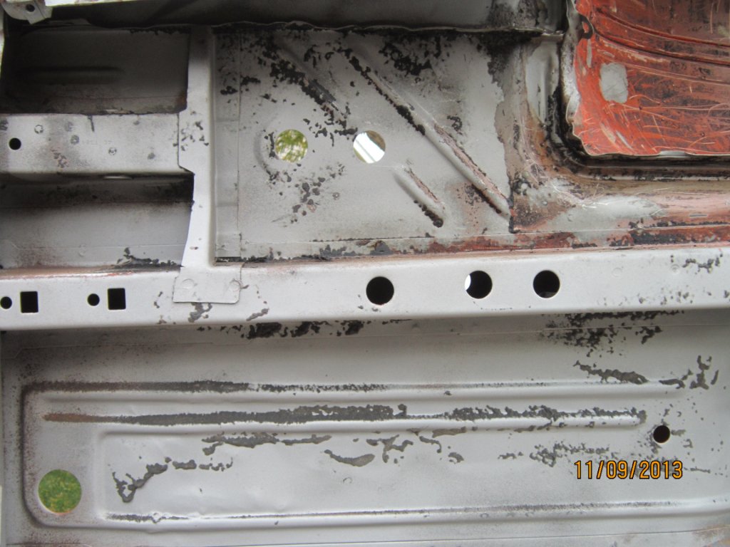

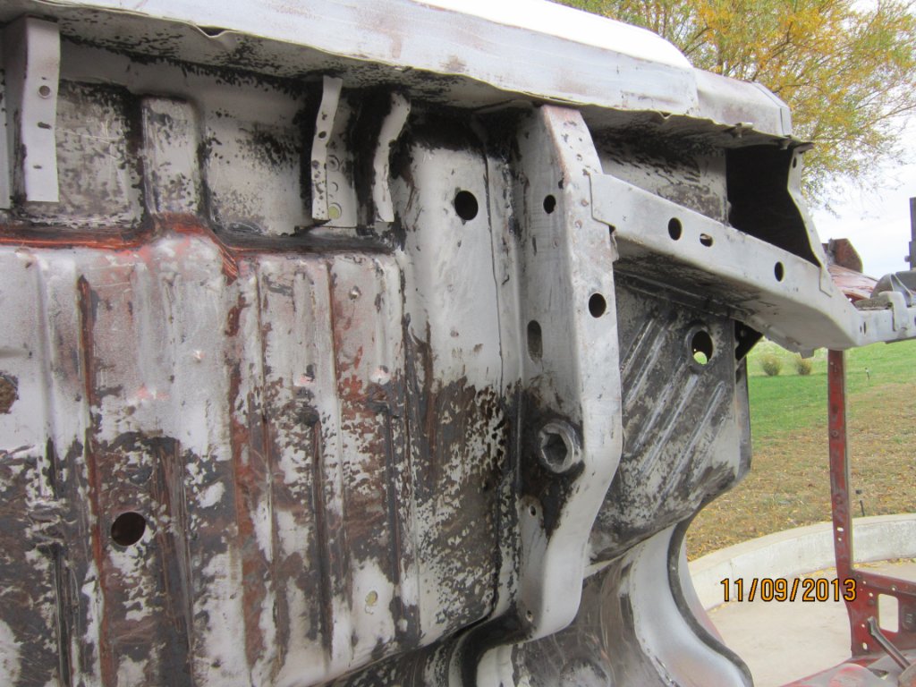

Post by rr6pak » Tue Aug 14, 2018 9:43 am

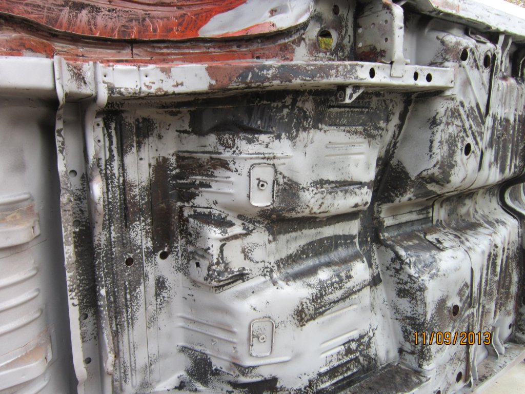

Here is some more of the undercarriage after removing the undercoating
