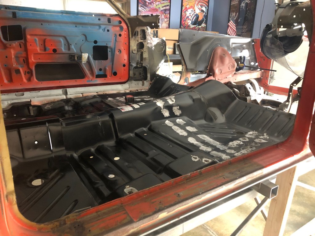

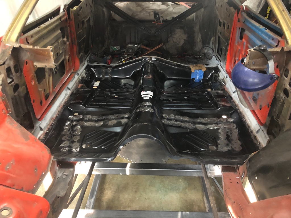

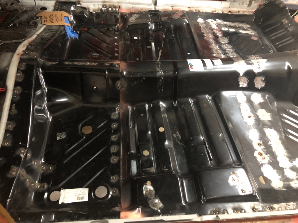

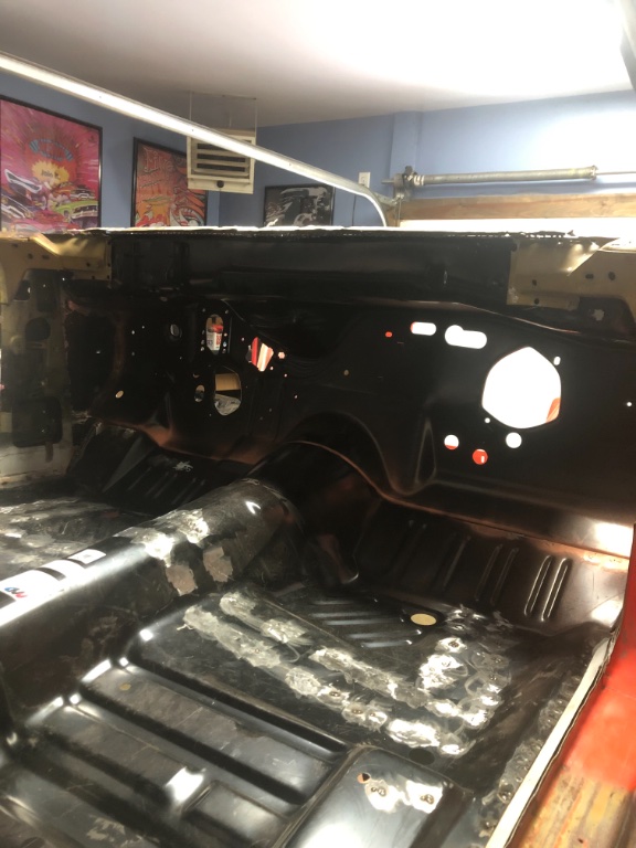

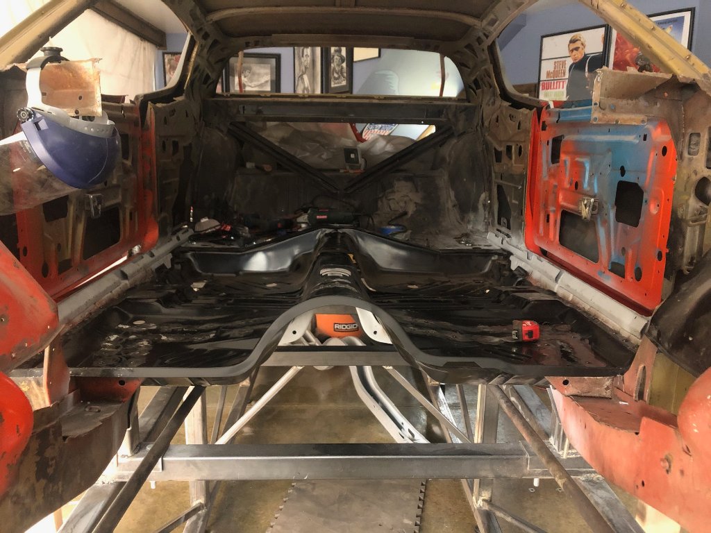

I'm still plugging away. I got the replacement crossmember welded in and in epoxy. I also hit the inside of the frame rails with epoxy, as far as I could. I then installed the front floor pan. I just need to grind the plug welds. I also have the rear foot wells in just for fitment check. I need to drill some holes in them for plug welds, grind coating off where it will be welded and get them in.

Still getting things done. I got the rear foot wells welded in. I just have to grind and sand the welds. Hopefully I’ll be able to start getting the firewall in soon. Thanks for looking!

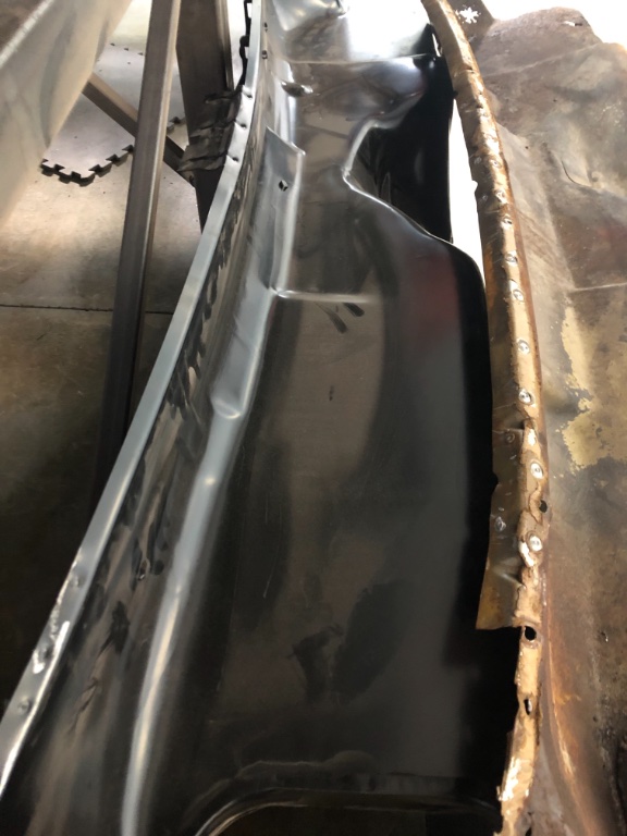

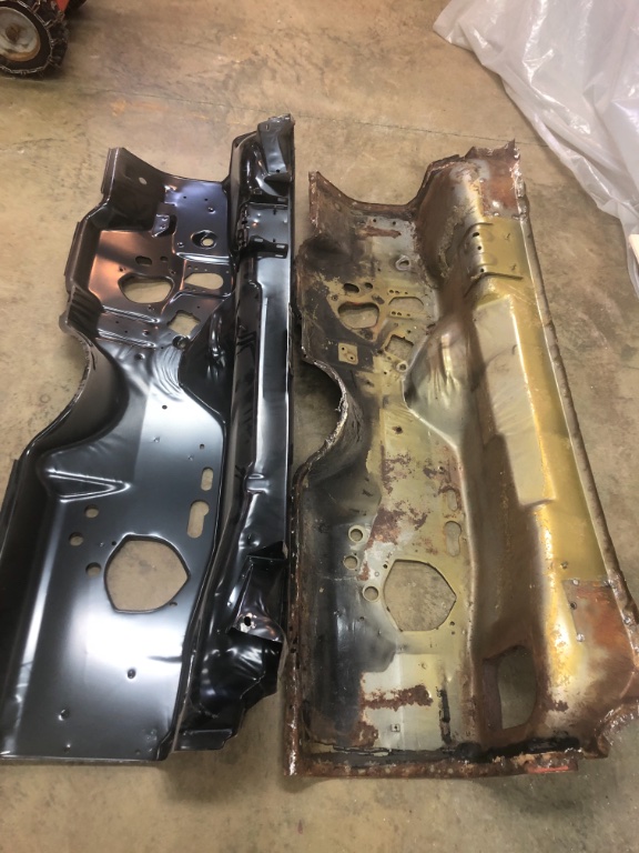

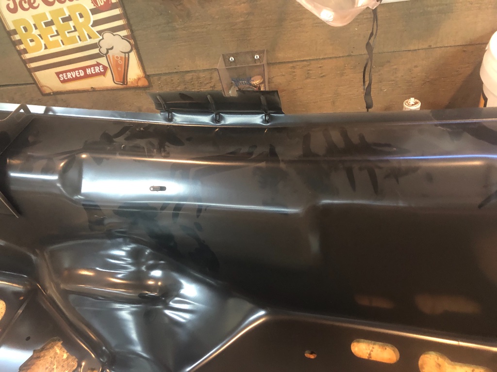

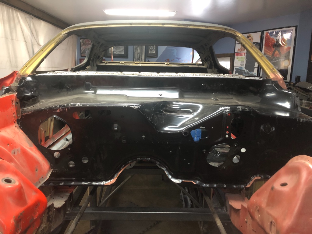

Making progress: I started mocking up the firewall from AMD. It this the an E body piece that is supposed to be correct for B bodies with AC. It is very close but, there are a few differences:
These mounting tabs are different, so I removed them:
Also, there’s a center tab that’s not correct:

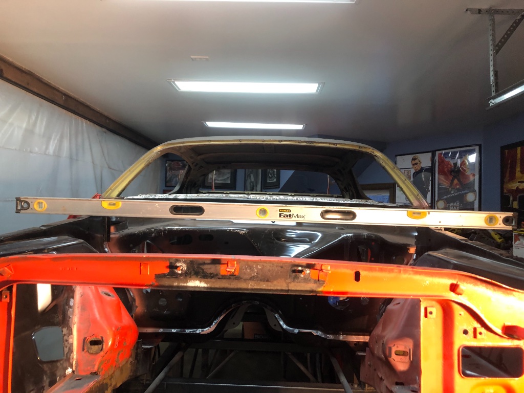

The biggest difference is the top flange that mounts to the cowl. I had to remove this flange from my original and weld on:
I’m waiting to do the final weld-in of the firewall until I get a new windshield. I want to make sure the flange I welded on is in proper alignment with the cowl and windshield. I don’t want any bad surprises!

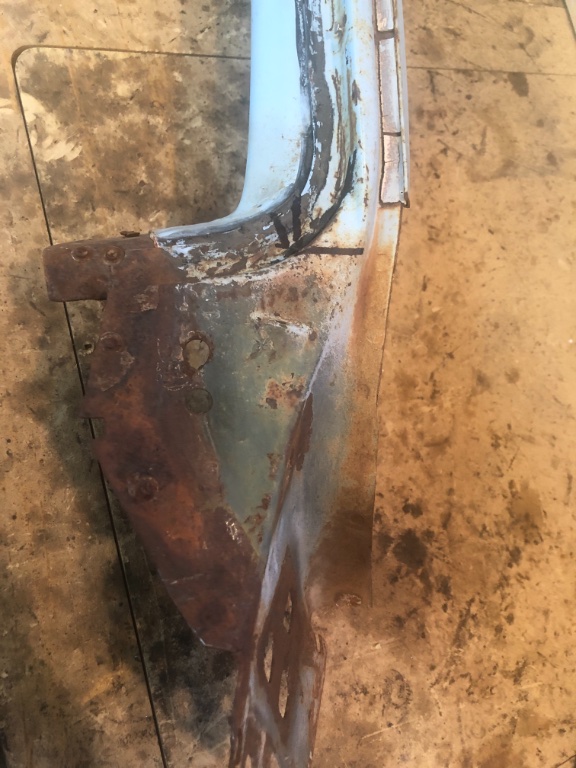

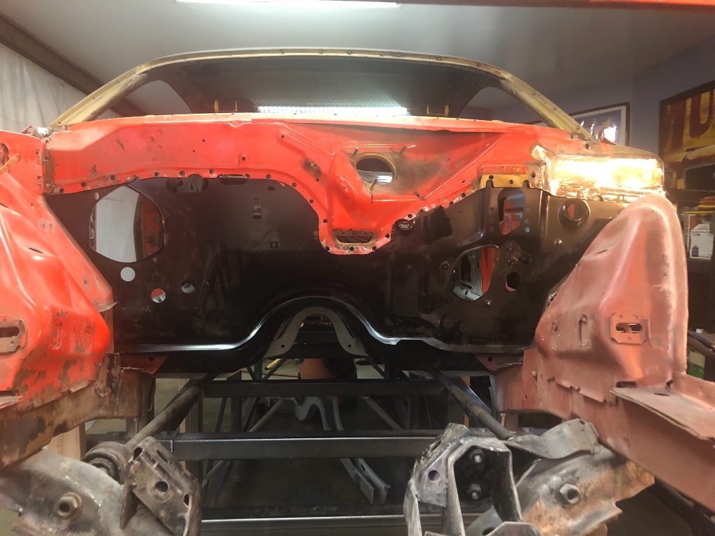

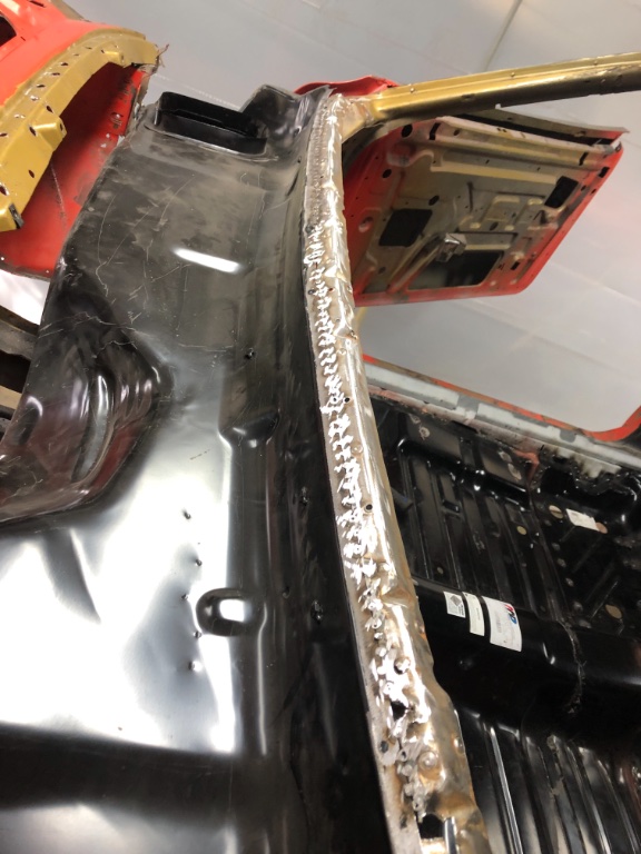

Here’s the firewall and cowl mocked up. I need to do some more repair work on my cowl:

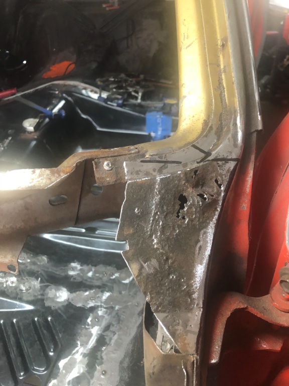

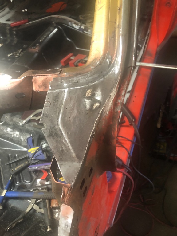

I also replaced the lower section of the driver’s windshield frame which many have done on this site.
Original:
Donor:
Welded in:

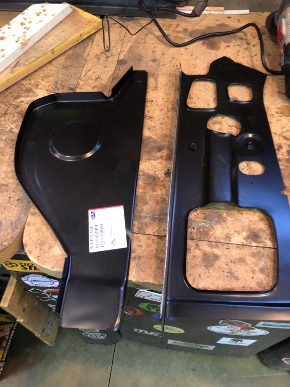

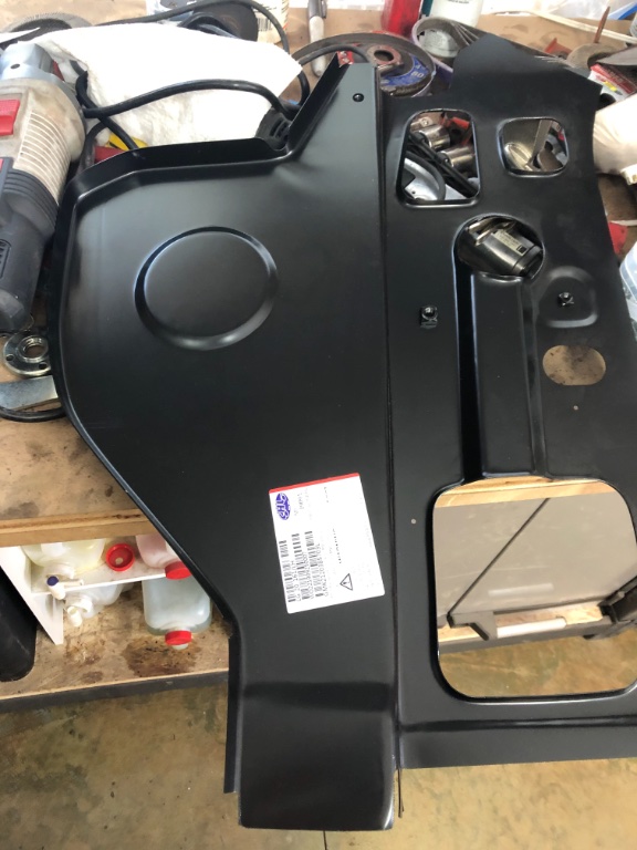

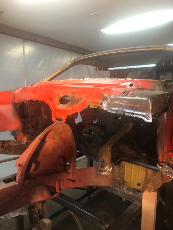

This weekend I replaced the left cowl side piece. I tried patching my original but I was chasing blow-throughs in several spots. I decided to purchase a cheap Goodmark replacement panel that fits the cuda/challenger. I took a gamble hoping it would be close for my needs. It wasn’t too bad. Mostly I wanted the panel for the circle punched into the panel.
I cut off what I needed. The circle was further over to the right on the repopped panel so, I had to cut it to fit properly

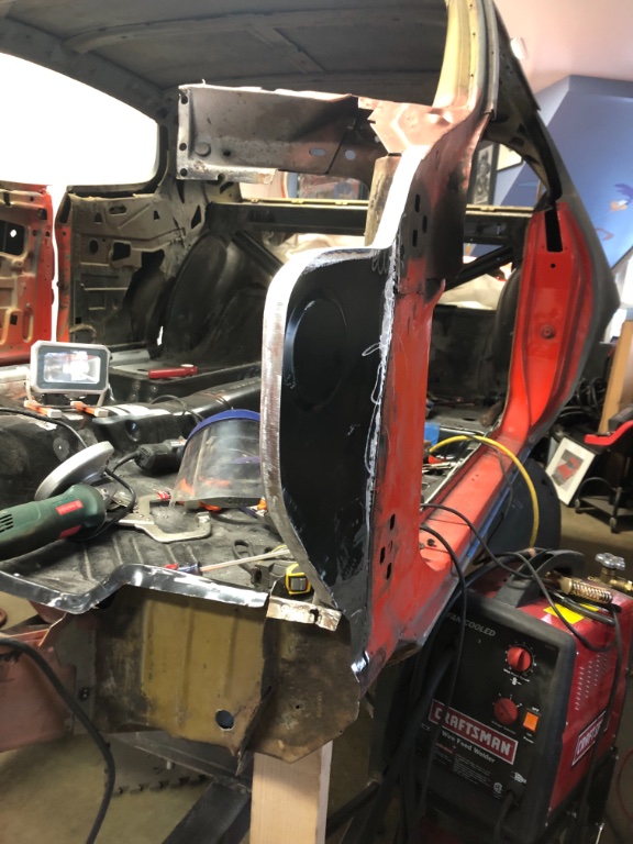

And then I welded it in and put a new flange on it:
I also got the firewall in. I purchased a spot welder from Harbor Freight to make the job easier:
I’m going to wait until I get my new windshield from ECS (6-8 weeks) before I install the cowl. I want to make sure the windshield fits properly before welding everything solid. I have plenty more work to keep me busy until then.

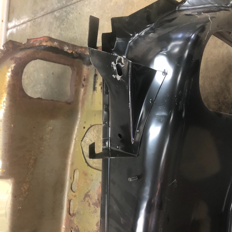

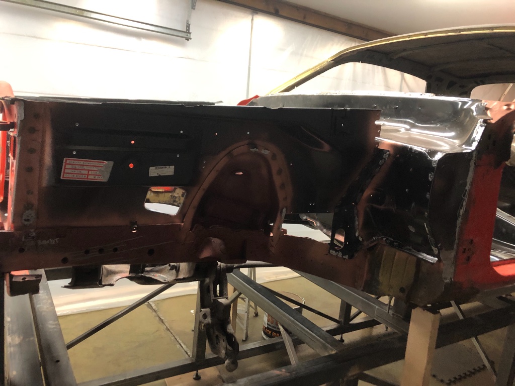

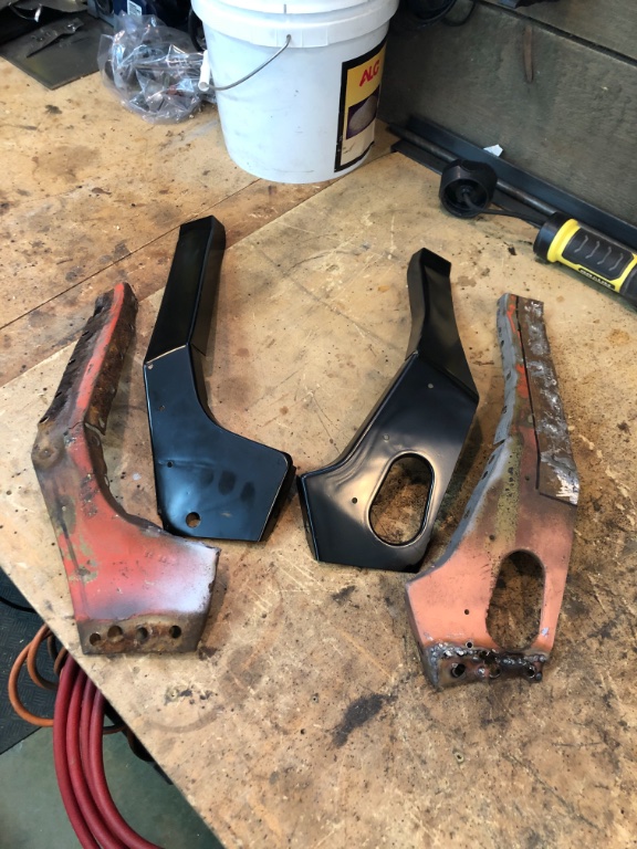

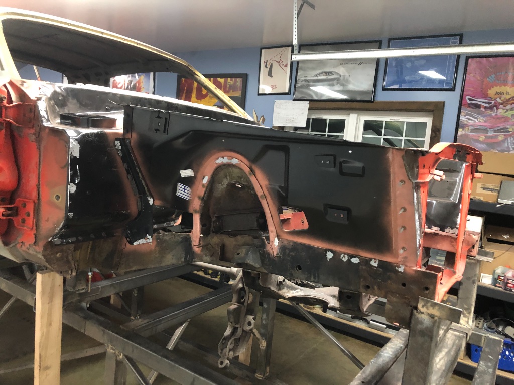

More progress: I got both inner fenders in this weekend.
I also replaced the cowl to fender brackets with AMD E-Body ones. They are almost exact. The only difference is that they are about 1/4” narrower than the originals.
