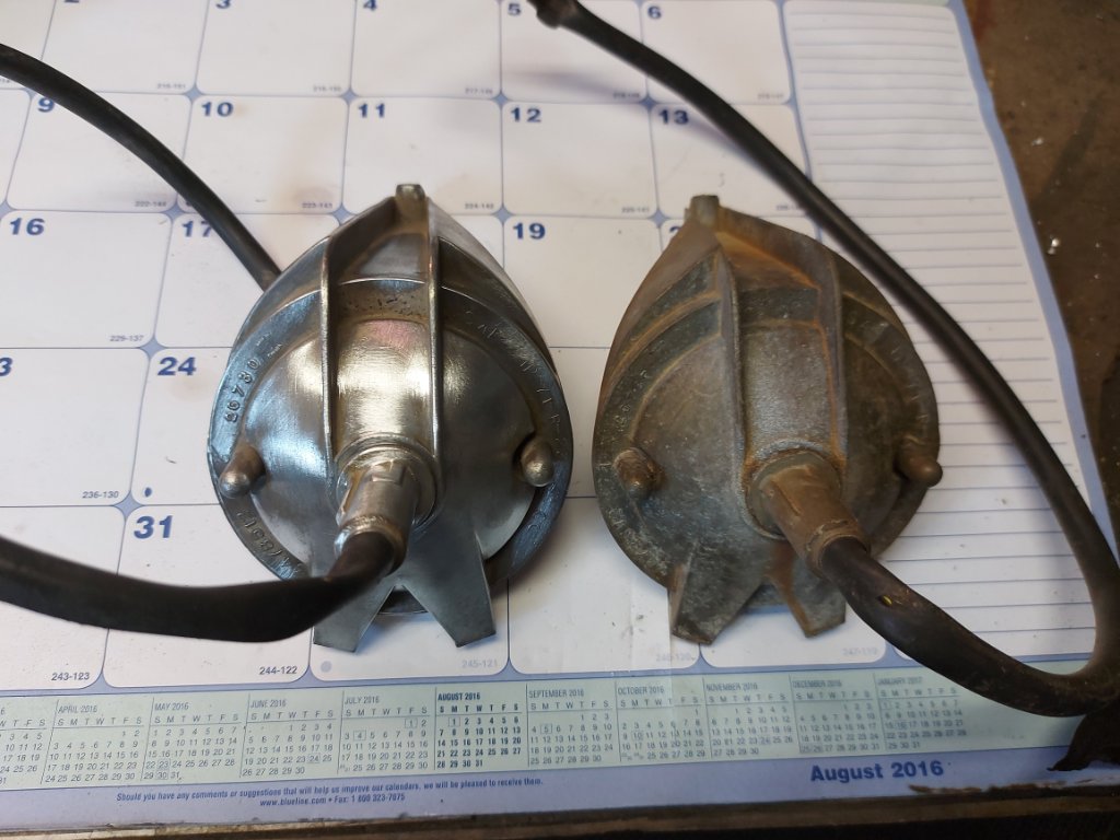

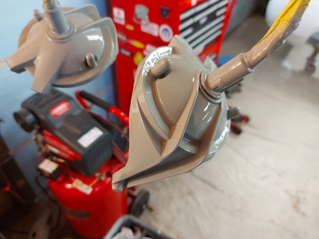

So I decided to move onto prepping the front signal light housings. Since they are aluminum castings they should clean up pretty well.
Here's the before and after shot.
Jan 31 (6).jpg (115.99 KiB) Viewed 28740 times
Here's the final cleanup.
Jan 31 (9).jpg (99.12 KiB) Viewed 28740 times

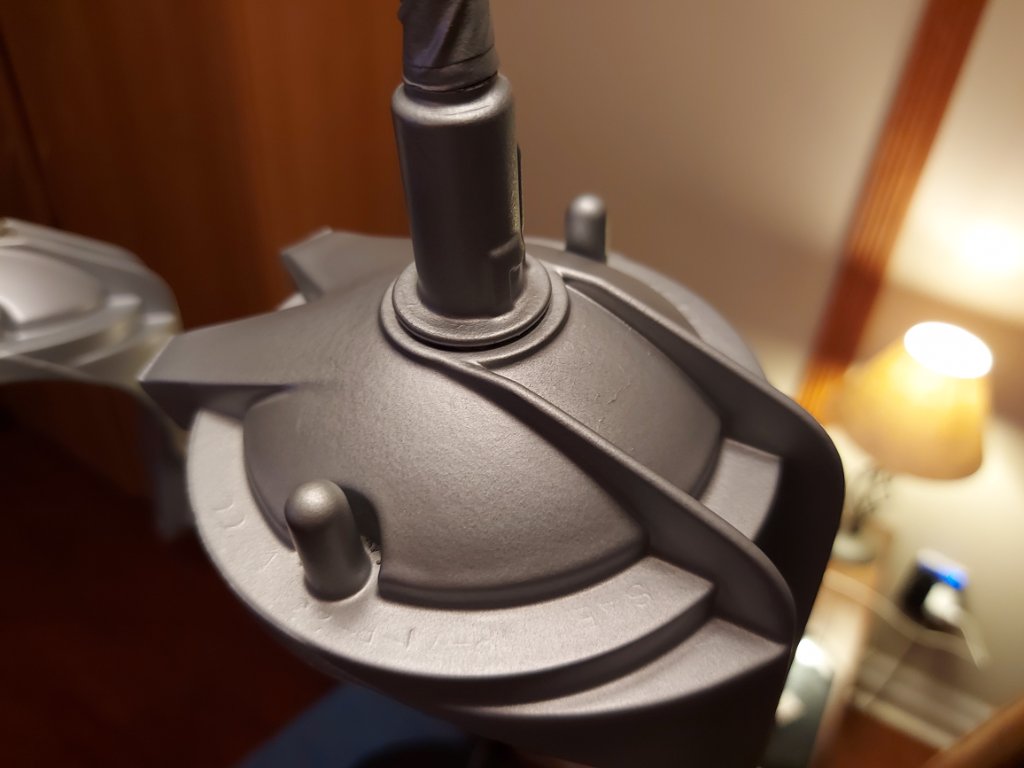

And with some primer on them.
Jan 31 (10).jpg (66.7 KiB) Viewed 28740 times
Jan 31 (12).jpg (82.57 KiB) Viewed 28740 times
Judging by their condition they came unprotected from the factory.
I will be spraying mine a cast aluminum color.

Did you media blast the housings? They came out great!
Post by 71Beeper » Tue Feb 02, 2021 1:52 pm
No ct - I did not blast them.
I used this fibre wheel in a drill press.
Fiber wheel.JPG (15.79 KiB) Viewed 28717 times
And I also used a wire wheel as it is easier to get it into little crevices that the fibre wheel can't get into.

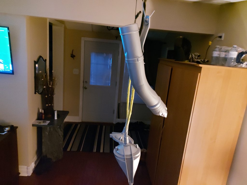

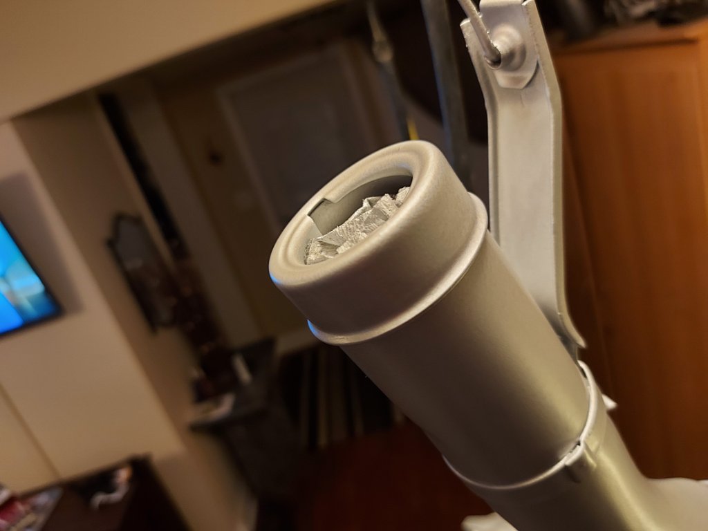

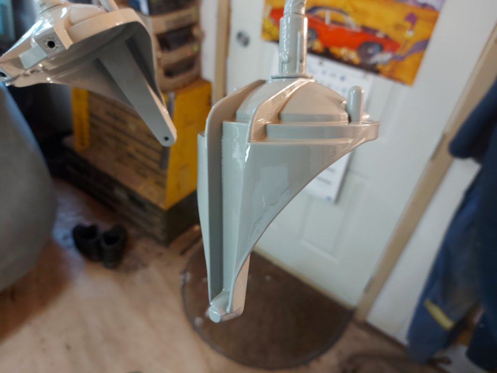

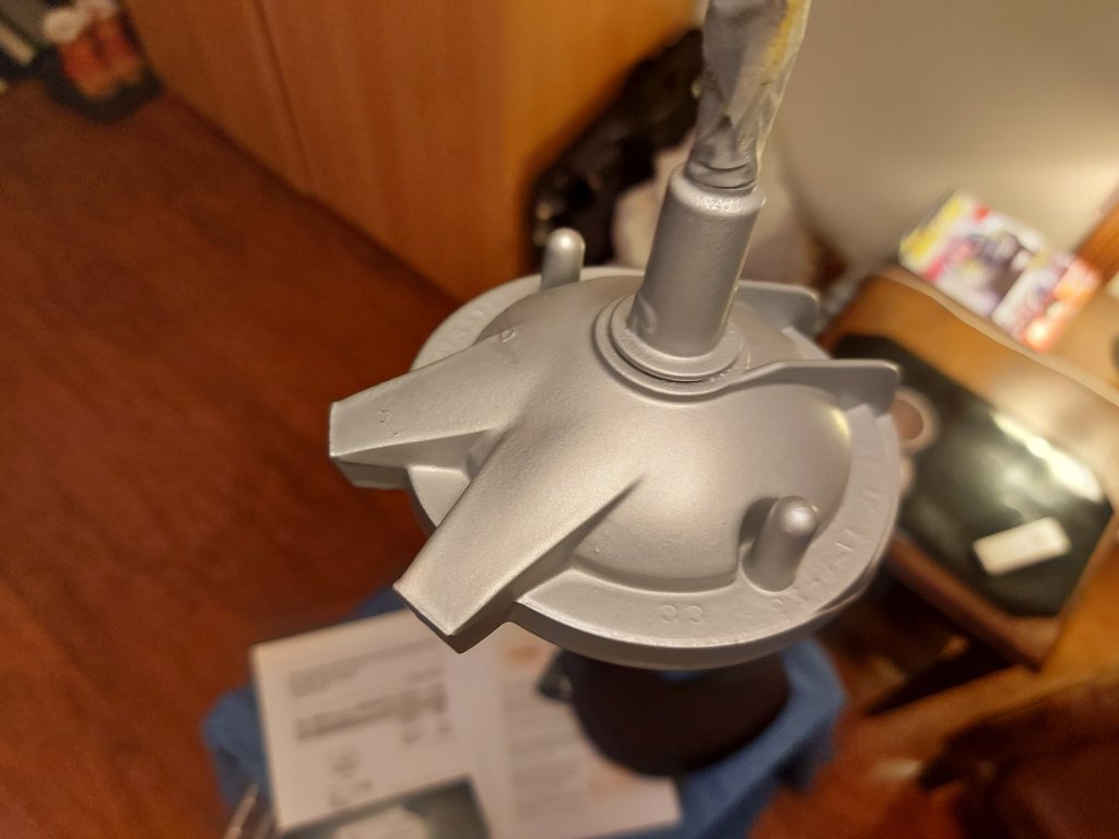

I even had to bring painted parts in the house to dry properly.
Feb 7 (1).jpg (82.45 KiB) Viewed 28693 times
Feb 7 (2).jpg (67.17 KiB) Viewed 28693 times
Feb 7 (3).jpg (76.29 KiB) Viewed 28693 times
Feb 7 (4).jpg (59.96 KiB) Viewed 28693 times

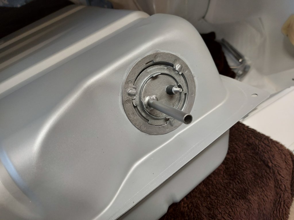

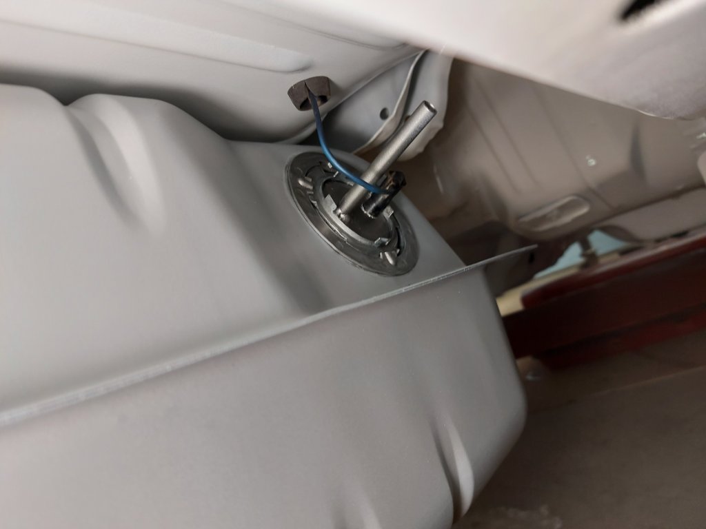

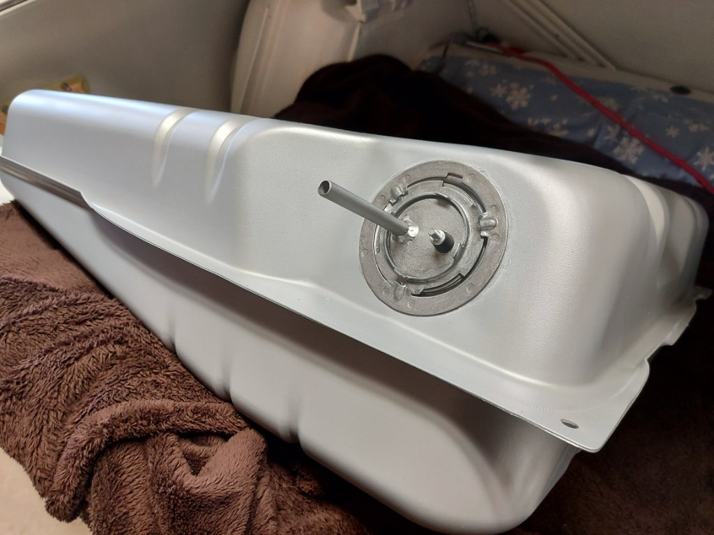

I did manage to get the fuel sending unit installed in the gas tank tho.....
Feb 7 (9).jpg (110.28 KiB) Viewed 28693 times
Feb 7 (11).jpg (81.52 KiB) Viewed 28693 times

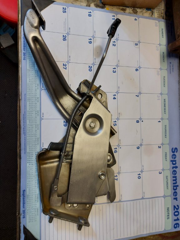

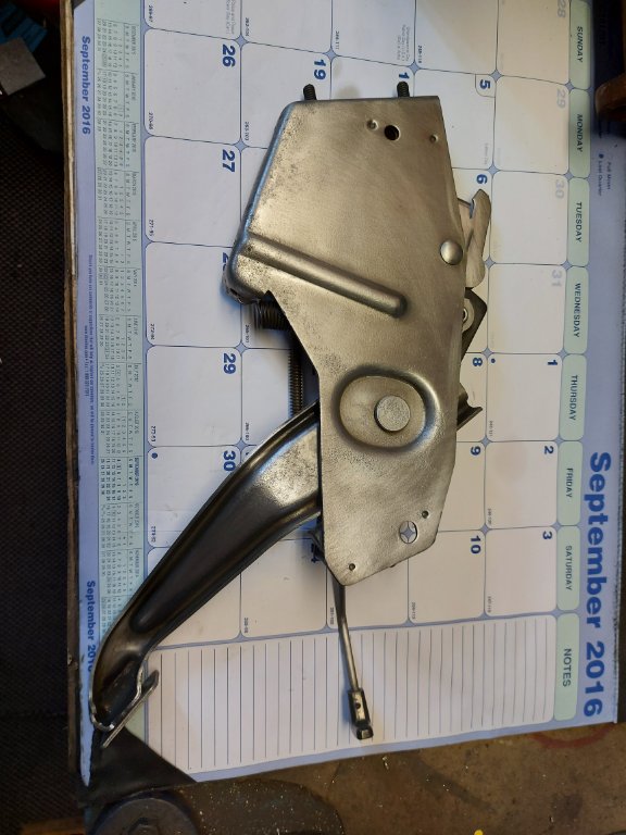

And I got the parking brake assembly out of the Evaporust and cleaned up - gotta wait for a little warmer weather to paint it.
Feb 7 (12).jpg (81.78 KiB) Viewed 28693 times
Feb 7 (13).jpg (79.36 KiB) Viewed 28693 times

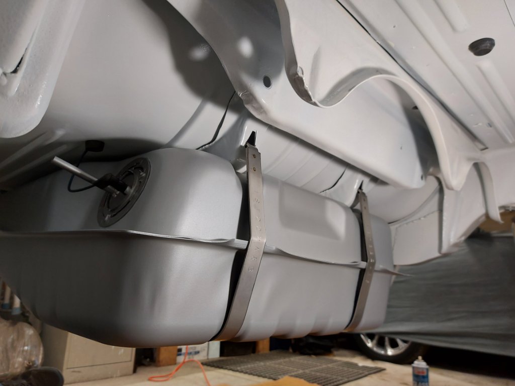

Post by 71Beeper » Mon Feb 15, 2021 10:53 am
So, with the weather being so cold out lately, no painting can be done in the garage with no heat.

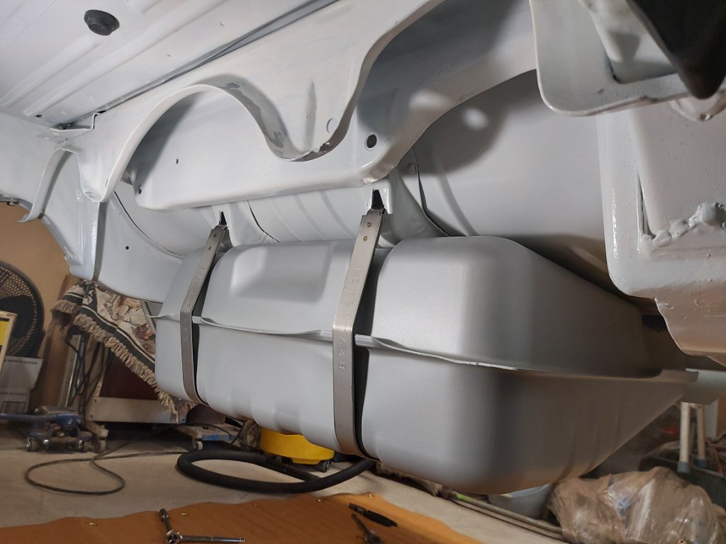

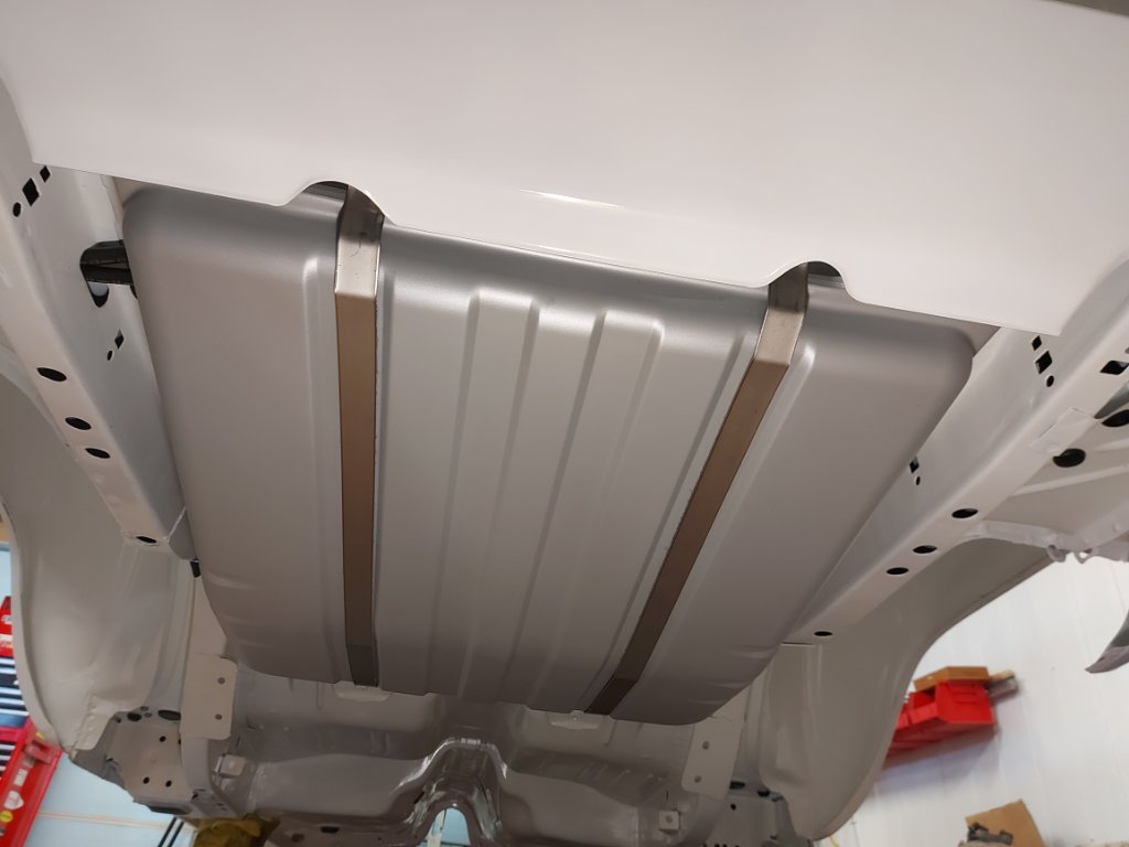

Instead......with some grunting and groaning and being very careful not to scratch anything I installed the gas tank.
The stainless straps gave me some grief, but I was able to git her done.
