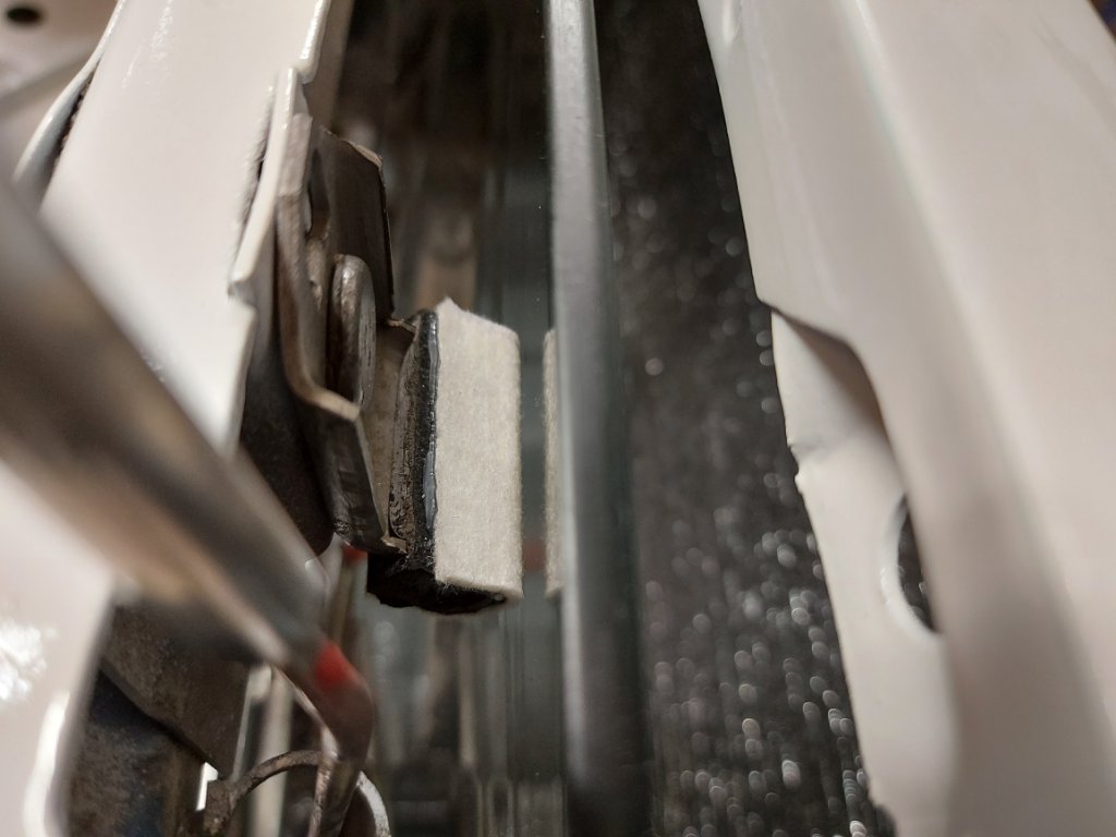

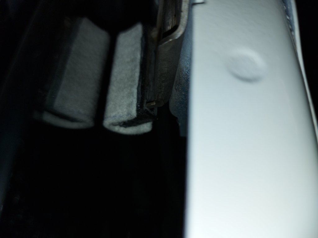

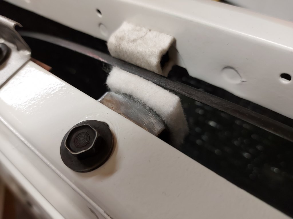

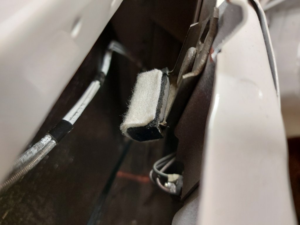

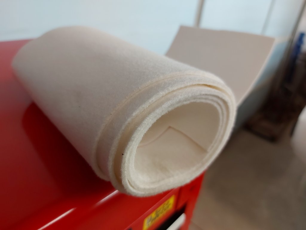

I removed the fuzzies from their base, as they were worn, and put on a thick felt.
Dec 22 (2).jpg (64.89 KiB) Viewed 41569 times
On the piece that goes on the outer door at the top, I applied a thinner felt.
Dec 22 (1).jpg (44.52 KiB) Viewed 41569 times
Dec 22 (4).jpg (37 KiB) Viewed 41569 times
And on the window stoppers I covered them with the same thinner felt, but realized it wasn't really necessary.
Dec 22 (5).jpg (75.35 KiB) Viewed 41569 times
Dec 22 (7).jpg (66.28 KiB) Viewed 41569 times
The company I work at makes industrial products using textiles, we have that felt in stock.

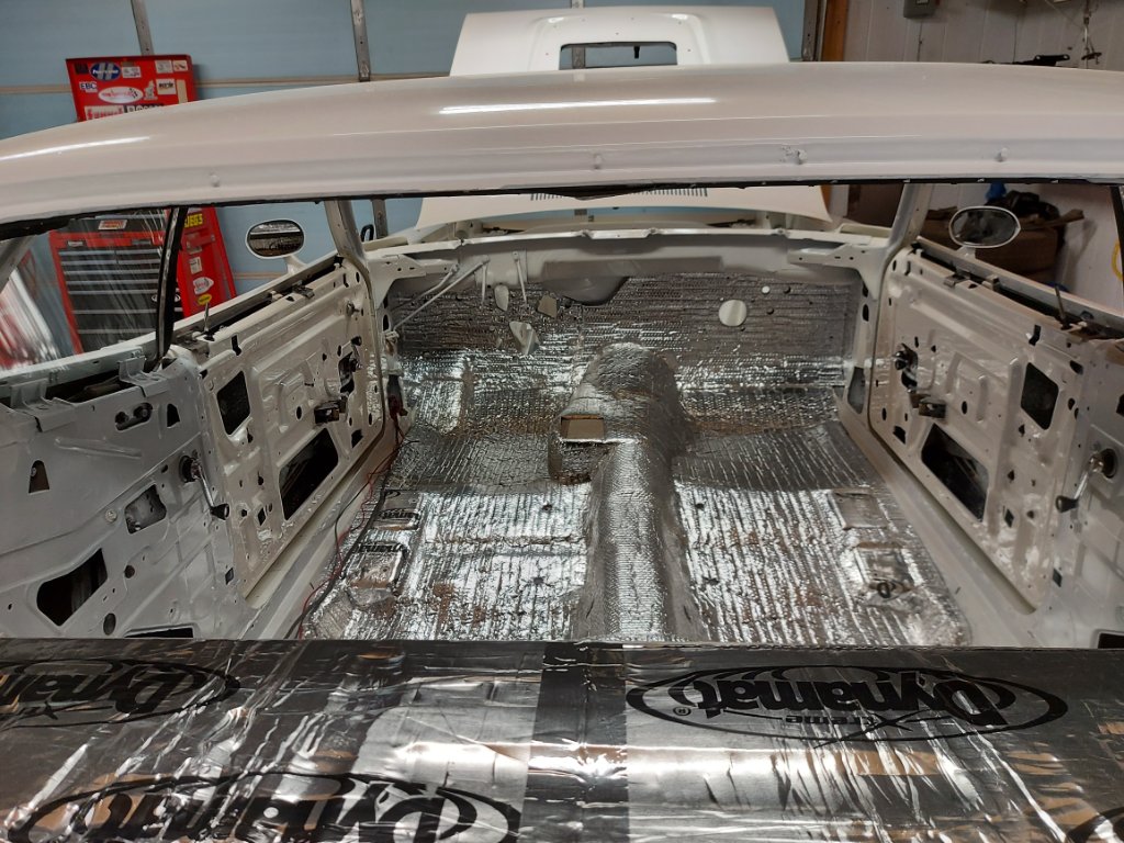

Post by 71Beeper » Mon Dec 28, 2020 4:54 pm

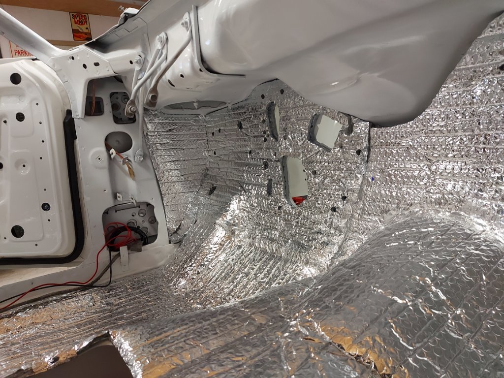

I took advantage of the Christmas holiday's to get out in the shop and put down the rest of the sound deadner.

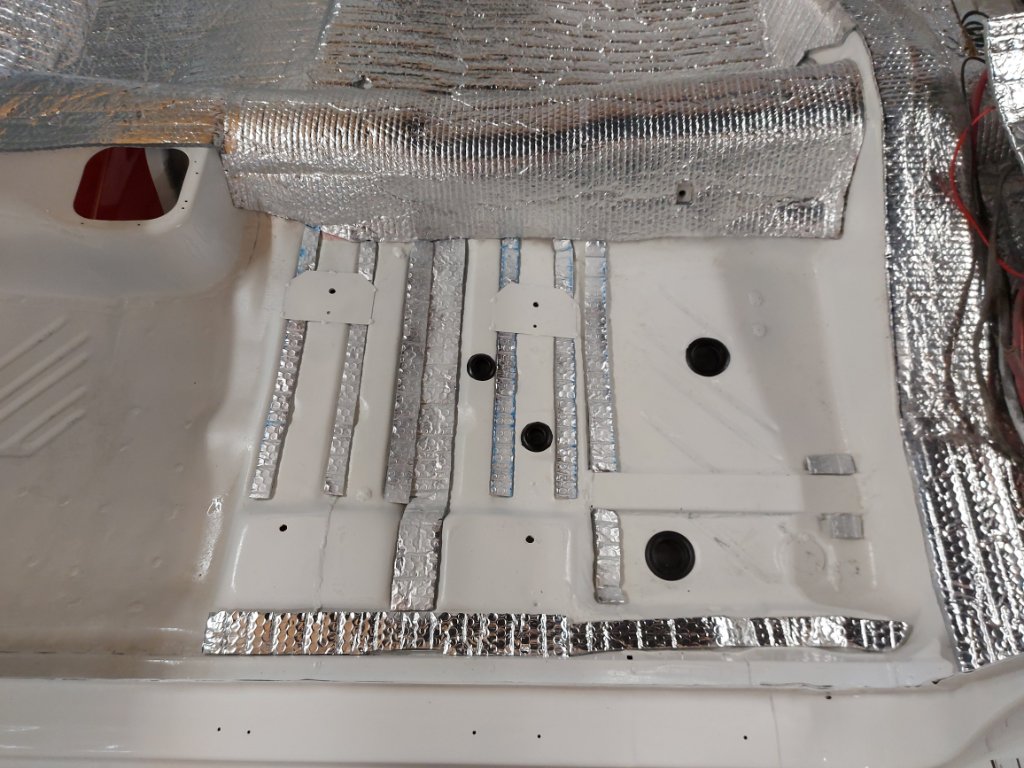

I put some filler pieces in the little valleys.
Dec 26_27_28 (3).jpg (147.11 KiB) Viewed 41538 times
Then add the rest.
Dec 26_27_28 (5).jpg (190.88 KiB) Viewed 41538 times
Then work my way up to the front.
Dec 26_27_28 (7).jpg (174.29 KiB) Viewed 41538 times
Finally do the firewall piece.
Dec 26_27_28 (9).jpg (227.98 KiB) Viewed 41538 times
And I'm still not done...

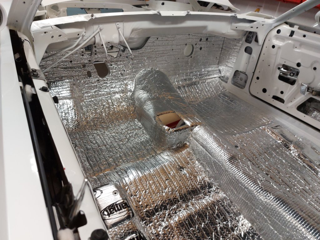

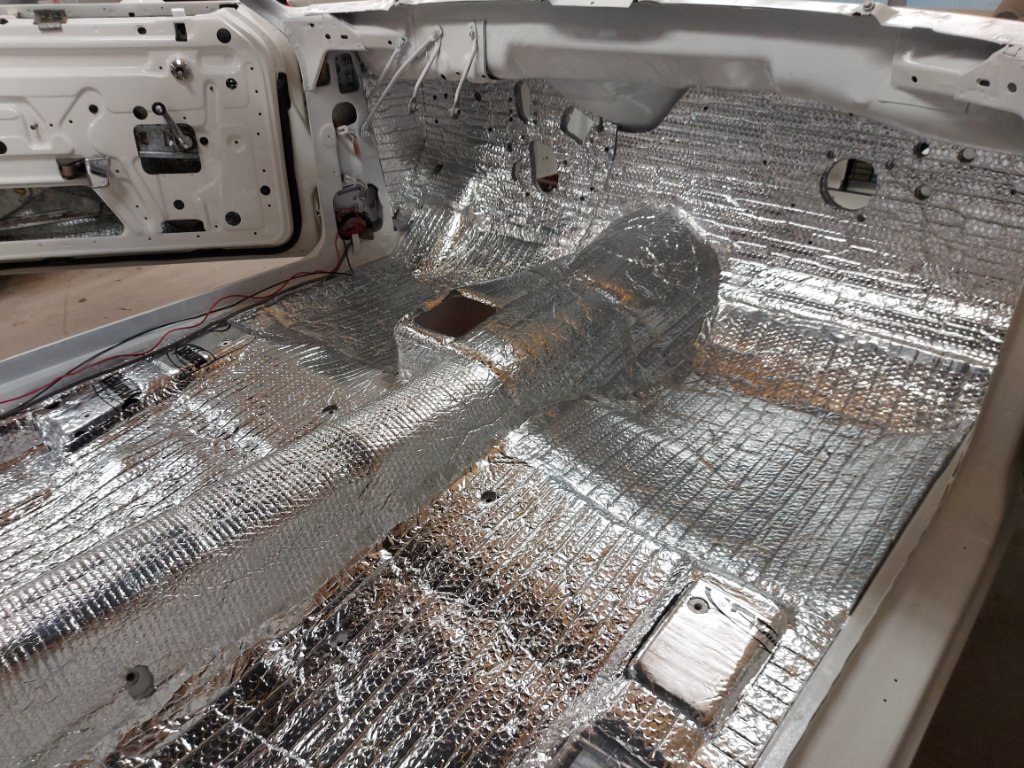

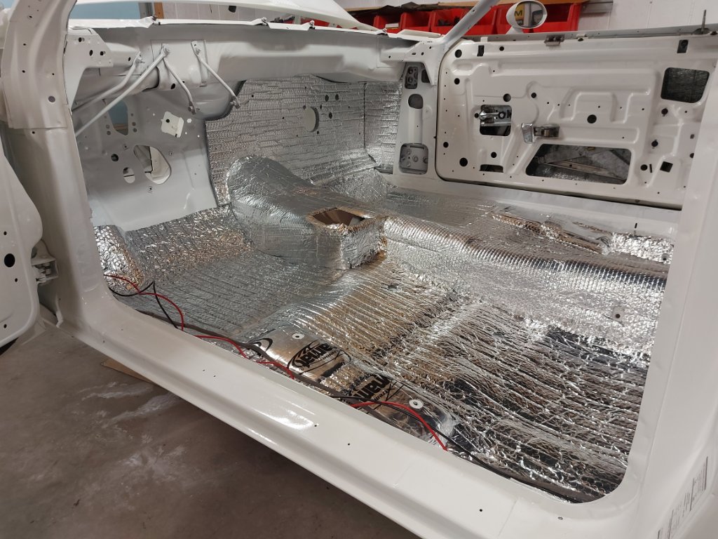

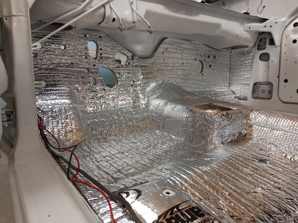

Post by 71Beeper » Fri Jan 01, 2021 11:07 pm
Happy New Year Guys!

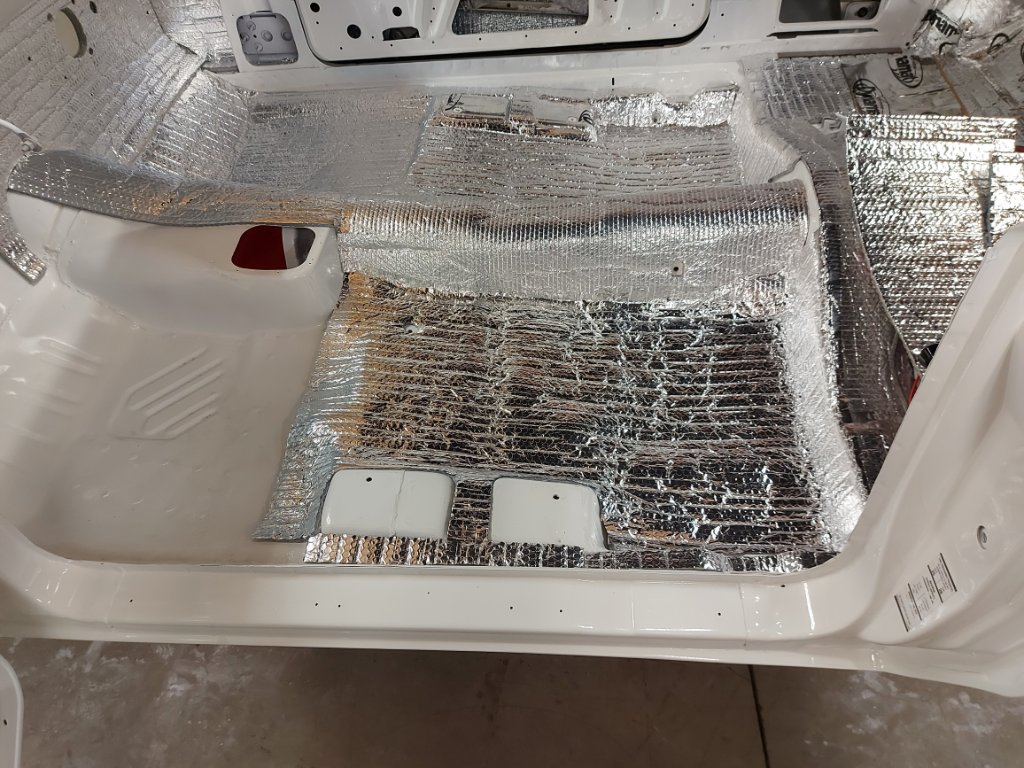

I finally got all the sound deadner installed.
Dec 26_27_28 (10).jpg (239.44 KiB) Viewed 41496 times
Dec 26_27_28 (11).jpg (235.09 KiB) Viewed 41496 times
Dec 26_27_28 (12).jpg (204.66 KiB) Viewed 41496 times
Dec 26_27_28 (13).jpg (190.43 KiB) Viewed 41496 times
Dec 26_27_28 (14).jpg (204.83 KiB) Viewed 41496 times
I think I have more of it than the space shuttle.... :lol:

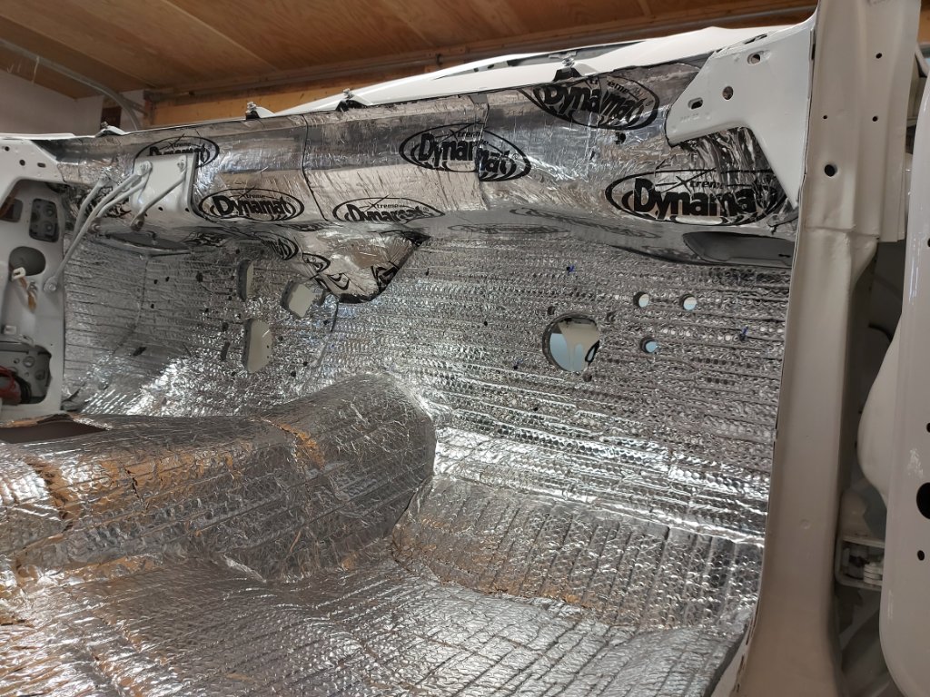

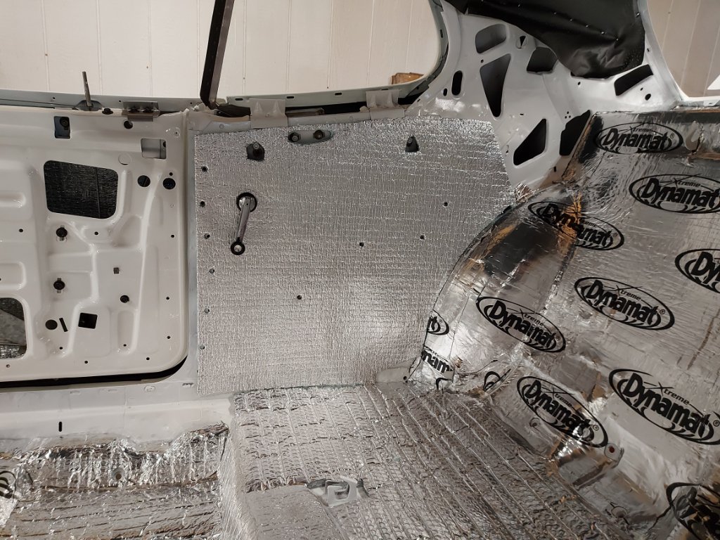

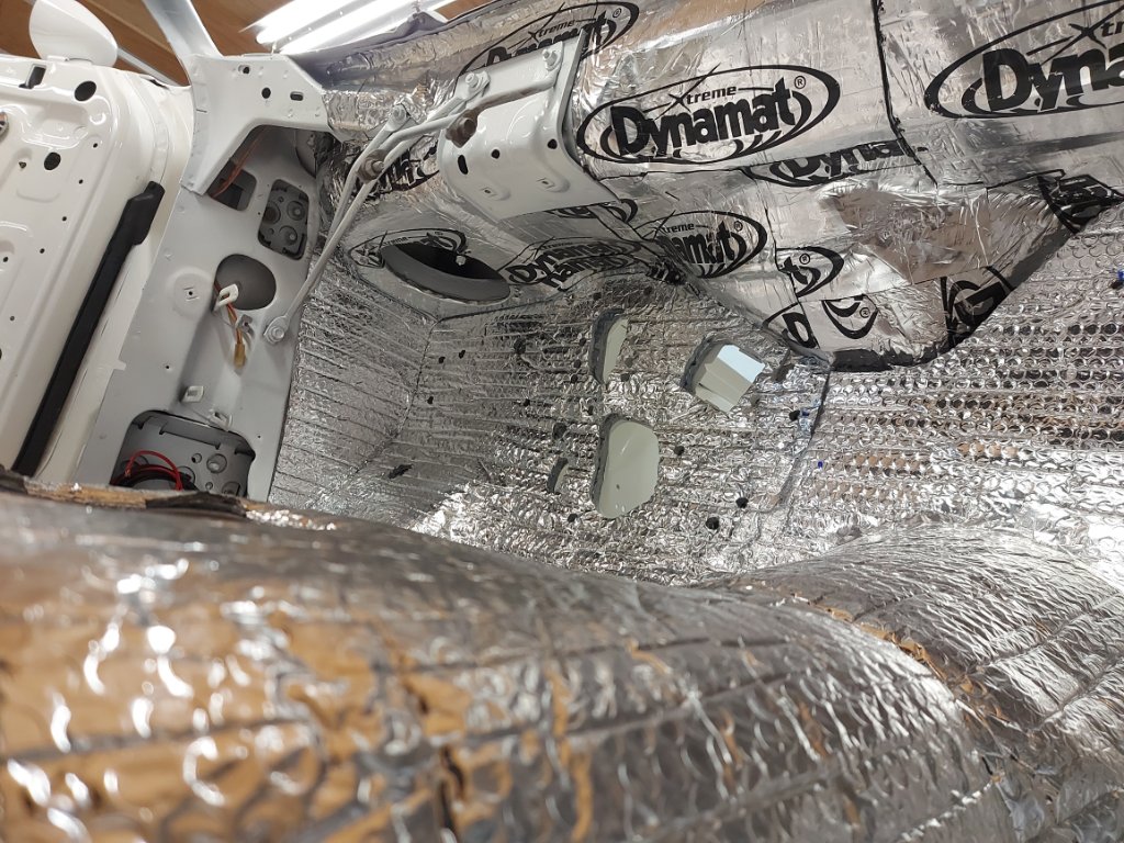

Post by 71Beeper » Sun Jan 03, 2021 8:20 pm

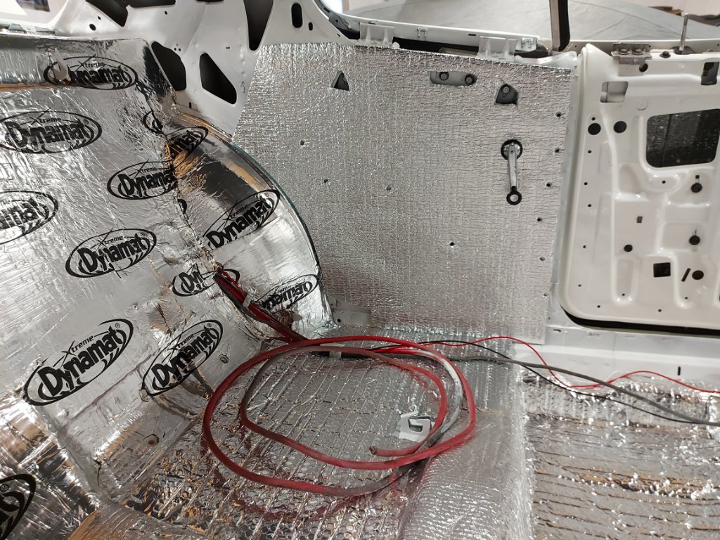

So keeping on with the sound deadner theme, I added more of it.
I put some Dynamat here...
Dec 31 (3).jpg (226.49 KiB) Viewed 41481 times
Dec 31 (2).jpg (222.38 KiB) Viewed 41481 times
Then I made these side panels.
Jan 2 (3).jpg (205.49 KiB) Viewed 41481 times
Jan 2 (4).jpg (238.83 KiB) Viewed 41481 times
I think that completes the sound deadner project....yay!

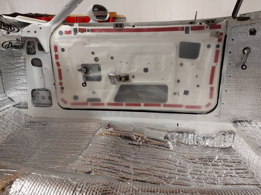

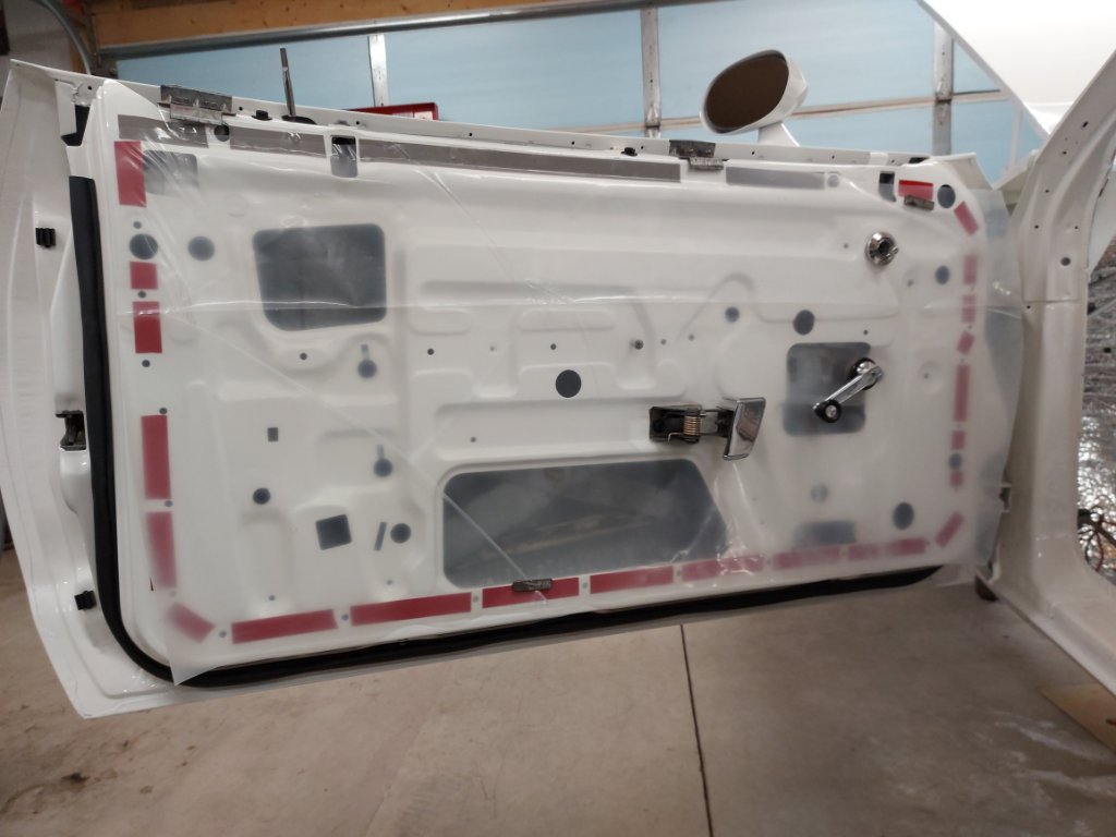

Post by 71Beeper » Sun Jan 03, 2021 8:22 pm
With the doors having sound deadner in them already, I made up the regular vapor barrier for them.
I'll use double sided foam tape to hold them to the door.
Jan 2 (5).jpg (84 KiB) Viewed 41481 times
Jan 2 (6).jpg (195.35 KiB) Viewed 41481 times

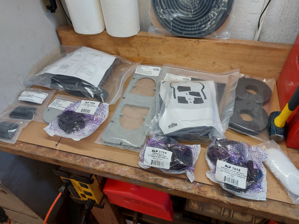

Today my box of gaskets arrived from Detroit Muscle Technologies.
Jan 9 (5).jpg (143.23 KiB) Viewed 41415 times
My proper length of trunk weather stripping now fits like its suppose to.

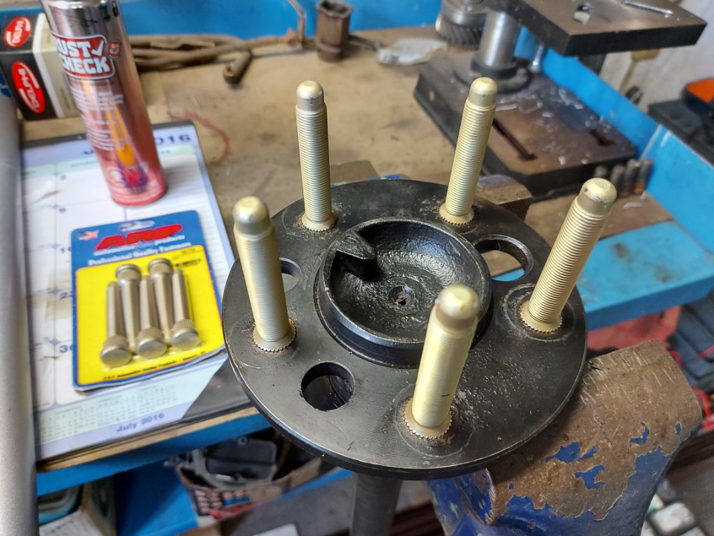

Also, my axle studs from ARP arrived.
Jan 9 (1).jpg (94.11 KiB) Viewed 41415 times
Time to install them.
Jan 9 (4).jpg (147.31 KiB) Viewed 41415 times

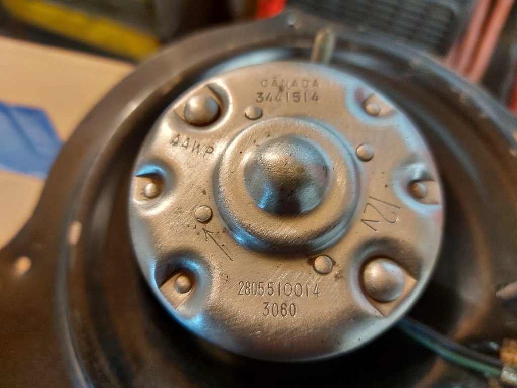

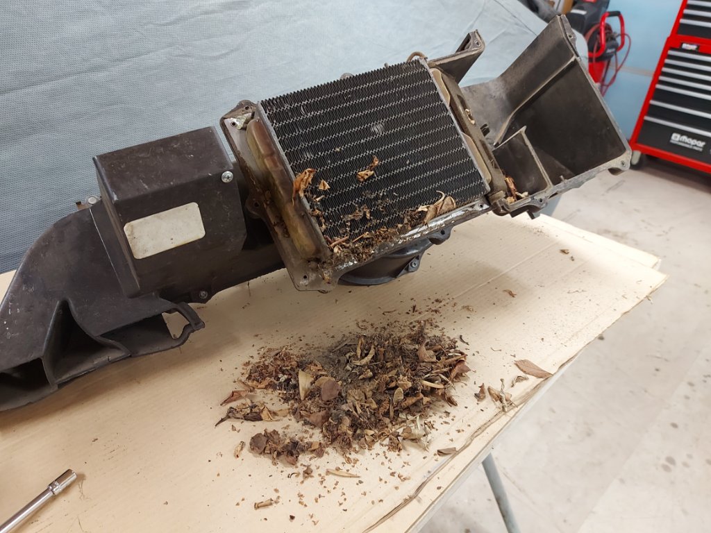

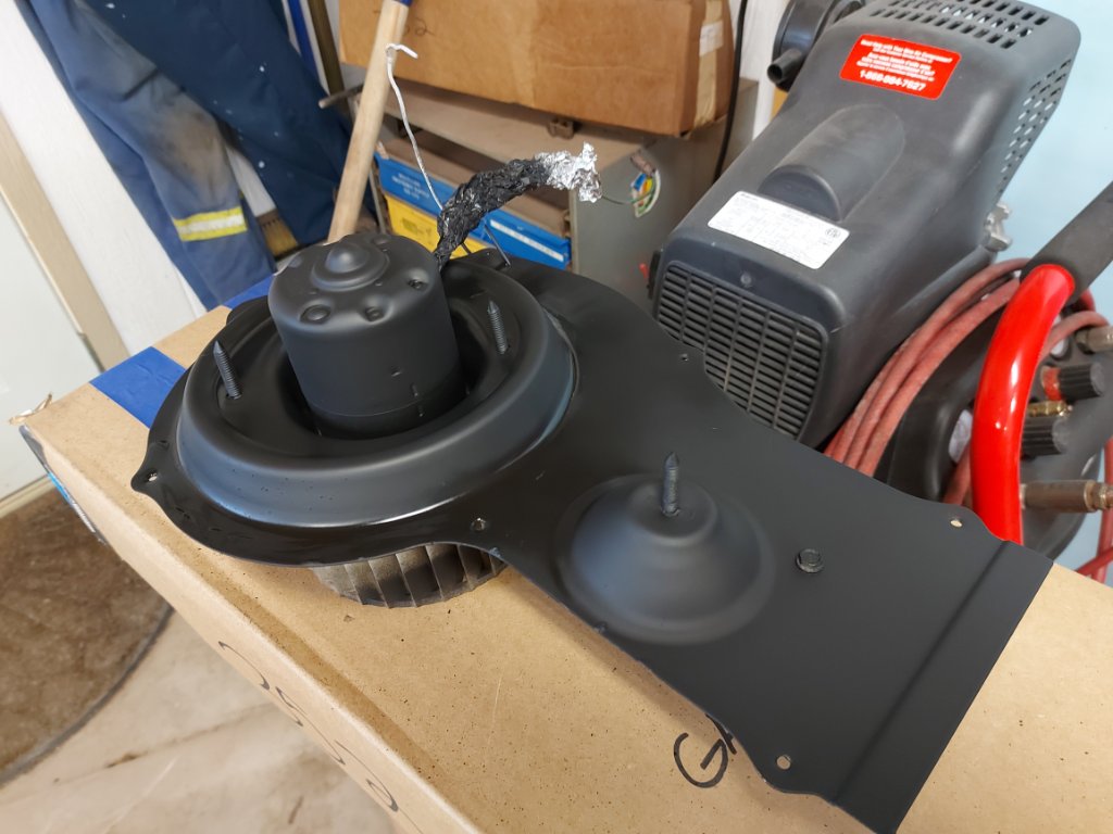

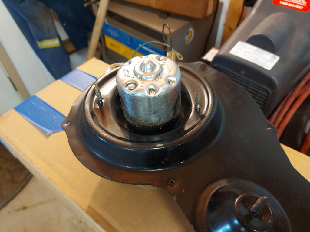

Post by 71Beeper » Sun Jan 10, 2021 9:14 pm

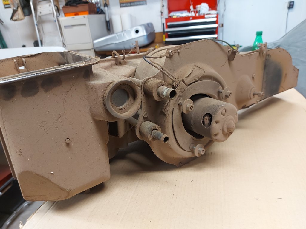

The heater box was covered in the dust left over from all the sandblasting that I did earlier.
Opened it up and this was in it... :shock:
Jan 3 (18).jpg (157.25 KiB) Viewed 41415 times
No mouse poop thank God. The heater core looks to be in good shape. I'll put some vinegar in it and rinse it out.
In the meantime I cleaned up the heater motor and got it ready for primer.
Jan 10 (1).jpg (96.63 KiB) Viewed 41415 times
Jan 10 (2).jpg (102.57 KiB) Viewed 41415 times
Jan 10 (3).jpg (106.22 KiB) Viewed 41415 times

Good thing I ordered the gasket kit from Detroit Muscle car technologies - the original 50 year foam on the blend doors literally fell apart as soon as I touched them... :shock:

Post by 71bird » Thu Jan 14, 2021 10:45 am
I like the idea of the felt for the side glass, have you rolled the glass up and down to see how it compares to original?
Post by 71Beeper » Sat Jan 16, 2021 9:25 pm
Yes, I did.
To be honest with you, and it could be that they need a final adjustment, but so far the glass is nice and tight going up or down.
There is no wobble in it, which is what I found with the original bits on it.
Don't forget the original guides were worn.
I've left the rubber blocks that go in the bottom of the door out as I need the glass to go below the point of where the fuzzies fit, that's the only way you will be able to put the mounting screws in with the glass installed.

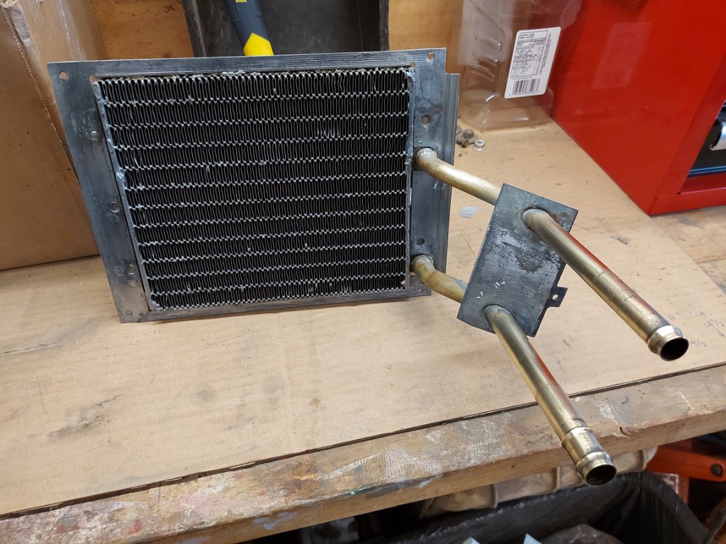

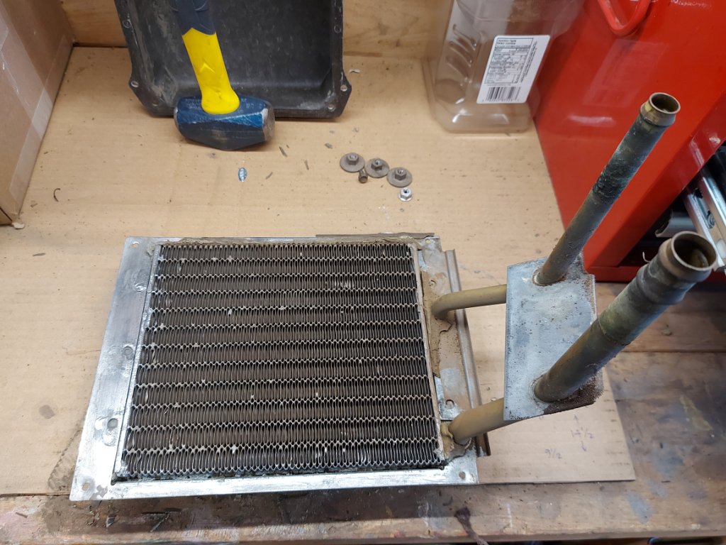

Continuing on with the heat box, I took out the heater core and cleaned it up.
Jan 16 (1).jpg (156.8 KiB) Viewed 41283 times

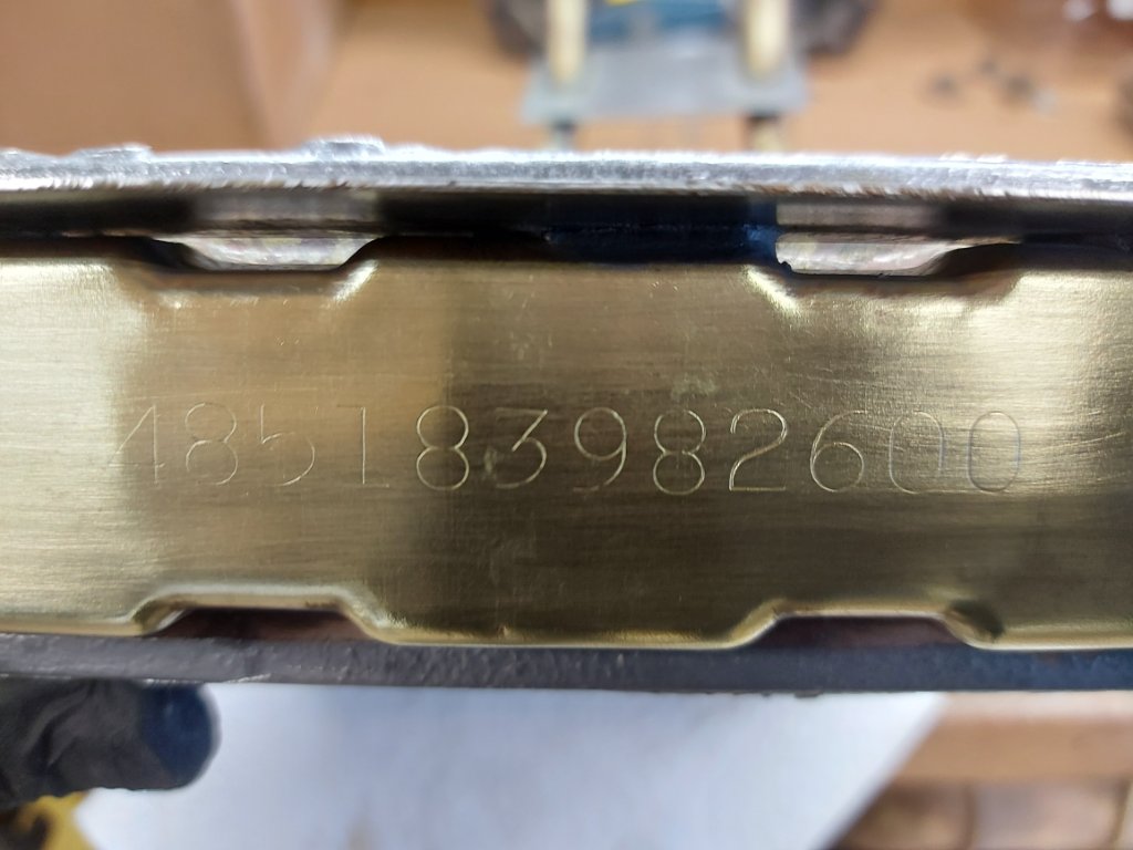

I even found a part number on the underside of it.
Jan 16 (4).jpg (90.62 KiB) Viewed 41283 times
Here's the finished product.
Jan 16 (8).jpg (164.91 KiB) Viewed 41283 times

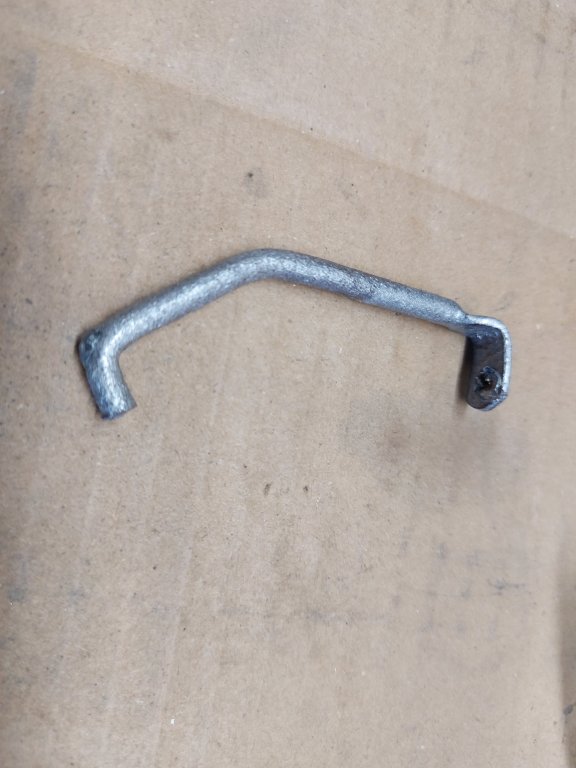

Don't forget about the little hook type attachment for non A/C boxes.
Jan 16 (5).jpg (58.05 KiB) Viewed 41283 times

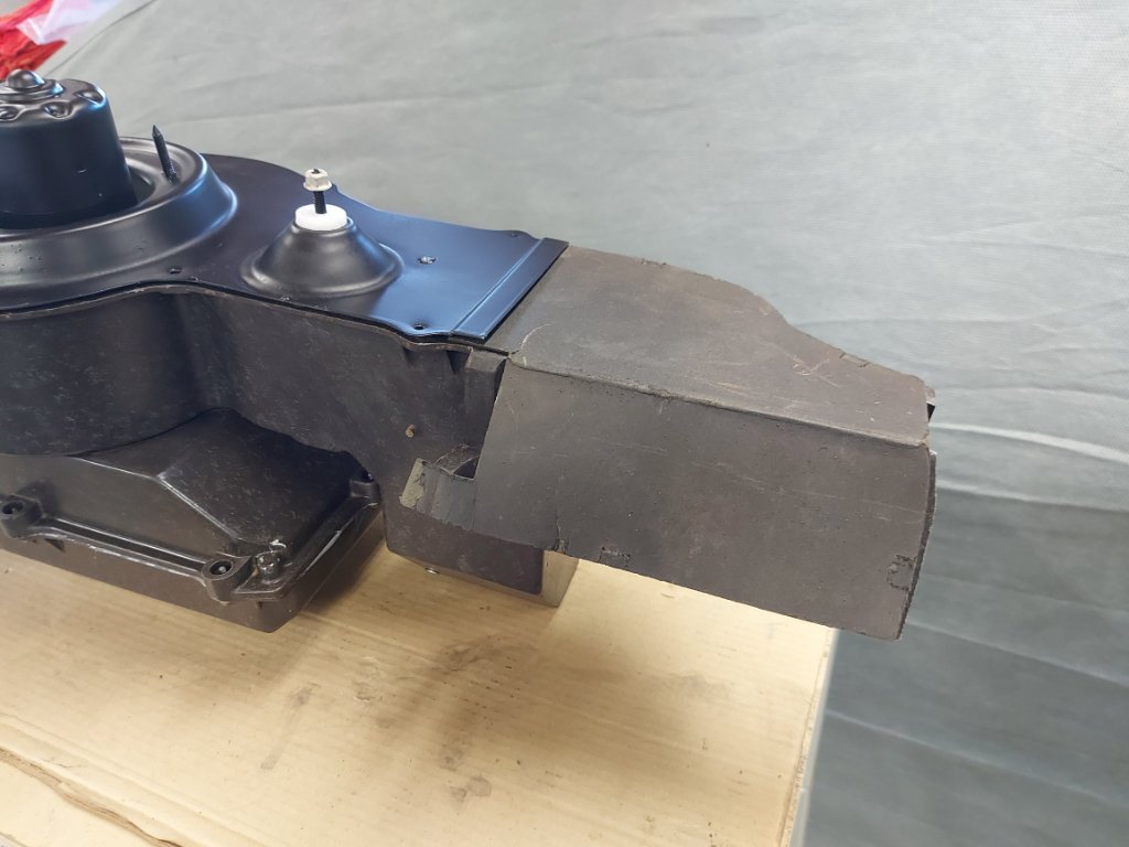

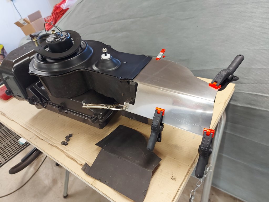

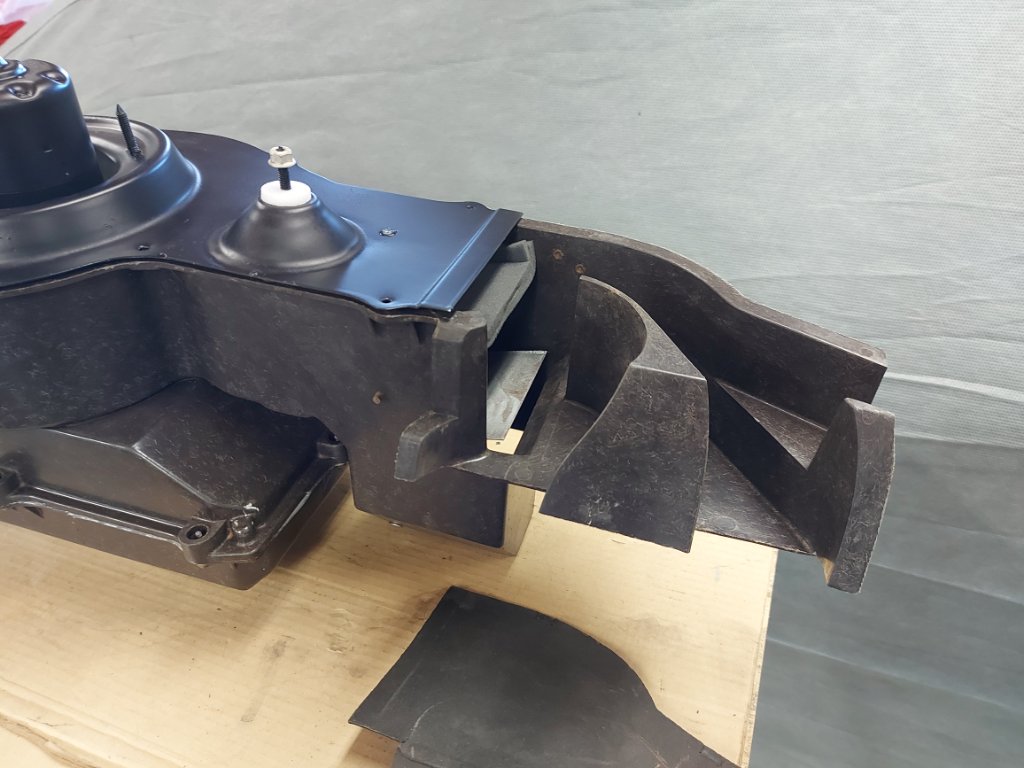

Post by 71Beeper » Sat Jan 23, 2021 5:14 pm
Today I did a little upgrading regarding the heater box.
Here's the small carboard piece that came from the factory.
Jan 23 (3).jpg (84.36 KiB) Viewed 41283 times
Its purpose is to complete the ducting that goes down to the feet area on the passenger side.
Jan 23 (2).jpg (103.61 KiB) Viewed 41283 times

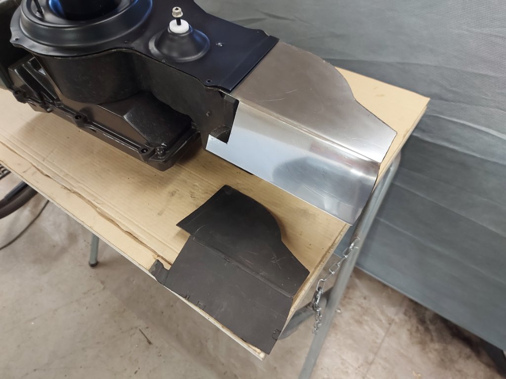

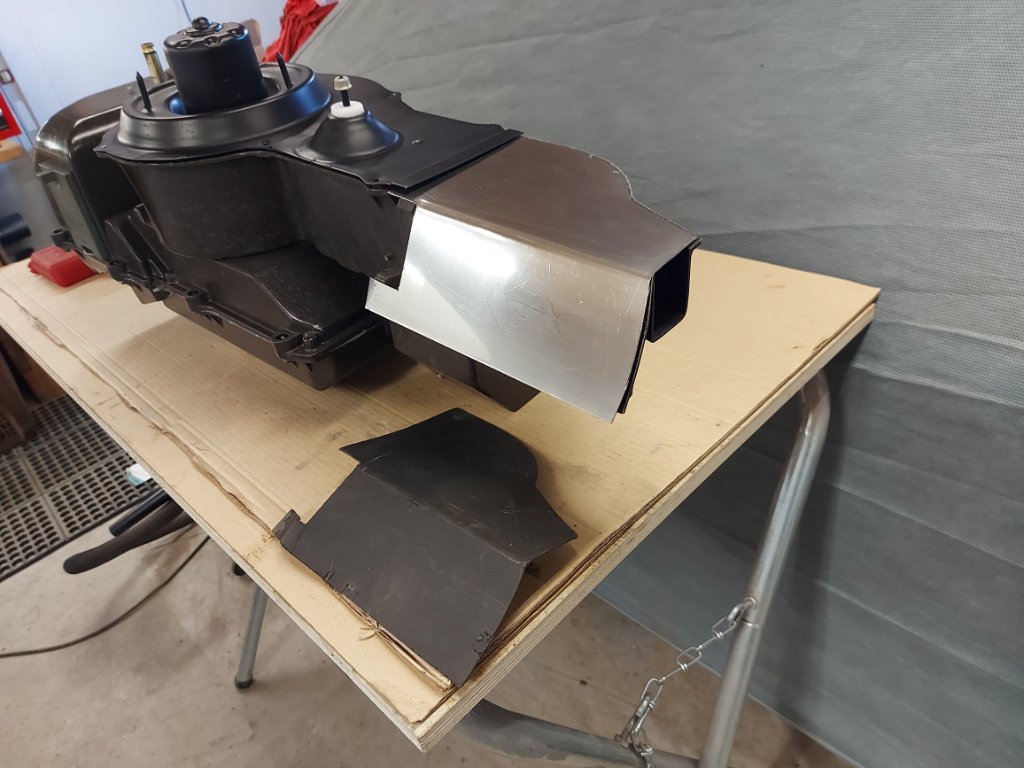

I did get a new one in the kit from Detroit Musclecar technologies, but decided I could make a better one.
So I got a thin piece of stainless steel and made a duplicate up.
Jan 23 (5).jpg (92.78 KiB) Viewed 41283 times
Jan 23 (6).jpg (109.53 KiB) Viewed 41283 times
Put a little sealer on the box and clip the new cover in place.
Jan 23 (7).jpg (111.55 KiB) Viewed 41283 times
