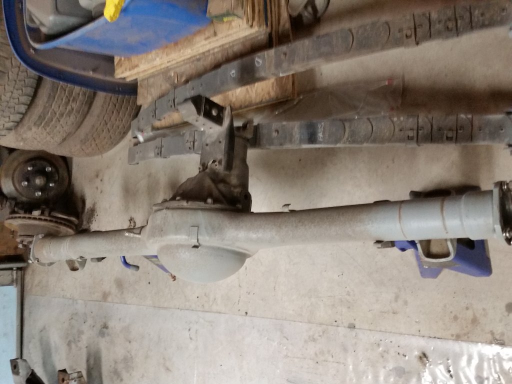

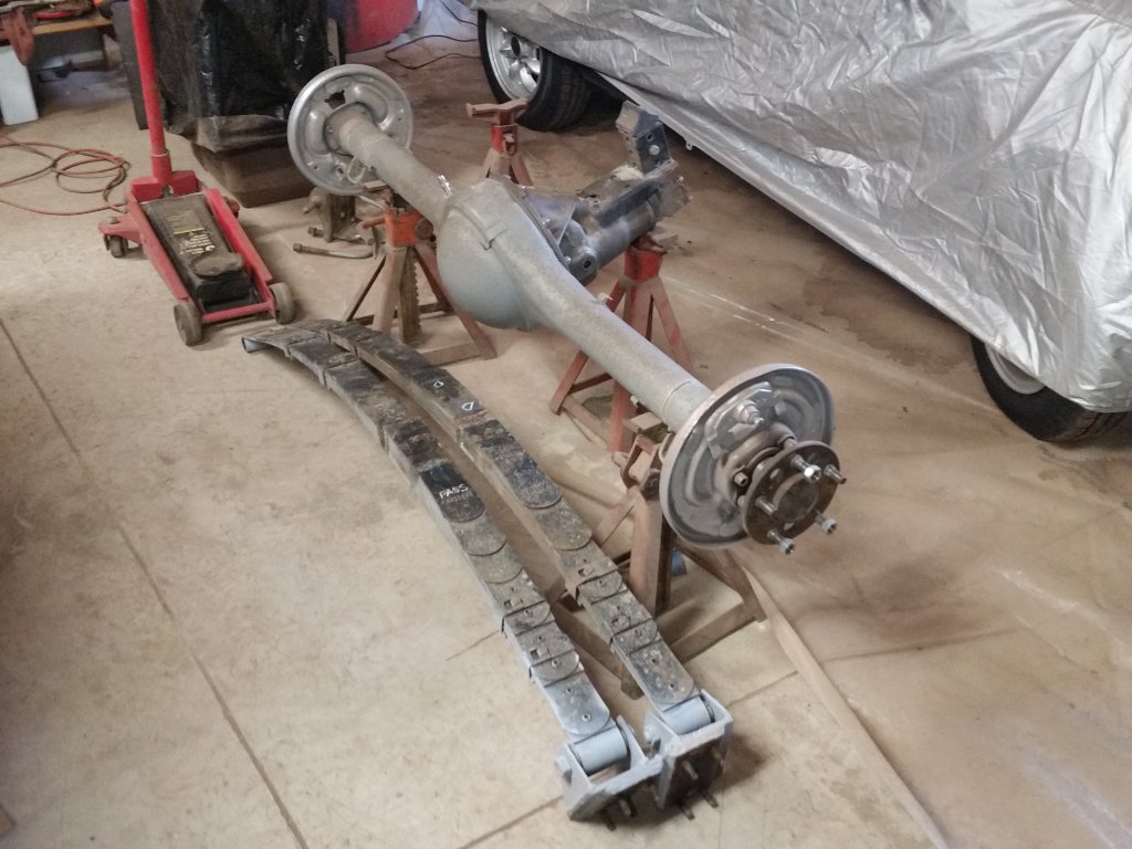

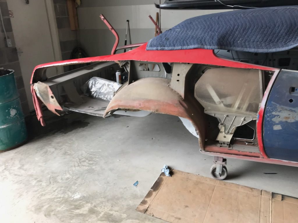

More progress today.

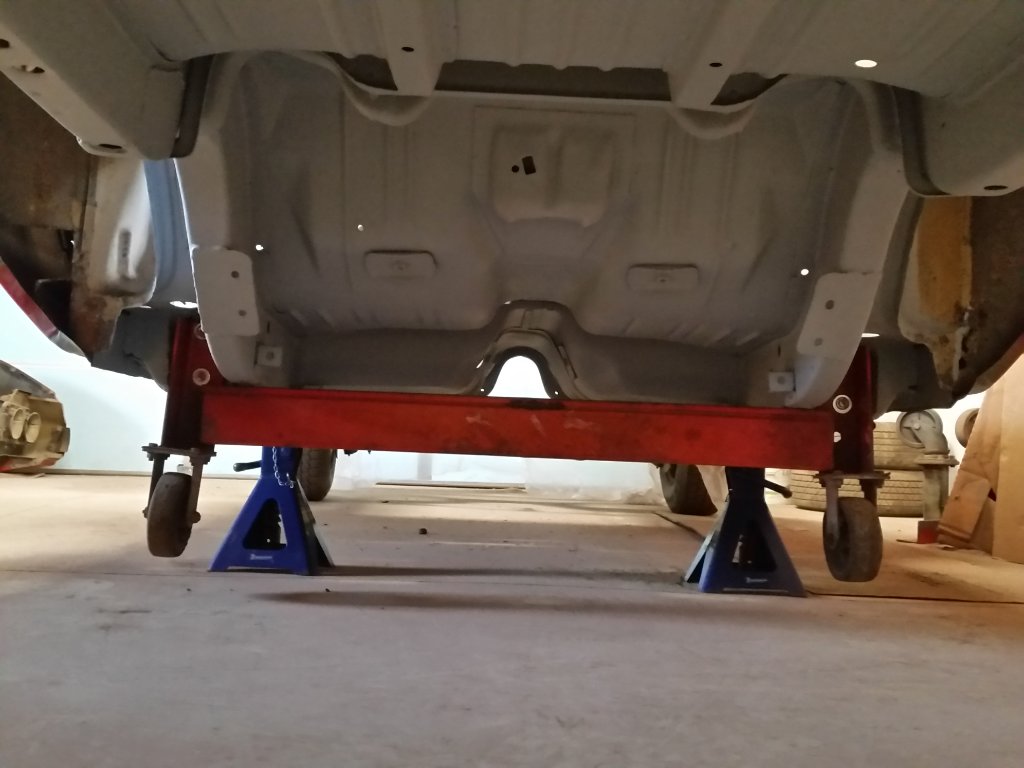

I got the rear end out and installed the dolly wheels.
March 24 (4).jpg (132.53 KiB) Viewed 28266 times
March 24 (1).jpg (127.07 KiB) Viewed 28266 times
March 24 (9).jpg (73.27 KiB) Viewed 28266 times
March 24 (13).jpg (79.86 KiB) Viewed 28266 times

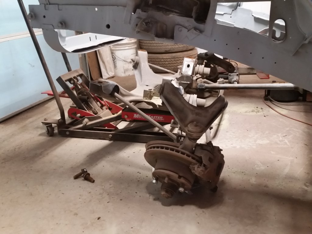

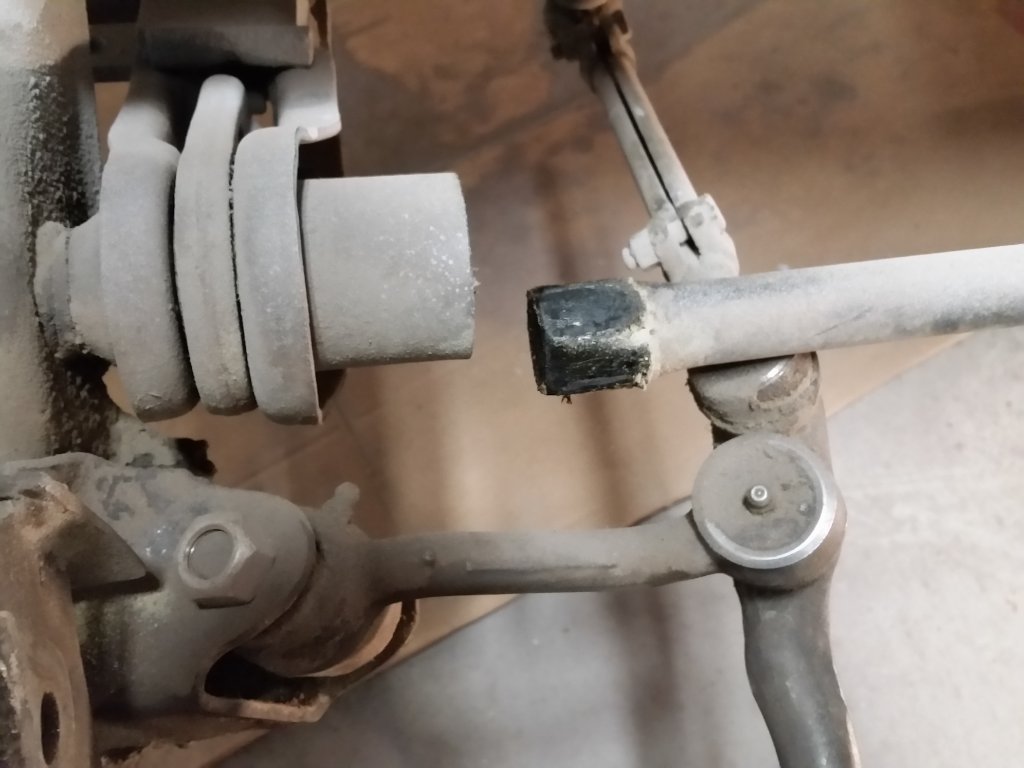

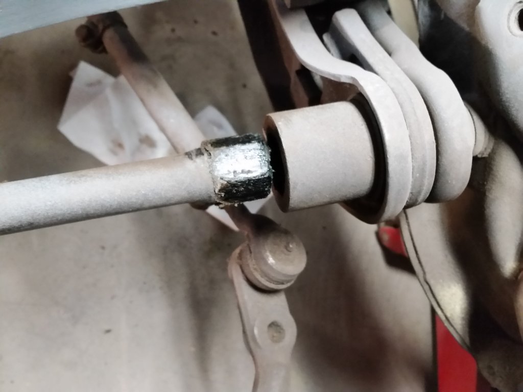

Yesterday, I started on the front suspension. the torsion bars came out easier than I thought.
March 30 (6).jpg (75.67 KiB) Viewed 28252 times
March 30 (7).jpg (79.14 KiB) Viewed 28252 times

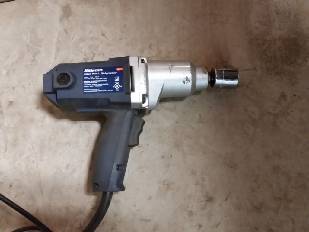

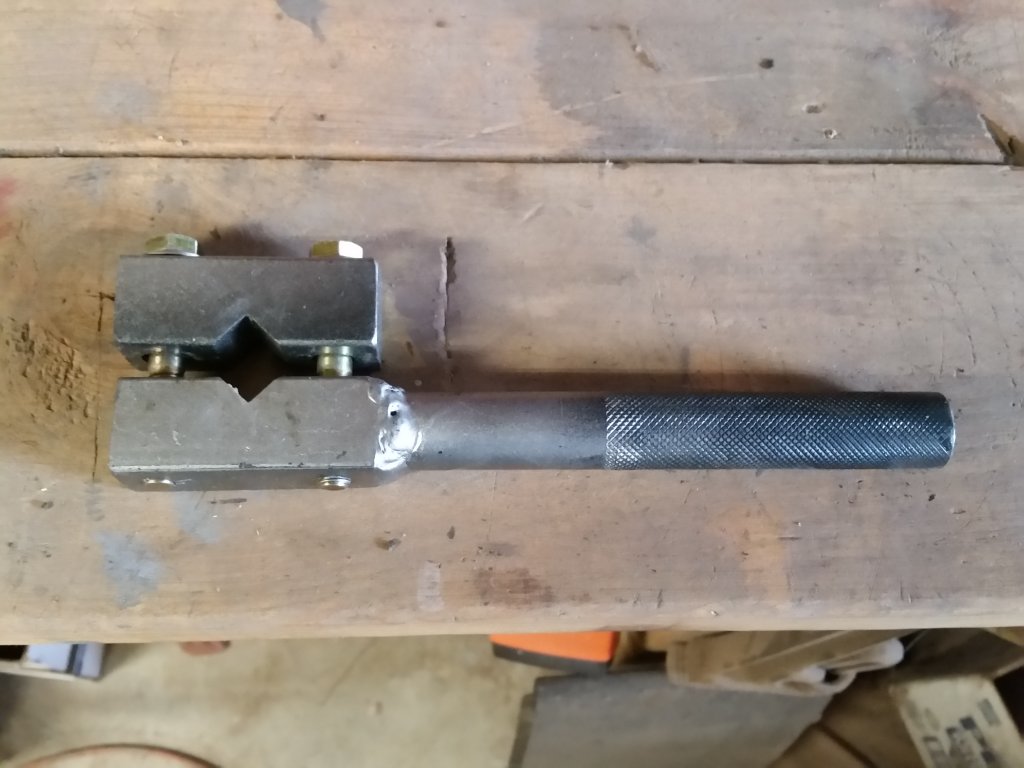

Having the proper tool certainly helped.
Then, the 4 bolts holding the front K-member were next. I had to use the big bertha to crack them free.
March 30 (12).jpg (73.21 KiB) Viewed 28252 times
The result.......it's out!
March 30 (14).jpg (107.77 KiB) Viewed 28252 times

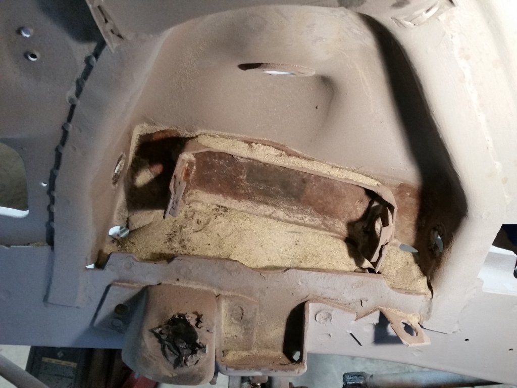

Now I know where some of the glass bead ended up........ :shock:
March 30 (10).jpg (93.66 KiB) Viewed 28252 times

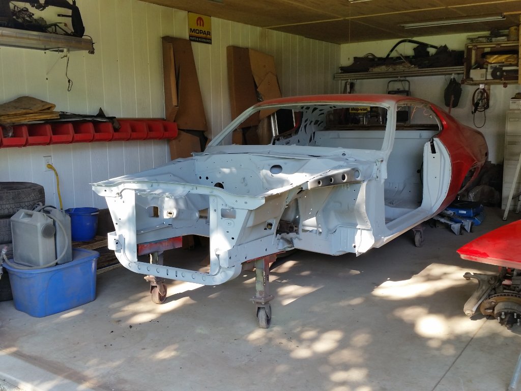

Post by 71Beeper » Sat Sep 21, 2019 9:11 pm
So......since the end of March I've been on the hunt for a reputable body and paint shop.
I finally found one.

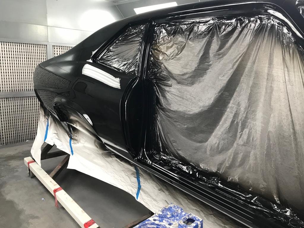

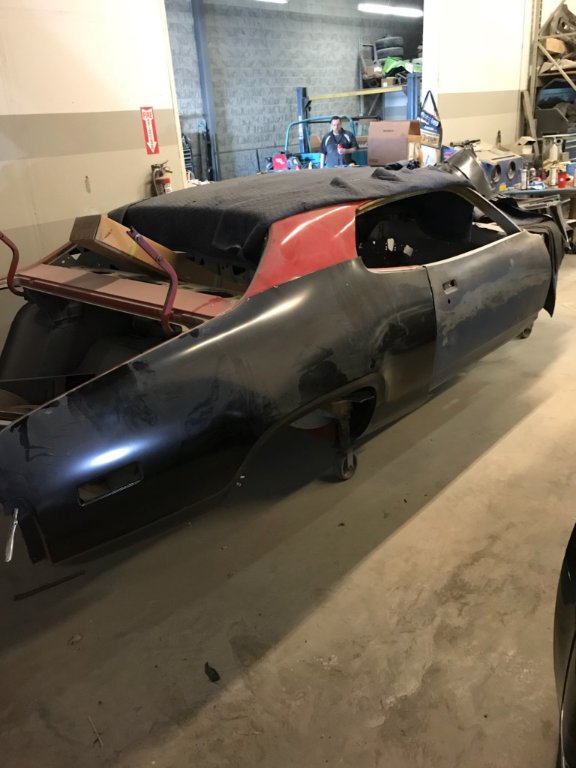

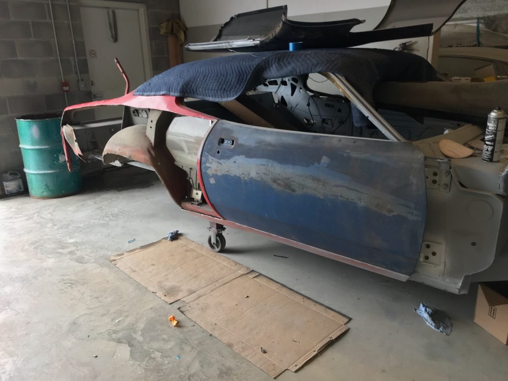

A friend of a friend had his Nova painted there. Here's a picture of it in the spray booth.
So I contacted this friend and had him bring the body guy to my house to look at the Runner.
He came and said yes he will do it - we agreed on a price and on Aug 26th the journey began.

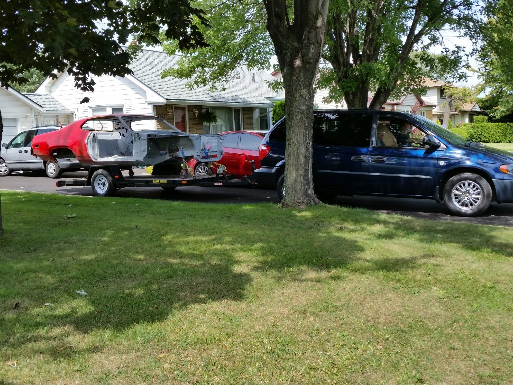

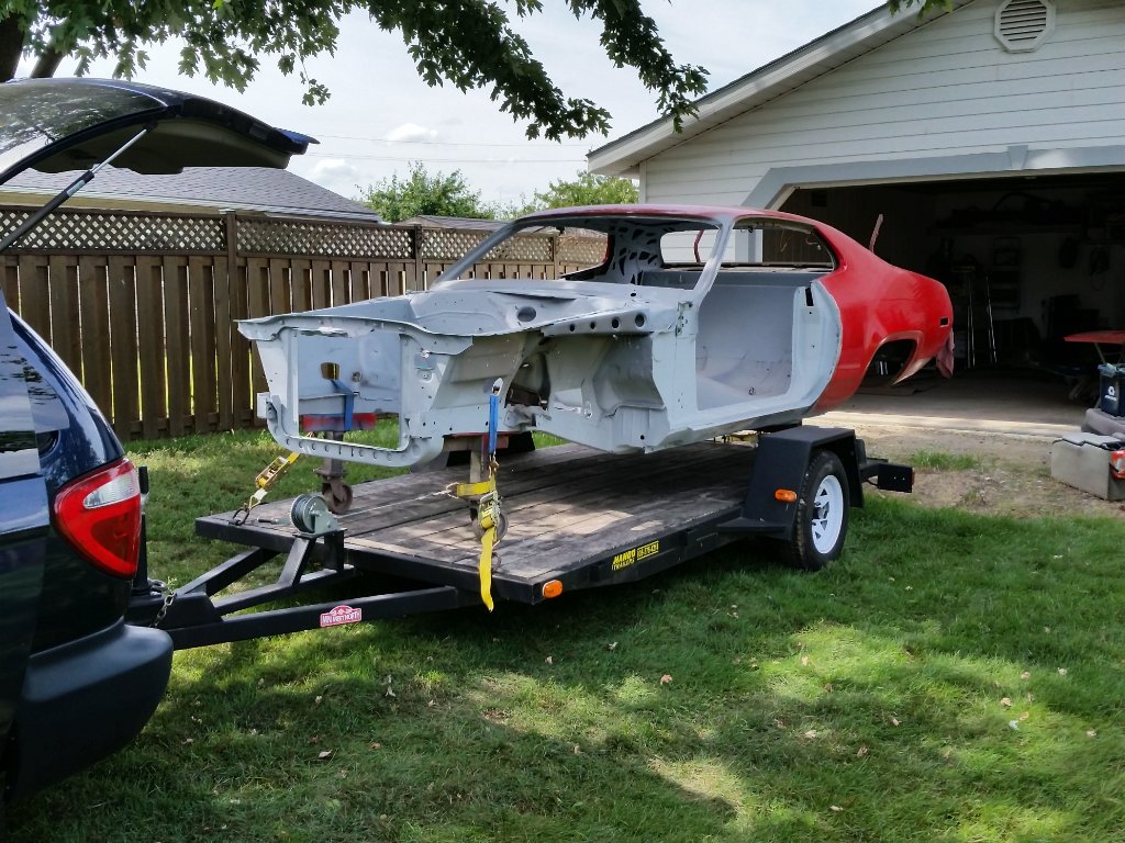

Here it is getting ready to load up on a trailer.
Aug 26 (13).jpg (127.09 KiB) Viewed 27866 times
I used a small trailer that I have for my wife's Mini Cooper.
Aug 26 (17).jpg (204.79 KiB) Viewed 27866 times
With the car being on dolly wheels, there was no issues getting it on the trailer.
Plus it is lighter than the Mini at this stage, so trailering it to the body shop was no issue.

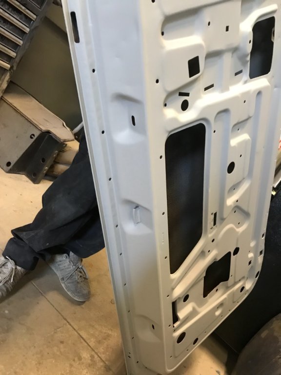

Posts: 746
Post by 71Beeper » Sat Sep 21, 2019 9:20 pm
I had taken the doors down to the shop separately as they would not fit in the Caravan with all the other pieces in it.
The shop started on the doors.

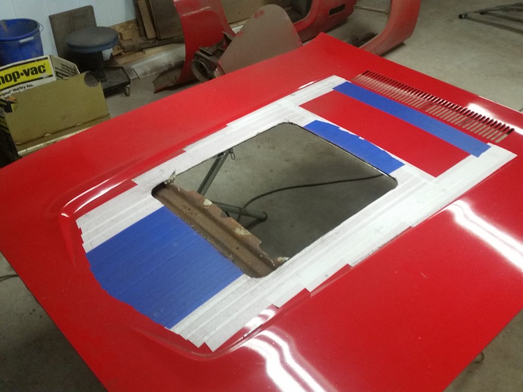

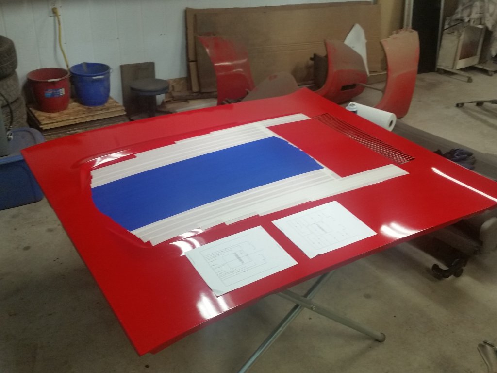

So in the meantime I have to get started on the hood.
The underside needs blasting & the hole for the air grabber needs doing.

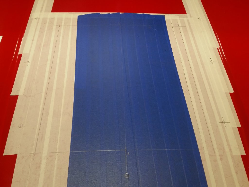

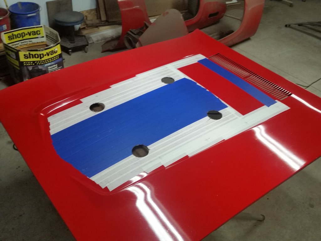

So,,, lets get started on the air grabber hole.
Aug 26 (35).jpg (80.65 KiB) Viewed 27866 times
Put on some masking tape.
Aug 26 (33).jpg (91.29 KiB) Viewed 27866 times
Carefully lay out the locations for the fasteners.
Aug 26 (4).jpg (121.67 KiB) Viewed 27866 times
Posts: 746
Post by 71Beeper » Sat Sep 21, 2019 9:25 pm
Hopefully all of my hole locations are correct.
Next fire up the hole saw cutter.
Then cut out the center.
Drill the mounting holes and that part of the job is done.

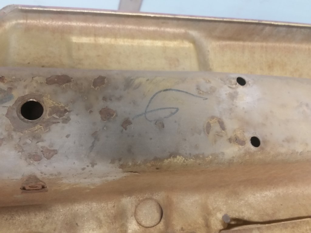

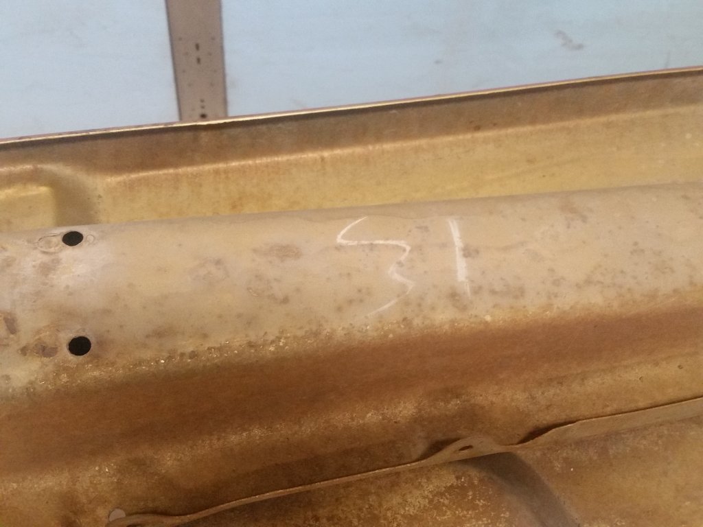

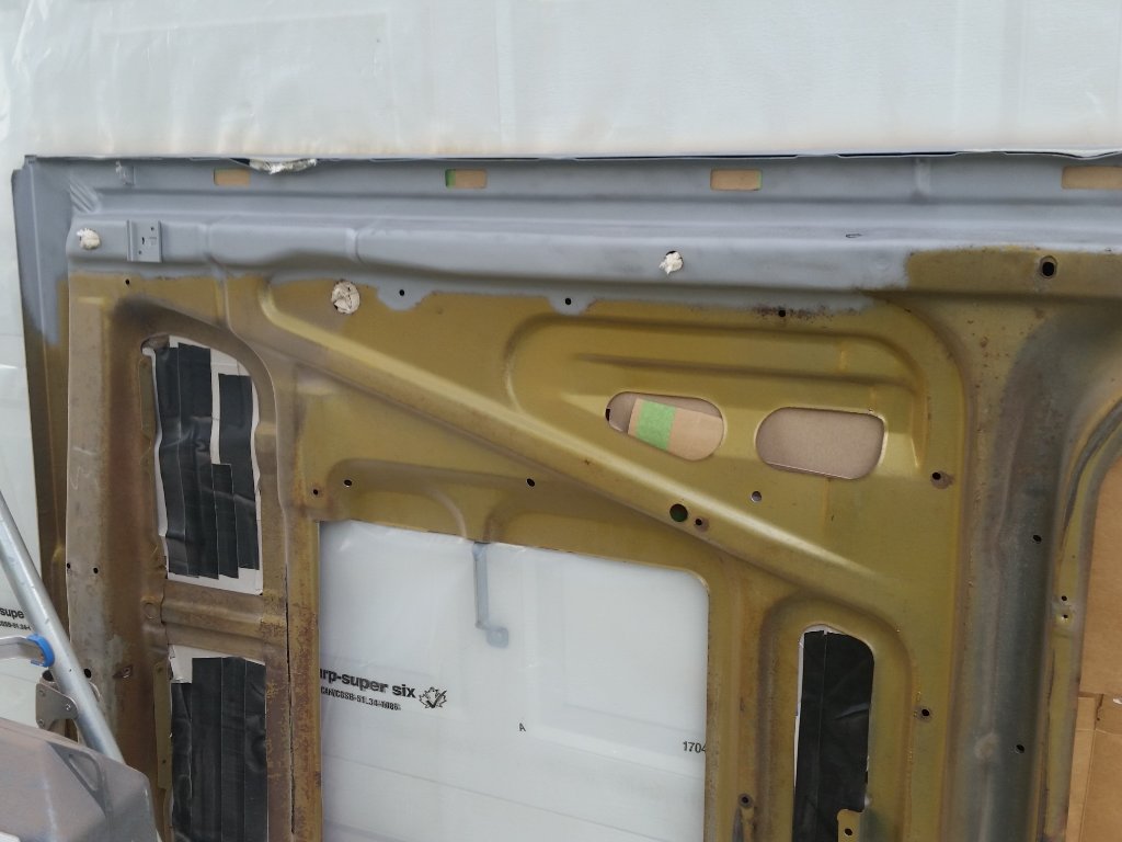

Next, it's time to clean up the underside. First I took some pictures of some factory markings that were still there.
Sept 14 (2).jpg (91.21 KiB) Viewed 27866 times
Sept 14 (1).jpg (75.6 KiB) Viewed 27866 times

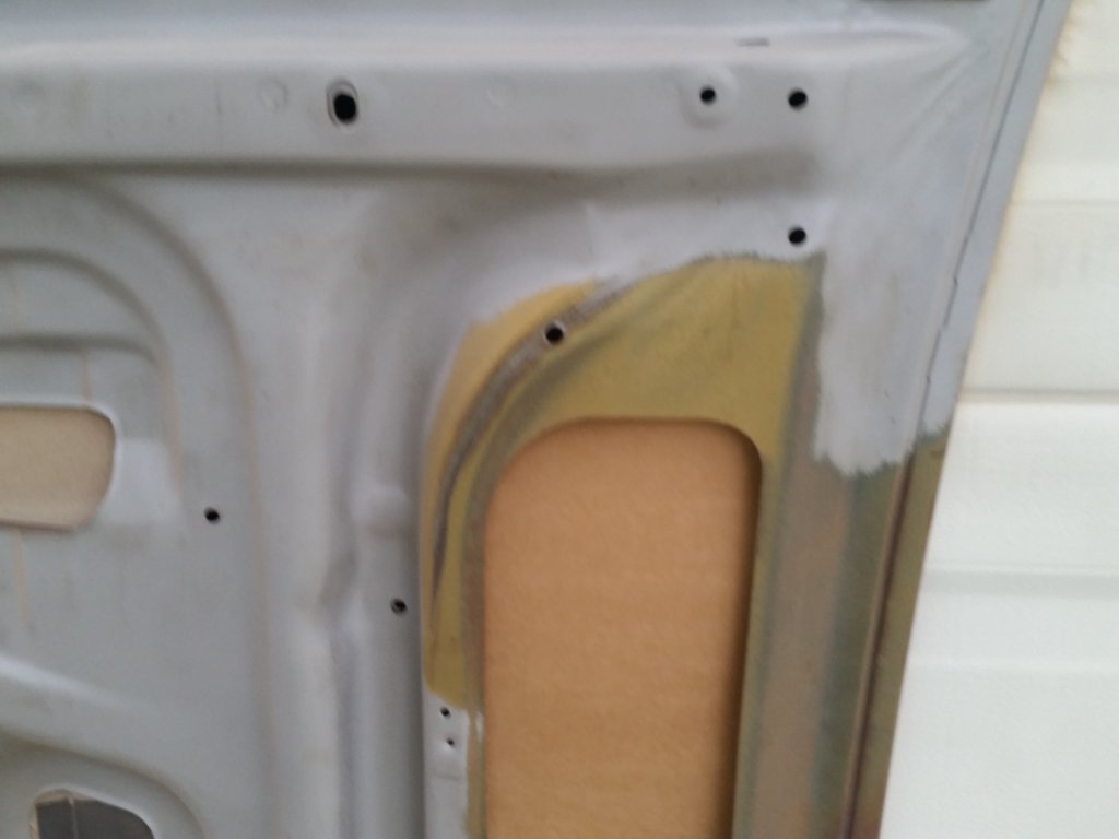

Here's the underside before blasting.
Sept 15 (2).jpg (113.89 KiB) Viewed 27866 times

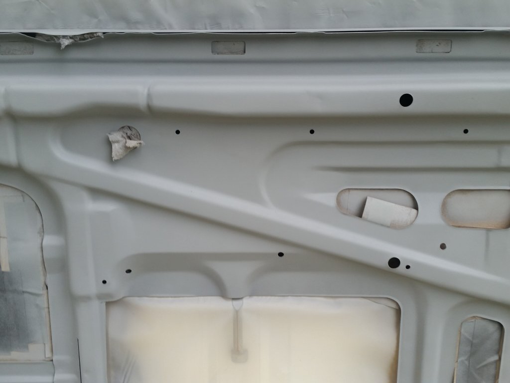

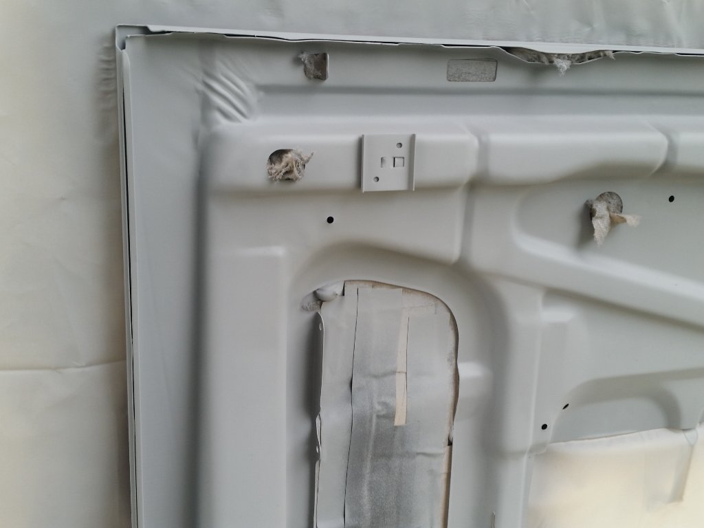

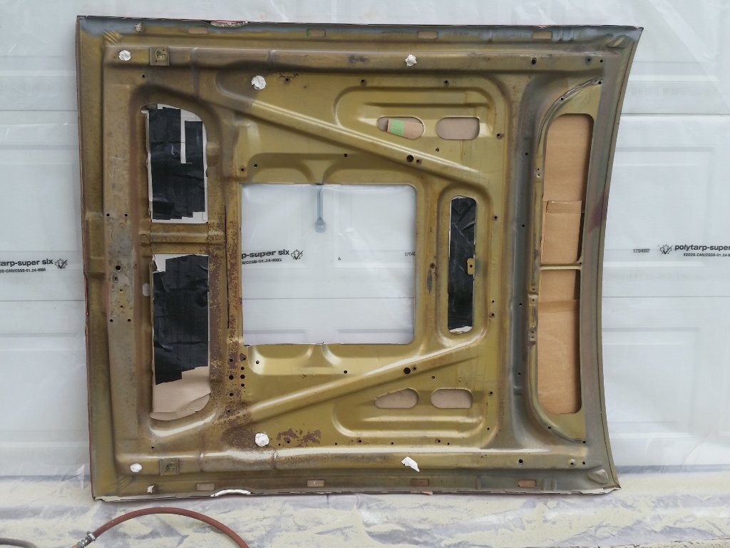

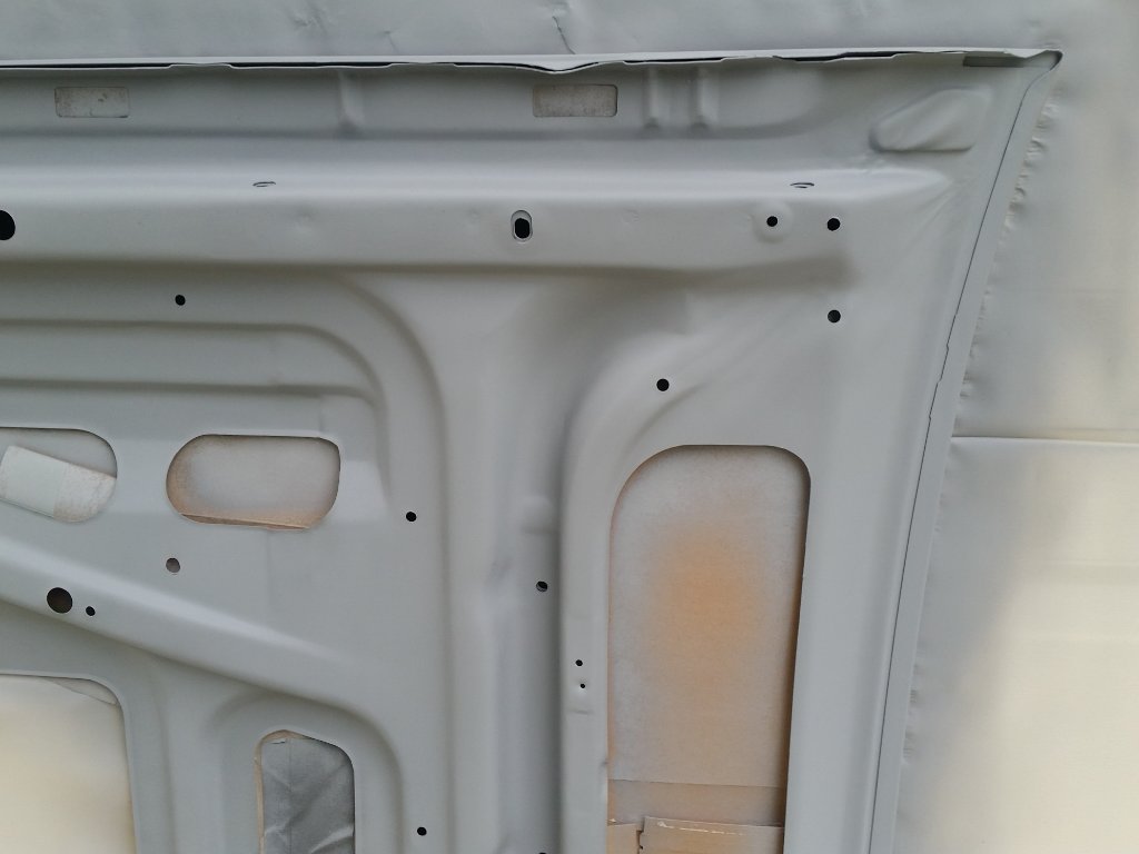

Time to blast.
BTW I did the blasting outside of my garage with the hood up against the big garage door.
I placed a 6mil vapour barrier plastic sheet between the door and hood.
Sept 15 (3).jpg (85.19 KiB) Viewed 27865 times
Sept 15 (5).jpg (49.25 KiB) Viewed 27865 times
I only did half the underside on that day as I didn't realize how long it actually took.
Then sprayed some primer.
Sept 15 (9).jpg (60.5 KiB) Viewed 27865 times
Sept 15 (10).jpg (57.53 KiB) Viewed 27865 times
Sept 15 (11).jpg (57.93 KiB) Viewed 27865 times

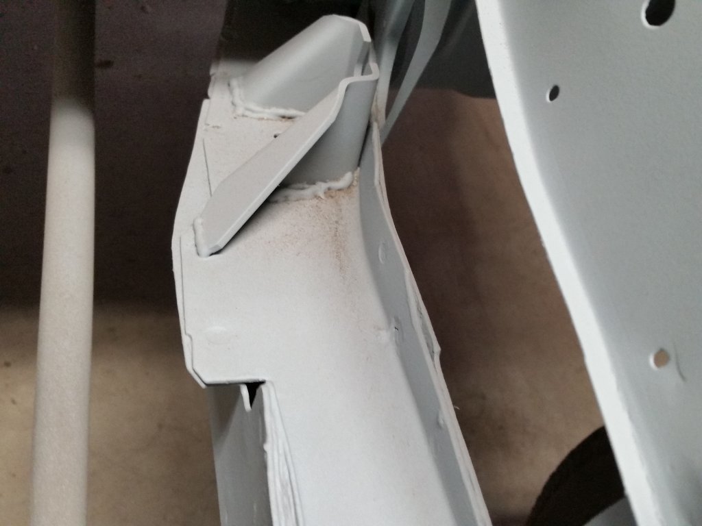

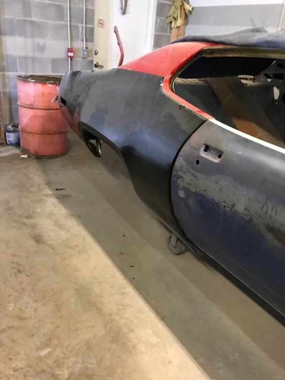

Post by 71Beeper » Tue Oct 01, 2019 7:53 pm
Some more progress from the body shop.....

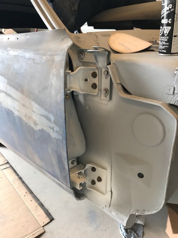

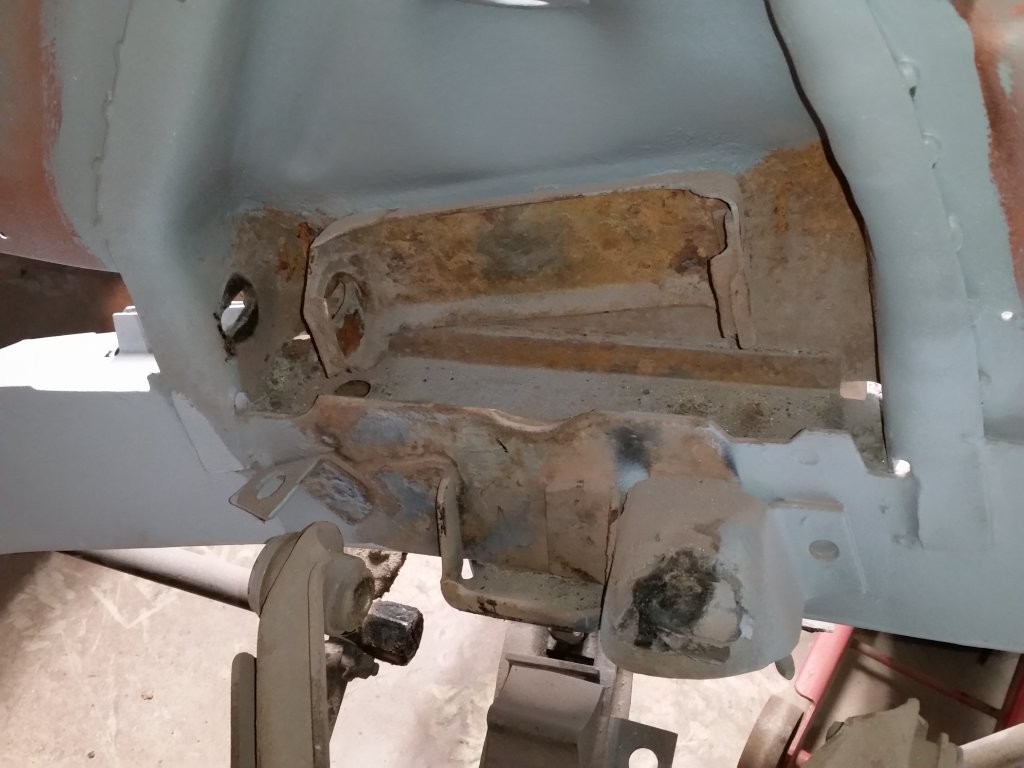

The old quarters are gone, time for the new AMD ones to go on.
Sept 29 (3).jpg (104.03 KiB) Viewed 27808 times
Sept 29 (4).jpg (106.63 KiB) Viewed 27808 times
Sept 29 (5).jpg (81.48 KiB) Viewed 27808 times
And here's a shot of the AMD door hinges in place. :D
Sept 29 (6).jpg (64.84 KiB) Viewed 27808 times

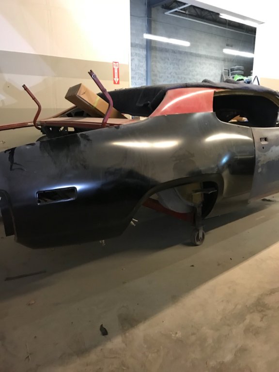

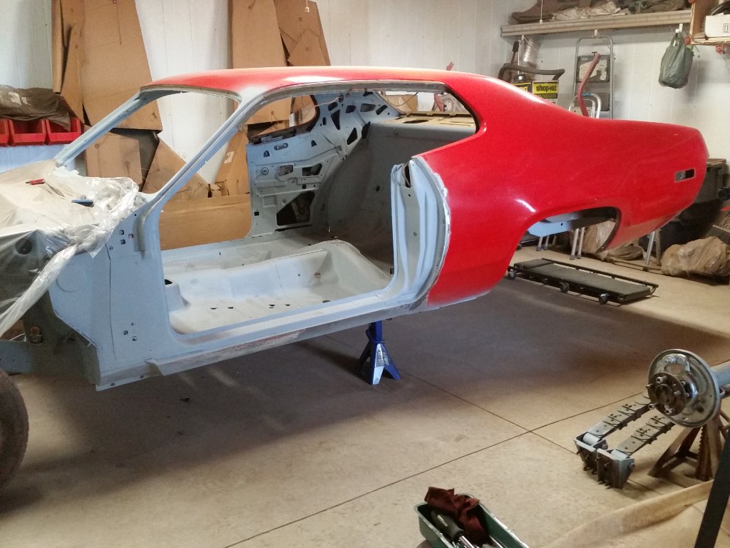

Here's the passenger side quarter being fit checked.
I'm going to be heading to the body shop on Nov. 11th to see the progress in person.
I haven't seen it since I dropped it off back at the end of August.

Here's the pics.
Oct 19 (2).jpg (54.74 KiB) Viewed 27668 times
Oct 19 (3).jpg (47.83 KiB) Viewed 27668 times
Oct 19 (4).jpg (62.8 KiB) Viewed 27668 times

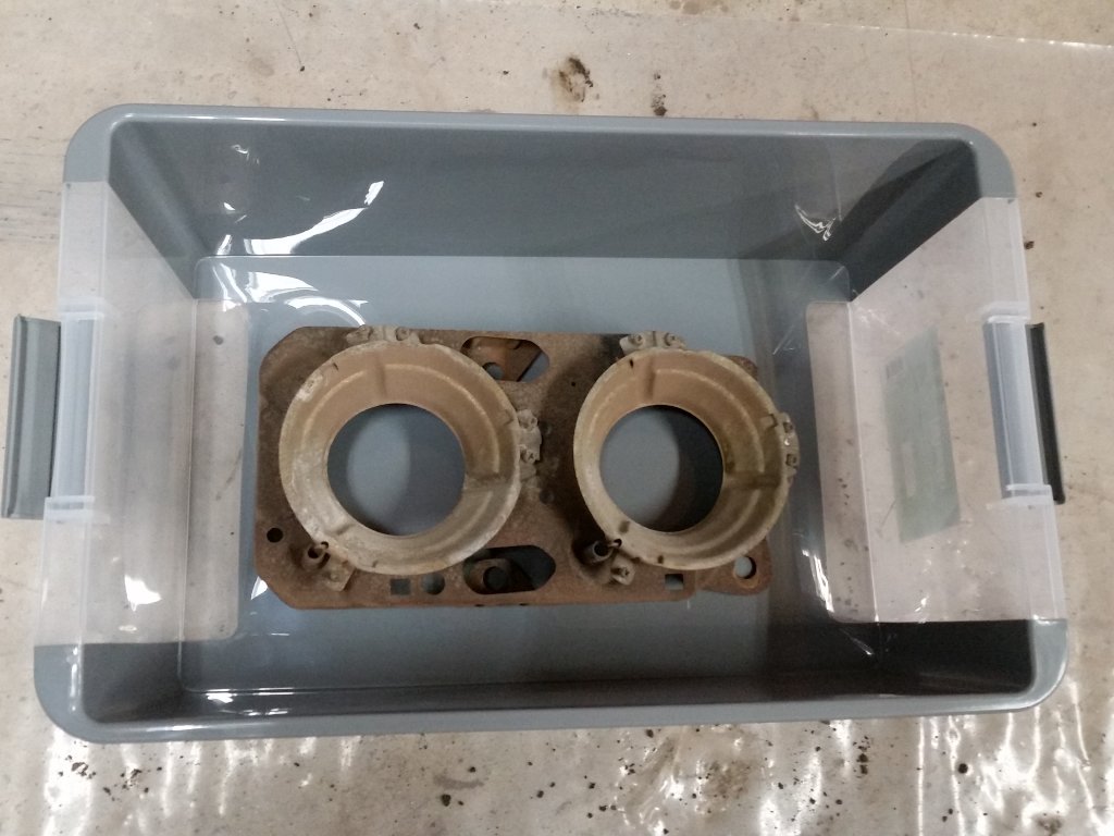

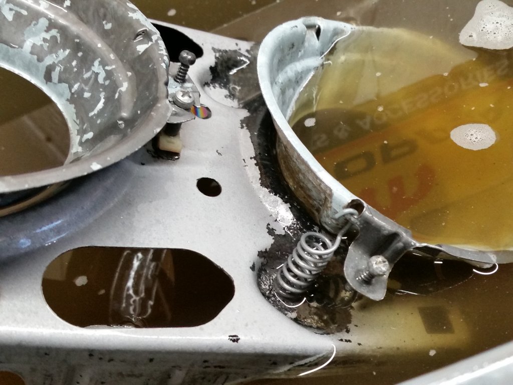

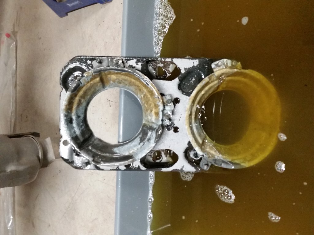

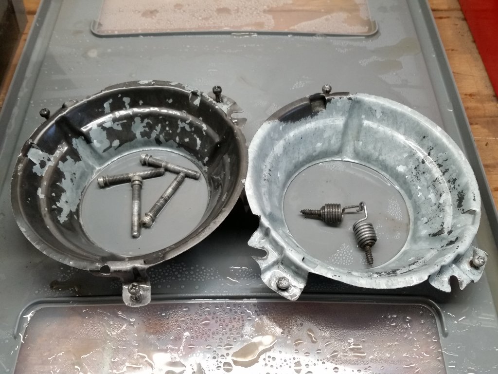

Time to do the headlight buckets.

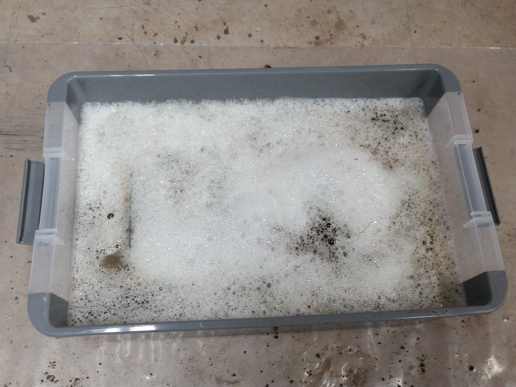

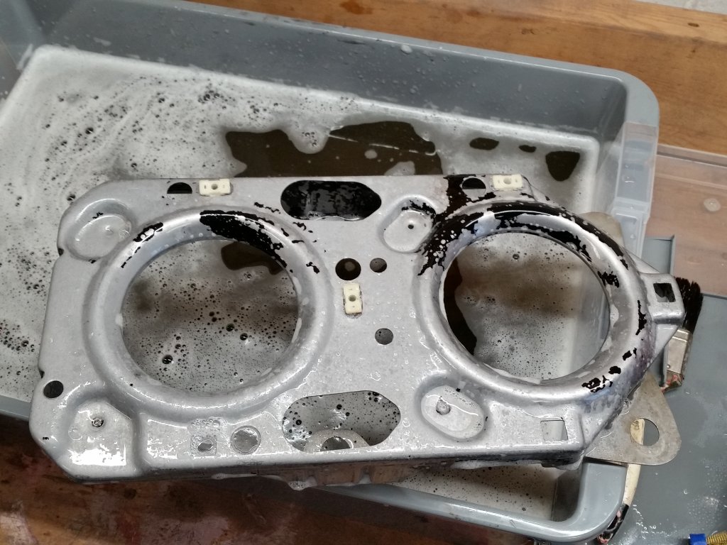

I didn't want to sandblast them - I decided to buy some Evapor-rust.
And a container to put it in.
Fill up the container and let it sit for a week or so.
Posts: 746
Post by 71Beeper » Sun Jan 26, 2020 11:38 am

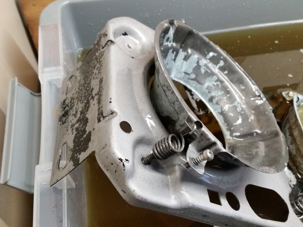

So the stuff is working pretty good!
Use a little scrub brush to help it along.
I took the assembly apart to make sure it gets all stripped.
I'll let it soak for another week.

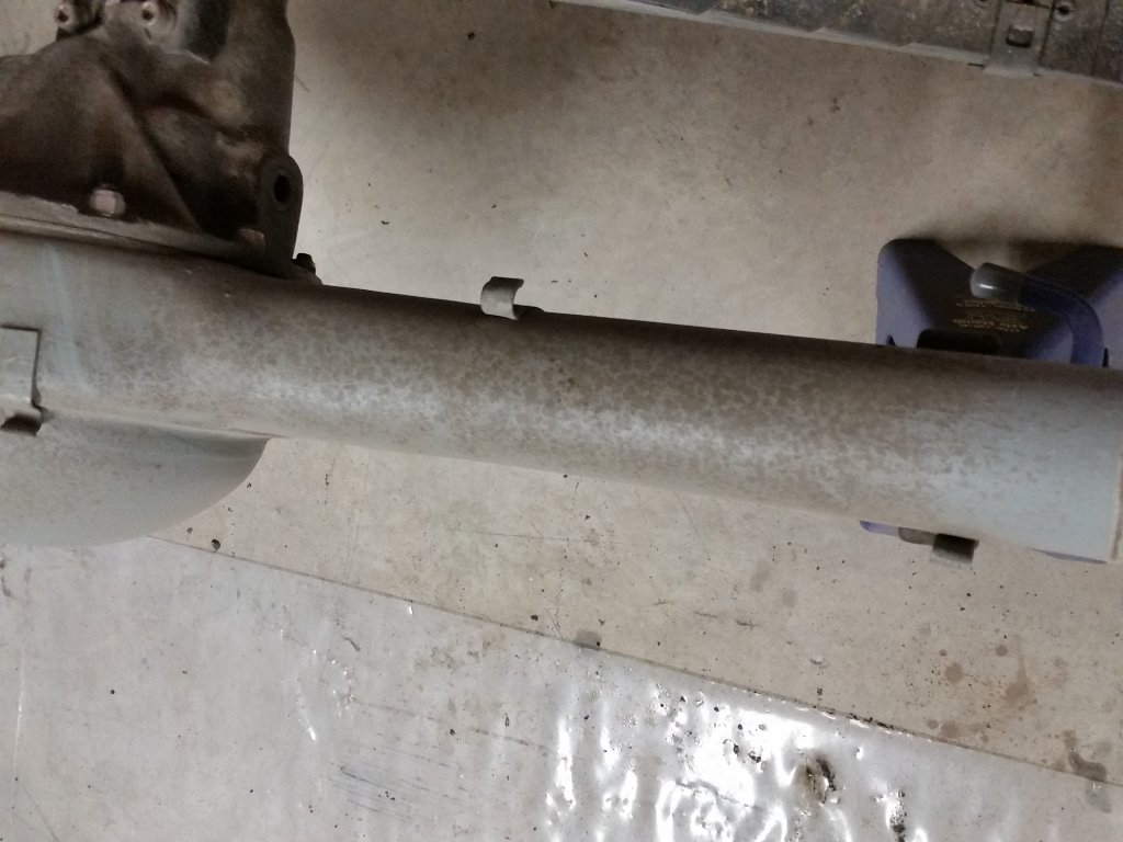

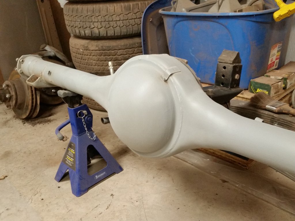

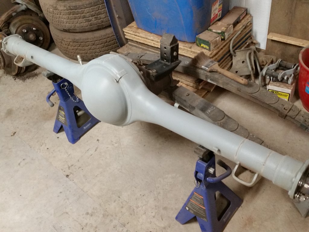

While waiting for the Evaporust to do it's thing I'll get started on cleaning up the rear end housing.
I had painted the rear end housing in the car some years ago. I used something similar to Rust bullet.
If you look back to page one here you will see the fresh paint on it.
Even tho I wrapped it with plastic while blasting the underside of the car it still managed to get under the plastic and onto the housing.
So with a coarse scotchbrite pad it cleaned up pretty good.
So the next step is to prep it for a coat of satin black.
