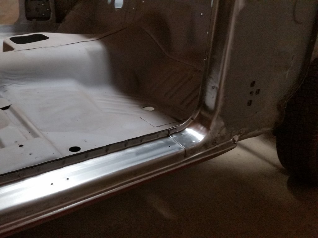

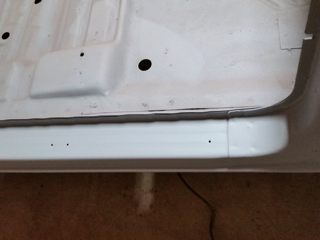

So, moving on I tackled the door sills next.
Passenger side first.....
Dec 22 (14).jpg (93.88 KiB) Viewed 58874 times
Dec 22 (13).jpg (66.72 KiB) Viewed 58874 times
Dec 22 (11).jpg (63.77 KiB) Viewed 58874 times
Then primered..
Dec 23 (3).jpg (76.38 KiB) Viewed 58874 times

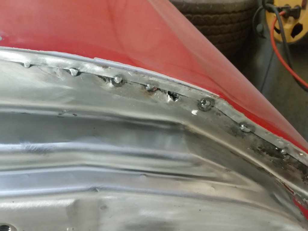

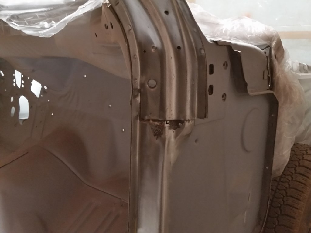

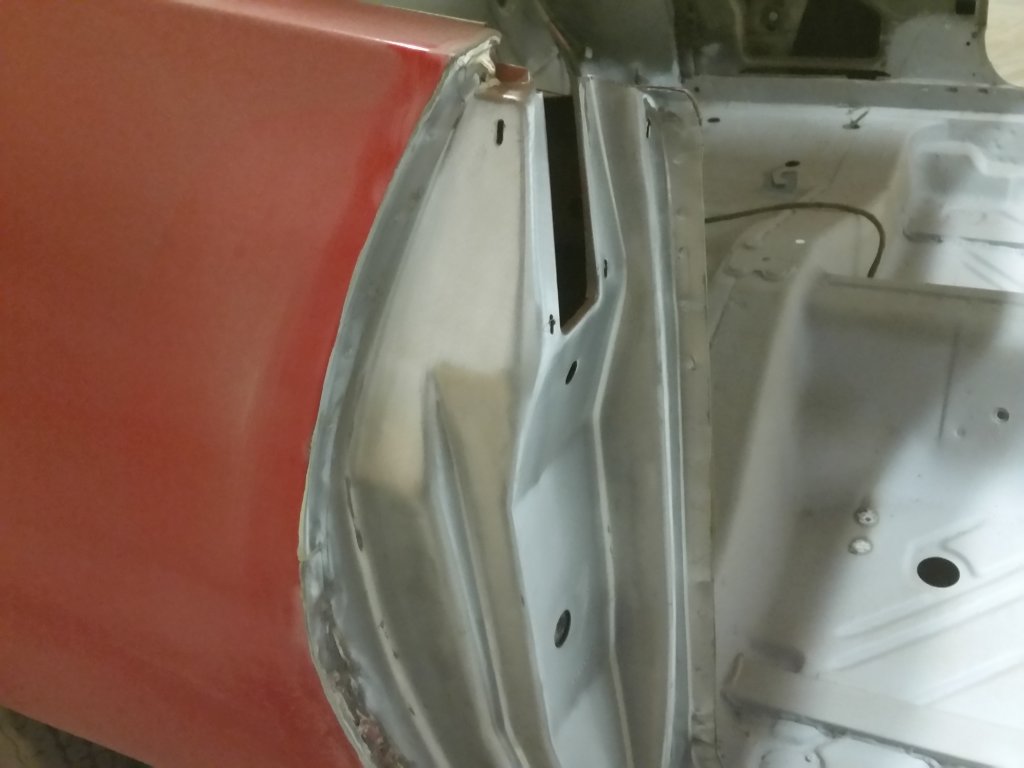

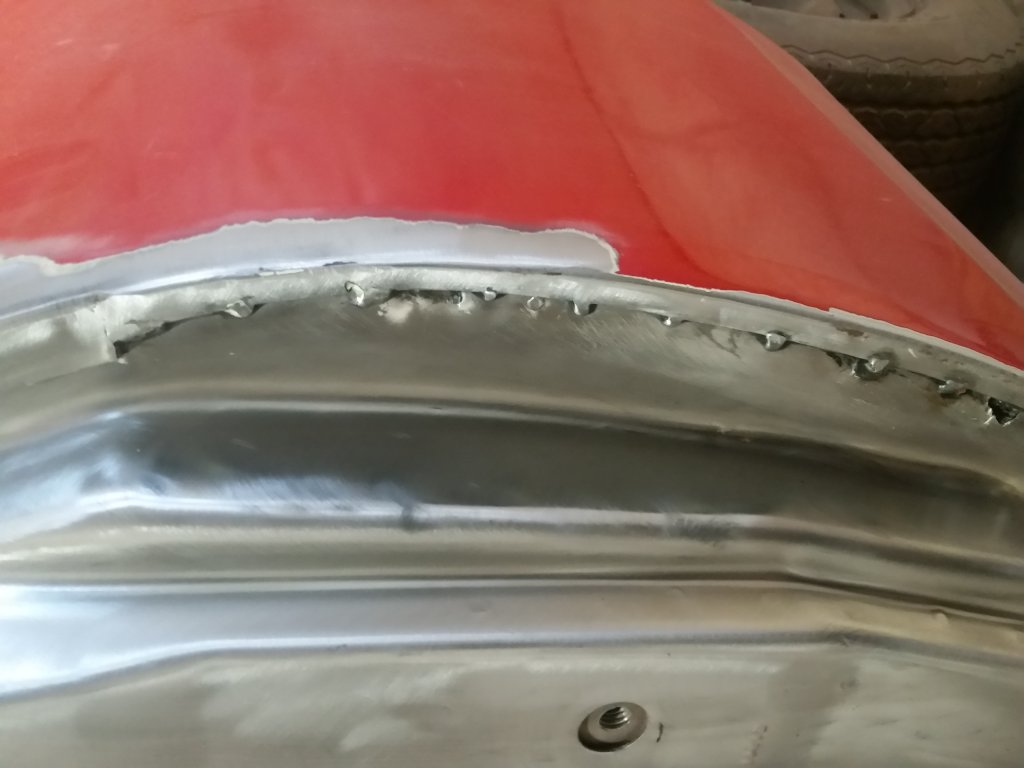

Next, the drivers side - I started cleaning up the area where the half quarter was attached at the front.
Dec 30 (9).jpg (75.17 KiB) Viewed 58874 times
Dec 30 (10).jpg (67.32 KiB) Viewed 58874 times
Looks like quite a bit of work involved to make that disappear.
So before I jump in to do that I think I will ask the guy who will be doing the body and paint on how to proceed.

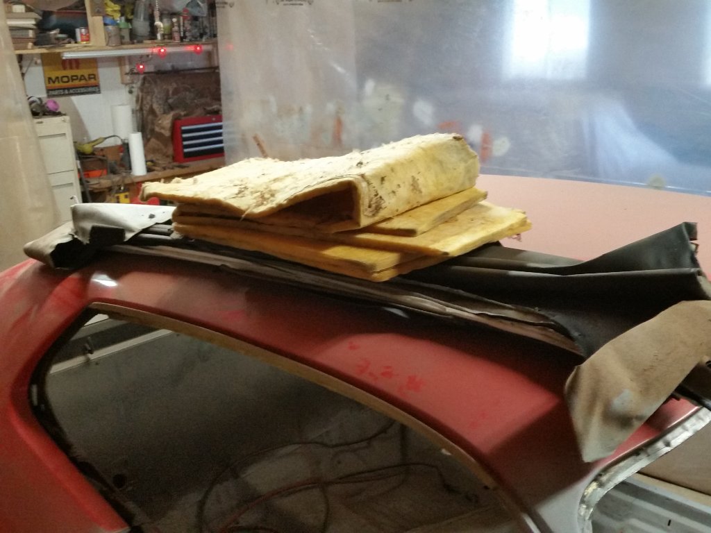

In the meantime.......no matter how much I tried to protect the headliner when doing the blasting, the crap still got into it.
So, out it came....
Along with the insulation pieces that had glass bead in it.

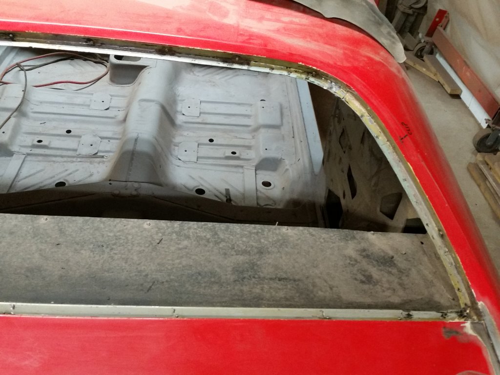

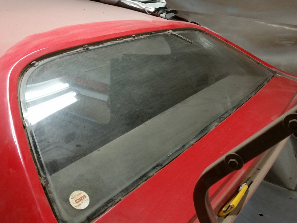

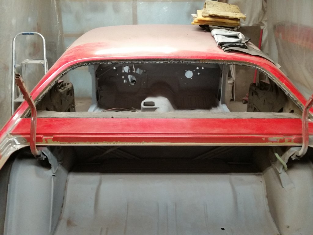

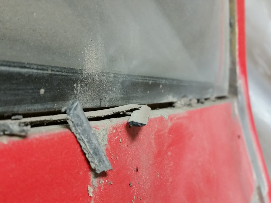

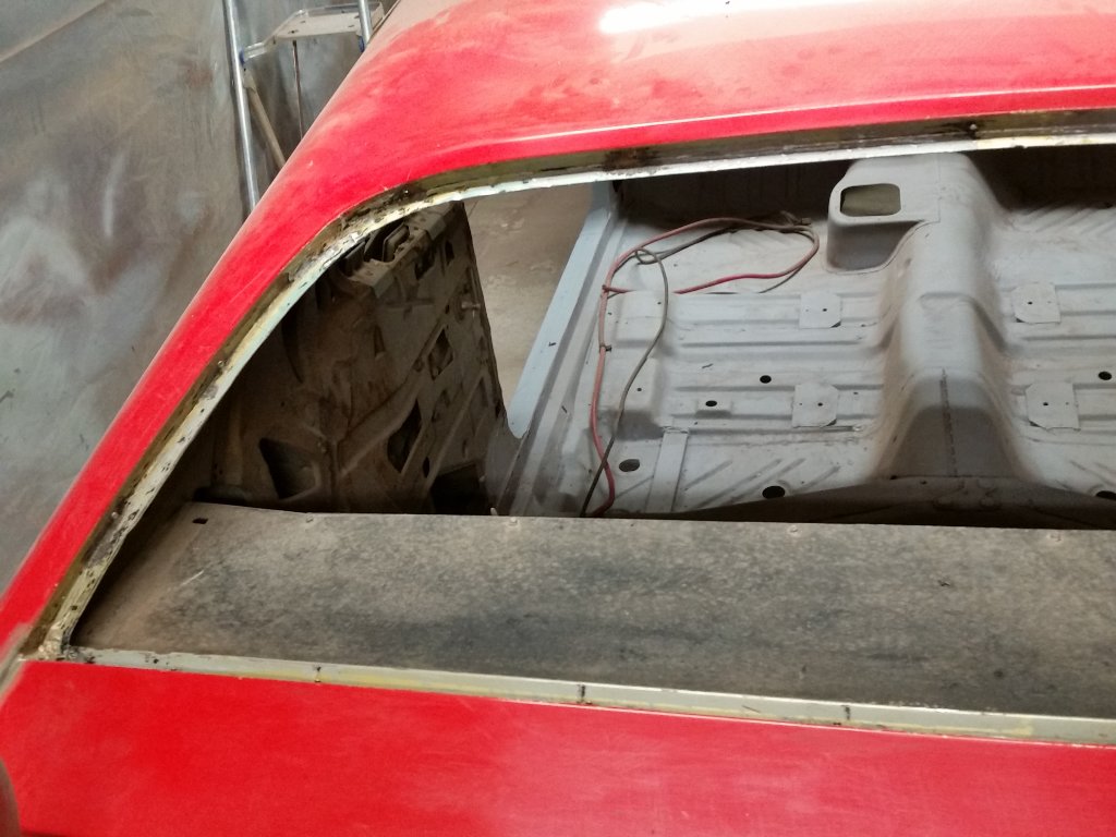

The next thing - remove the rear glass.
Now you see it....
Post by 71Beeper » Sun Jan 13, 2019 8:23 pm
Now you don't.....
Good thing I did take it out as 48 years of original buytle sealer wasn't sealing very well.
But the channel was pretty clean...

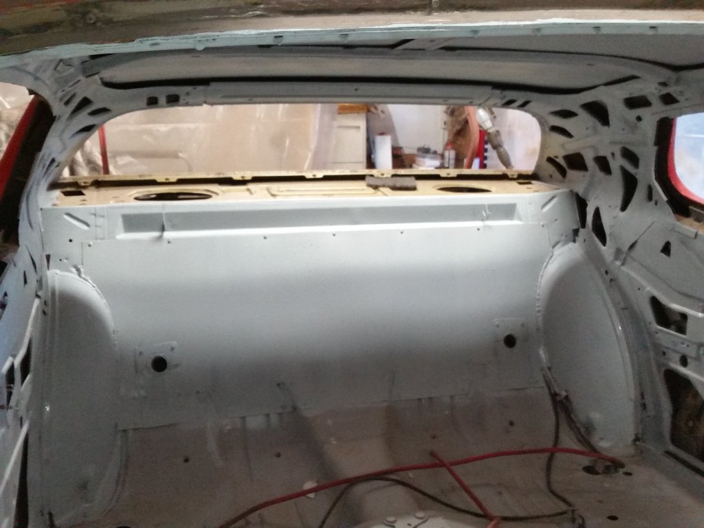

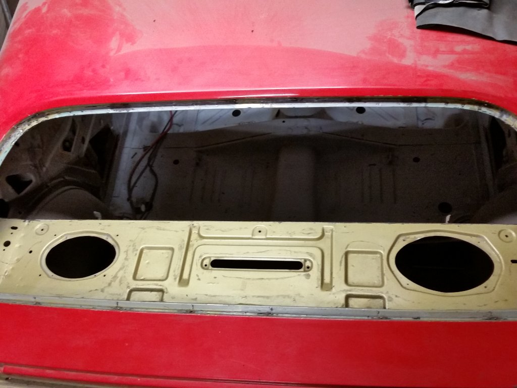

Finally with the rear glass being out I was able to remove the steel panel that was on top of the rear parcel shelf.
When this car was a drag car & had a trunk mounted battery, per safety rules the trunk are has to be isolated from the interior of the car so that panel was put there. another panel was installed between where the back goes and rear seat X brace. I'm going to leave it there, as it be a good area to place sound deadner on before the rear seat is installed.
Here is the rear parcel shelf.

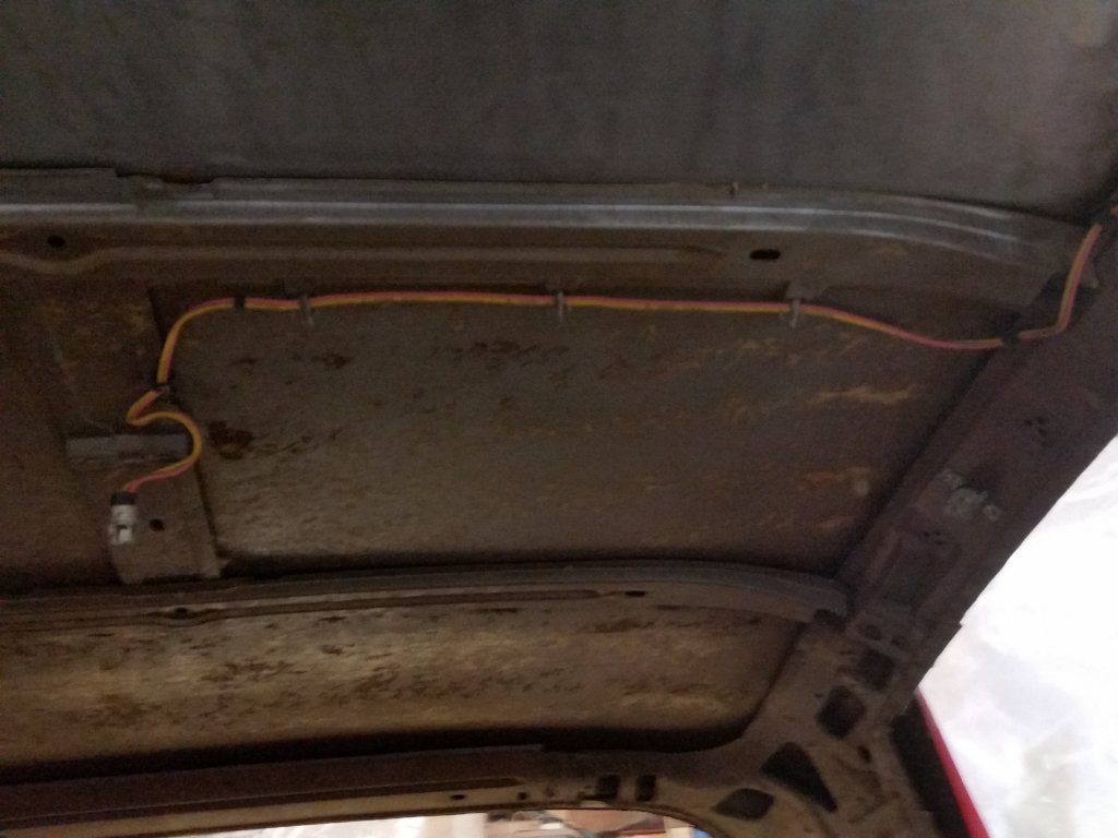

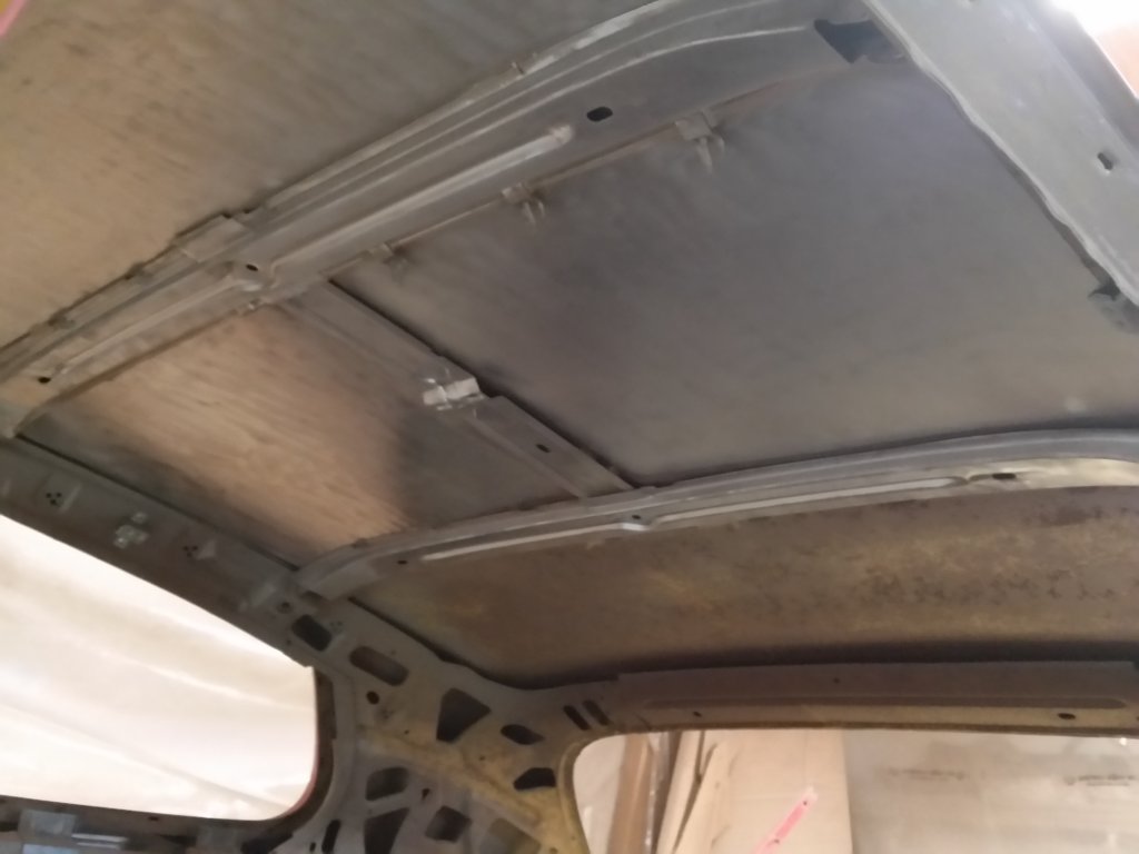

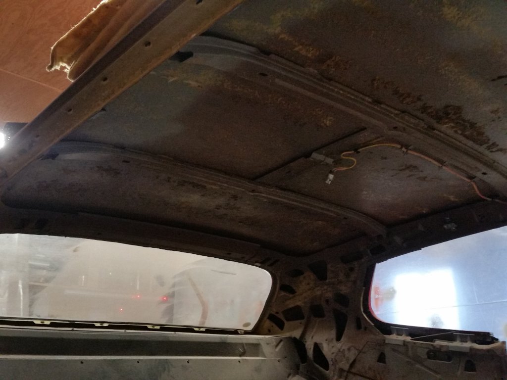

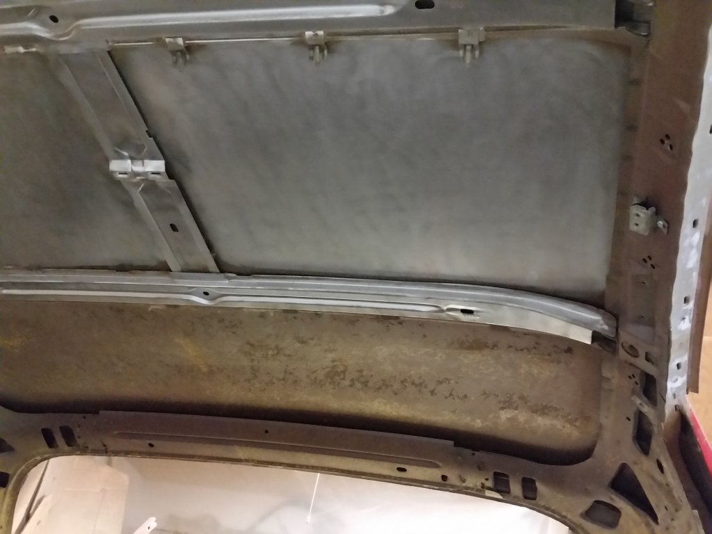

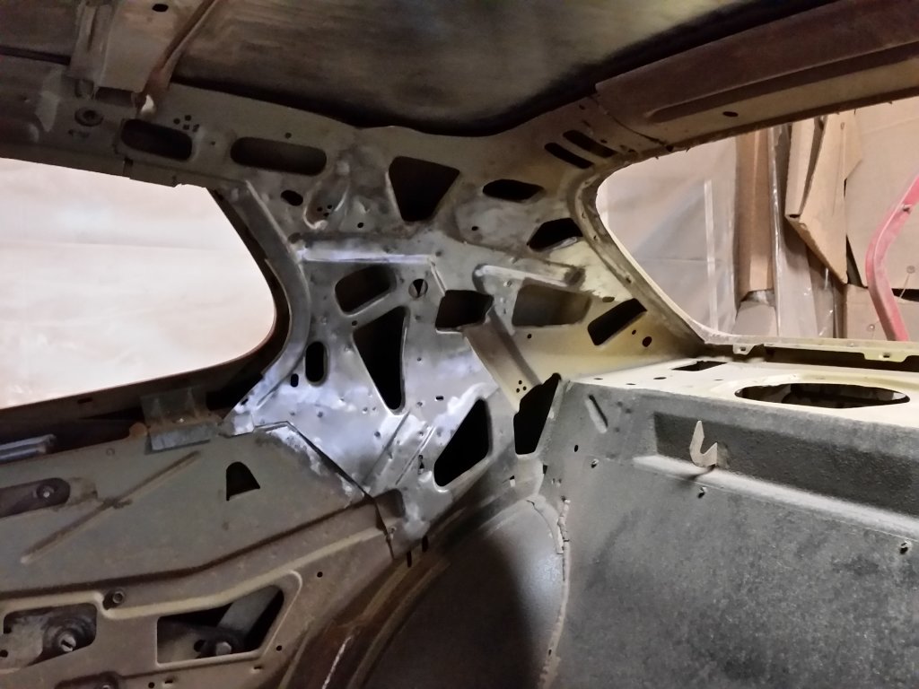

I started stripping the underside of the roof.
Here's the before shot.
And now some progress shots.
I just have the rear-most panel left to do. That will be for next weekends work.
Post by rr6pak » Sun Feb 03, 2019 10:59 pm

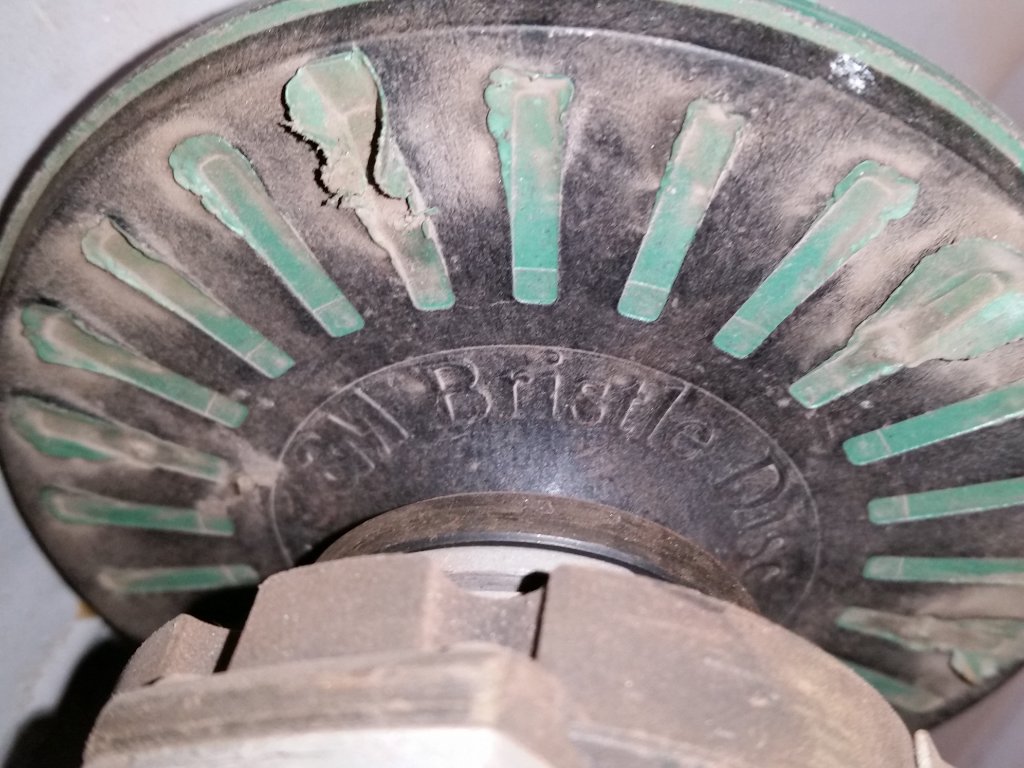

What did you use to strip it? Soon, she'll be getting her new "prom dress". I was there as well.

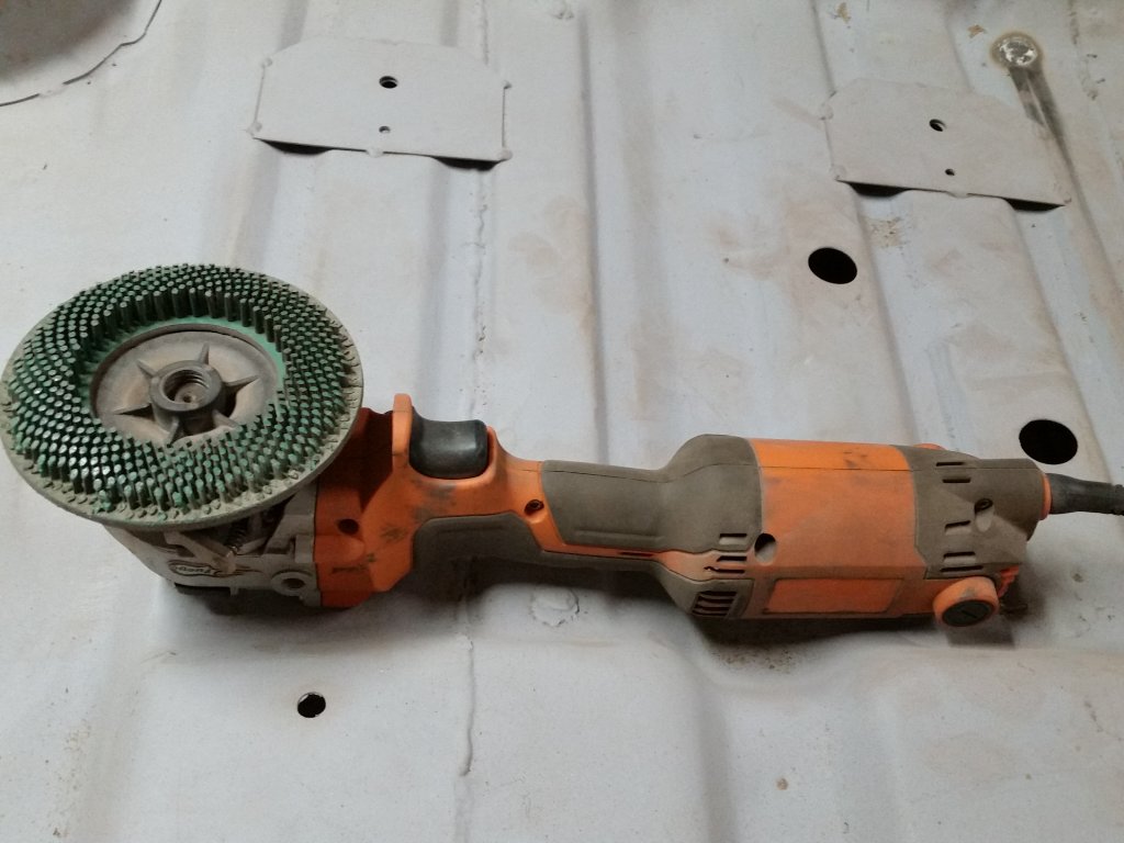

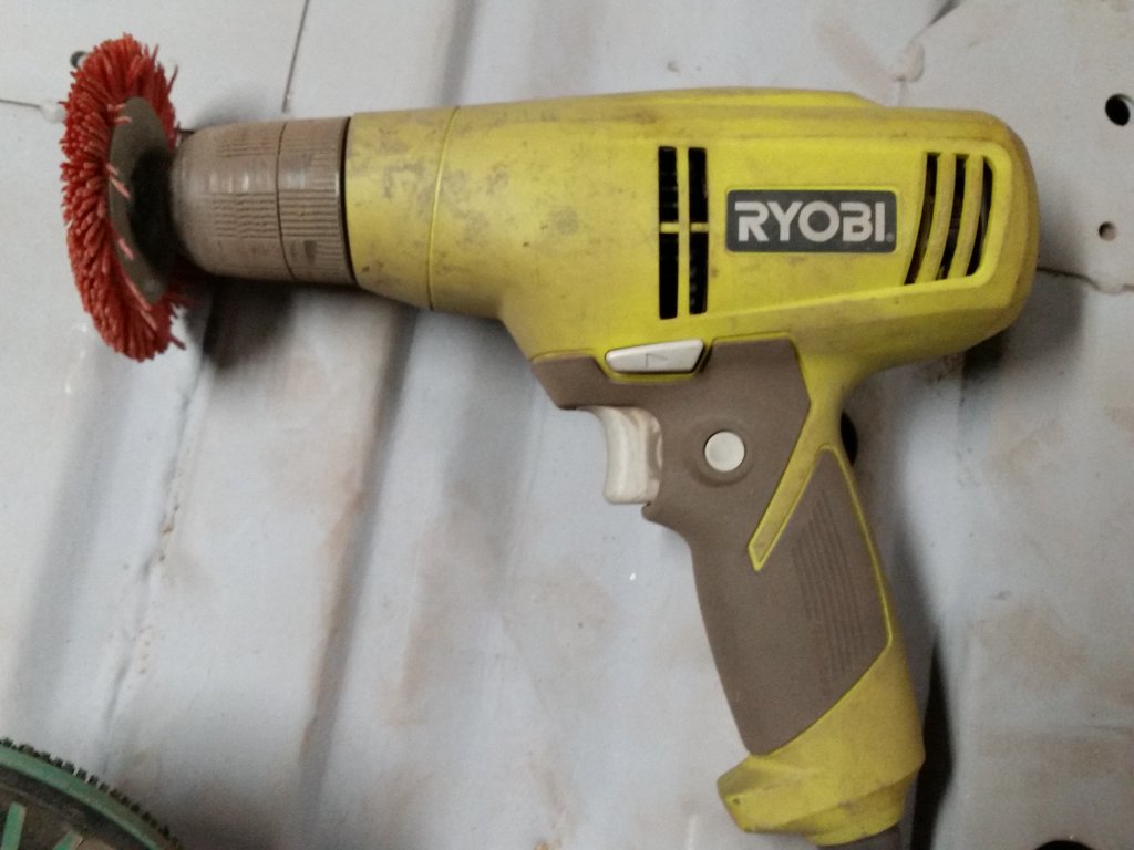

Post by 71Beeper » Mon Feb 04, 2019 8:19 pm
I used 2 different power tools.
First I used this rubber bristle disc to remove the hard contact cement glue that was on there.
Close up of the wording - its made by 3M
Then I went over it with this fiber wheel.
Cleans it up real nice with no heat to the metal.

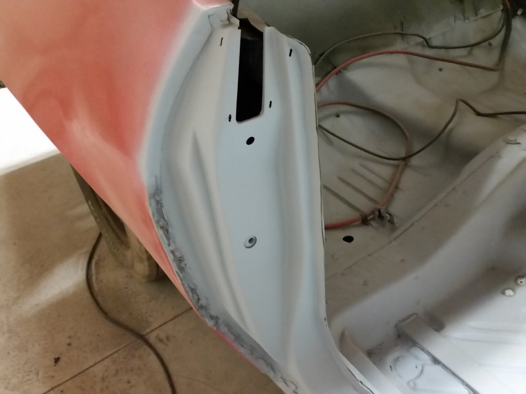

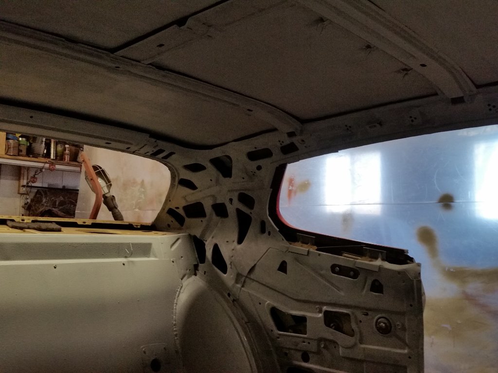

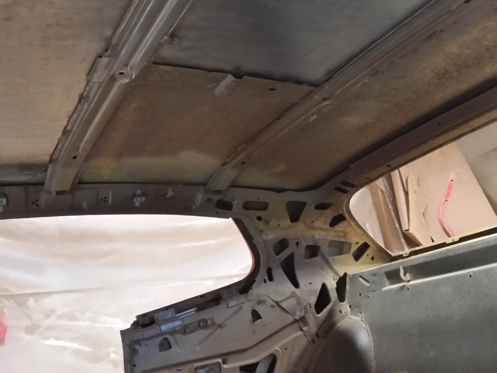

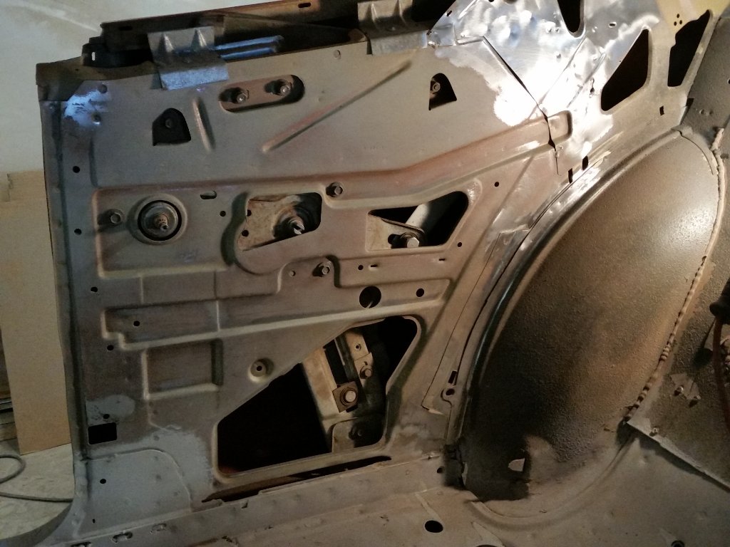

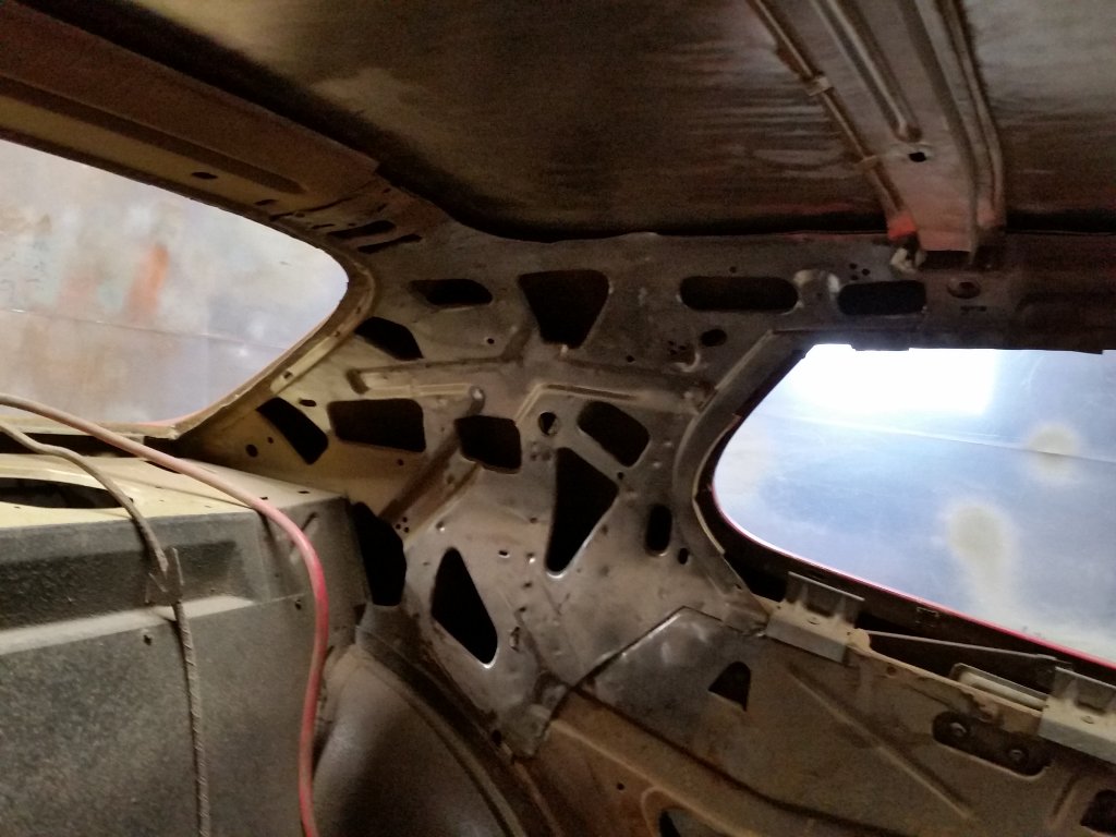

Post by 71Beeper » Sun Feb 10, 2019 8:18 pm
A little update today.
I finished cleaning the underside of the roof along with the insides of the C pillars.

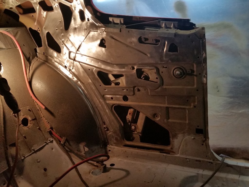

Post by 71Beeper » Mon Feb 18, 2019 8:32 pm
Finished up prepping the sides - now to wait for warmer weather before putting on epoxy primer.

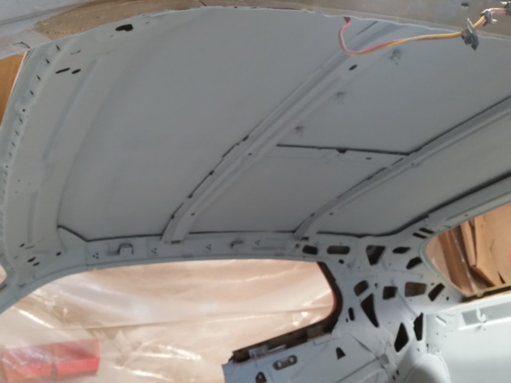

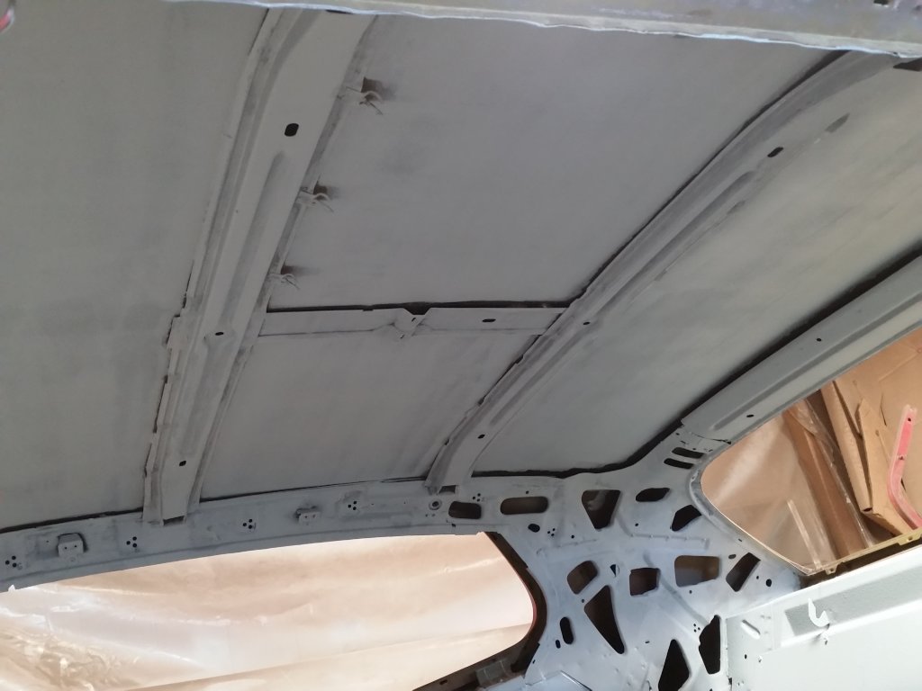

Post by 71Beeper » Thu Feb 28, 2019 9:01 pm
Many Thanks Gary - I'm trying to get all of the primer work done before the car goes to the body shop.

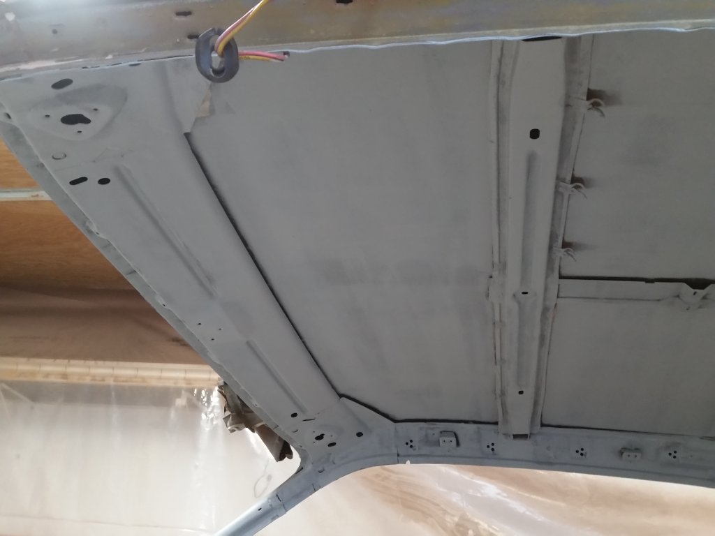

I got the first coat of epoxy primer on the underside of the roof and C pillars.
Feb 23 (3).jpg (74.25 KiB) Viewed 58660 times
Feb 23 (6).jpg (112.11 KiB) Viewed 58660 times
Feb 23 (4).jpg (59.03 KiB) Viewed 58660 times
Feb 23 (8).jpg (104.68 KiB) Viewed 58660 times
Feb 23 (2).jpg (96.41 KiB) Viewed 58660 times
I plan on putting a final 2nd coat soon.

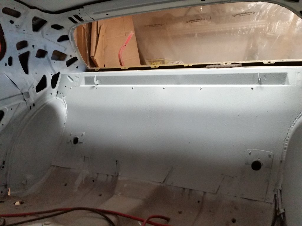

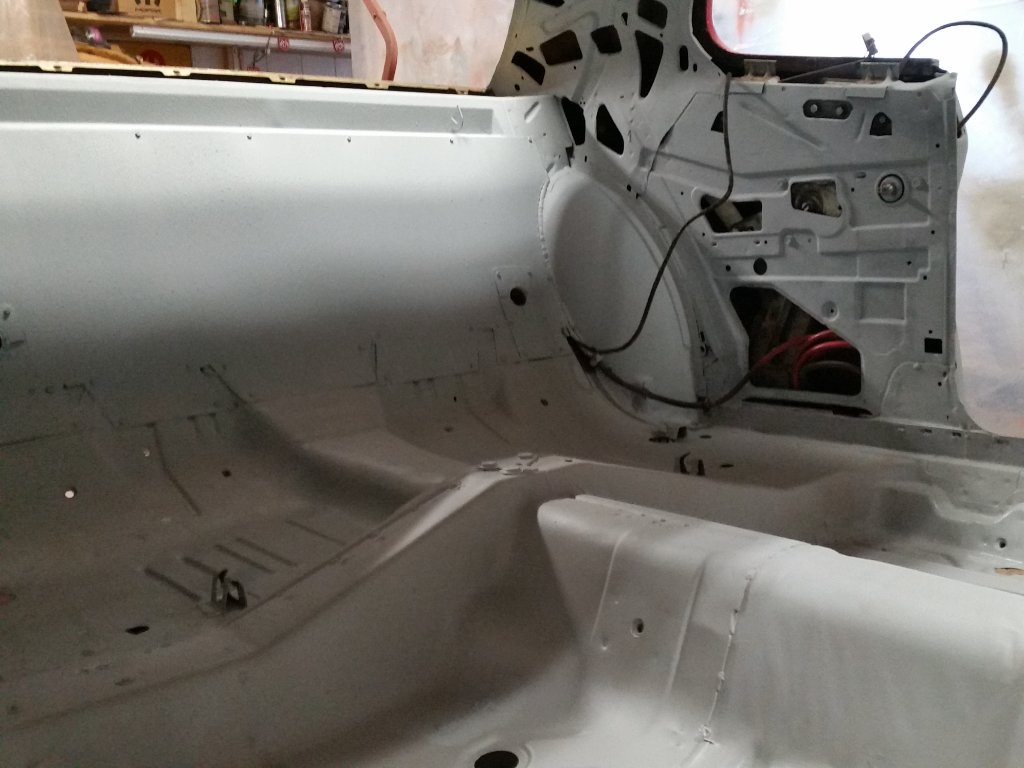

Post by 71Beeper » Sun Mar 03, 2019 12:08 pm
Thanks rr6pak,

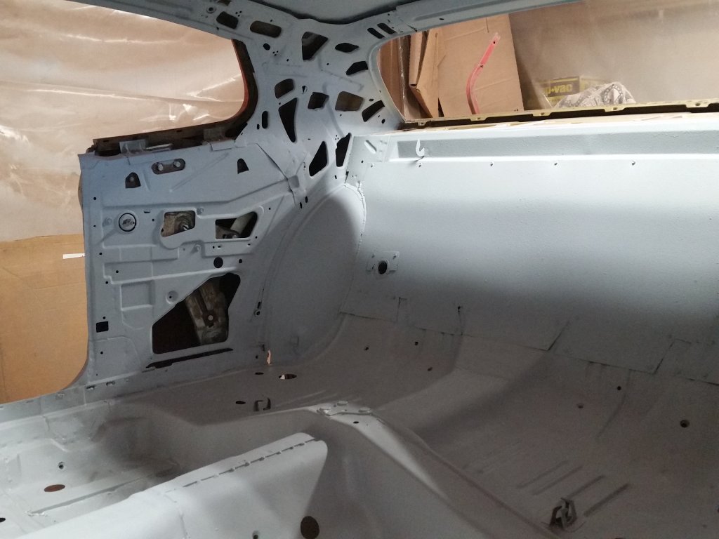

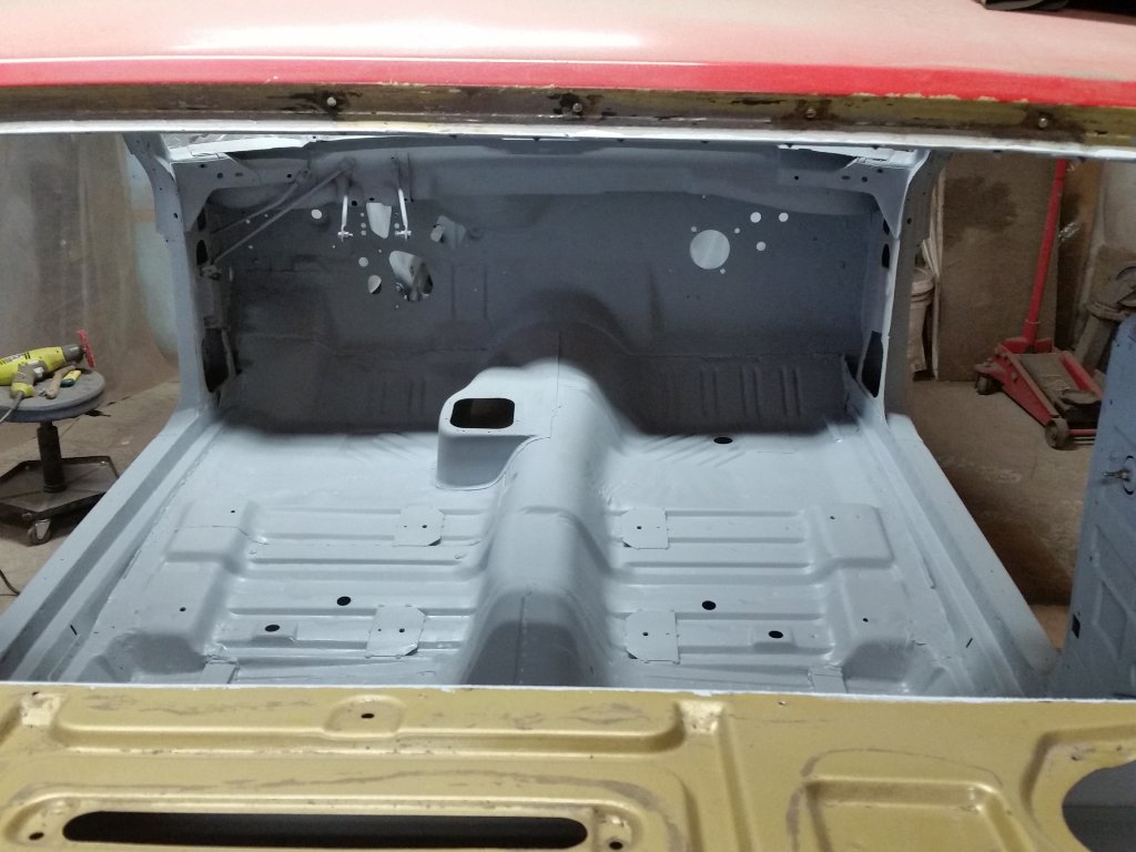

Yesterday I put down the final coat of epoxy primer on the whole inside of the Runner.
I'm happy with the way it turned out. :D
The next step.....to remove the front and rear suspension and get her on dolly wheels.

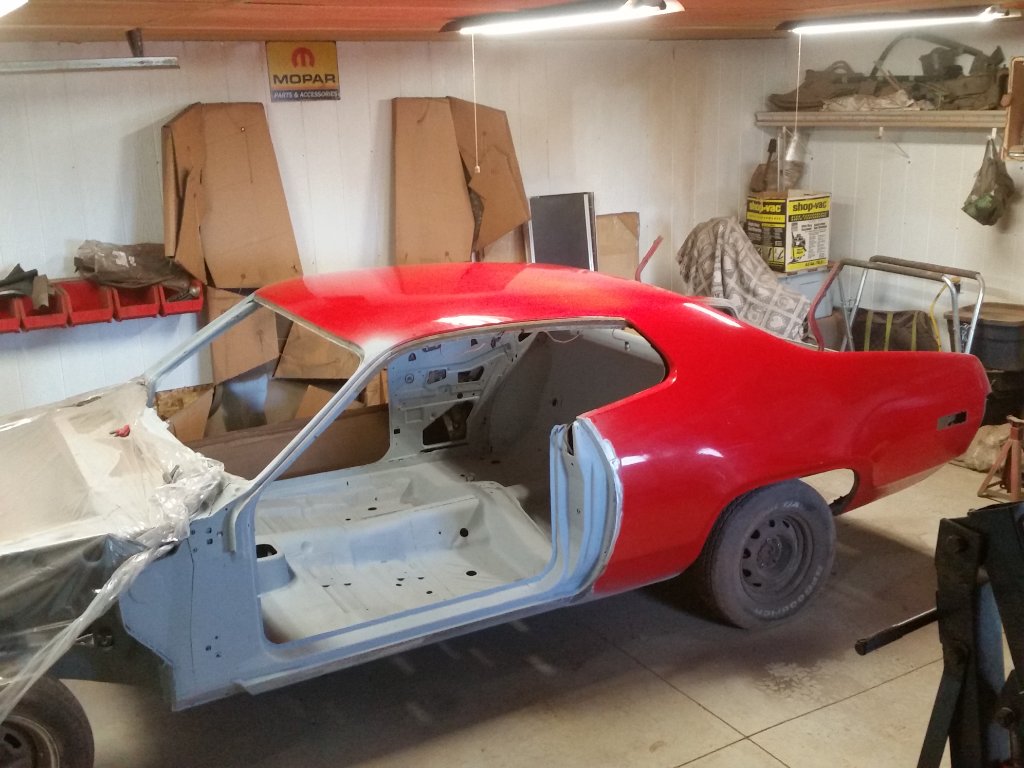

Post by 71Beeper » Sat Mar 23, 2019 1:16 pm

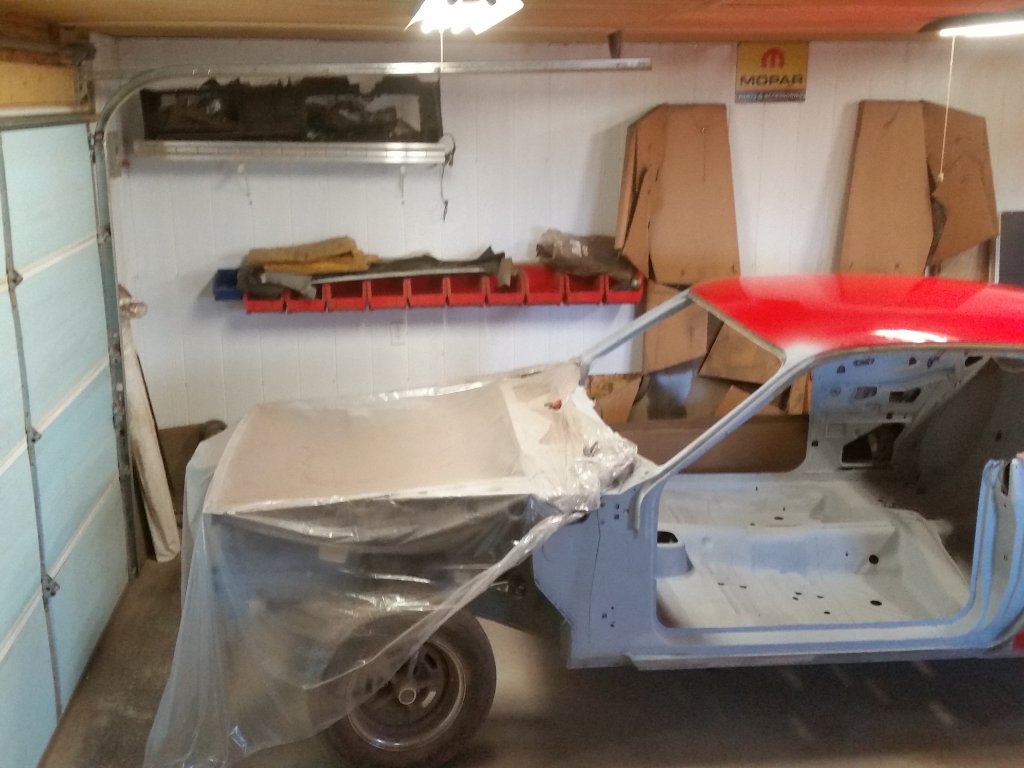

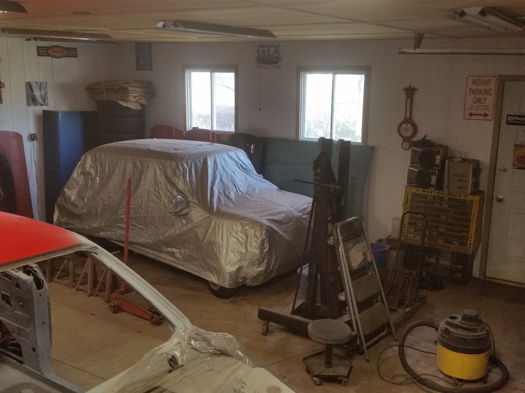

Now with no more grinding or sanding required by me, it's time to clean up the shop.
I took down all of the 6mil poly plastic that I had on the walls and dividing the shop in half.
It looks much bigger now.
March 17 (5).jpg (121.57 KiB) Viewed 58537 times
March 17 (6).jpg (103.1 KiB) Viewed 58537 times
But of course looking at the other side of the shop - that's where all the other stuff is piled up......sheesh :mad:
March 17 (8).jpg (117.3 KiB) Viewed 58537 times
So now the next step is to remove the front & rear suspensions and get the car on dolly wheels.
