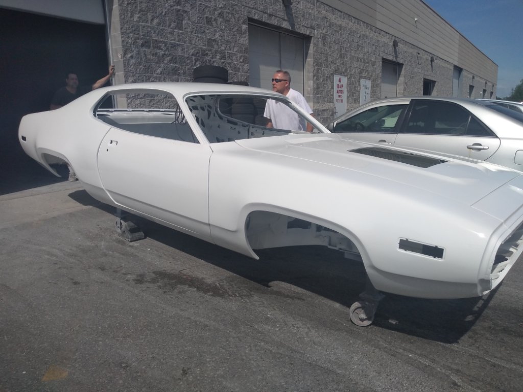

Are you sure the colour is Spinnaker white?
It sure looks like the Alpine white I just had my car painted in. It could be the photos.

Re: My 73 RR
I'm fairly certain its Spinnaker White, it's on the fender tag codes. Not home right now the check the codes. Either color looks great on these cars, at least I think so.
Your car paint turned out great from the pictures you have posted.

Re: My 73 RR
EW1 was the same color from 1969 through at least 1980 - It was just given a different name depending on year range and make of vehicle. For Dodge vehicles from 1969-1971 it was called "White". Plymouth 1969-1970 "Alpine White". Chrysler cars 1969-1971 & Plymouth 1971 "Spinnaker White". For Dodge 1972 and up "Eggshell White". And for Chrysler/Plymouth 1972 and up "Spinnaker White". And to confuse things further GW3 was a brighter white in 1971 - Dodge "Bright White" and Plymouth "Sno White".

Re: My 73 RR
W3 was the paint code I told my painter to get.

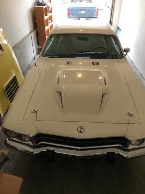

Took my car out for about 150 mile drive. Ran great. Planning a 1200 mike drive next week.

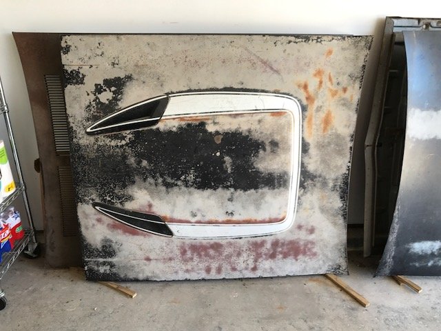

Picked up a spare hood few months back. Can never have enough spare parts around.
Mike
Mike
- 1973 RR front 3 23 2021.jpg (17.91 KiB) Viewed 79551 times
- 74 RR hood black and white.JPG (72.37 KiB) Viewed 79551 times

Sorry, that not the correct spare hood I wanted to post.
Mike

- ct71rr
- Posts: 344
- Joined: Tue Aug 16, 2005 7:23 pm
- Location: Massachusetts
Re: My 73 RR
Very nice! I’m not sure if I’ve ever seen a white ‘73 before.
