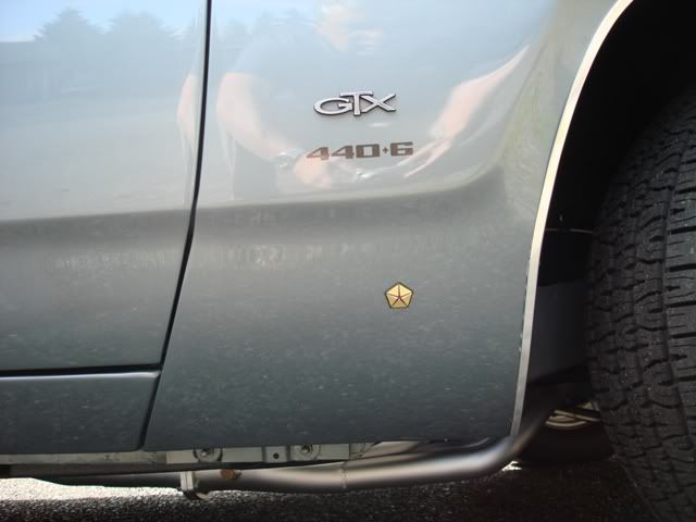

Moparlar wrote:
1972RM23 wrote:This is correct for a 72 N96 car
You are saying that air grabber cars should have 440 on the fender?
LArry
That's what the factory engineering documents indicate....in fact they indicate 340, 440, and 440+6 decals in this location for 72 air grabber cars equipped with these engines. Can't say I've seen an original 340 72 car with these though....and you have the only known 440+6 car...

Only 440 RR/GTX car with N96 for 1972 got fender call outs.
They were below the GTX emblem, not above the side marker lights like 1971.
No fender call outs for 400 cars with N96 for 1972 (I do not think 340 cars either)
Though my 400 has them above the marker light on my 1972 RR.
They are not correct but look very cool so I'll keep them on.
David's car is correct on N96 RR/GTX for 1972

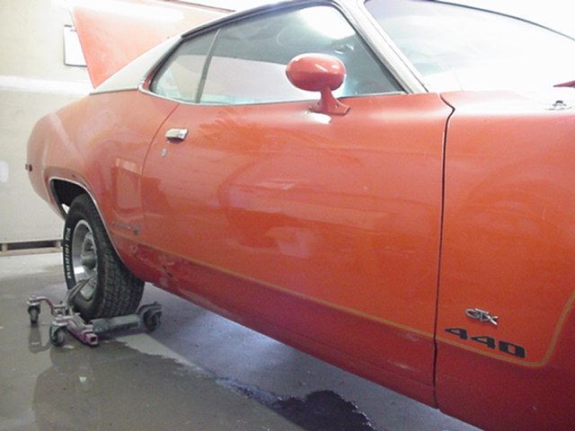

Post by farmboy70 » Sat Dec 31, 2011 9:23 am
There use to be drawings on the Hamtrack historical website but he had to take them down because of copy right issues.
I think I still have a copy in a booklet I bought years ago, I'll see if I can find them today.
farmboy70
Posts: 136
Re: Where are we on the 'GTX badge' thing...

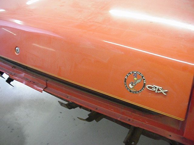

Post by farmboy70 » Sat Dec 31, 2011 9:28 am
Here ar a couple of pictures beforethe resto on 72.ImageImage

I grabbed copies of everything they had on the 72’s before they were taken down, nothing specifically covering 72’ fender call-outs that I can find. As Larry mentioned, nothing in the parts cats about them that I can find either.
Back then it was way easy and pretty common to order up stick-on badges and call-outs from other applications/years and stick them where ever, and on anything. Also there was a lot of dealer body repairs performed on many cars prior to delivery to the first buyer, a lot of that stuff just didn’t get back on where they were originally or in some cases omitted altogether.
