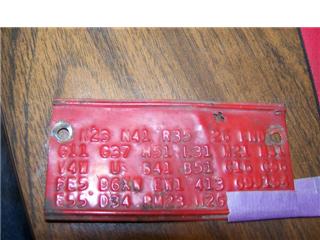

Well the guy said he added the trim when he bought in the 76 and he's the second owner. And he sent me the fendertag and well I think this wraps up this mystery. Also I've checked everything on here that would have the roadrunner emblems even on the dash it's just the trim got me worried about it.
RM23H2G187947

Mo Power wrote:This is what the guy sent me for the codes he could not find all of them so hopefully you can tell me some good news on this Roadrunner 1972RM23. Also the guy said he would be giving me 4 good fenders, 2 doors, front valance, decklid, rocker replacment,dash pad,and another front and rear bumper if this isn't screaming deal I don't know what is.
N23 N41 R35(am/fm radio) 26(radiator) END G11(tinted glass all) G37(chrome mirrors) H51(AC) L31 M21 M31(belt moldiing) V4W(canopy vinyl roof) U B41(PDB) B51 C16(console) C56 FE5(rallye red) D6XW(white buckets) EW1 413 G(sun roof) 99154 E55(340x4) D34(auto) R(plymouth) M(medium) 23(2 dr hard top) H(340x4) 2(72) G(st louis) XXXXXX
413 G(sun roof) Where does this say it means it is a sunroof car?
I thought 413 was the build date of April 13, I am confused, can anyone explain this to me??????

Mo Power wrote:Well the guy said he added the trim when he bought in the 76 and he's the second owner. And he sent me the fendertag and well I think this wraps up this mystery. Also I've checked everything on here that would have the roadrunner emblems even on the dash it's just the trim got me worried about it.
Well the tag you show is a 1972 RR tag.
It has the options that look to be on this car and the tag sequence number is (looks to be) G99154.
The "G" make to a Sunroof optioned car.
413 is the build date of April 13 1972.
I have my production numbers at home .. i'll PM you.
I would check the radiator support, Vin tag, door tag and cowl numbers.
Looks like it could be real.
The thing people are hung up about is the SSP trim and lower argent paint ... which you say the pervious owner added ... that could be possible.
It looks as if the tag and the car show have options the match so it could be the real deal.
It has the light group, a 340, white canopy vinyl top, sunroof, FE5 red car and white interior.
Sound like a great deal if it really is a RR.
Post by 1972RM23 » Fri Nov 16, 2007 11:05 am
OK ... I emailed my friend Jimmy Boros (1971-1972 B-Body guru) about this car and he believes he has this tag in his records.
He and I think it's the real deal as far as we can tell.
It's a 1 of 34 SUNROOF 1972 Road Runners.
For $5000 it would be a good deal ... needs lots of work but a RARE CAR!

Mo Power wrote:Ya I've checked this one on ebay and got me thinking because of all the satellite interior panels. But I nowadays any car could be a joke but I couldn't check out every car I was going to purchase. So sometimes you gotta take the guys word since I have talked to him. But I know you guys are worried about it not being a real roadrunner. But thanks for the helpout guys that would of scared me if I didn't post this before I bought the car. And I typed in the fendertag decoder and had nothing to say about a sunroof on the car.
Surprisingly, the sunroof code (M51) didn't show up on fender tags on St. Louis cars. As 1972RM23 mentioned, the G at the beginning of the VON (vehicle order number) is the only indication you will see on the tag (and a sunroof car will have to have either the full or partial vinyl top)
