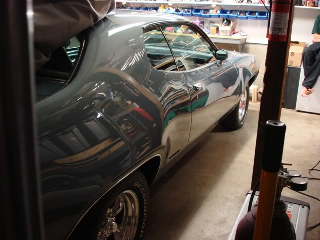

Post by 72RoadRunnerGTX » Wed Mar 11, 2009 7:42 pm

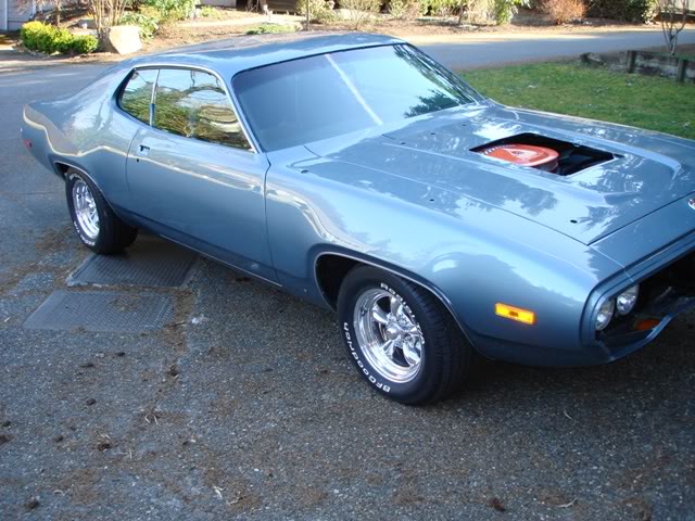

Finally home from the body shop, now I can put it back together.

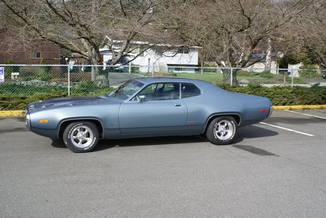

Re: Continuing progress on the 72' Road Runner/GTX
Post by 72RoadRunnerGTX » Fri Mar 13, 2009 12:03 pm
After grilling my paint guy a little more about the color, turns out according to DuPont, the "modern equivalent" for the original 72' GA4 is a 98' Mitsubishi color (T52 Sydney Blue Effect). There are times it looks blue, other times I can see a slight green tint, and every so often it does look grey especially after dark. I'm not yet convinced it's a perfect match to the original color I remember. It does match well with the old paint chips for 72' I have however. Either way I am very pleased with the end result.

Re: Continuing progress on the 72’ Road Runner/GTX
Post by landon1 » Fri Mar 13, 2009 6:54 pm
indeeed - my car is supposed to be Intense Blue Pearl (common on late 90s Dodge Rams, Dakotas, etc. but if I park next to one, it's not at all alike...
i think anyone would be pretty jealous, regardless :beer:

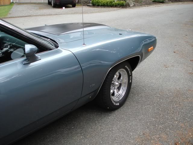

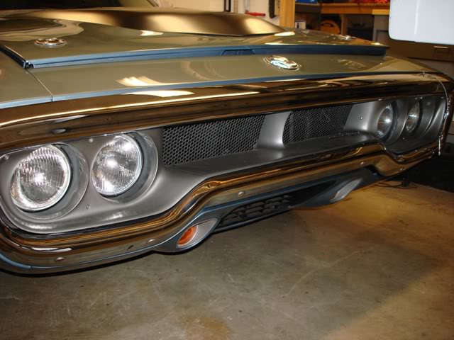

Post by 72RoadRunnerGTX » Fri Mar 20, 2009 1:01 am

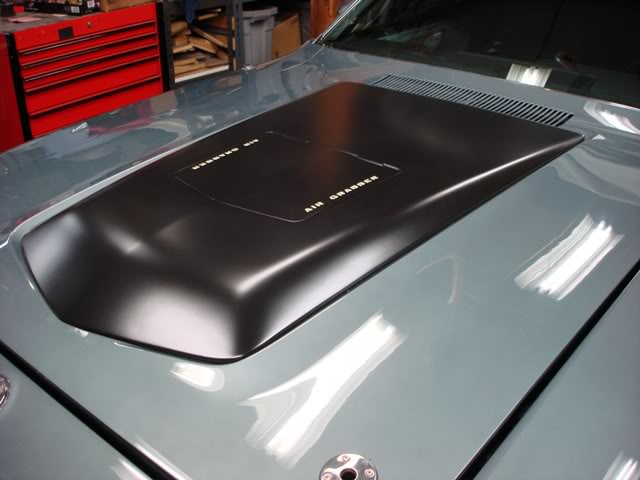

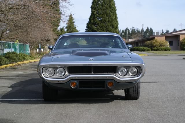

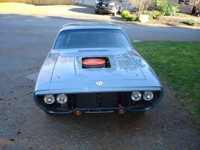

The installation of the air grabber parts today marks the completion of the body\paint portion of this restoration. With a just few details left on the interior the car is pretty much done. Now if it would only stop raining here, I could go drive it.
Post by ajcpaperboy » Fri Mar 20, 2009 1:13 am
Your car looks GREAT, I wish I was working as fast as you are.
Your pictures of the Air Grabber are going to be very helpful
when I get to that point. Thanks

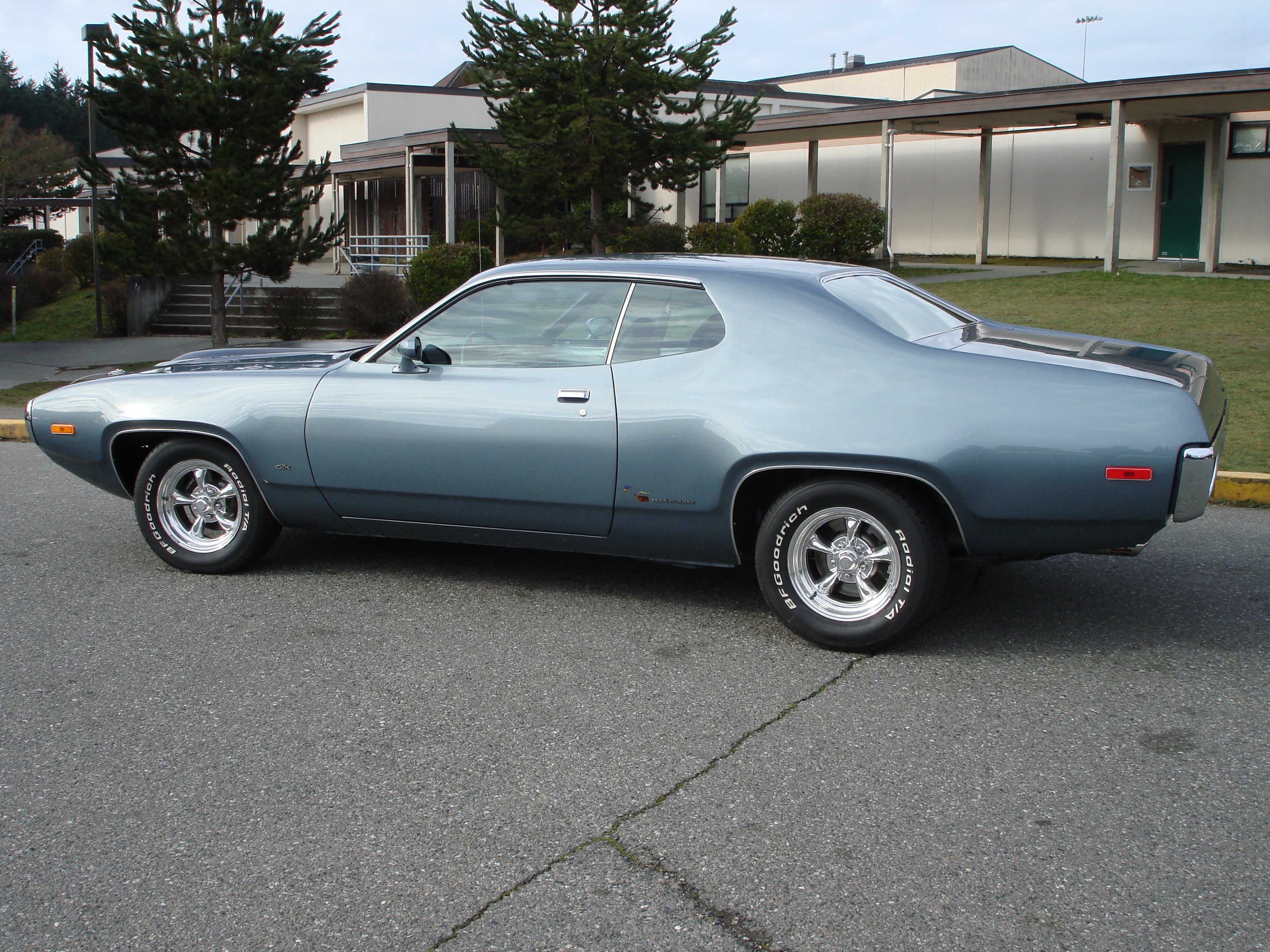

Ian B.

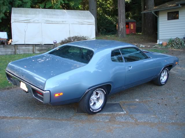

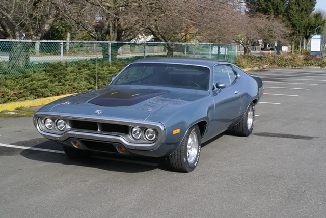

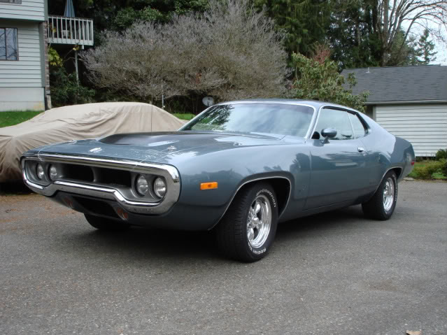

Post by 72RoadRunnerGTX » Sat Mar 21, 2009 2:24 pm

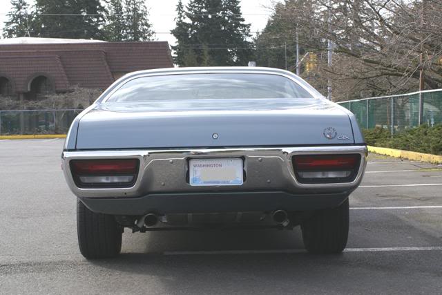

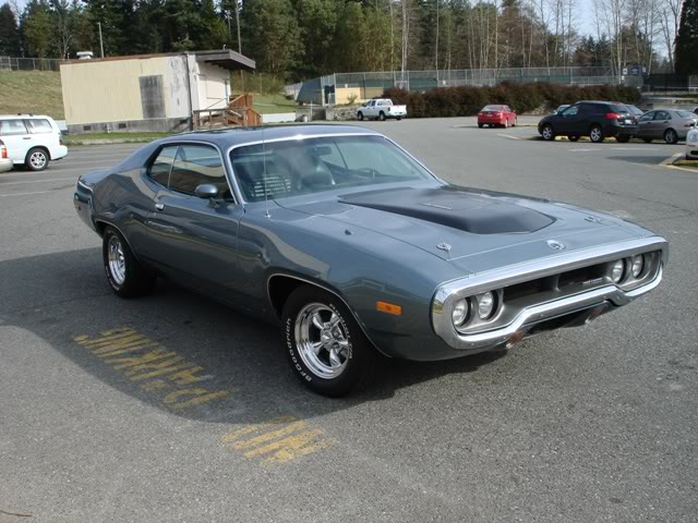

Was able to get the car out of the garage today and get some decent pictures.

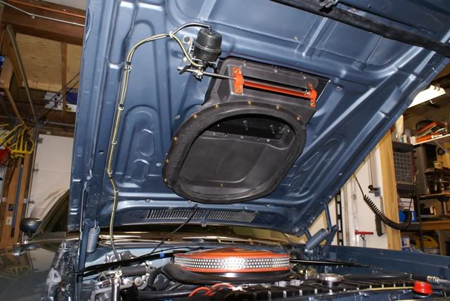

If I could ask one question.........What size screw did you use to mount the actuator bracket mount to the hood for the air grabber? I have been pondering that question for my car the entire winter.
Great car,
Dennis

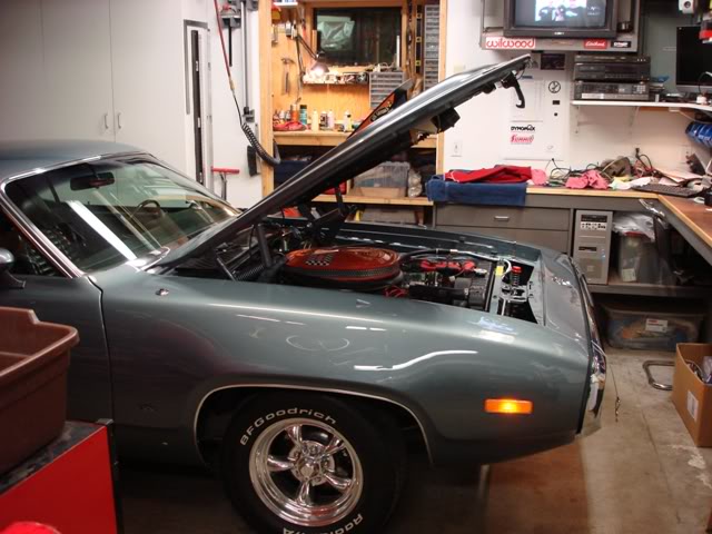

Post by 72RoadRunnerGTX » Tue Mar 24, 2009 12:14 am
Screw size is 10-24x ¾" captured washer. If memory serves me correctly, the factory A/G hoods had a nut plate affixed to the inside of the hood brace, the bracket mounted to that and allowed for quite a bit of position adjustment. The Satellite flat hood I used had all the holes punched but no nut plate so I created my own nut plate for this propose, unfortunately I don't have a picture of it. Basically four 10-24 square nuts welded to a sheet plate formed to conform to the backside of the brace.

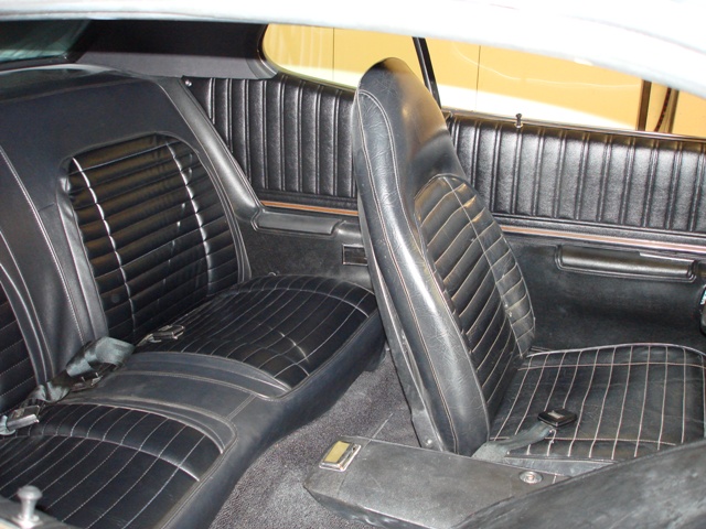

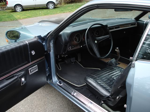

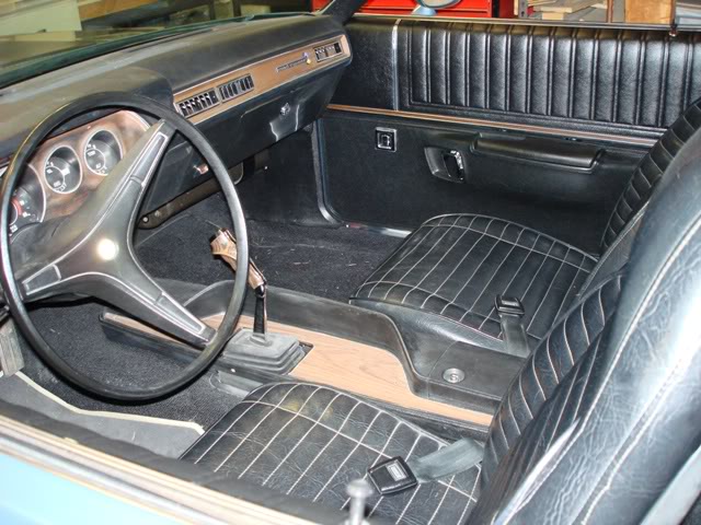

I do appreciate all the complements received for this project over the last couple of years, thanks much all. I installed the door panels on the car tonight and basically there is not much left to do except clean up the body shop dust and go dive it. I am finding it hard to believe it's finally done.

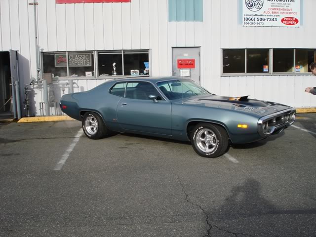

Re: 72’ Road Runner/GTX restoration

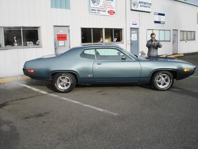

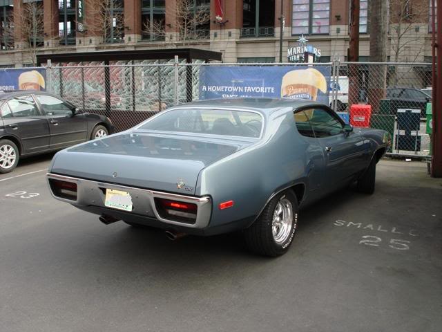

Post by 72RoadRunnerGTX » Thu Mar 26, 2009 11:06 pm

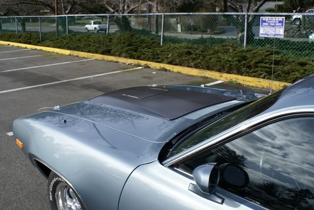

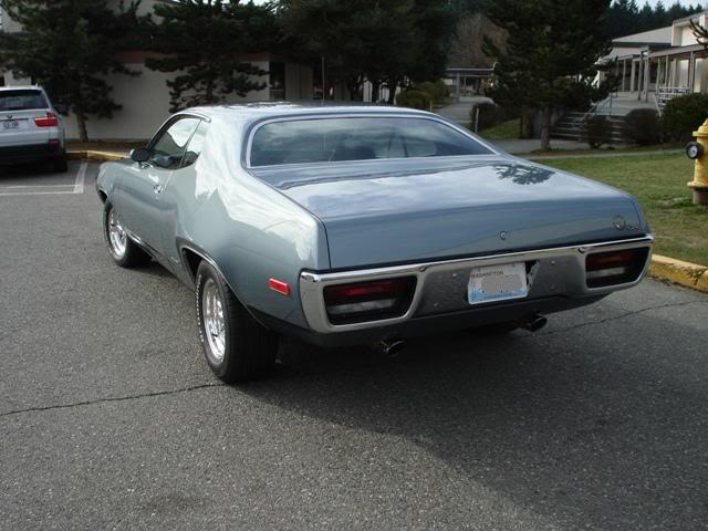

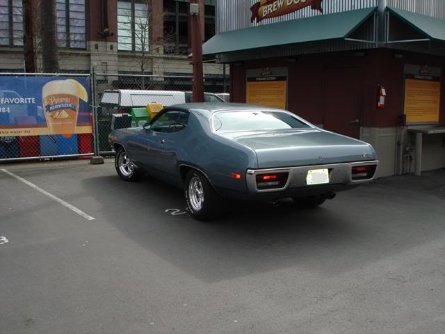

Another day in Seattle without rain in the forecast, so I drove the car into town today.
Last edited by 72RoadRunnerGTX on Sun Apr 10, 2022 11:02 pm, edited 4 times in total.
