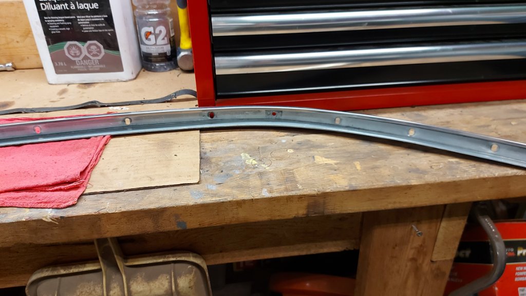

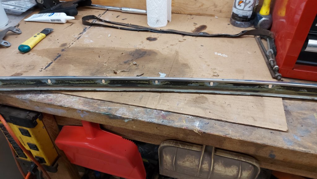

In the meantime I started cleaning up the upper window seal trim.
Oct 15 (2).jpg (133.51 KiB) Viewed 44772 times
Now I know when I took them off the car I kept them together.....or so I thought.
I could only find the passenger side.
I don't remember if the drivers side had issues or was already broken, but it's MIA.
I'll have to start to find another one.

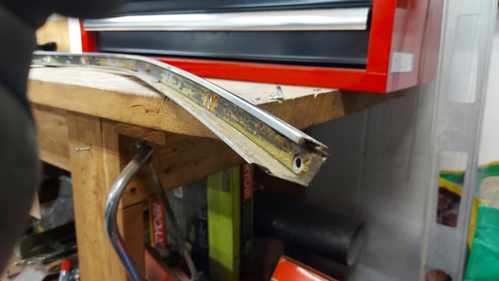

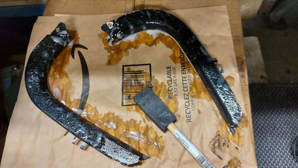

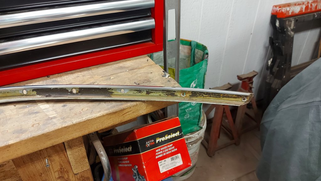

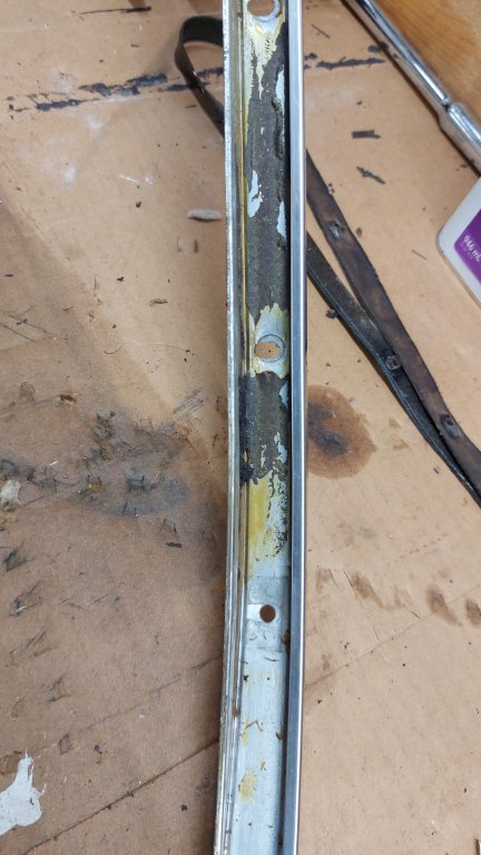

So now to get all of the contact glue off of it.
Oct 15 (3).jpg (112.67 KiB) Viewed 44772 times
Oct 15 (1).jpg (70.02 KiB) Viewed 44772 times
Oct 15 (4).jpg (112.77 KiB) Viewed 44772 times

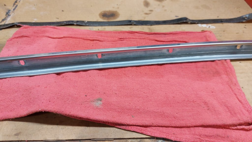

Post by 71Beeper » Sun Oct 17, 2021 8:24 pm
A little bit of lacquer thinner and a scraper and it's all clean.

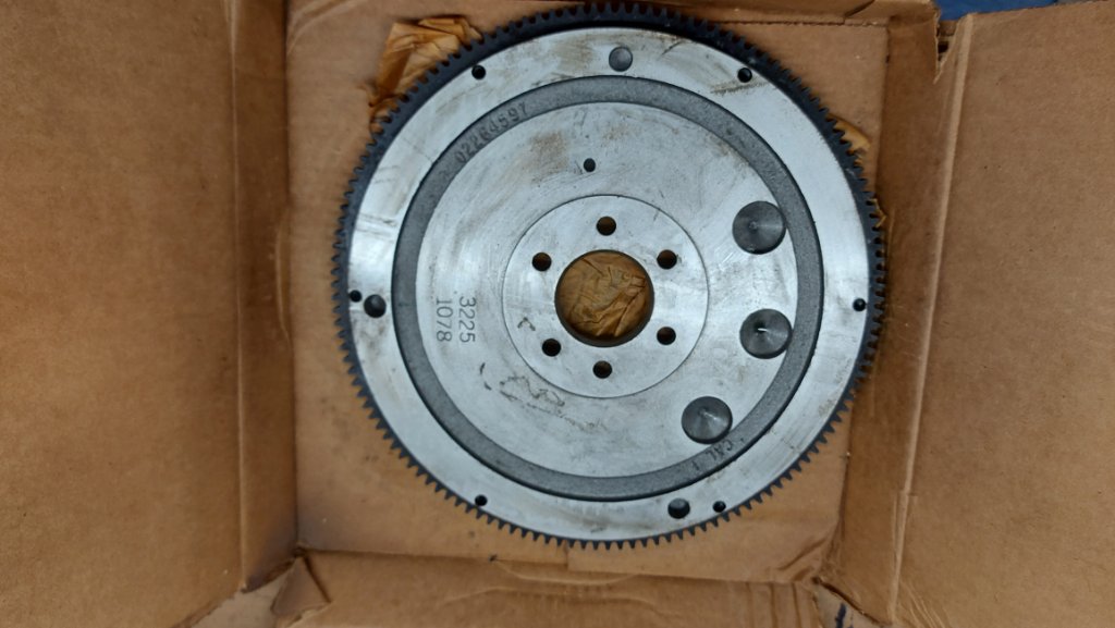

Like, get my new flywheel down and make sure it goes with the engine when its time to take it in.
I mention new cause that is what it was when I bought it from my local dealer.
Nov 1st (1).jpg (72.47 KiB) Viewed 44666 times
Nov 1st (2).jpg (65.06 KiB) Viewed 44666 times
Nov 1st (3).jpg (86.98 KiB) Viewed 44666 times

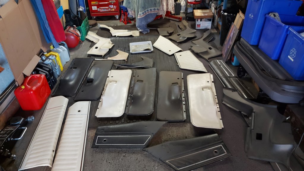

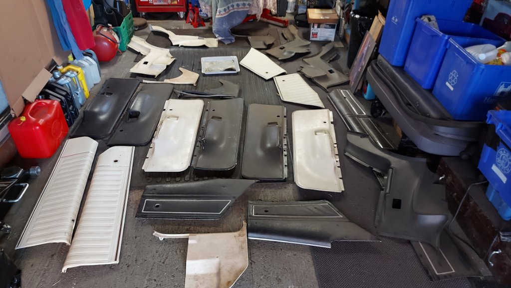

Post by 71Beeper » Sun Nov 07, 2021 8:20 pm
Today I had a chance to gather all of my interior panels.
Nov 6th (1).jpg (115.27 KiB) Viewed 44666 times
I didn't realize what a hoarder I am...... :D
Nov 6th (2).jpg (118.02 KiB) Viewed 44666 times
I think I have 3 sets of panels....one that the car came with, one other set of black and a set of white panels.
Nov 6th (3).jpg (117.38 KiB) Viewed 44666 times
I'll have to go thru all of them and pick out the best ones to dye black.

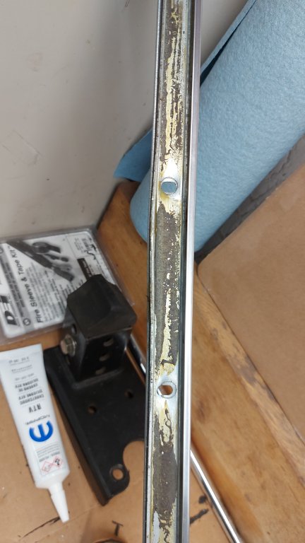

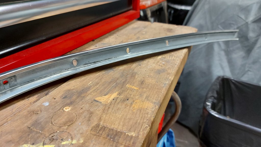

I got the both upper window seal trim pieces (since I had to buy one) all cleaned up and primered and painted.
Nov 14th (2).jpg (89.46 KiB) Viewed 44597 times
I tapped all of the mounting holes flat before primer and paint.
Nov 14th (5).jpg (48.75 KiB) Viewed 44597 times

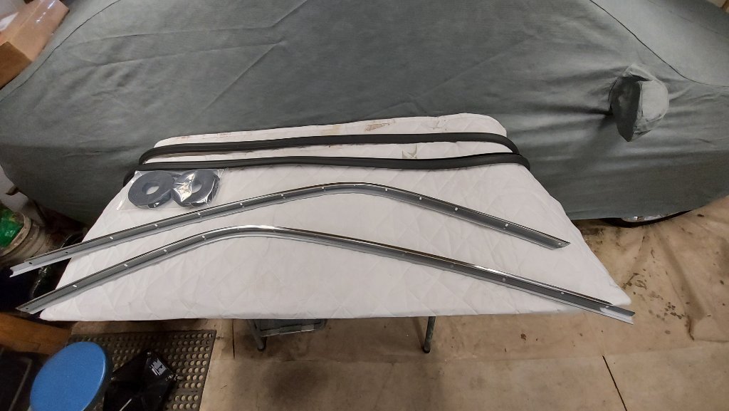

I had to glue on the upper foam seal which I got from Detroit Muscle.
I used the 3M adhesive.
Nov 14th (7).jpg (79.1 KiB) Viewed 44597 times
Nov 14th (9).jpg (70.1 KiB) Viewed 44597 times

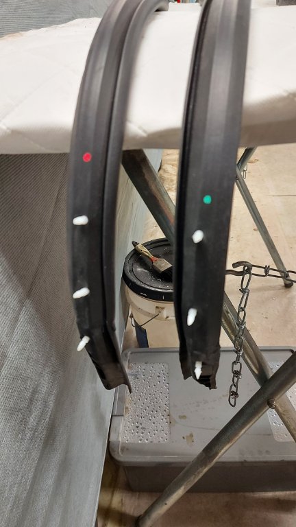

The seals themselves, I'm not sure which one goes on which side.
Nov 14th (10).jpg (60.2 KiB) Viewed 44597 times
Anybody here have an idea?

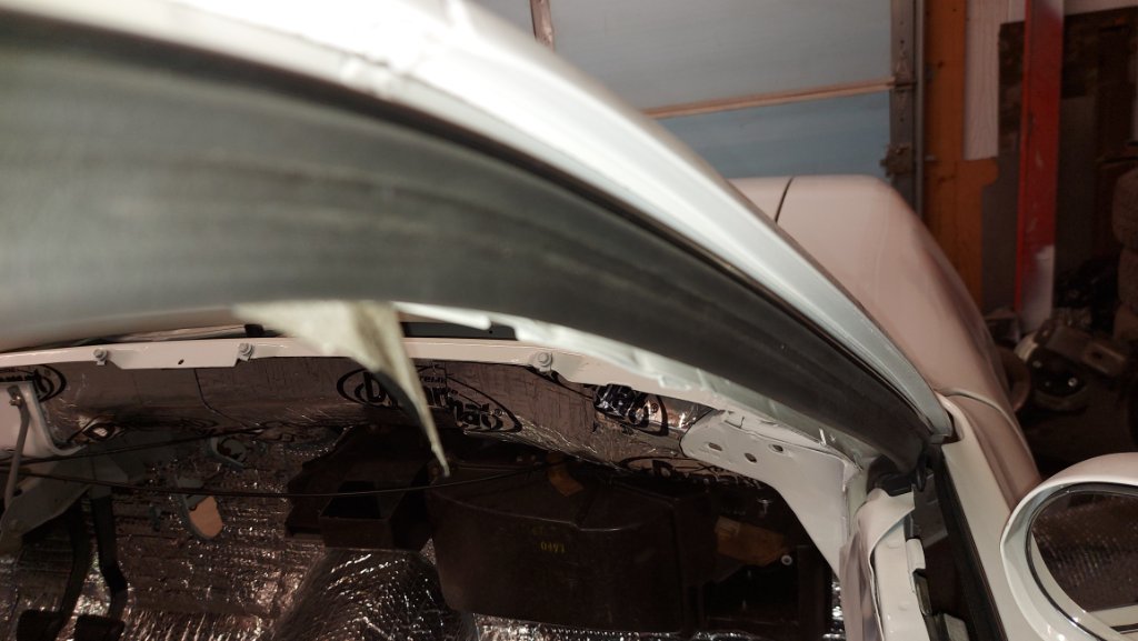

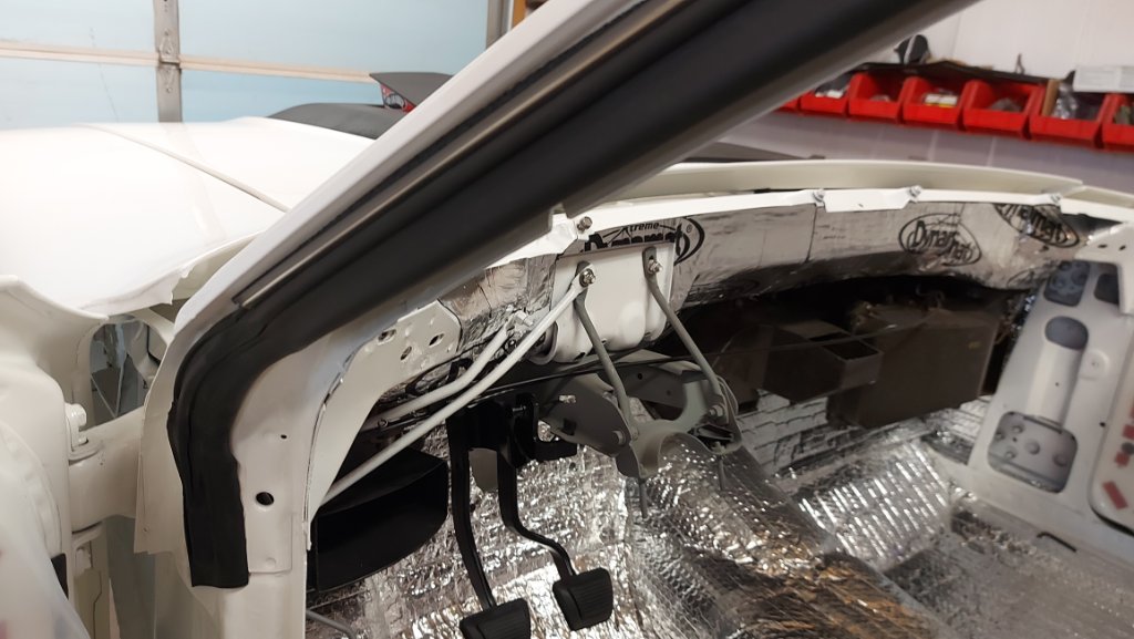

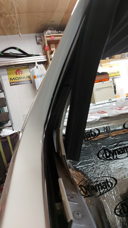

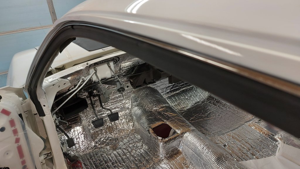

So, I had time to do a fit-check of the window seals.
Nov 20th (7).jpg (80.36 KiB) Viewed 44533 times
Not too difficult going into the track.
Nov 20th (5).jpg (106.39 KiB) Viewed 44533 times
Nov 20th (4).jpg (63.58 KiB) Viewed 44533 times

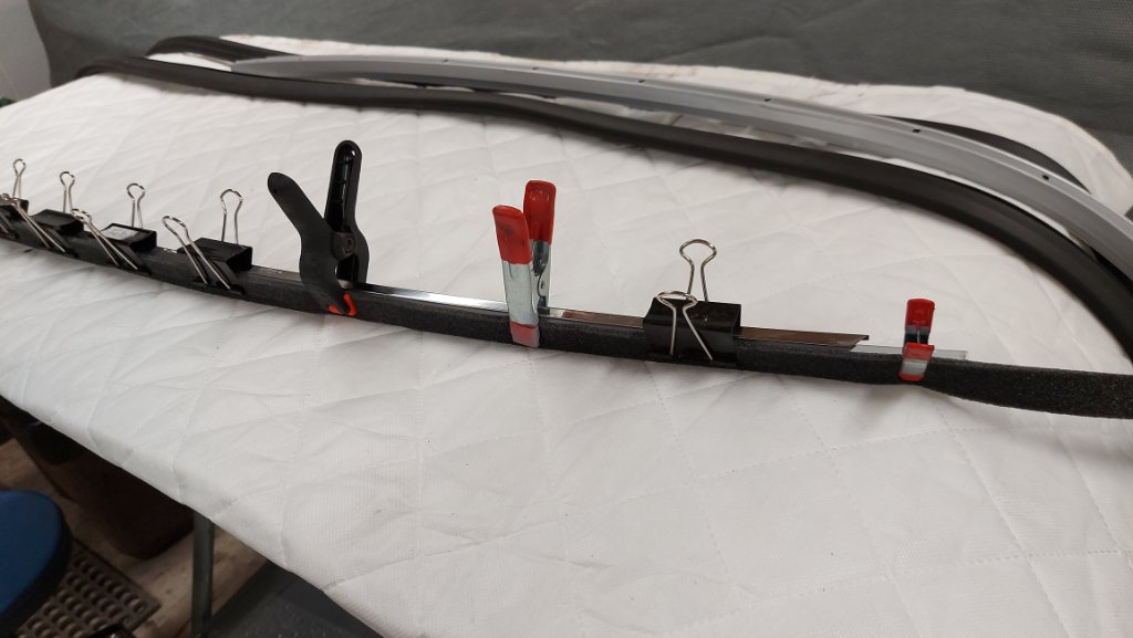

The front section has to be glued in place.
Nov 21st (2).jpg (58.93 KiB) Viewed 44533 times
So I left them like this so the adhesive can set.
Nov 21st (3).jpg (83.04 KiB) Viewed 44533 times

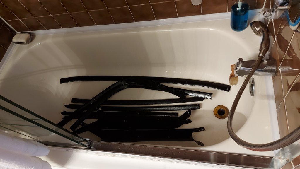

While waiting for the adhesive to set I found all of my interior trim pieces.
Problem is the previous owner painted them gloss black, so I have to prep them to be stripped (if possible) and painted the proper satin black.
You know you're a redneck when you use the bathtub to wash parts.... :lol:
Nov 21st (4).jpg (79.61 KiB) Viewed 44533 times

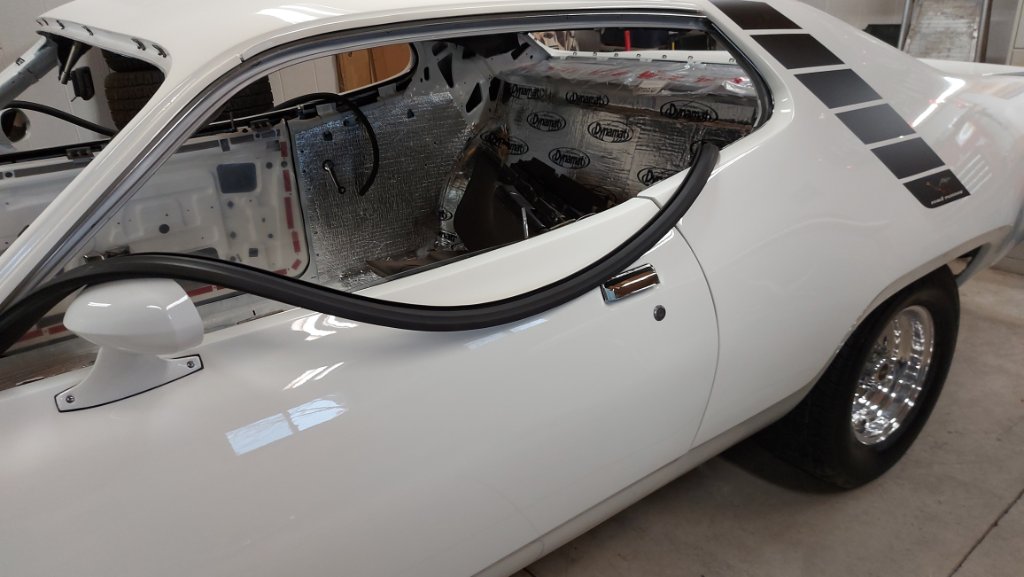

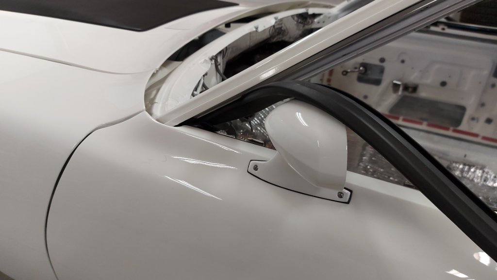

Post by 71Beeper » Mon Nov 29, 2021 9:14 pm

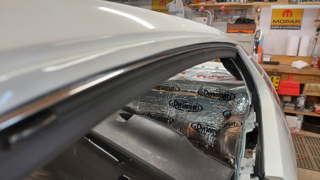

Yesterday I did the final install of the side window seals.
Nov 28th (1).jpg (92.72 KiB) Viewed 44447 times
Nov 28th (2).jpg (127.19 KiB) Viewed 44447 times
I did glue them in place to make sure they stay in their track.

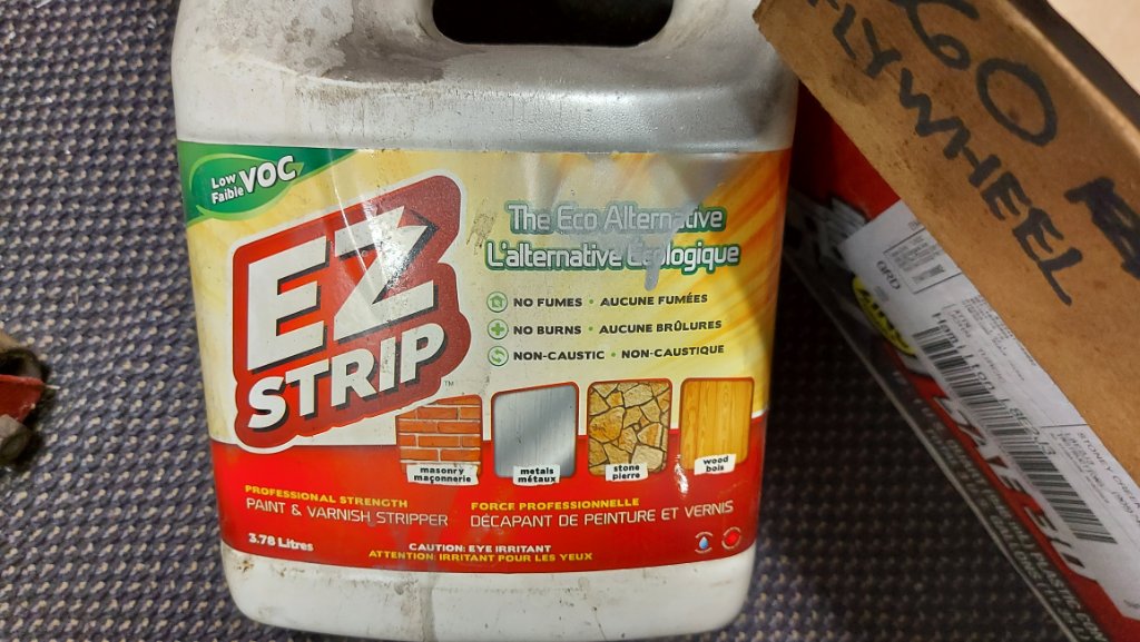

My neighbor suggested that I use paint stripper to get the gloss black off the pieces.
He gave me a jug of this stuff.
Nov 28th (6).jpg (134.34 KiB) Viewed 44447 times
Seems to work good so far.
Nov 28th (7).jpg (127.42 KiB) Viewed 44447 times
Nov 28th (8).jpg (80.14 KiB) Viewed 44447 times

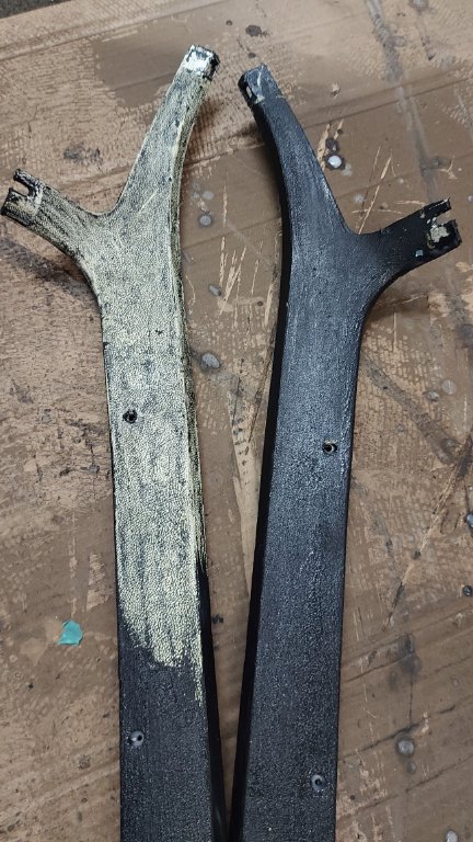

Posts: 746
Post by 71Beeper » Sat Dec 18, 2021 1:13 pm

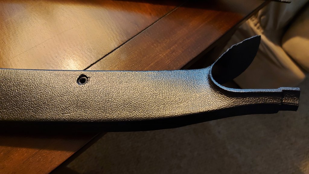

Here's what those pieces look like with the SEM trim paint.
Dec 15th (2).jpg (108.58 KiB) Viewed 44233 times
Dec 15th (3).jpg (115.52 KiB) Viewed 44233 times

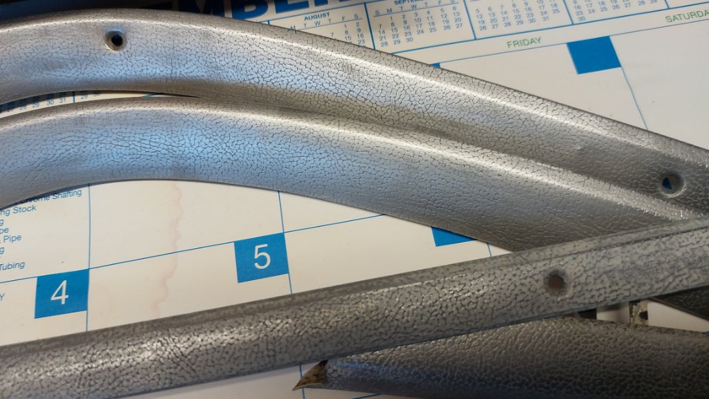

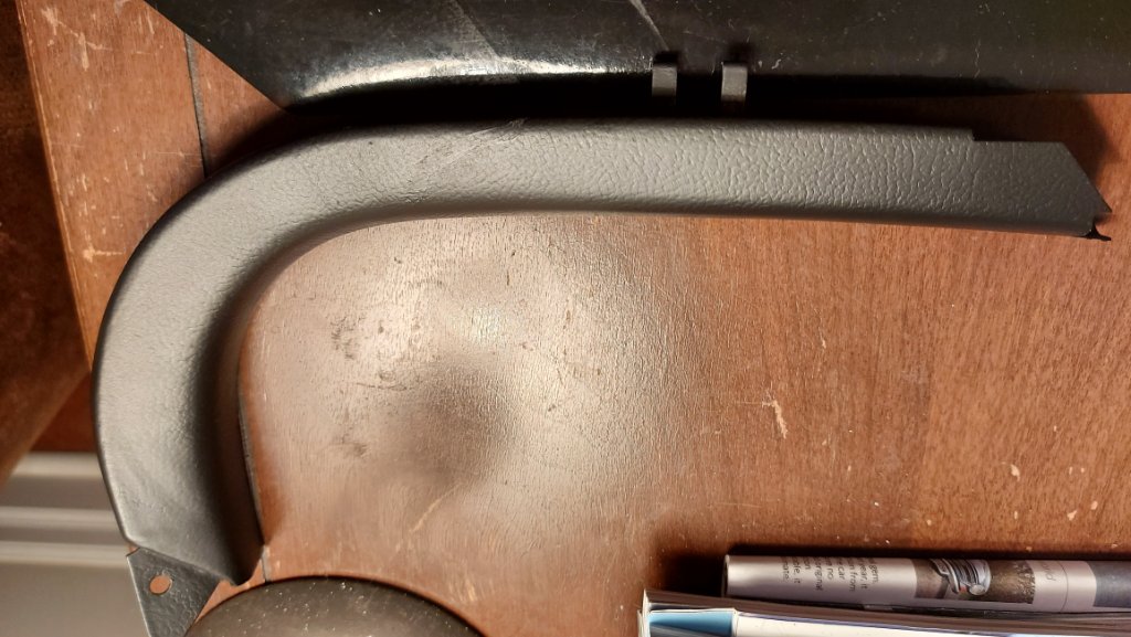

While that was curing I stripped the rest of the trim pieces. First with the paint stripper then using a fiber wheel in the drill press.
They turned out good.
Dec 14th (2).jpg (115.06 KiB) Viewed 44233 times
Dec 14th (3).jpg (124.81 KiB) Viewed 44233 times
I did the same with the A pillar trim, but was careful with the fiber wheel.
Dec 14th (7).jpg (101.94 KiB) Viewed 44233 times

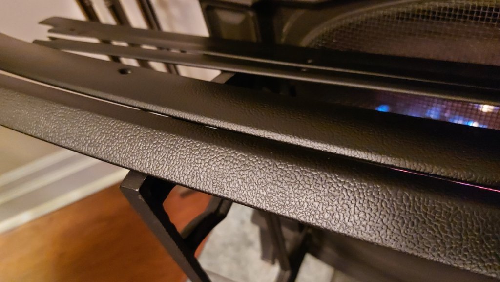

Posts: 746
Post by 71Beeper » Sat Dec 18, 2021 1:17 pm

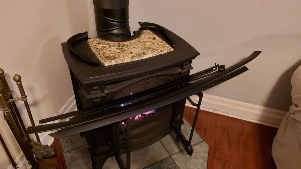

Painted up all of the trim - but with the cooler weather I had them inside to dry properly. Nothing like having a gas stove to cure the paint!
Dec 15th (1).jpg (74.67 KiB) Viewed 44233 times
They turned out great.
Dec 15th (4).jpg (94.9 KiB) Viewed 44233 times
Dec 18th (1).jpg (115.91 KiB) Viewed 44233 times
Dec 18th (2).jpg (114.23 KiB) Viewed 44233 times
Dec 18th (3).jpg (114.63 KiB) Viewed 44233 times

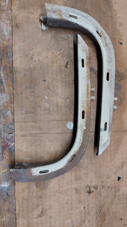

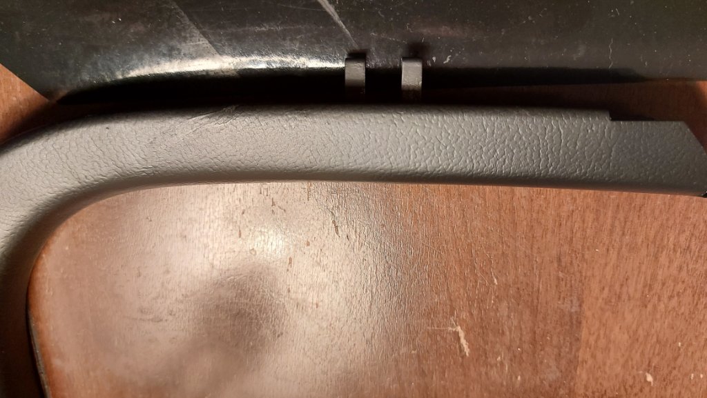

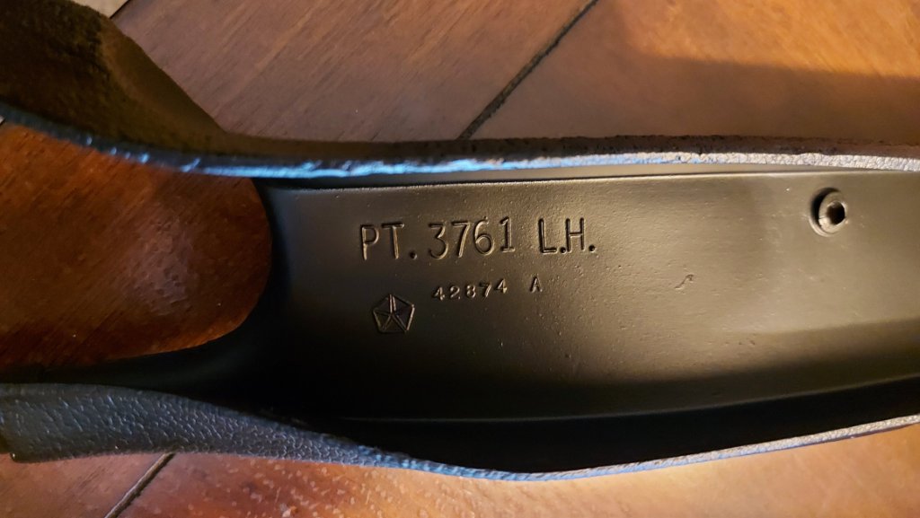

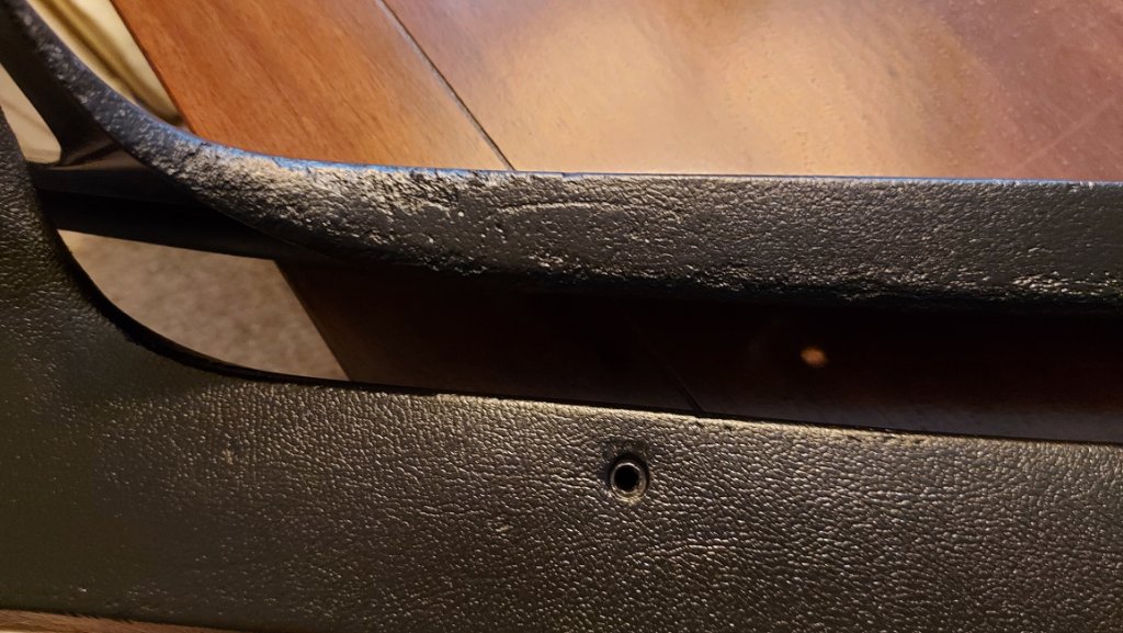

Post by 71Beeper » Sat Dec 18, 2021 1:20 pm

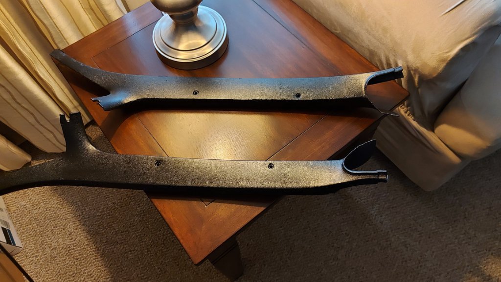

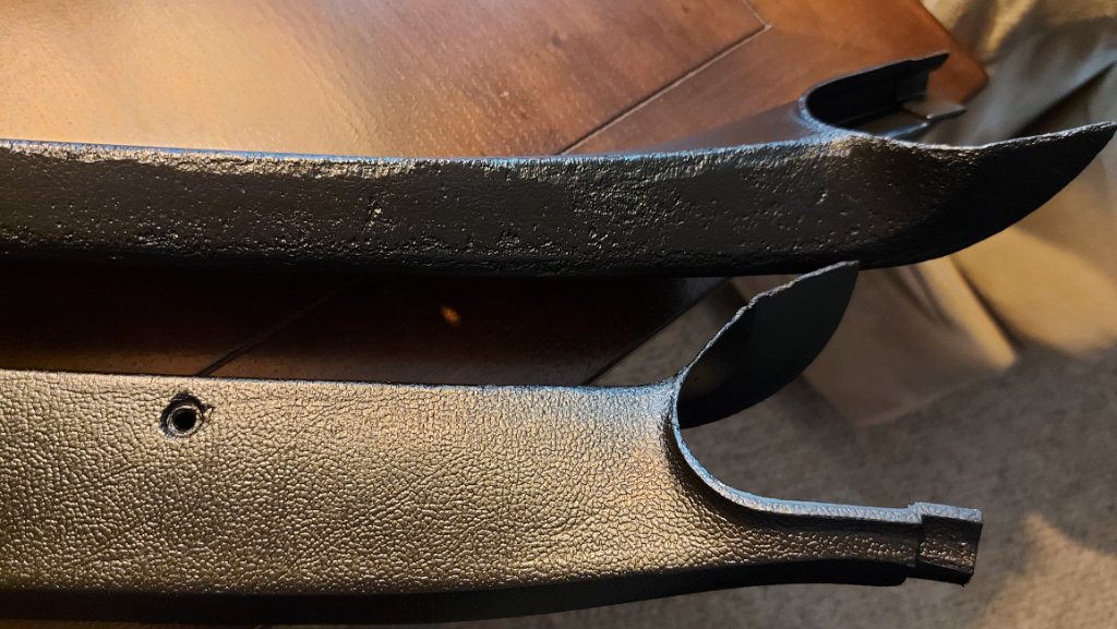

Now pictures can be deceiving. The A pillars are the original ones from the car. Since they were white previously, the sun has taken it's toll on them.
Dec 18th (4).jpg (128.48 KiB) Viewed 44233 times
Dec 18th (5).jpg (130.57 KiB) Viewed 44233 times

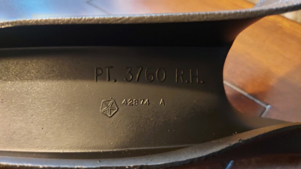

They are not perfect, but considering the cost of re-pop ones.... :shock:
Here are the part numbers for them.
Dec 18th (6).jpg (74.27 KiB) Viewed 44233 times
Dec 18th (7).jpg (63.12 KiB) Viewed 44233 times
