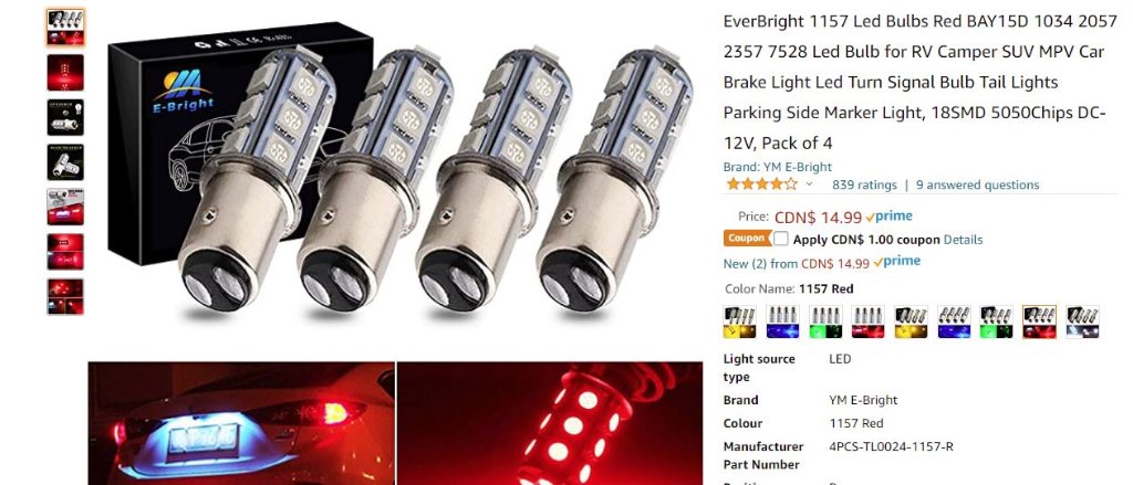

Scott - my light bulb sockets are not in too bad a shape. I did squeeze the o.d. slightly so the bulbs are quite a snug fit.
Here are the part numbers for the bulbs.
I did get them from Amazon.
For the red LED's
Red LED bulb.JPG (90.07 KiB) Viewed 38388 times
and for the back-up bulb.....
White LED reverse bulb.JPG (89.64 KiB) Viewed 38388 times

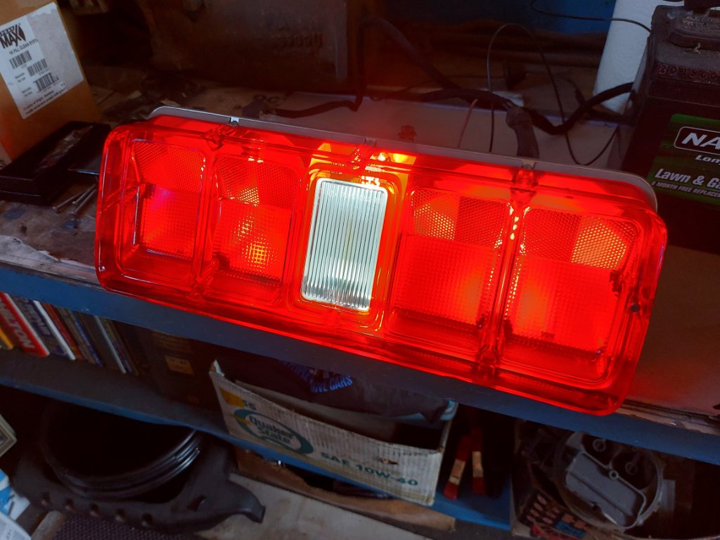

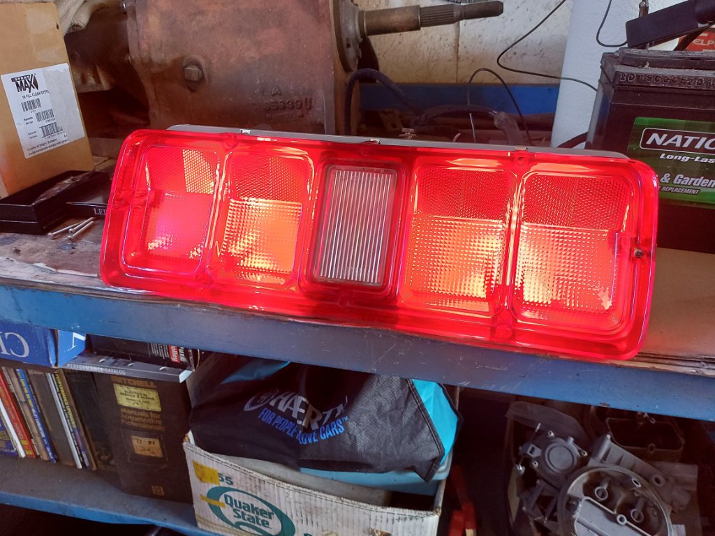

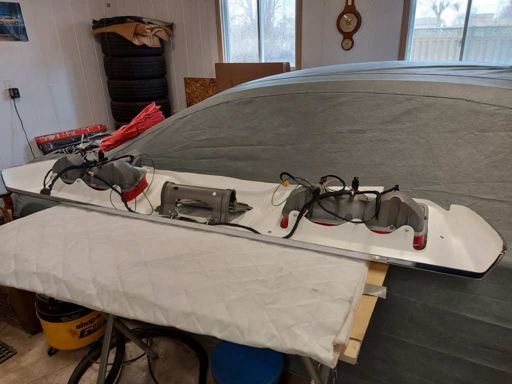

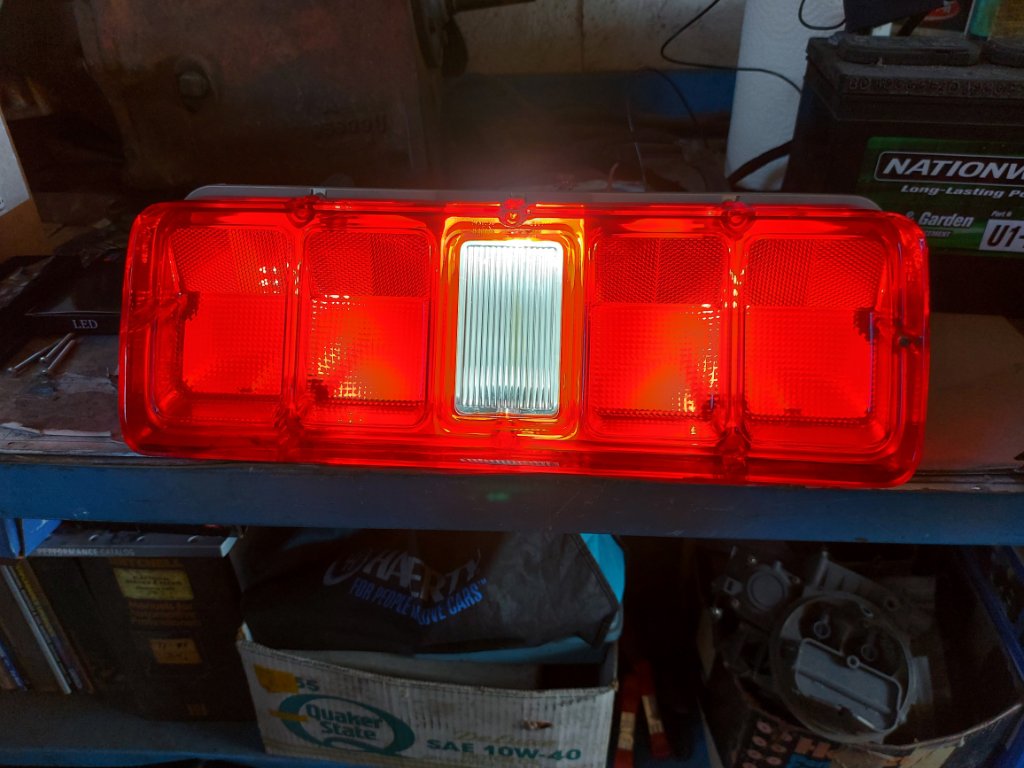

Also, I put the tail light lens back on (with a new gasket from Detroit Muscle Tech) and put the power to it.
March 21 (3).jpg (167.08 KiB) Viewed 38388 times
March 21 (1).jpg (119.31 KiB) Viewed 38388 times
March 21 (2).jpg (107.92 KiB) Viewed 38388 times

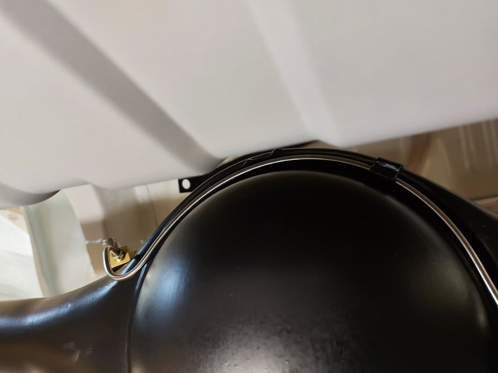

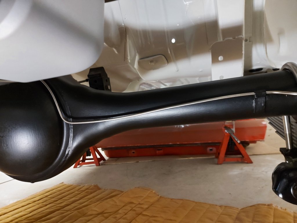

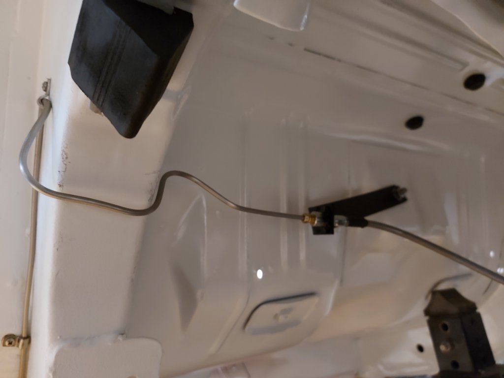

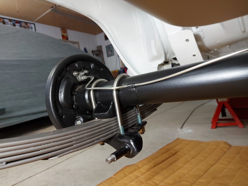

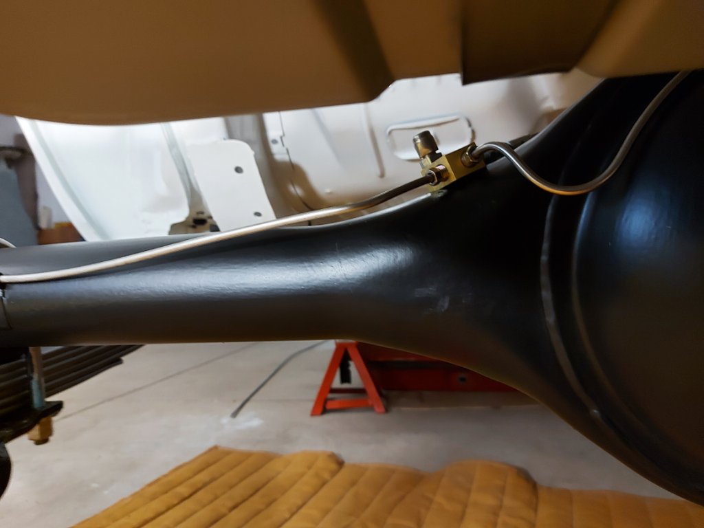

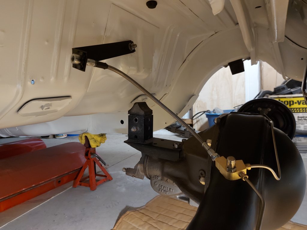

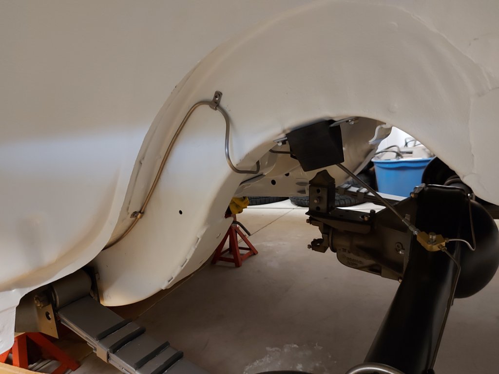

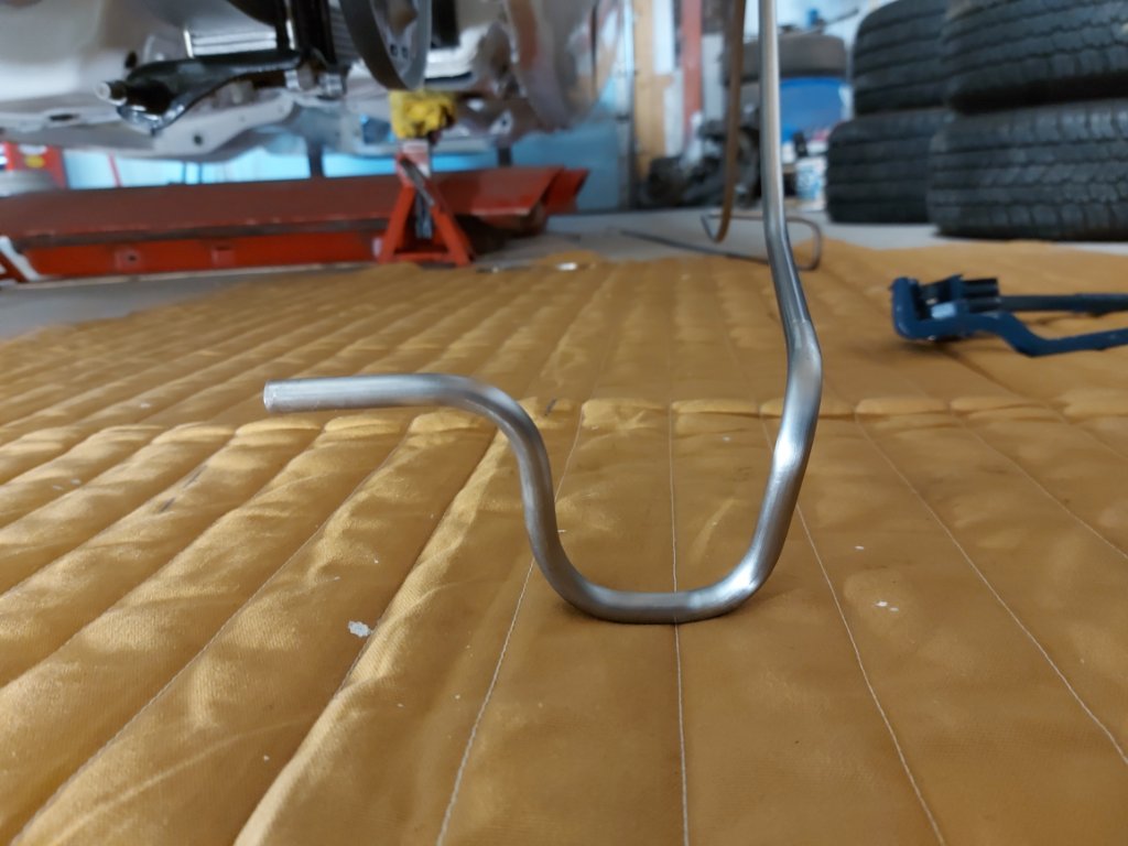

So this past weekend I came to the realization that the rear end housing in my car is not a B-body housing but a C-body housing - probably out of a Fury.
I know this now because I had bought the stainless pre-bent brake lines that go along the housing from the distribution block out to each wheel cylinder for a 1971 B-body.
March 27 (14).jpg (87.4 KiB) Viewed 38340 times
When I went to fit them, well the one for the passenger side was too long, and the one for the drivers side was too short..... :mad:
But the good thing was I was able to shorten the passenger side to fit....it just had to be tweaked a bit.
March 27 (8).jpg (88.18 KiB) Viewed 38340 times
March 27 (9).jpg (52.51 KiB) Viewed 38340 times
For the drivers side I had to make a new one.
Good thing I have some 3/16 stainless brake line at home along with a good flaring tool.
March 27 (12).jpg (91.9 KiB) Viewed 38340 times
March 27 (11).jpg (68.73 KiB) Viewed 38340 times
Also, in the first photo you'll see the braided flex stretched right out to it's max. If the block was a little more towards the drivers side, that line would be a little more relaxed.
Anyway, they are installed....now onto fitting the rear brakes.

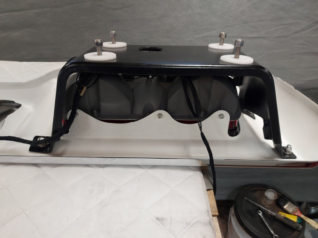

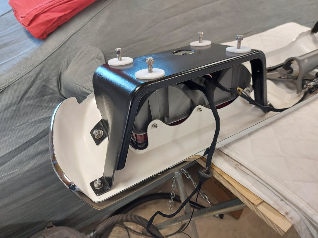

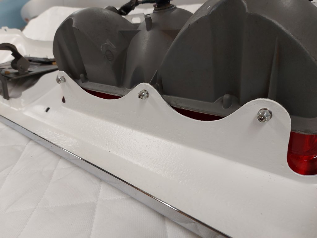

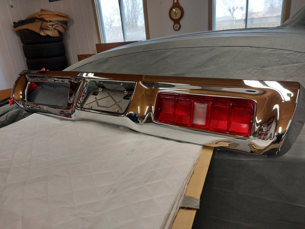

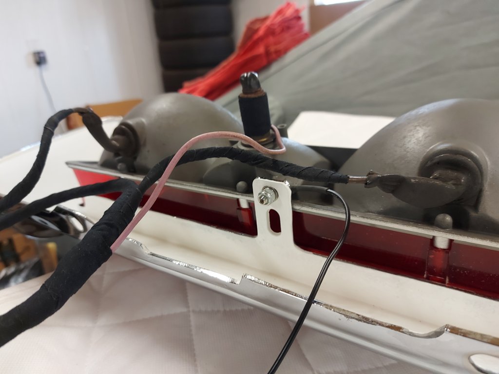

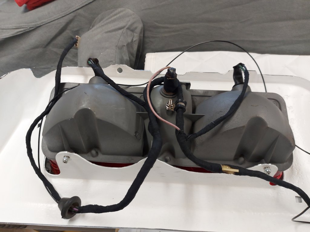

Post by 71Beeper » Sat Apr 03, 2021 5:05 pm

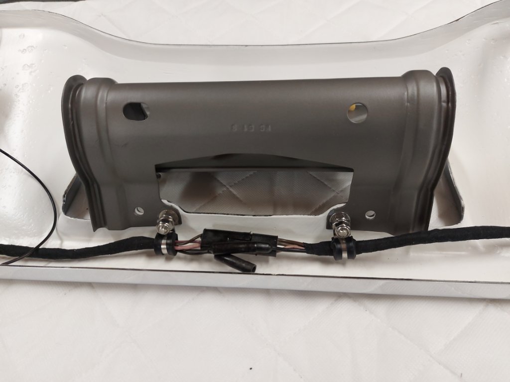

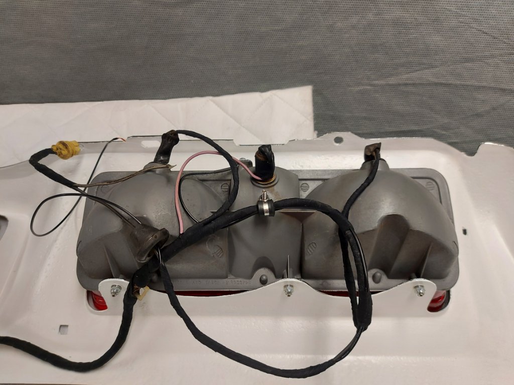

While waiting for my remaining red LED to come in, I installed the passenger tail light housing and license plate holder to the rear bumper.
April 3 (7).jpg (116.92 KiB) Viewed 38281 times
April 3 (1).jpg (116.64 KiB) Viewed 38281 times
April 3 (2).jpg (106.46 KiB) Viewed 38281 times
April 3 (3).jpg (63.21 KiB) Viewed 38281 times
April 3 (4).jpg (85.73 KiB) Viewed 38281 times
I added a ground wire to the housing to make sure there will be a sufficient ground for the lights to work properly.

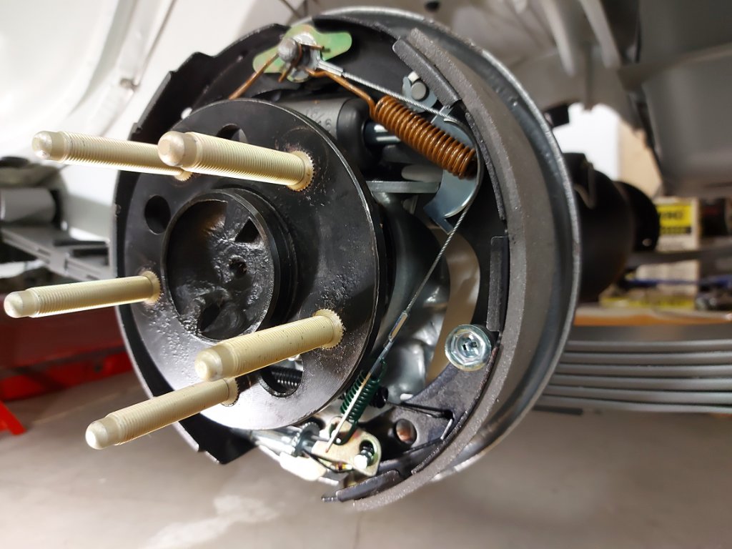

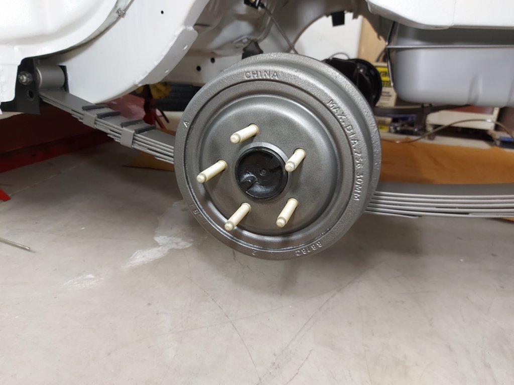

Post by 71Beeper » Sun Apr 11, 2021 4:05 pm

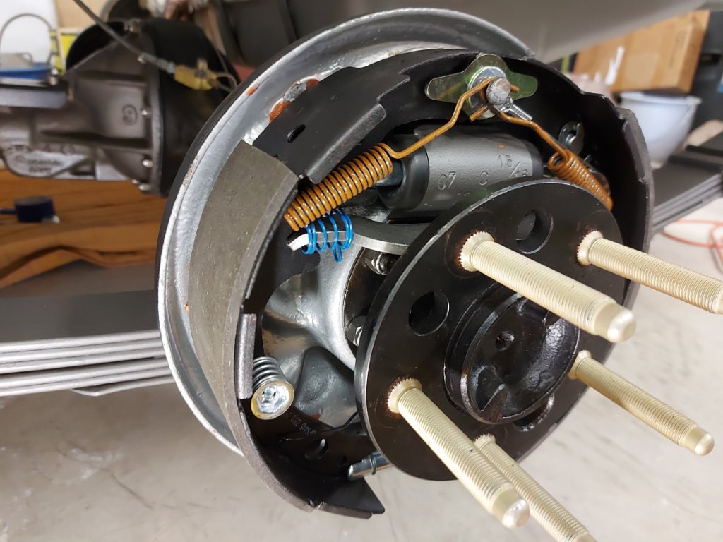

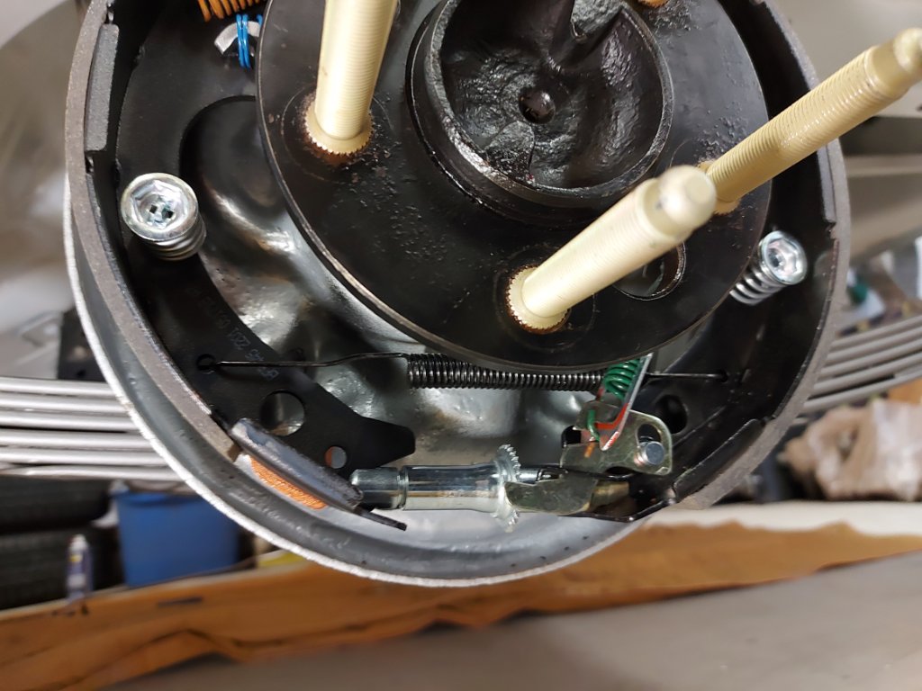

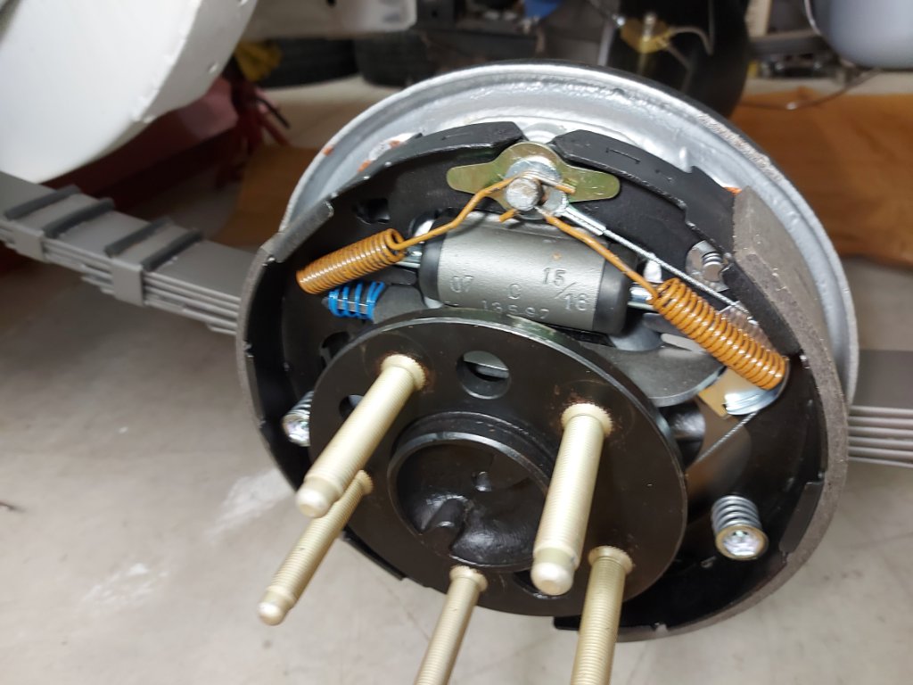

With all the CORRECT brake hardware finally arriving I was able to get the rear brakes put together and the drums on her.
April 11 (1).jpg (99.74 KiB) Viewed 38178 times
April 11 (2).jpg (120.1 KiB) Viewed 38178 times
April 11 (3).jpg (115.85 KiB) Viewed 38178 times
April 11 (4).jpg (125.99 KiB) Viewed 38178 times
April 11 (5).jpg (90.26 KiB) Viewed 38178 times

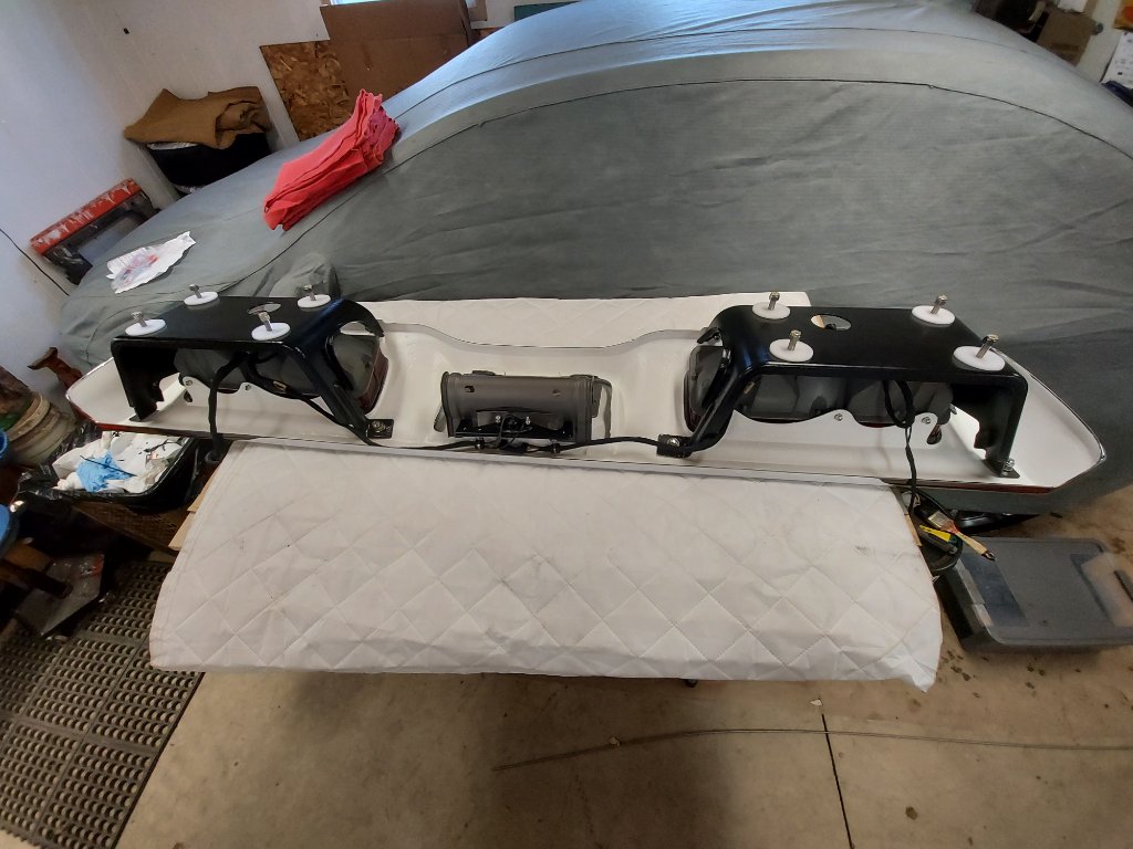

Post by 71Beeper » Sun Apr 11, 2021 4:07 pm

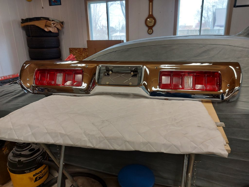

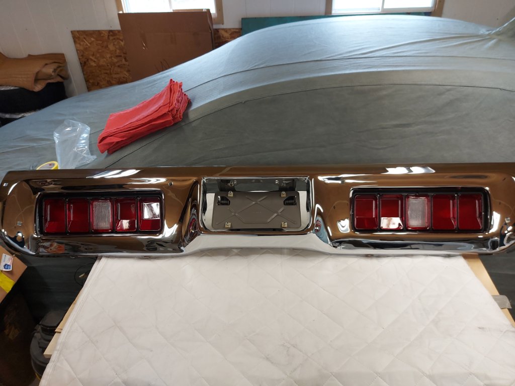

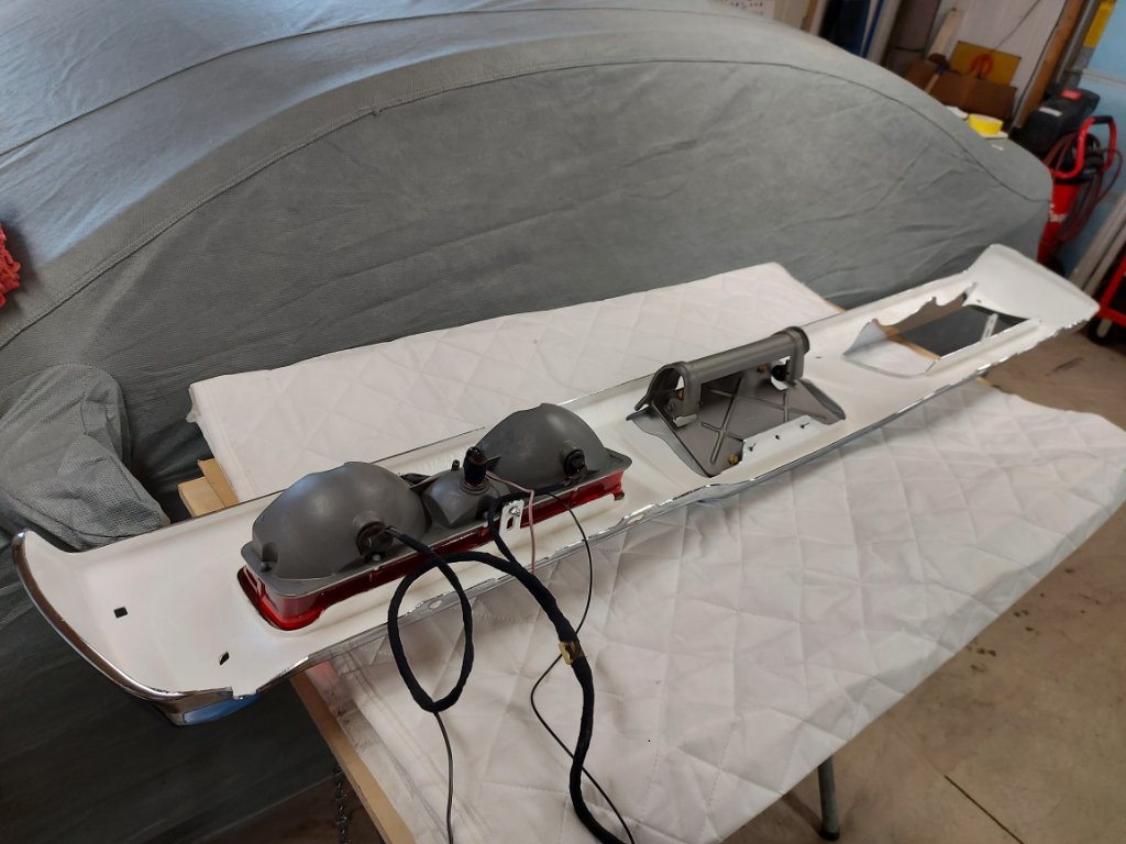

And my red LED bulb came in so I was able to put together the drivers side tail light and install on the bumper.
April 11 (20).jpg (113.6 KiB) Viewed 38178 times
April 11 (21).jpg (126.26 KiB) Viewed 38178 times
April 11 (22).jpg (70.66 KiB) Viewed 38178 times
April 11 (23).jpg (111.8 KiB) Viewed 38178 times
April 11 (24).jpg (94.79 KiB) Viewed 38178 times

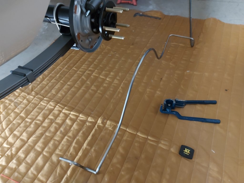

I also started bending up the 3/8" stainless fuel line and 3/16" stainless brake line.
The fuel line can be tuff, especially using a small hand held bender.

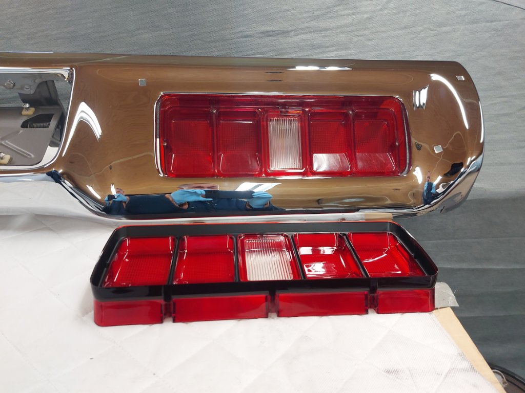

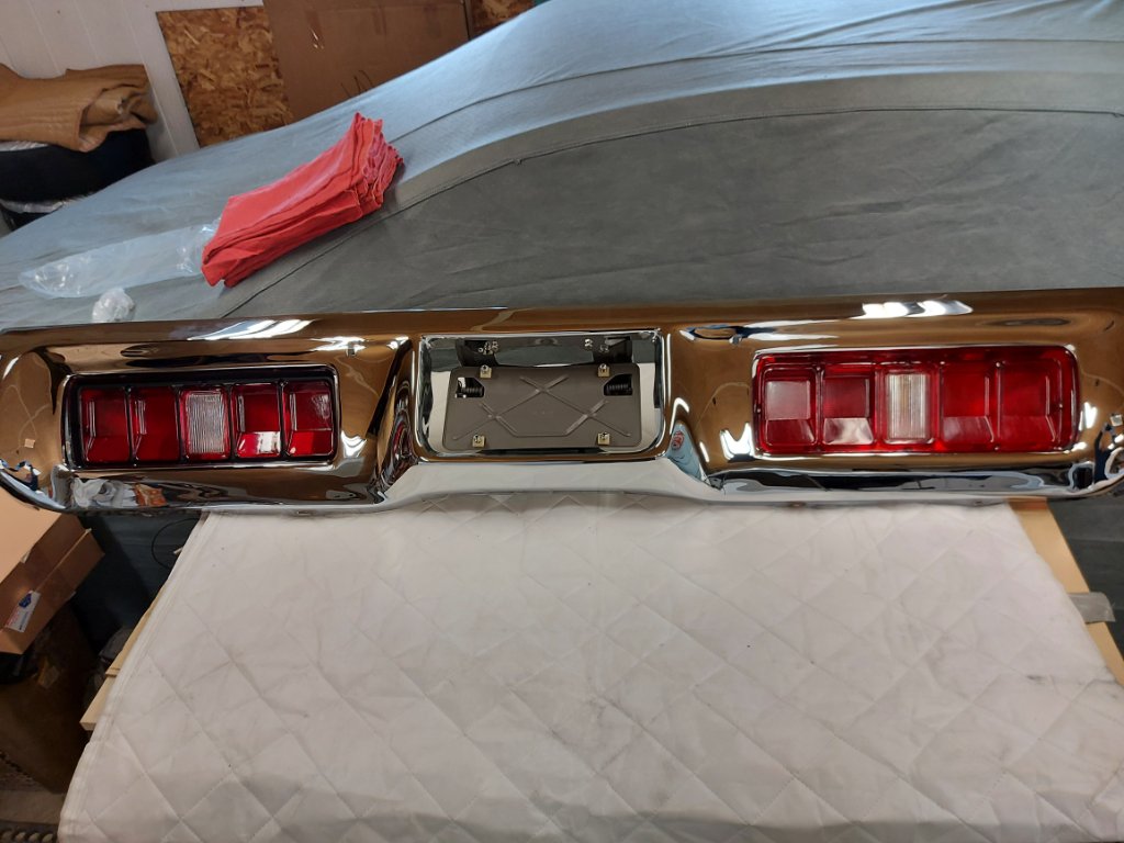

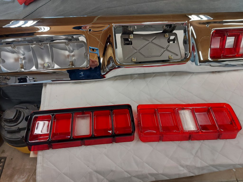

After all the time and effort I took getting the tail light lenses cleaned up was for nothing.....today I'm in the attic looking for the master cylinder for the car and I find a box that says "1971 Road runner tail light lenses".
I guess I did buy new lenses at some point in time....go figure.. :?
Old versus new....
April 17 (9).jpg (130.59 KiB) Viewed 38115 times
April 17 (11).jpg (127.1 KiB) Viewed 38115 times
April 17 (10).jpg (109.9 KiB) Viewed 38115 times
And both new ones installed..
April 17 (13).jpg (102.85 KiB) Viewed 38115 times

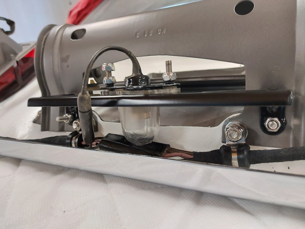

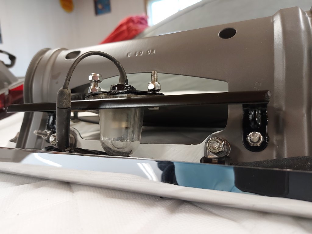

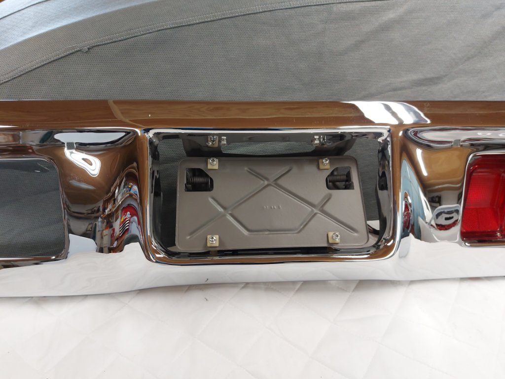

I finally found a license plate light assembly....it was in a box of spare parts my buddy who owned a 1973 Roadrunner gave me after he sold his Runner.
I don't think my car came with one or I don't remember removing it... :shock:
Anyway, cleaned it up in the Evaporust and put a some semi gloss black on it and mounted it.
April 25,2021 (1).jpg (95.94 KiB) Viewed 38058 times
April 25,2021 (2).jpg (85.06 KiB) Viewed 38058 times

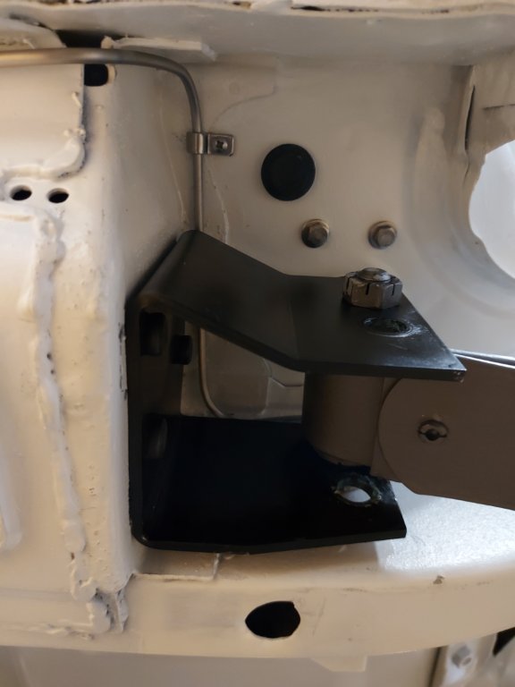

Now that I have everything to mount the rear bumper, it's time for the bumper brackets..
April 25,2021 (3).jpg (118.81 KiB) Viewed 38058 times
April 25,2021 (4).jpg (80.98 KiB) Viewed 38058 times
April 25,2021 (5).jpg (122.51 KiB) Viewed 38058 times
