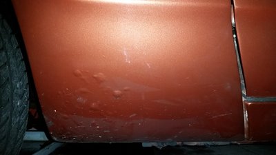

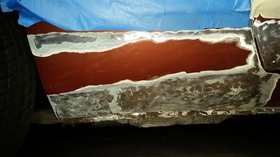

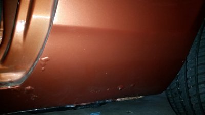

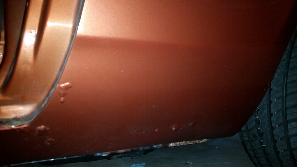

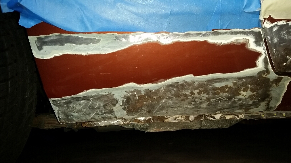

I bought this numbers-matching, no-fender-tag-or-build-sheets 71 GTX in late 2012, knowing it was going to be a project even though it was drivable and running (poorly). It had very visible blistering of painted bondo between the wheel wells on the quarters, rockers, doors, and the left fender. A friend had said he would do the body work before I decided to buy it, but I could never get him to do it. After 4 years of other tweaks and repairs, etc. I decided to attempt to do the sheet metal patching or replacement myself. Naturally, things are worse than they appeared to be before I started grinding away paint and bondo around the blisters.
I had been hoping to stay below the body line, which would make not-quite-matching paint not so visible.
It's looking like I may be replacing both quarters instead of using lower patch panels.
Some time ago I had bought rocker skins - I think from Roseville - and left them in the box until recently. They don't really fit and the outer surface is flat rather than curved. WTF. I might be able to cut them at the sill and bend them close to the correct shape, then slather on the mud.
The patch panels for the fender lower rears and quarter lower fronts seem to fit well. They came from Classic, and might be made by AMD.

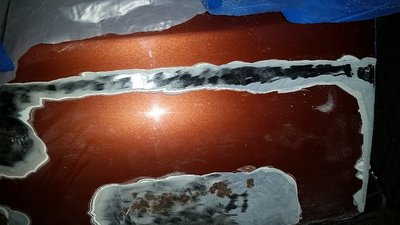

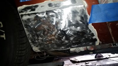

A previous "restorer" tac-welded in some half-assed patched and continuous welded some others. I found bondo nearly 5/16" thick, where the metal was caved in, either from welding warp or physical damage.

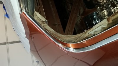

The first thing to do was remove the rear glass exterior moldings, the rear glass, the quarter window felts, and the quarter window belt moldings.
The rear glass moldings are held in by a clip that is installed onto studs around the reveal. These studs look like the top 1/8 inch of a 4 penny common nail. Some were missing, and the clips were screwed on instead. I couldn't get the screws out with a screwdriver. Note that the new AMD quarters don't have these studs, so unless I want to try to make studs and weld them in from behind, I'll have to use screws anyway.

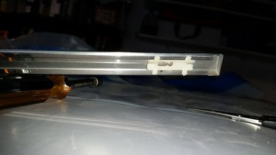

There are tools available to release the moldings from the clips, and I watched some youtube video, then decided to try to use a right-angled pick scribe, which is hardened tool steel. With a little fiddling around, you get the point in behind the clip at the upper end, pull it away from the reveal, and the molding pops up.
The belt molding is actually two pieces crimped together with a splice piece in between. They don't readily separate. The forward piece is held down by two plastic clips that fit into the channel of the molding and can slide back and forth. They clip onto studs the same as the rear glass moldings. The rear portion is held by a screw down low and a pretzel spring clip up high. I broke the one plastic clip on the passenger side because I though the whole thing used the pretzels, and just tried to pry it up. Oddly, the other one came off without breaking. On the drivers side I tried to reach under and slide the clips forward to release them, but broke one anyway. It may not matter, because unless I'm going to try to make studs for the new quarter, I'll have to find another way to attach them.

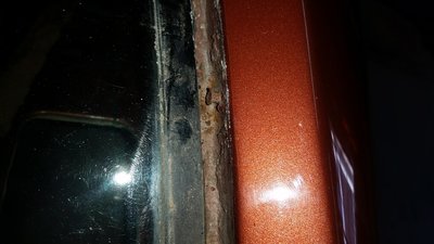

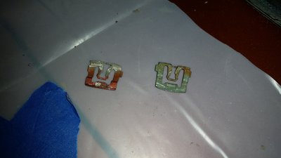

The window felts, or cat whiskers, have upside-down u-clips, that fit into slots cut into the quarter - 7 in total. I used and .020" feeler gage in between the felt and the sheet metal to locate the clips. Since I intend to replace them, I didn't care if I saved them. I just grabbed it next to the clip with pliers and yanked up. A few were rusted in. Destroyed them. They were dry-rotted anyway.
