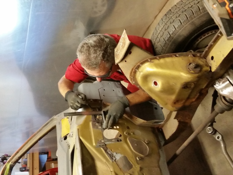

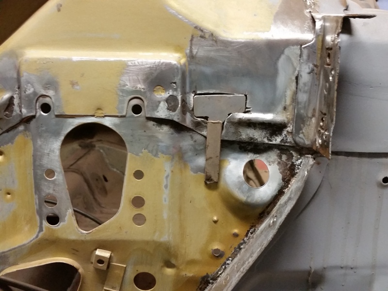

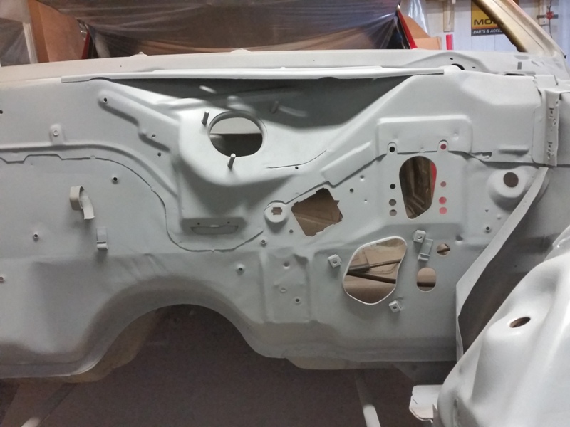

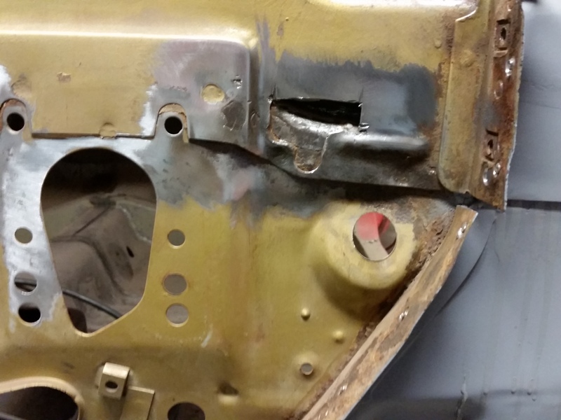

The more I look at it rr6pak the more I think it's been relocated. Here's a really good pic of a nice K-member.See the drivers side mount - the location looks different than mine. But until I get some real world measurements, I won't know for sure. But I have a buddy who has a 1971 Cuda. I will be looking at that K-member and taking some measurements from it. Until then, I'll keep working on other stuff, namely getting the drivers side firewall done. So here's what I have so far.Yours truly measuring up for a patch. And here's the patch (with a magnet to hold it)

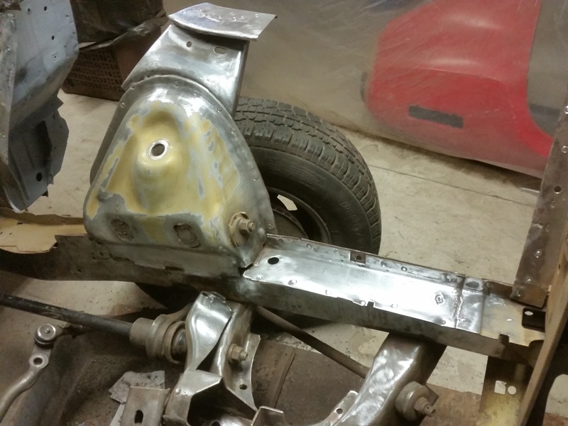

Onto prepping the frame rail and shock tower and getting it ready for some zero-rust paint.

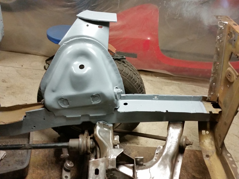

So this weekend was able to get some Zero rust paint on the frame rail.And was also able to finish the firewall on the drivers side.So now I can go back and concentrate on the engine mount. I was able to see the K-member in a 1969 Charger and took some measurements. So looking at mine here.The mount is too far to the left by 1.5" - that's compared to the Charger mount. I will go and have a look at an E-Body K-member to confirm that measurement, so I won't do any cutting or removing till I have seen the E-body one.

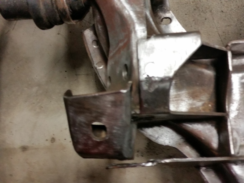

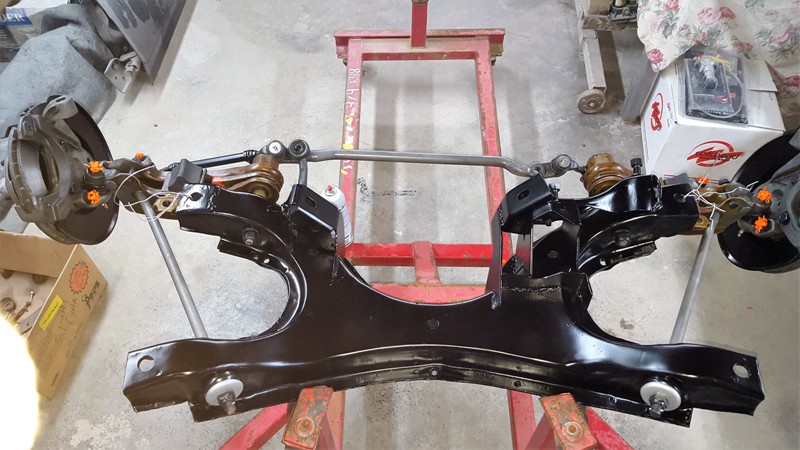

After some more investigation and getting another k-member to use as reference, it turns out that both engine mount perches have been moved. So therefore I will be getting another k-member.
The good thing about getting another k-member is that I will be able to put the engine and front suspension parts on it, then drop the car over it when the time comes - just like Bruce did with his white one.

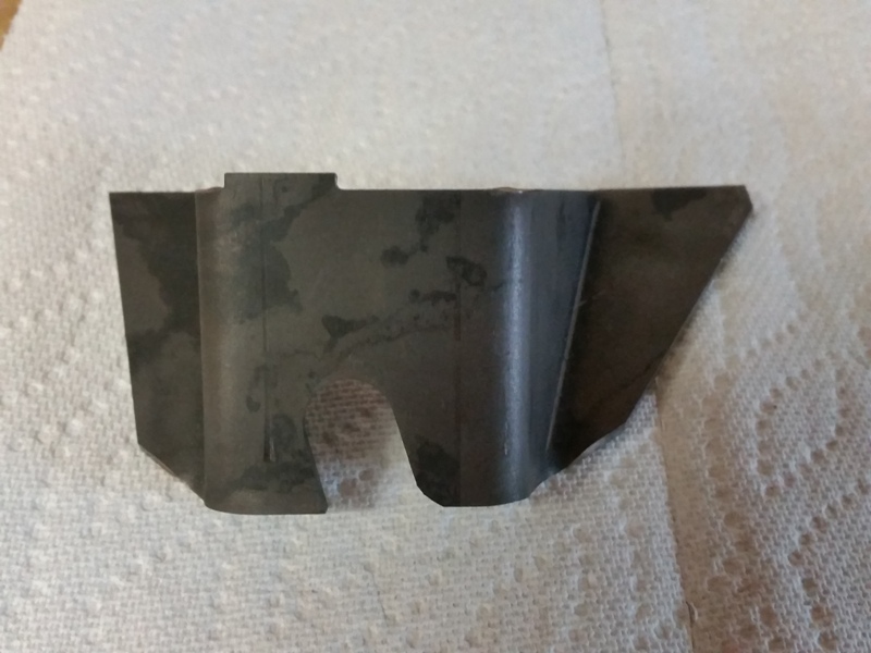

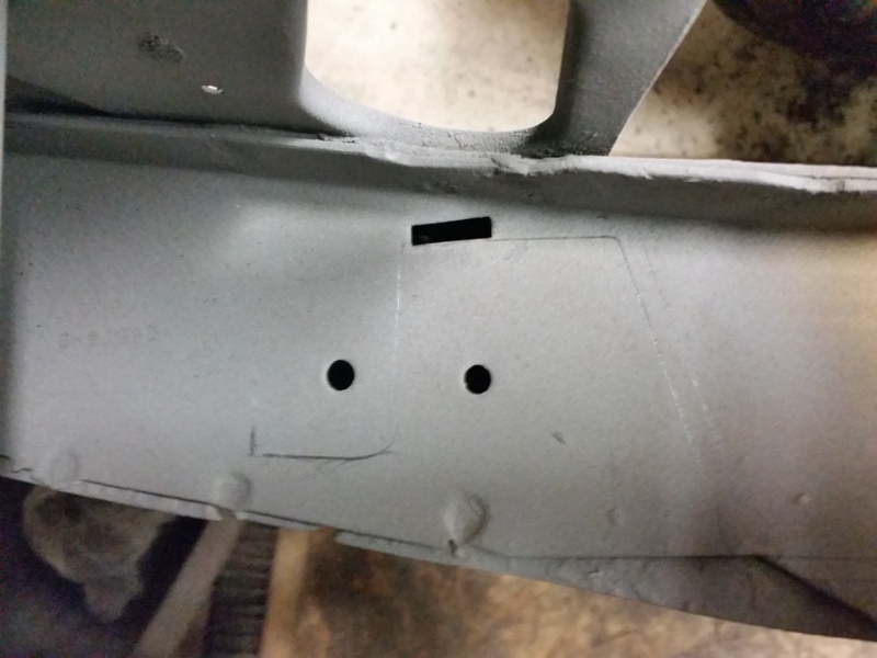

Today I prepped the bracket for the 4 speed z-bar. The raised area at the top goes into the slotted hole in the frame. Then grind the area clean & fit-check then weld her on and finish with a coat of primer. After that I started prepping the outer surface of the drivers side inner fender to get it ready for some rust bullet paint.

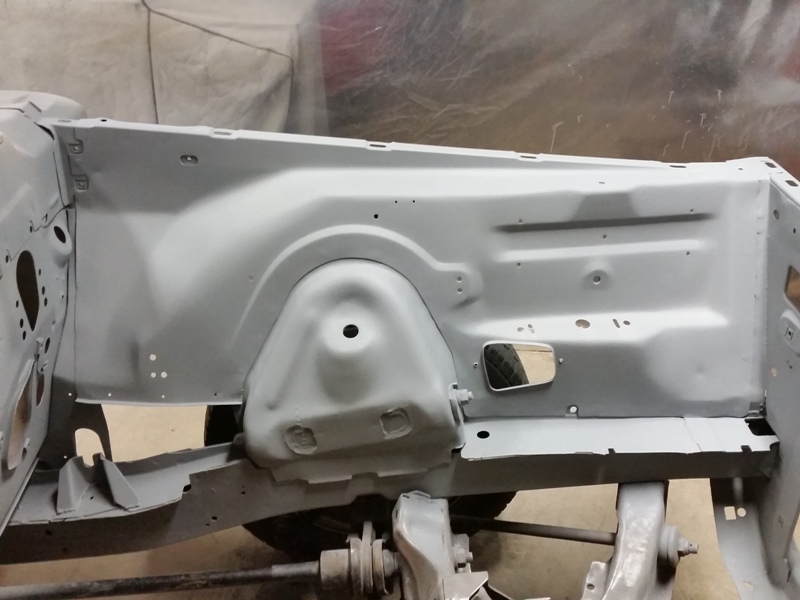

So continuing on, I had a small spot on the rad support to put some metal prep on and finish it up.Then I primered the drivers side rad support. Next is to fit-check the inner fender and plug weld it in.

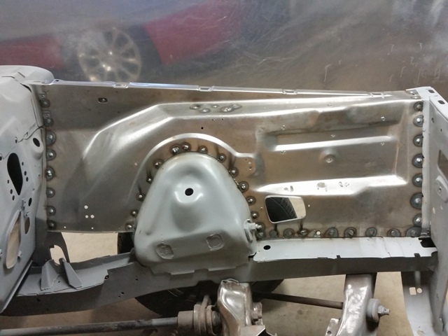

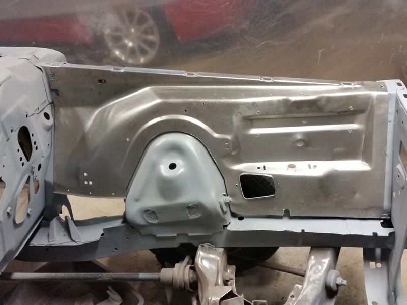

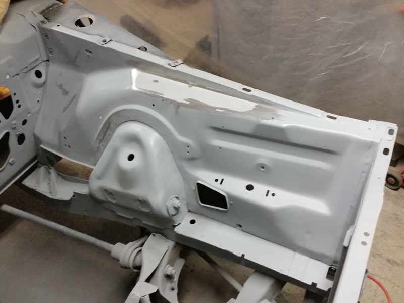

Ok so this weekend is the weekend I end up with a head cold - crap.

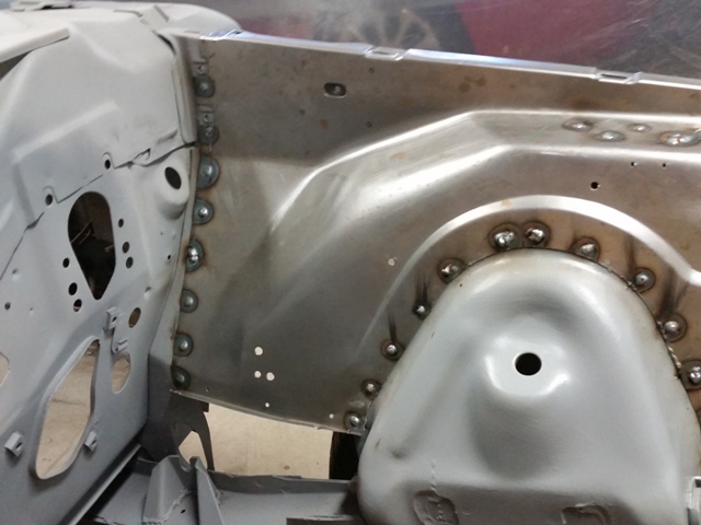

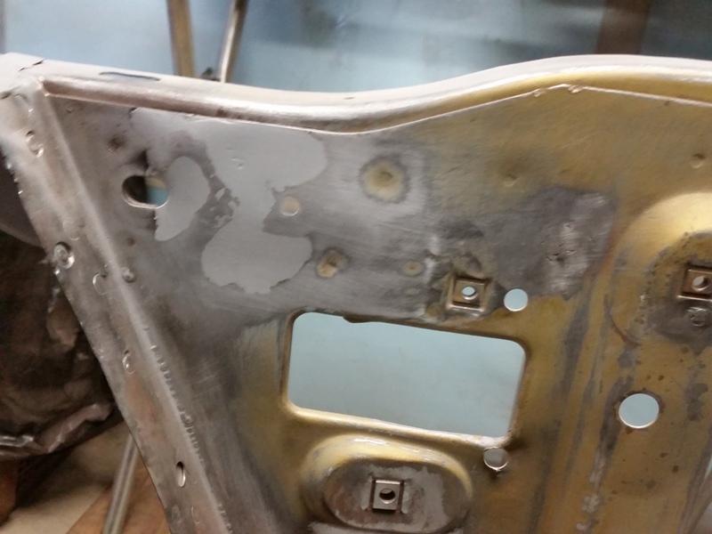

But I still got a chance to weld up the drivers side inner fender. Next step is to clean up the welds and put on a little putty.

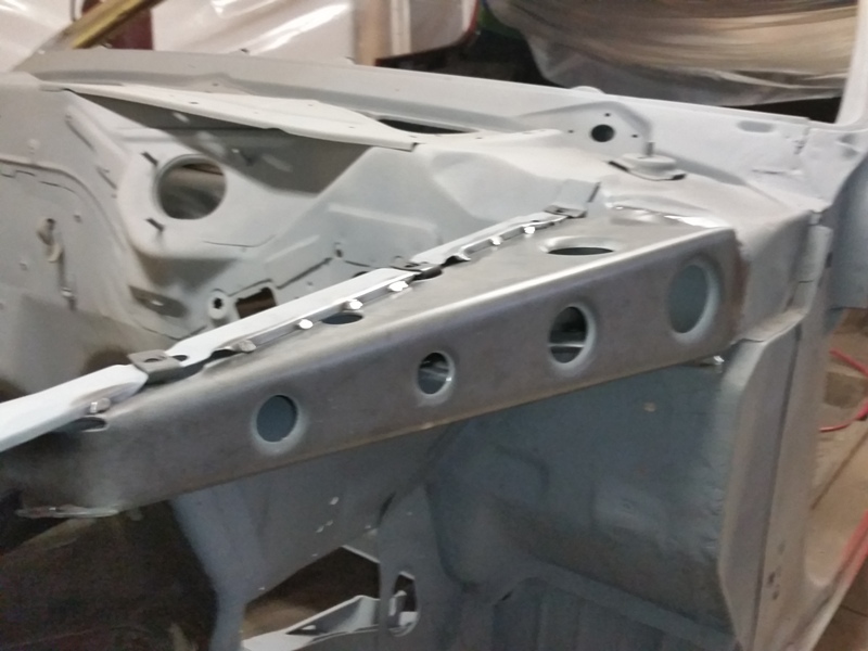

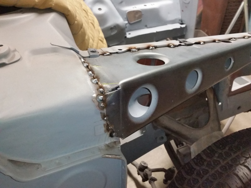

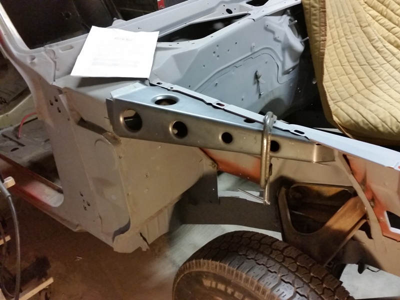

So to update from my last post, I ground down the spot-welds and applied some all-metal putty. Then get the all-metal sanded down and prep for primer. and shoot some primer. Next it's on to doing a fit-check on the US car tool inner fender braces. They don't make them for 1971 B-bodies so I ordered the ones for an E-body. I assumed the fender braces would be close as the inner fenders for a B & E body are the same.......WRONG! Here's some pics.so I'll be doing a little nip and tuck here and there. Hopefully I won't get too much grief.

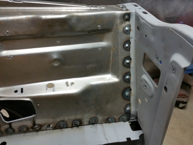

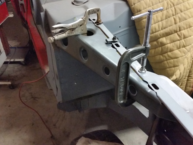

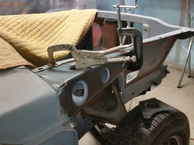

As I stated in my last post, I had a little fitment issue while doing the fit-check. With a little sister sledge hammer work it went from this....to this........But another issue has came up - it seems I cannot put the J nuts onto the inner fenders after tack welding the brace on... it looks like the reliefs that US car tool put into the braces are kinda small. So I need to order the proper J nuts. Anyone know where I can get them?

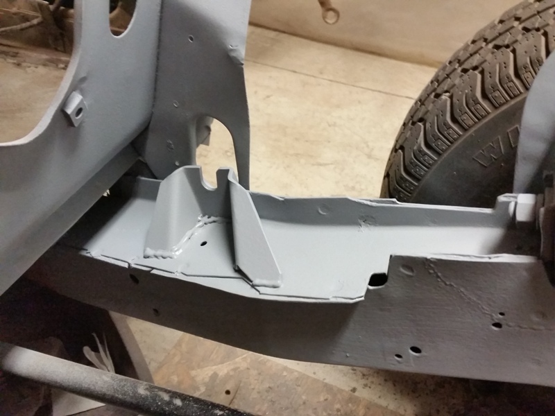

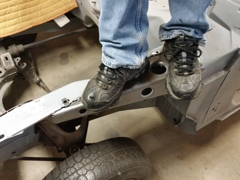

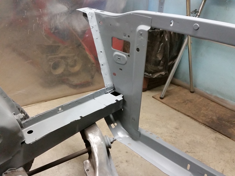

So over the Christmas holidays, I was able to finish installation of the fender braces, both sides. Here's the passenger side and here's the drivers side. They sure are strong braces.....strong enough to hold me!

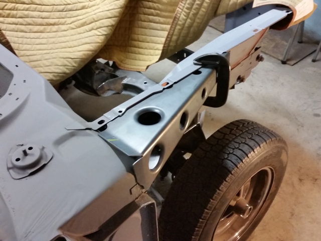

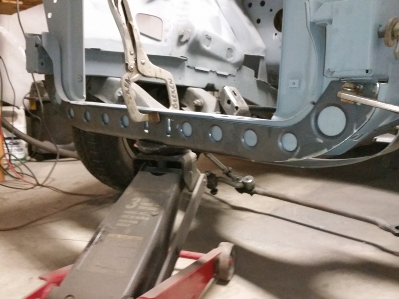

Next I moved onto doing a fit-check on the rad support brace...

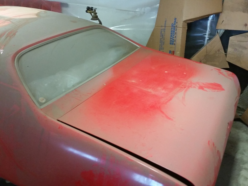

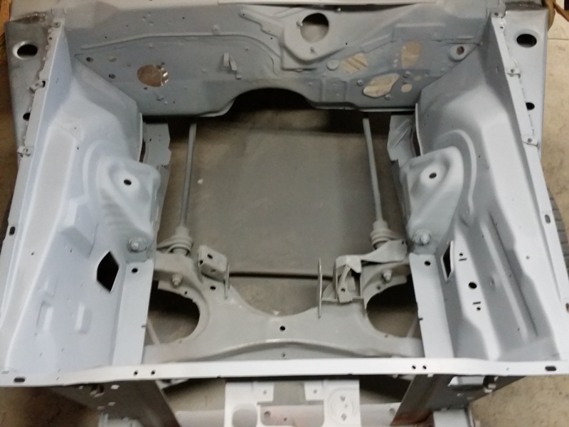

So,continuing on - the rad support brace is now welded in, so I had to back-step a bit. Seems that when welding the gussets in for the inner fender braces I wrecked some of the putty that was on the inner fenders, so I had to take it all out and re-putty. and now the final primer coat which should finish up the engine compartment for now!!! Yay!!

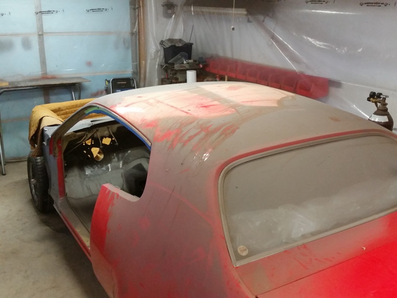

Moving on to the inside of the firewall, but before that i thought I should clean up the car and the area around it. Man I couldn't believe the amount of dust and crap on the car.Even on the trunk where I had one of the new rear quarters sitting on it, I moved the quarter off the car and this was underneath it.
