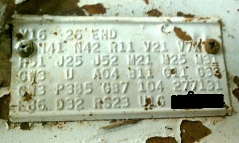

Re: Help With My "New" 71 GTX
White with blue cloth interior...very cool!Uppy wrote:Here is my fender tag for my 1971 GTX.

If you really want a tag in there to make the engine bay look more complete, then maybe you could do something like this. Make it plainly obvious that its not the original tag. You can probably figure out what month it was made just tracking a few VINs here and there, so use the three letter abbreviation for the month instead of the normal SPD. You will never know the VON, so just put REPROD or CUSTOM in that spot. Then just don't claim any special equipment in the option codes like air grabber hood or bright exhaust tips etc etc. Just the bare minimum standard options that usually come on a GTX. Maybe even stamp in small letters across the top "Custom Tag". If a buyer down the line can't figure out its not a real tag, then they haven't done their homework - and its not like you are trying to pass off a Satellite coupe for a GTX - It is a GTX baby!
Just my 2c.
Oh yah - just pretend this Autumn Bronze tag was repainted GB7.
Just my 2c.
