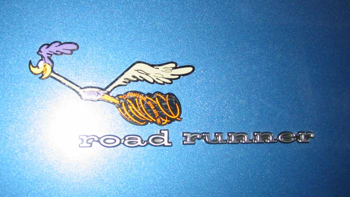

Thanks for your reply. What would the light package and decor package include? There are four holes on the drivers side quarter panel, anybody know what those are for? What would the exhaust tips look like? Standard or chrome? Sorry for all the questions. Seems to have a few cool options.

The holes in the quarterpanel are for the roadrunner emblems.
http://www.roadrunnernest.com/forum/vie ... lem#p23748
If your car came with the strobe stripes, the roadrunner was part of the decal. Check out the picture thread for all the different placements on 71 and 72 runners.
http://www.roadrunnernest.com/forum/vie ... f=1&t=4711

Since your car is not coded for the strobe stripe, this is what you should have on your quarter panels over the wheel (both sides)

Yeah, but the stripe is WAY cooler! :D
