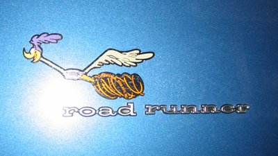

The holes in the quarterpanel are for the roadrunner emblems.
http://www.roadrunnernest.com/forum/vie ... lem#p23748
If your car came with the strobe stripes, the roadrunner was part of the decal. Check out the picture thread for all the different placements on 71 and 72 runners.

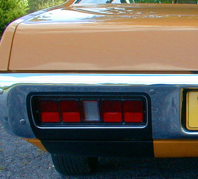

With no tips and the A87 package, you'll have this blackout on your bumper/valance too (tip cars with A87 have the blackout too, but the valance also has half round cutouts for the tips)

Since your car is not coded for the strobe stripe, this is what you should have on your quarter panels over the wheel (both sides)
