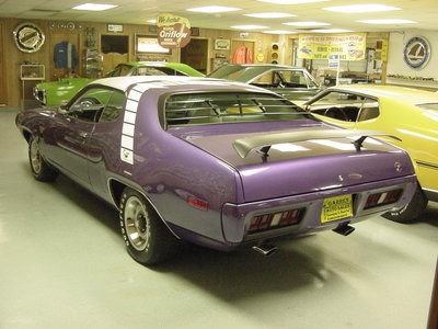

Here's a pic of your original combo for inspiration
