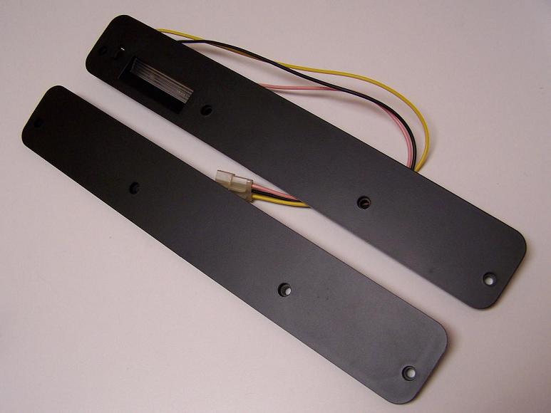

Getting closer! Got another round of protos the other day. The texturing is going thru another round to roughen it up some more, but the wiring, switch, lens, etc are there now and looking good! Should have an updated texture in about a month. You can park the switch on these in the middle just like the original ones if you want to have it off all the time too.

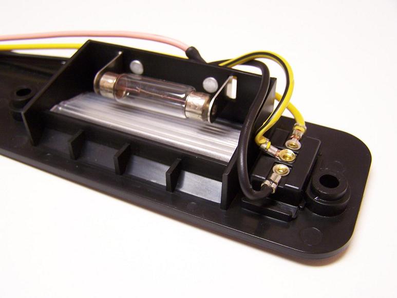

Backside pic...

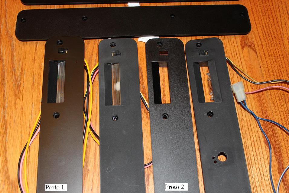

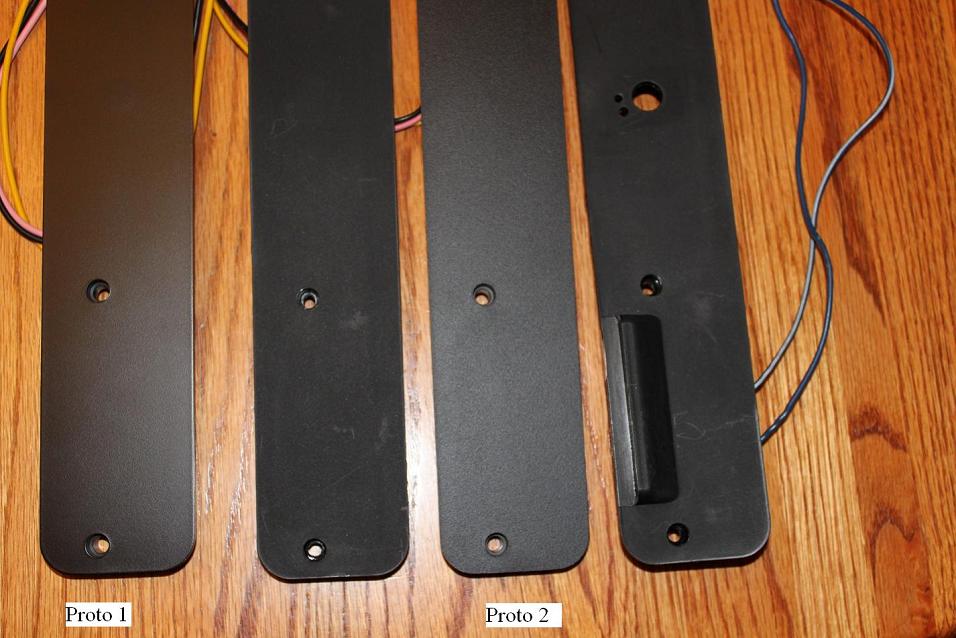

Well, I'm not sure the extra texturing was a step in the right direction or not. I think the tough part about this piece is that even when they're "nice", they really don't LOOK nice. Almost like they were run past a beadblaster to roughen them up a bit and knock off the glossy look that the backside shows. Here's a couple pictures showing the first proto and second proto (rougher) next to a couple originals. What do folks think of this? The "sheen" seems better on the second one, but it seems too rough now. I think the texture of the first proto was technically closer to the original, but it just seems too shiny to me. Opinions?
- map lights.jpg (106.03 KiB) Viewed 24913 times
- map lights2.jpg (126.53 KiB) Viewed 24913 times
Re: Map light lenses and assemblies
Jeff, hats off to you!! WOW, those things look amazing! I hope you are able to make a few bucks, you deserve it. Thanks
...and I agree with you, the first one looks much closer.
